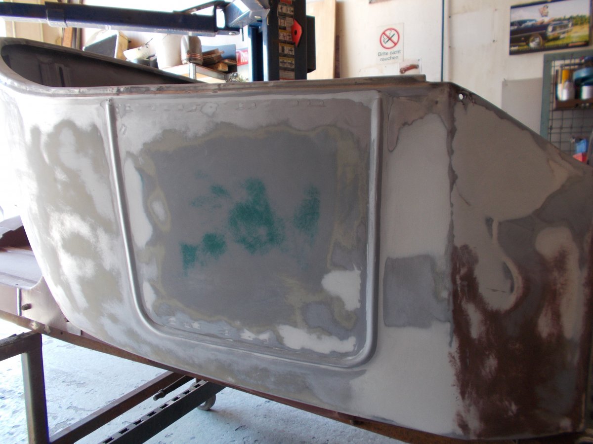

    Here's a picture of one of the rear trunk side panels after many coats of rustproof paint. Sanded smooth with a scuff pad I think I'm going to leave the whole body like this. It looks like faded brown paint.

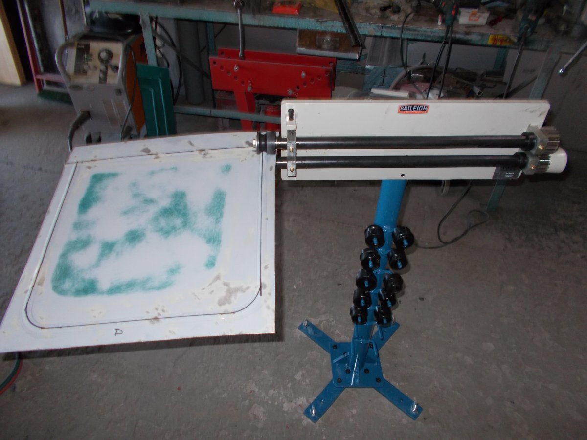

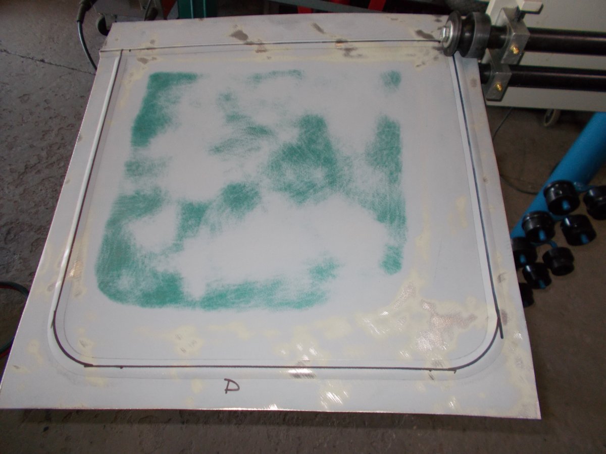

    Waited 10 weeks for the beading machine. Took an hour to ***emble it and just 30 minutes to do all the beading! It is a two man job though, especially the big panels.
    DSCN0940.JPG DSCN0943.JPG DSCN0945.JPG DSCN0946.JPG DSCN0938.JPG DSCN0939.JPG

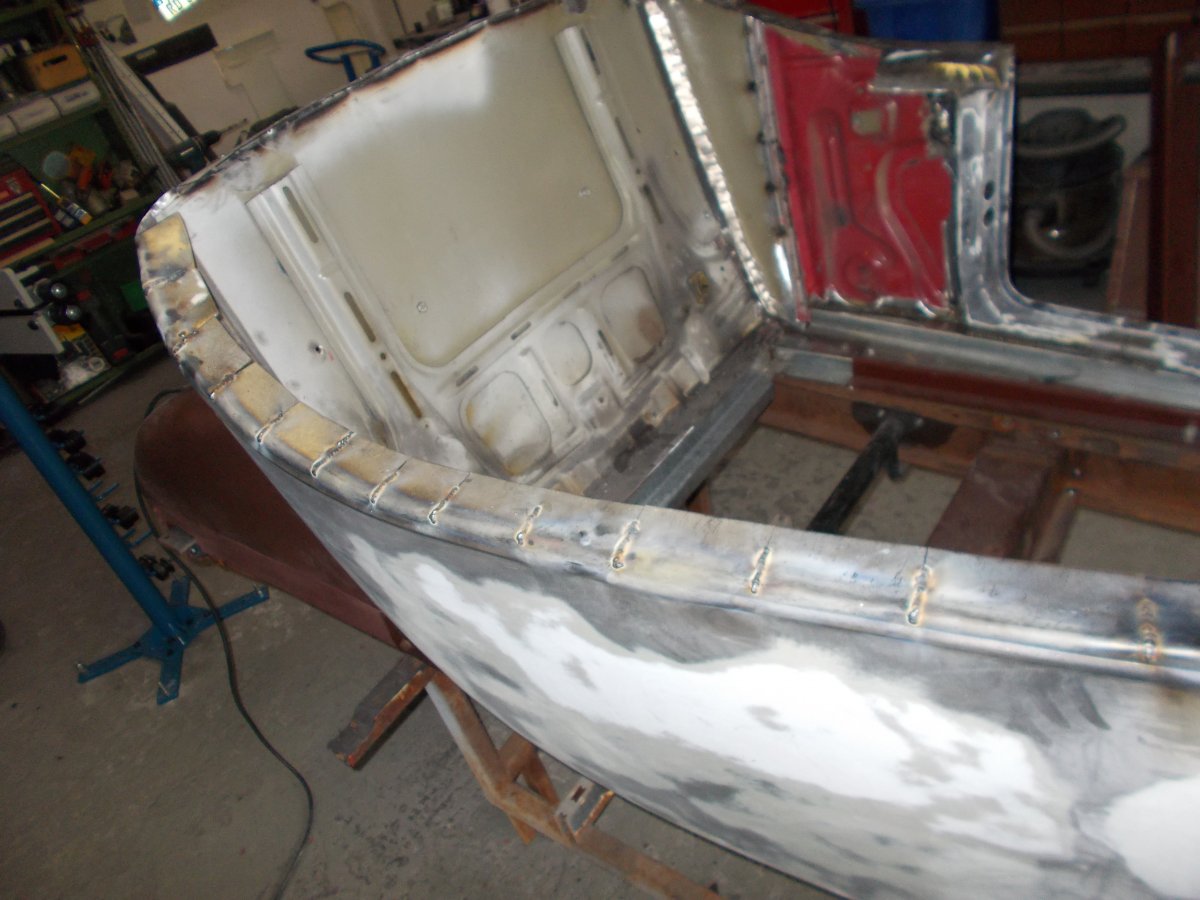

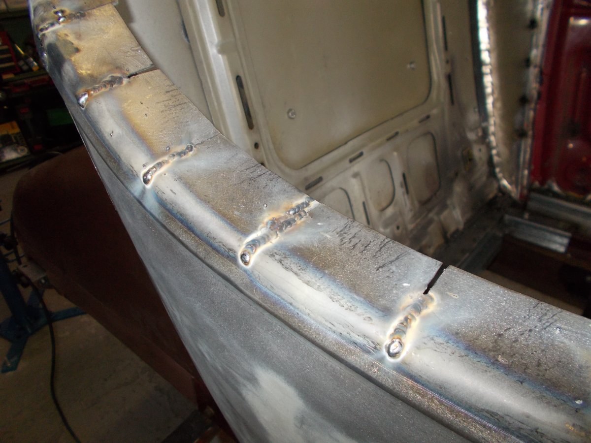

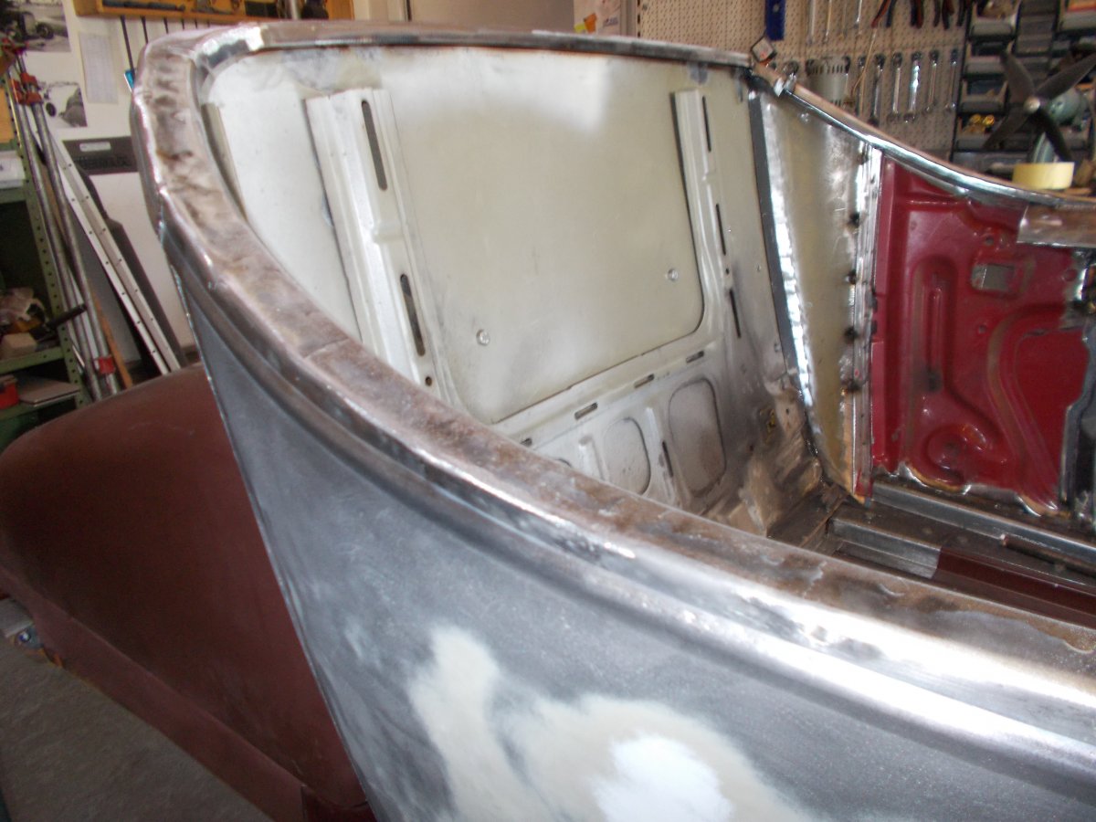

    So with the beading done I could finally weld up the tub. I spend the last two days doing that and rolling over the top edges. Also fitted the door skin. Still some detailing to do before filler.

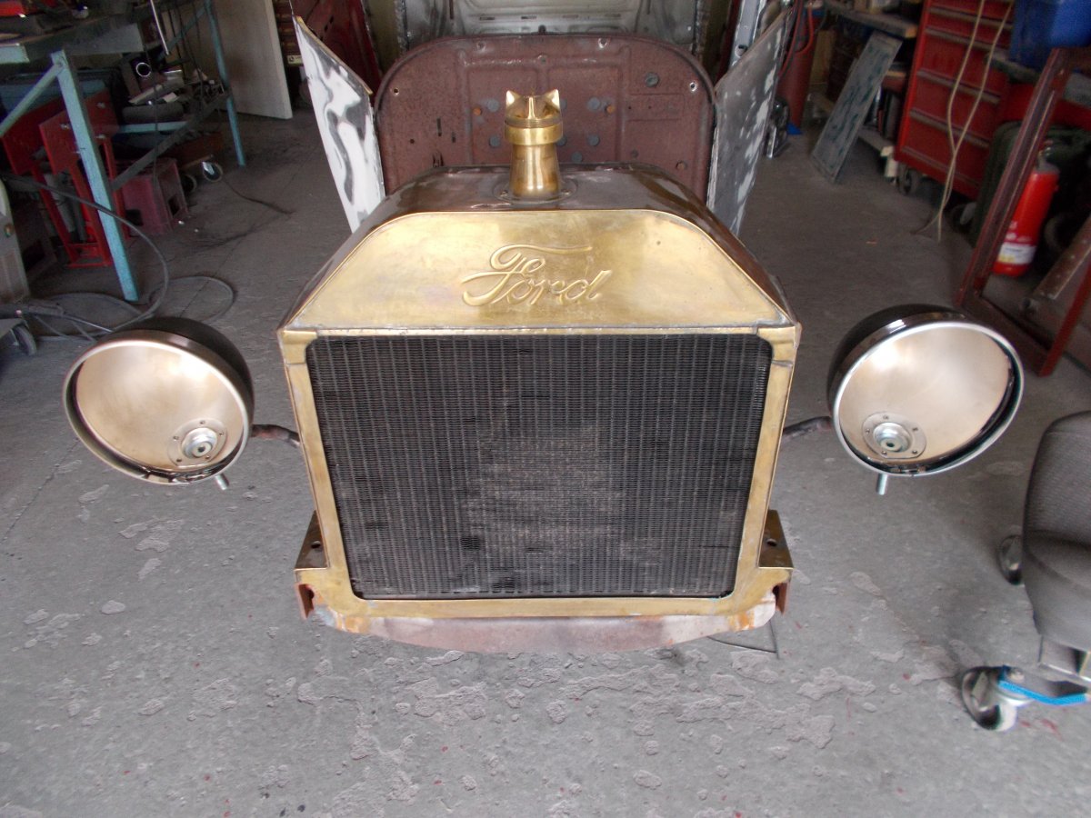

    Oh and I also fitted the headlights I made the stands out of an old Model-A headlight bar someone gave me recently.

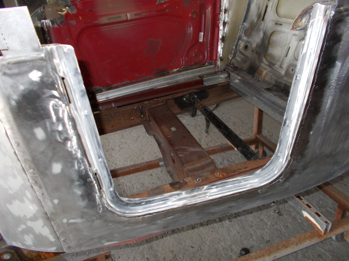

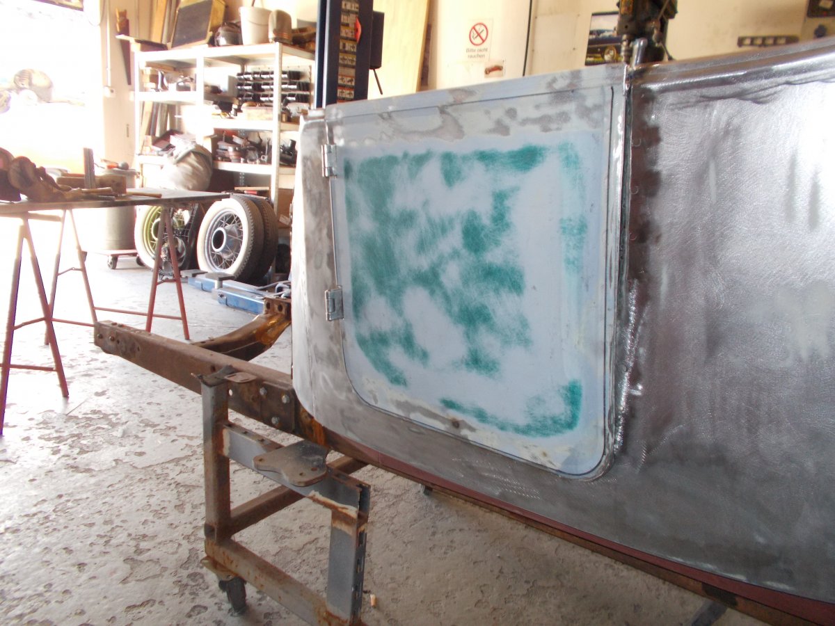

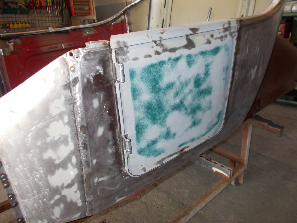

    On the drivers side, Model-Ts had a dummy door pressed into the side. Obviously due to the size of this panel, and the internal bracing I wasn't able to put the beading into the panel so I beaded an extra piece of metal and trimmed it down exactly to the edge of the bead. I then drilled holes into the panel just in from the beads in order that I could spot weld it in place. It was attached in place with those tiny nuts and bolts I used earlier. Again I can't stress enough - when using metal from modern vehicles you have to clean off all traces of the zinc coating where you want to weld. When you're cleaning off the zinc with a flap wheel you can see it disappearing. The zinc is a mat color, the steel underneath is shiny. Then I filled the inside of the bead with windshield glue and then bolted it in place. Where I couldn't use nuts and bolts to attach it I used self tapping screws. I left the glue overnight to cure and then welded it on the next day including the holes from the nuts and bolts. After grinding I used flexible filler to blend it in.

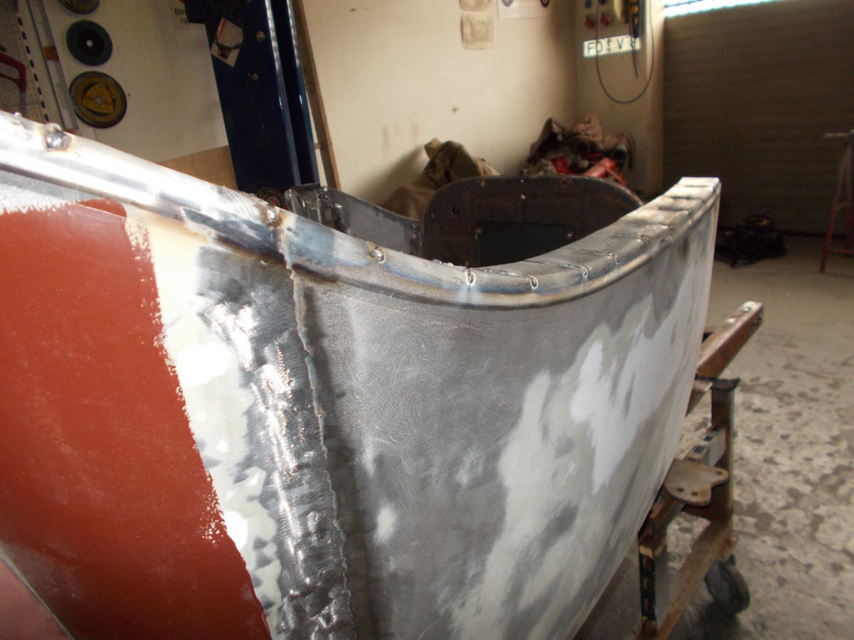

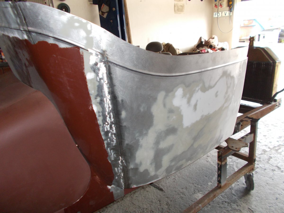

    Yesterday I removed the bucket from the subframe to do more detailing. The bucket actually has it's own subframe too so it's rigid and stable on it's own. The firewall is now welded in place so the whole bucket lifts off in one piece. I was surprised how light it was despite the heavy duty subframe I could easily pick it up on my own. I think that is due to the light weight of those modern hoods I used. And as you can pick up the whole trunk, including trunk lid, with one hand I reckon the entire body will be really light weight. Nevertheless everything is extremely stable now. Probably just as well it's light weight with just 40 hp.
    2 lbs of filler already used up. Another 1 lb on order.
    Now I'll be the first to admit that this body is taking up quite a few hours of work and wouldn't be possible if I was charging somebody an hourly rate. But a surprising number of people build T-buckets using fibergl*** bodies. In fact there are probably more fibergl*** T-buckets than steel ones. Anyone who has ever framed out a fibergl*** body knows how much work that is especially if you do a good job of it. The fibergl*** bodies aren't 100% accurate either so you may as well make your own body out of steel. The steel body I built isn't heavier than a framed out fibergl*** one. Possibly even lighter. All the internal strengthening in my body is the modern Ford factory bracing which is paper thin steel too and only has it's strength because of it's pressed shapes. Also I reckon I now have more side impact protection than I would in a framed out fibergl*** bucket. (I don't intend to put that theory to the test though).
    Add to that - working with steel is easier than fibergl***. No gluing, sanding fibergl*** and all that horrible stuff. Steel can be welded, ground down, bent to shape and filled with filler. And as I pointed out earlier, the 1990's bubble shaped car steel I've been using is the easiest to form I've ever had.

  27. Love this! How did you fold over the top of the tub? I see the slits of course but did you use a form of some sort of form to maintain consistency or are you just that good?!
  28. edwardlloyd
    Joined: Aug 2, 2003
    Posts: 2,074
    edwardlloyd
    from Germany
    I made a dolly with a bump on it which just fitted into the beading. Actually it was a two man job. I applied heat to the fold area and my buddy held the dolly in place and knocked the top over. We tried it cold but found we were distorting the beading. The inside return edge was made with that 1/2" L profile steel which I've used extensively in the build. It really stiffens up edges and is easy to bend using Eastwood's shrinker and stretcher. Three lengths were used, left, right and rear with two fillet pieces in the corners.
