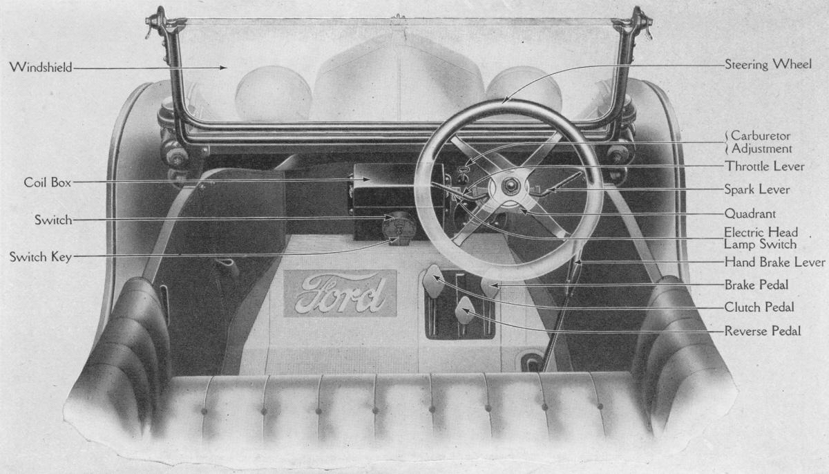

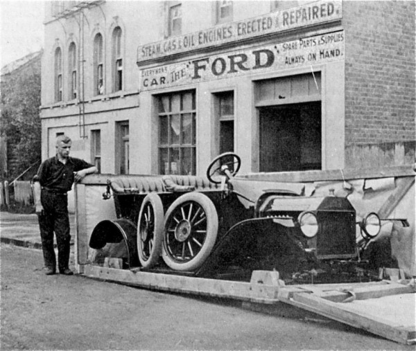

    Model-Ts were built at Trafford Park in Manchester, UK. Also RHD cars were built in Canada for the world market. The picture of the knocked down Canadian export model appears to have a door on the right. In the illustration there's only one door on the left. The photograph of the UK car in a barn has a door on the left hand side. So I reckon I'm OK with my left hand door.
    In Europe only the UK and Ireland are RHD. Sweden was too until 1955. So German spec Model-Ts were just like the US versions. Model-Ts were very common in the UK and Ireland. I don't know how popular they were in Germany.
    I have an original Model-T cowl / dash. There's no point in fabricating them as they're complex, available on ebay for around $100 and easy to ship.
    Don't forget quite a few early American cars were built RHD. In fact it was Ford's decision to build his cars LHD which made that the norm back then. And it was probably because his cars were so small you couldn't get out of the left hand side anyway, so the driver still got out on the right, keeping his boots clean.
