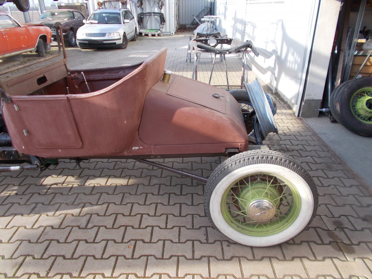

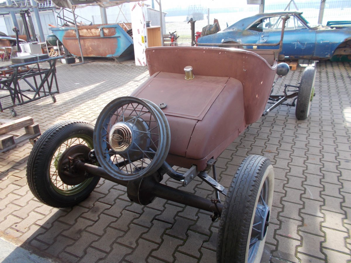

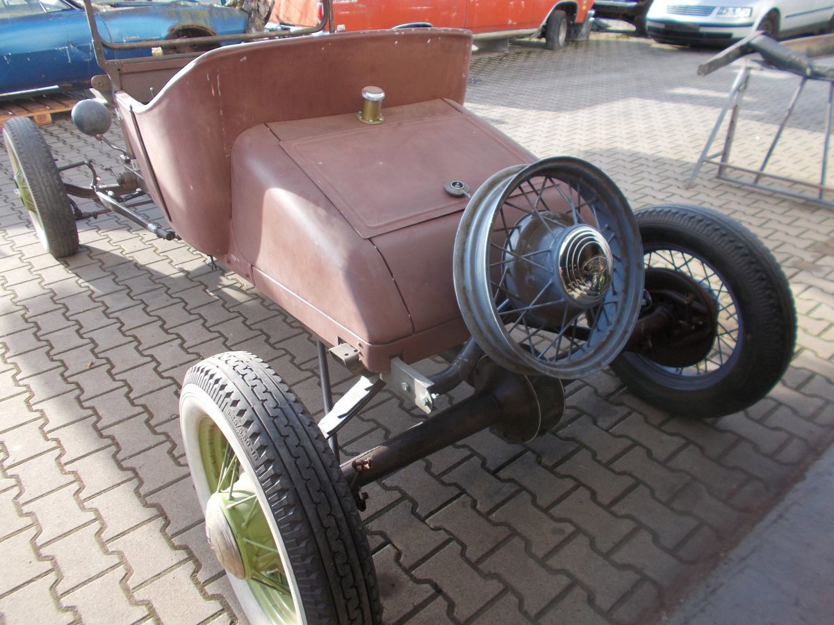

    Progress so far. I made a suicide front end using an original '32 heavy I-beam and split '32 'bones mounted to the side rails using tie rod ends and brackets made from 1946 Ford body mounts. I then moved the radiator forward above the axle which gives me room for a mechanical fan now. Brakes are '32 Ford and the rear axle is an early '32 mated to a Model-A torque tube. The bells have been reversed and I used a Model-A rear spring.
    Here's how it looks today.

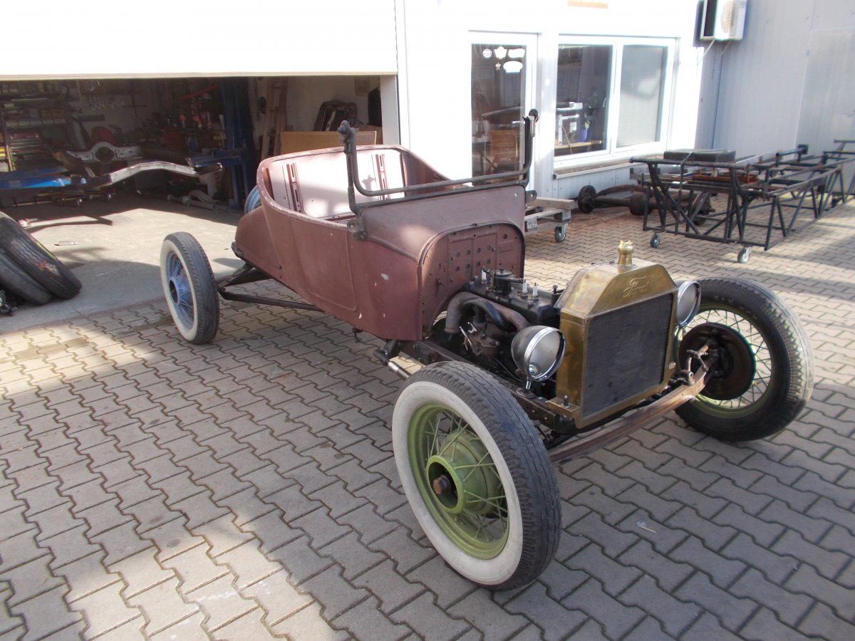

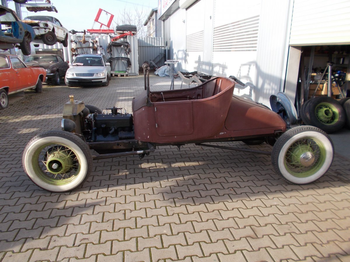

    Before and after pictures.
