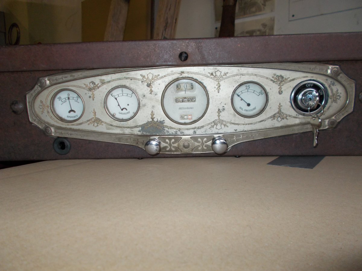

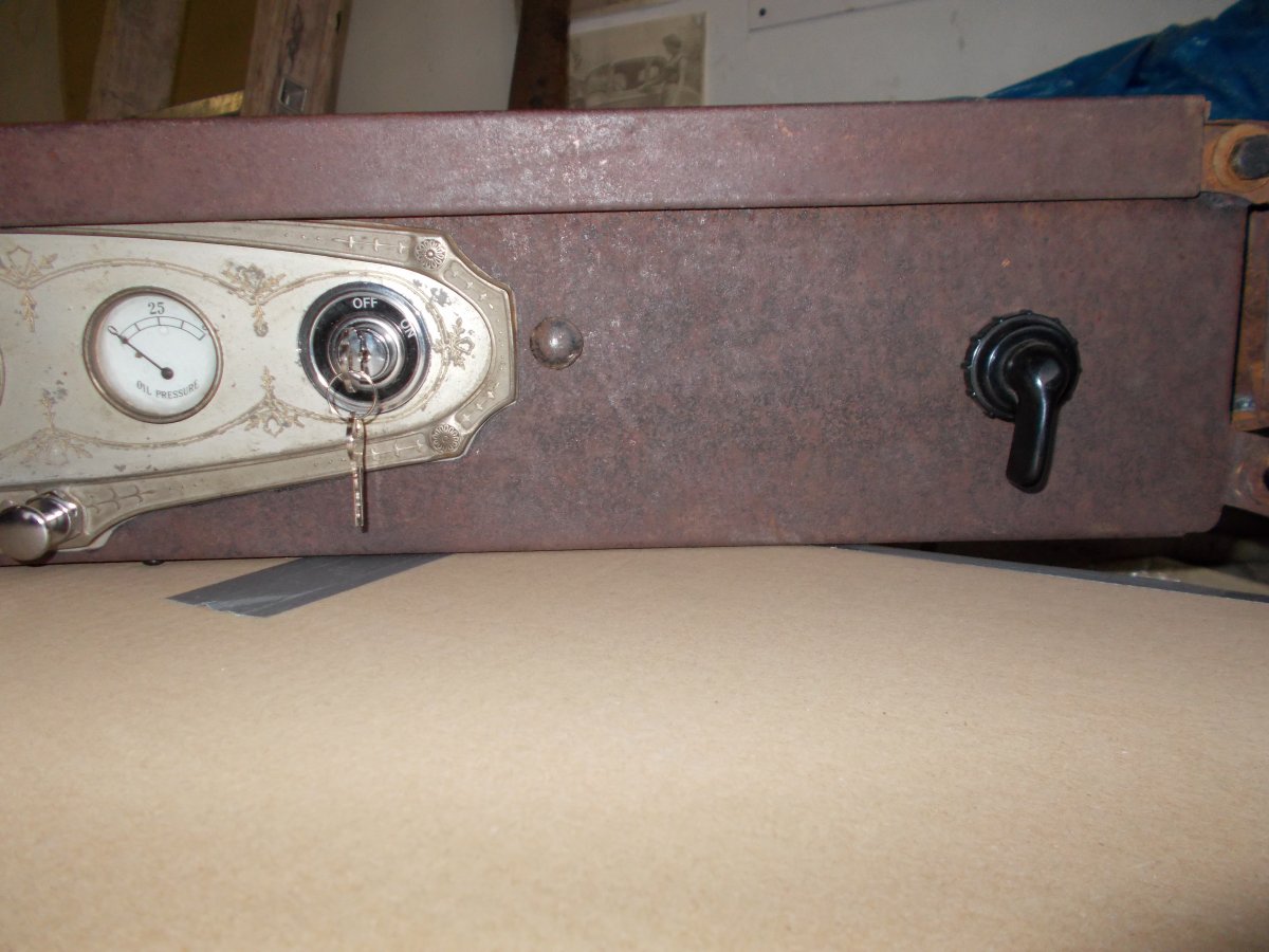

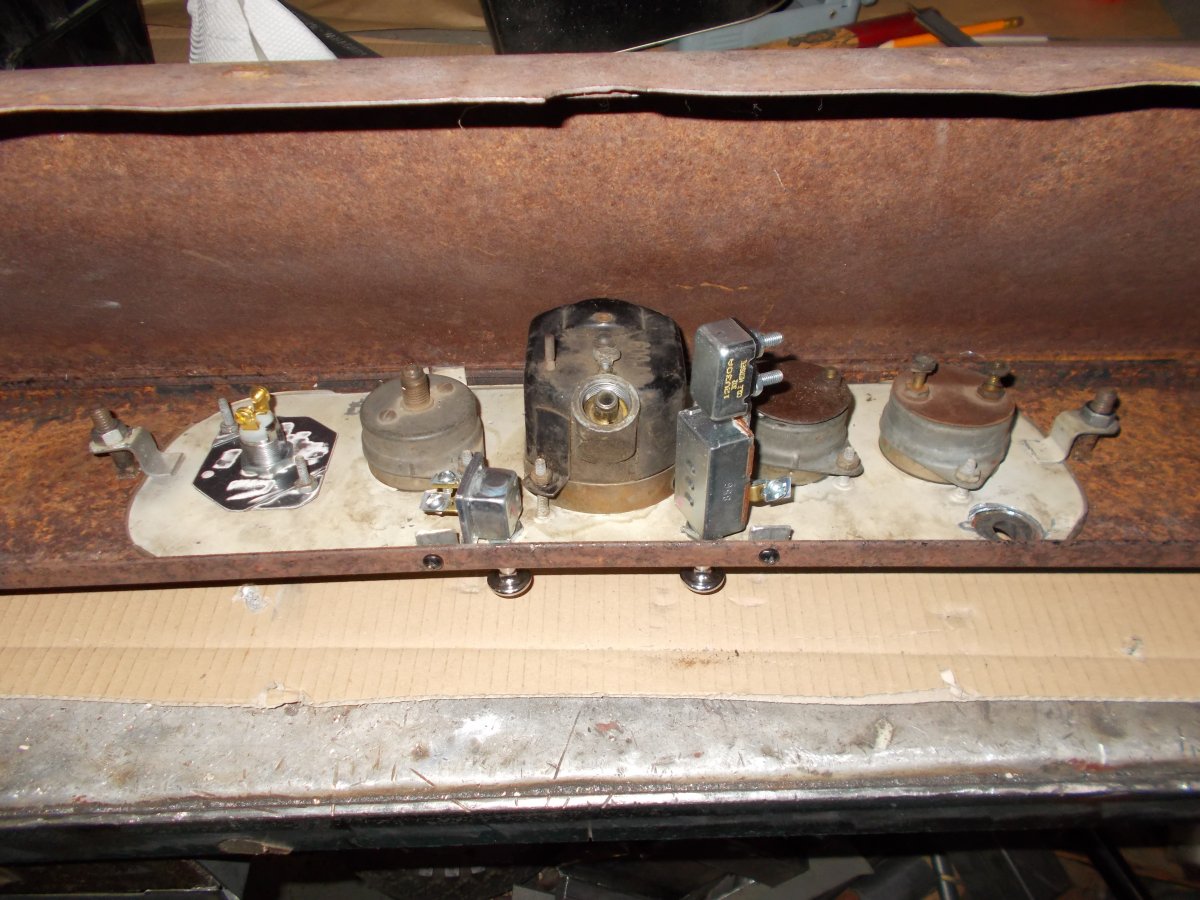

    Yesterday I fitted the 1929 Marmon dash insert into the Model-T dash. It was exactly the right height and clips in place. The top of the speedo just touches the cowl! It wasn't easy to install because it doesn't sit on top of the metal dash but inserts in from behind so I had to cut out the metal to the exact right shape. And as I wanted to preserve the original rusty dash metal it was a one shot attempt.
    I'm running with the original Marmon gauges and fitted a Model-A ignition switch in the right hand hole which is where Marmon put theirs.
    This is, I believe, the little piece which adds a little something unique to the car. I just love the looks of that dash now. I was so lucky to find this dash and it is just what the car needed.

    I would have been terrified trying to cut out that unique shape in the dash. You did a great job though, it looks excellent!
    It looks really stand out on an already neat car.

    Thanks Speedy. Yes I was nervous so I took my time.

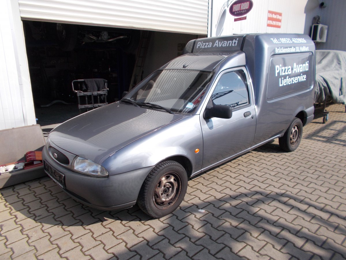

    Honestly I was a little worried what the end result was going to be when I saw your "donor car".
    Images of this kept popping into my head...
  17. edwardlloyd
    Joined: Aug 2, 2003
    Posts: 2,074
    edwardlloyd
    from Germany
    Give me some credit - please.

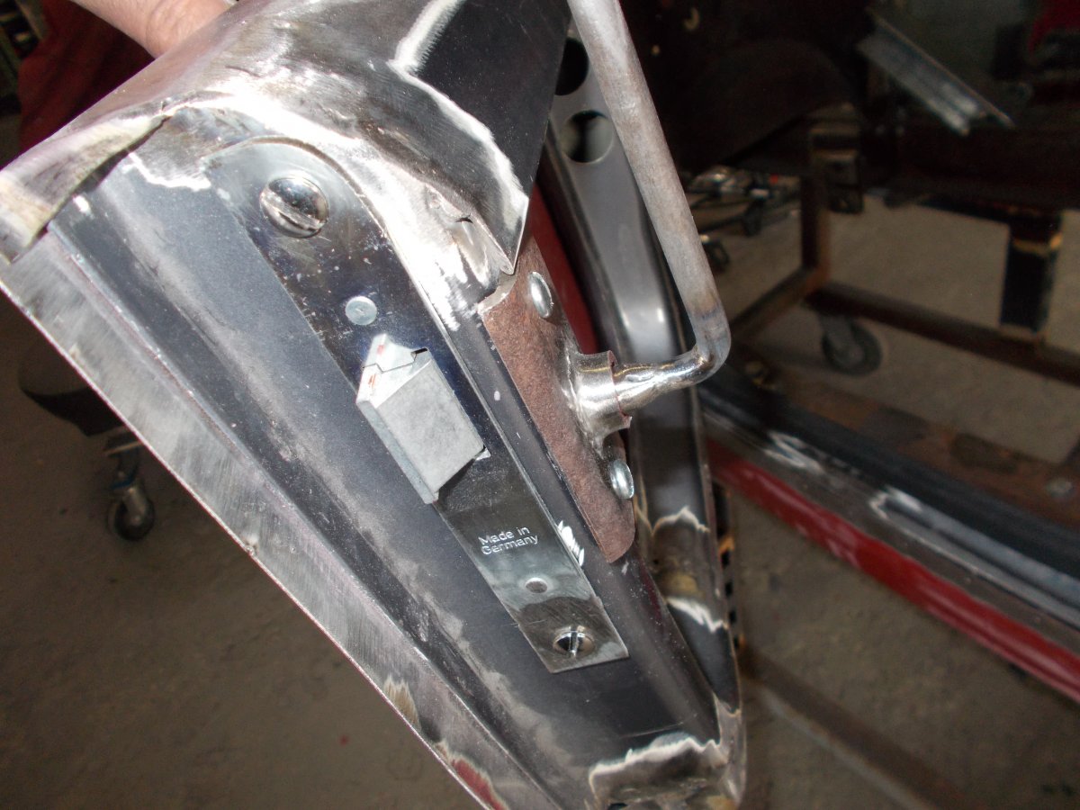

    Well reused parts.
    ... but a patriotic door latch, none the less! Great little detail! :D
