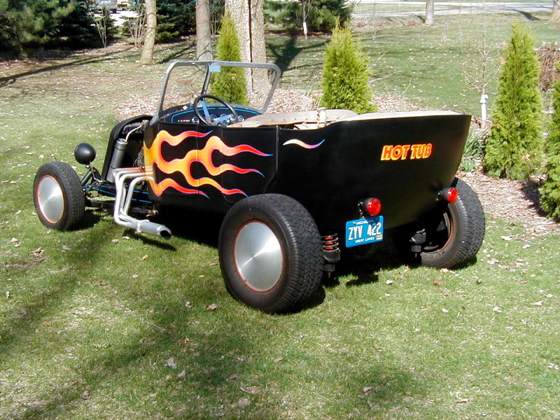

    Mine is suburban door skins, dodge truck hood, and original Ford cowl.
    sko_ford, Outback, brEad and 2 others like this.

  12. studebakerjoe
    Joined: Jul 7, 2015
    Posts: 1,176
    studebakerjoe
    Rab, is that one of the 94 and up Dodge hoods?
  13. rab71
    Joined: Jan 1, 2007
    Posts: 571
    rab71
    Yes it is. I cut it shorter and then sectioned it narrower.

  15. rab71
    Joined: Jan 1, 2007
    Posts: 571
    rab71
    I highly recommend planning for too much leg room[emoji6] I went off of model A measurement I found online. Then didn't take into account channeling and the back... I could use six more inches. (But who couldnt?[emoji1])
