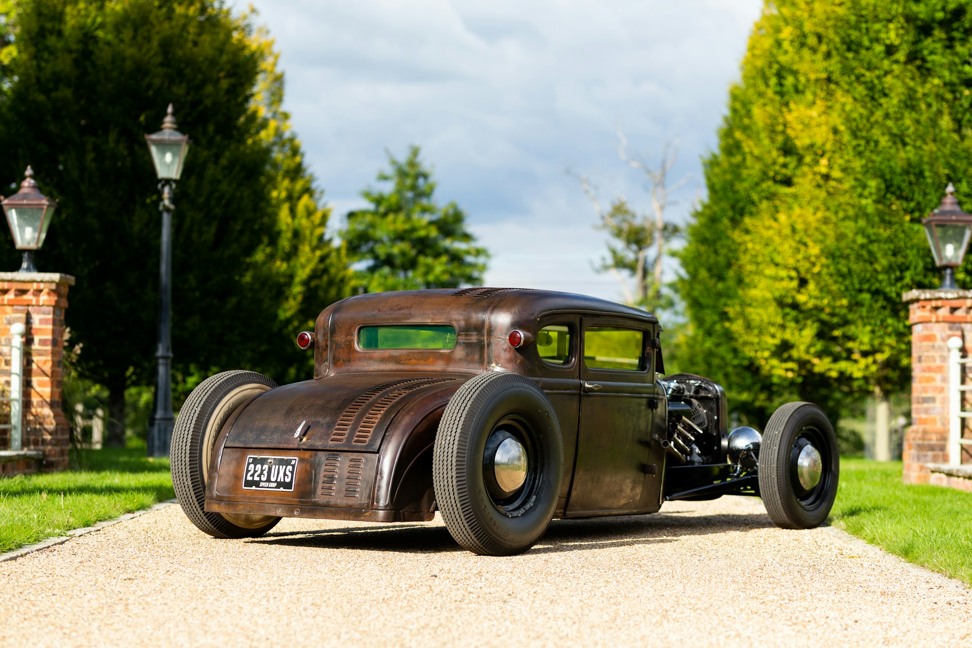

    I really dig the look of this one:

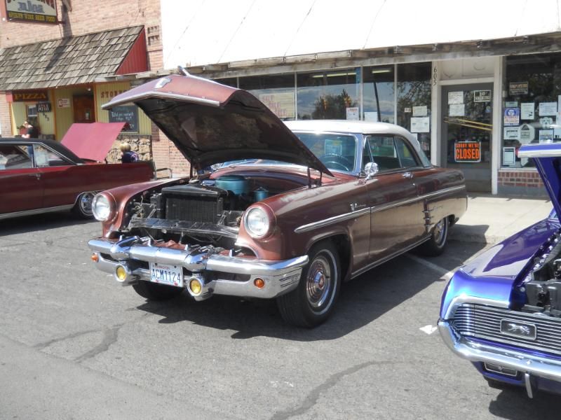

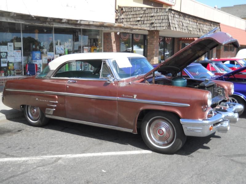

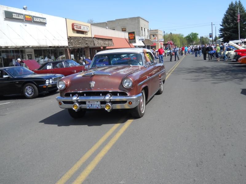

    On the other hand if I were to actually do fake patina the rig would go down to no damned rust, get primered with decent primer, then get Tractor supply or similar paint pretty well the same color as the primer and lay that on and scuff it and go over that with the same brand of paint in what might be an "original" color of choice. let that set up good and hard and then start "color sanding" areas where a tarp would rub if the rig was under a tarp and where natural wear such as the drivers door just under the window where your arm rides and over sand it until the different color starts to show through in spots.
    This Merc was a much loved car that belonged to one of my customers around 1990 who was scared to death to drive it because the gas gauge didn't work and kept it under a tarp in his yard. he couldn't grasp the concept of figure out how far you could go on a tank and fill it when you had driven half of that. Anyhow this is one of the best examples outside of what we saw in another thread of actual patina as far as a car goes. Well cared for and loved but you can see where the paint was worn though by the tarp and I have seen cars that were polished so often that the paint was worn though. A friend of mine painted the same car the same colors three times over a 35 year period because the owner's favorite pastime was polishing that car every week even though every six months would have been plenty.
