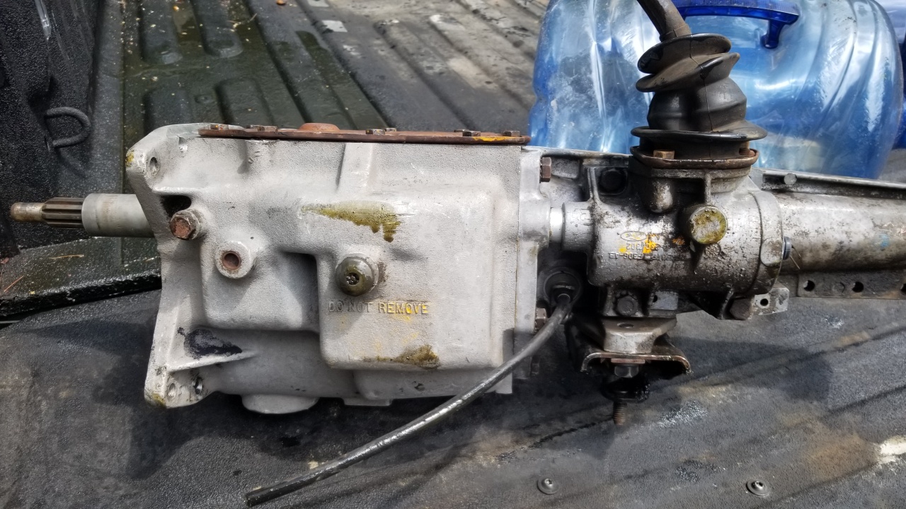

    I recently purchased a toploader for my '66 F100. The guy that sold it to me said that it was from a mid-late 80s pickup and that it was a 3spd with OD (so, 4spd with 4th being OD). The truck now has the original 3spd and I'd like to give it some better highway legs.

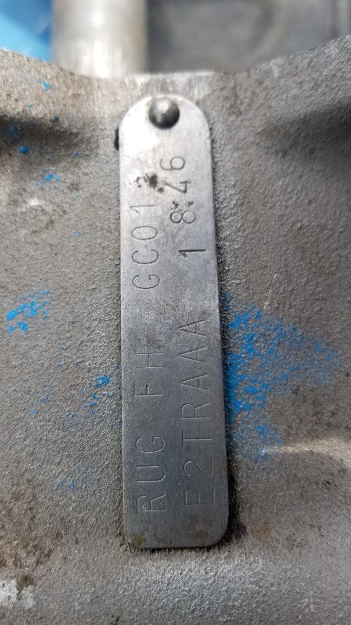

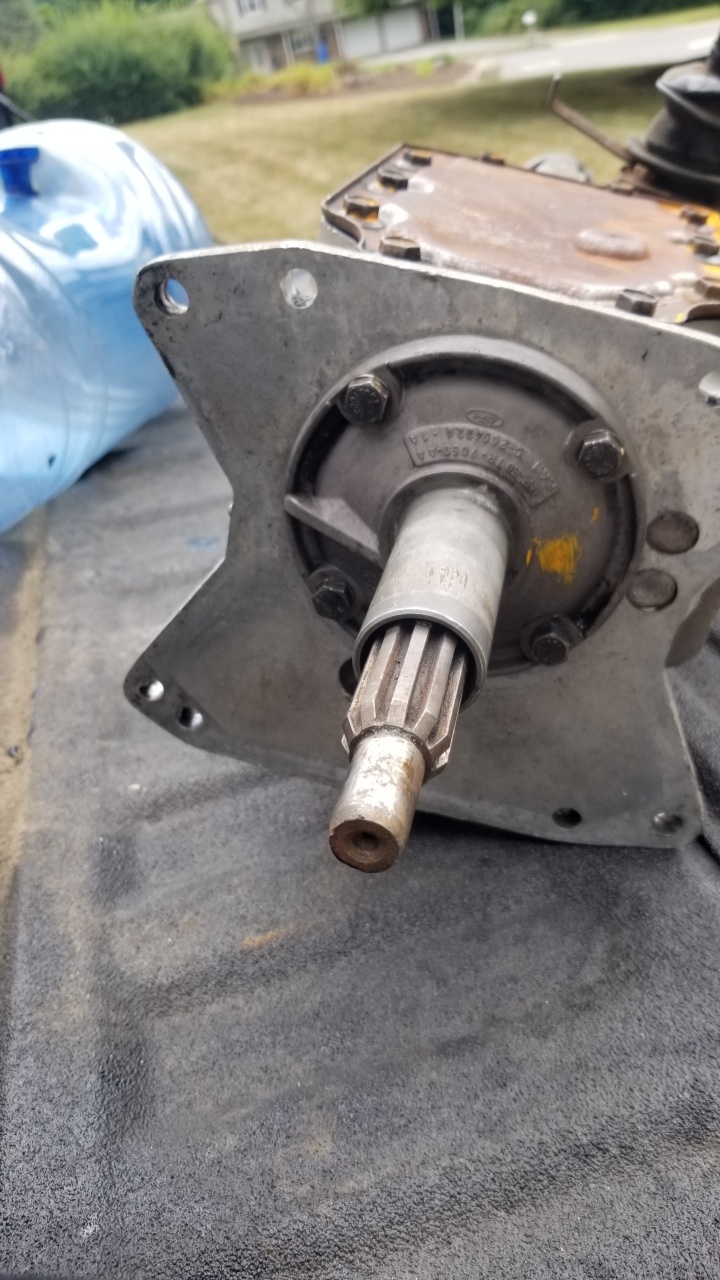

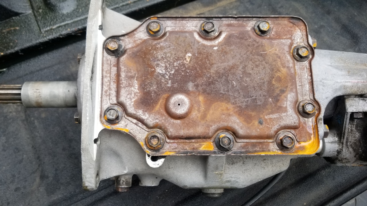

    I'd like to ID the transmission definitively before I start tearing things apart. Here's what I've got:
    The tag reads RUG FH GC01 (first line) E2T RAAA 1846 (2nd line)
    Aluminum case
    Internal linkage
    DS speedo cable
    10 spline input
    Input shaft 5 5/8"
    Can anyone tell me definitively what I've got?

    Do the input shaft dimensions match those of a stock factory 3 spd (ie. do I have to replace the clutch plate?
    Same question with the overall length (ie. will I have to have my driveshaft altered?)

  2. RUG SR-OD Single Rail 4 speed overdrive: 1978/83 F100/150; 1978/89 E100/250. Those from what I've read are ok for a stock motor. Any abuse or towing and they will give up, they where the predecessor to the T-170 rts TOD, that was much better.
    I have a T-170 and they look different.

    OT - Thanks. After the post, I continued digging and was able to ID the tranny as a SROD transmission. I'm aware that they're not the strongest box out there, but I'm hoping that it will live ok behind a stock 352 2bbl engine assuming I won't hammer on it, which I won't. The 352 is rated at 208hp/315 ft/lbs of torque.
    Does anyone know if the input shaft is the same length and spline count as the stock 3spd in the truck now?

  5. Input shaft length, diameter, and spline count is going to differ for the FE motor.
  6. The SROD was the weakest of the converted 4-speed ODs that Ford used in the late '70s/early 80s. If you're planning on any towing or hauling weight, DO NOT use the OD as the cluster gear bearings are the weak point on all of these, with the case flex inherent in the aluminum case version contributing a bit 'extra' to the problem. Ford specifically said to not use the OD under those conditions.
    It's not the HP, it's torque that kills them. Your 352 puts out more torque than the 300 sixes these were generally found behind. It IS direct bolt-in to a '65-up truck bellhousing.
