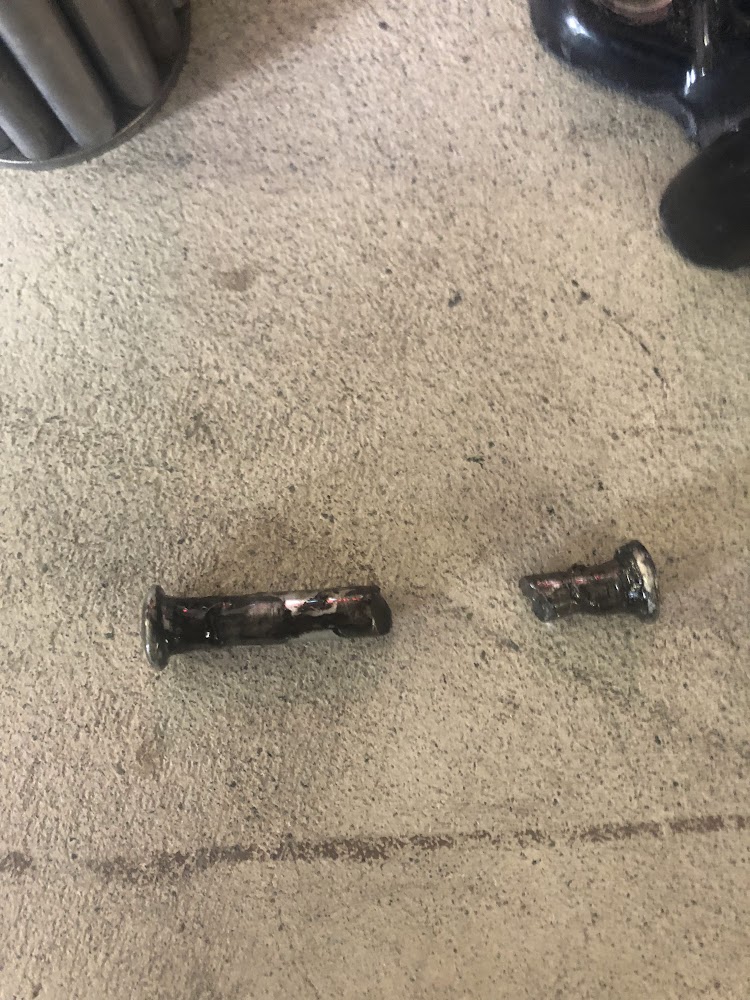

    We found out the drive line pin was also broken. It was missing a bearing also

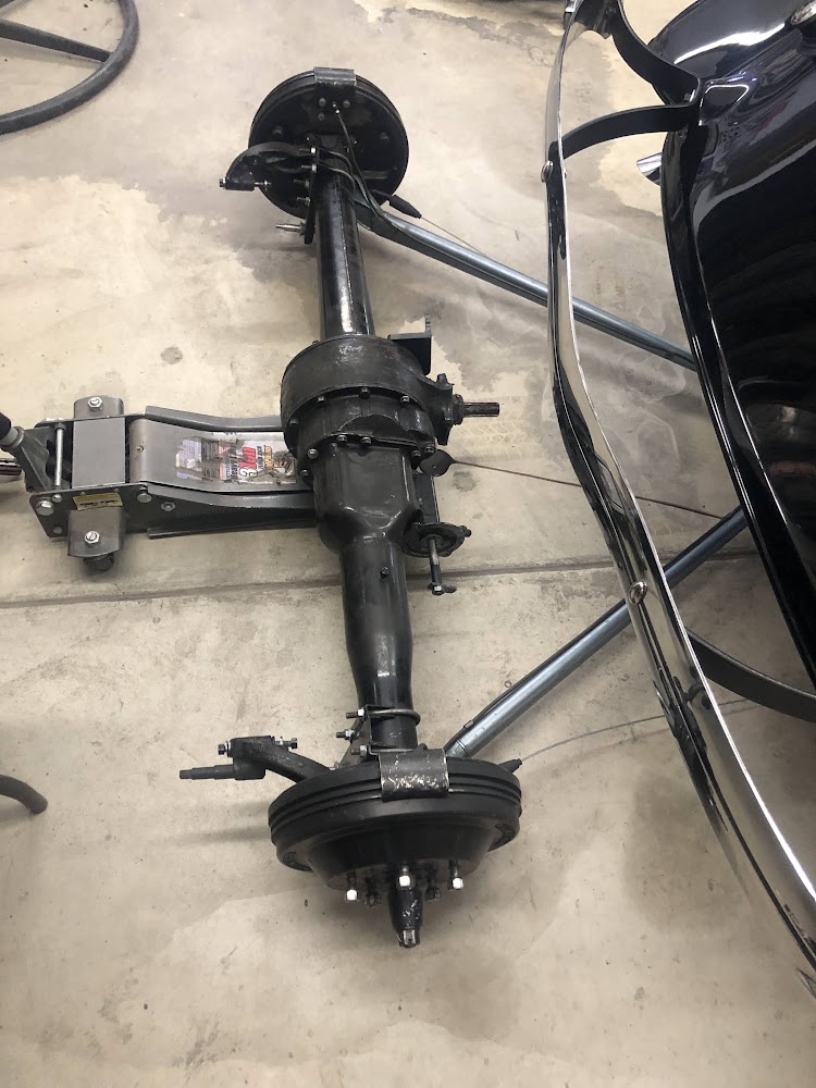

  7. Luckily I had a nice '34 rear axle ***embly I had gotten from a restored car that was doomed to be street rodded.

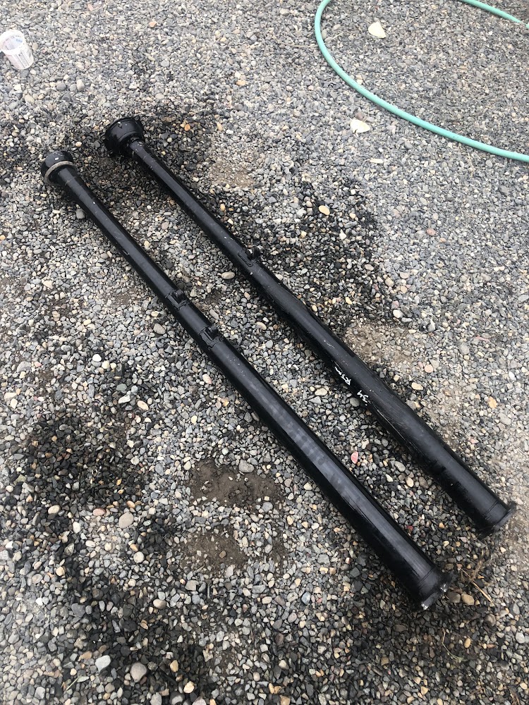

    You can see what had been done for a drive line. They shortened the later drive & used the '34 torque tube.

    I had a spring that I had the local spring shop (White Front) reverse for me for another project bur Scott needed it more than I did. Paired with some longer shackle it'd make the car sit like it should.

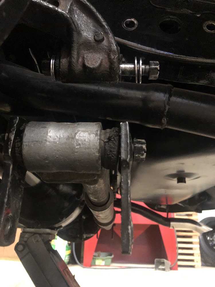

  25. I wont bore you with the re-plumb. We also did a new fuel line. It was all rubber hose. We then turned our attention to the shock mounts.
    We started with some F-1 mounts in the rear. The hole spacing was about right on.
    The fronts needed to be modified in order to clear the steering. I've done this on a few other cars & it's worked well.

    That’s a neat coincidence that the rear wishbone bolt spacing is the same as an F-1 shock mount. Nice solution.
