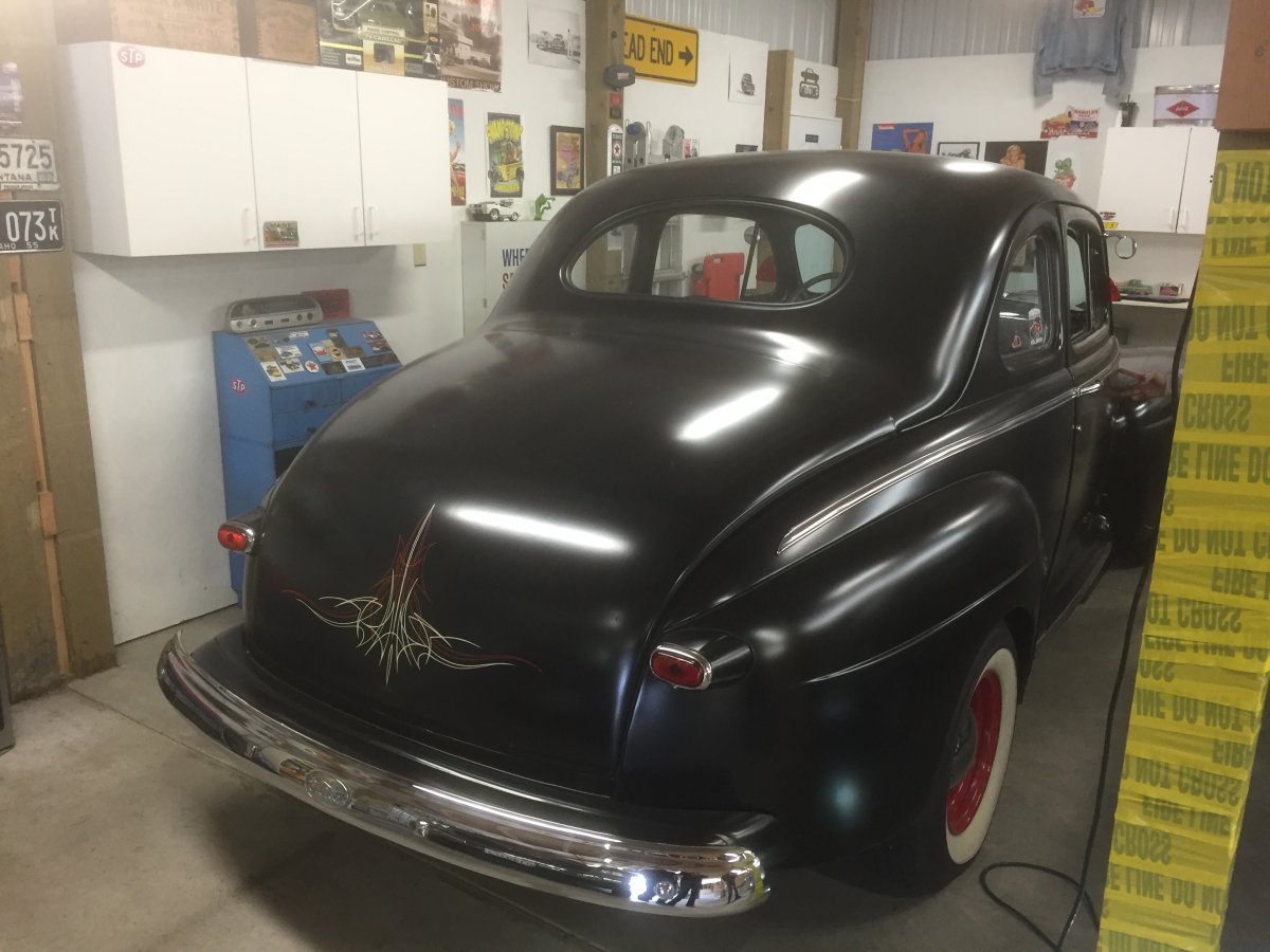

    I had a 1941 Ford club coupe project, but when I saw this 46 coupe advertised locally a few weeks ago I figured I should go look it. The seller told me over the phone it was a traditional Hotrod. He had no pics in his ad. This is what I saw when I walked in his garage.
    The paint, stickers, tires/wheels...ugh it needed help. It did run and drive, but the seller told me it needed a new engine, and thus why it was a pretty reasonable price. It had all stock running gear and aside from having some trim shaved, appeared to be a nice dry car. I was sure I could get it looking a lot better for not a lot of money, so we struck a deal and I brought it home. The car running/driving was the bonus as I wanted a car my family and I could enjoy sooner then later. I asked the seller where the front bumper was, and he replied "hotrods don't have front bumpers". Sure thing, man.
    First thing I did was pull the gross 14" wheels and white wall radials off and put some 16's on it. The drums had been redrilled to 5x4.5" bolt pattern, so this meant I had to clean up another set of drums and rebuilt all the hydraulics on the brakes and packed wheel bearings while I was at it
    Then, I removed the seats and swapped them with the freshly s***ched seats I had for the other coupe. The seats in the 46 were nice, but not my style. I also peeled all the stickers off and put a stock steering wheel back in it.
    The car has been painted "Hotrod flatz" which is a single stage enamel with a flatning agent. My car painter friend Dusty came over and looked at it, telling me you can wet sand and buff the flatz paint. We tried an area just above be p***enger side headlight. Now I get to do the whole car!
    And yesterday I figured out why it was running bad. I think he had an externally resisted coil, with no resister, and it burned up the points and condenser. The coil is not marked anywhere, so I replaced it with a internally resisted coil and a fresh distributor I had. It now runs like a watch. It had a rechromed rear bumper, and I picked up a rechromed front bumper at the Monroe swap meet a couple weeks back, and found a nice front gravel pan on Craigslist. I installed those and it really looks better.
