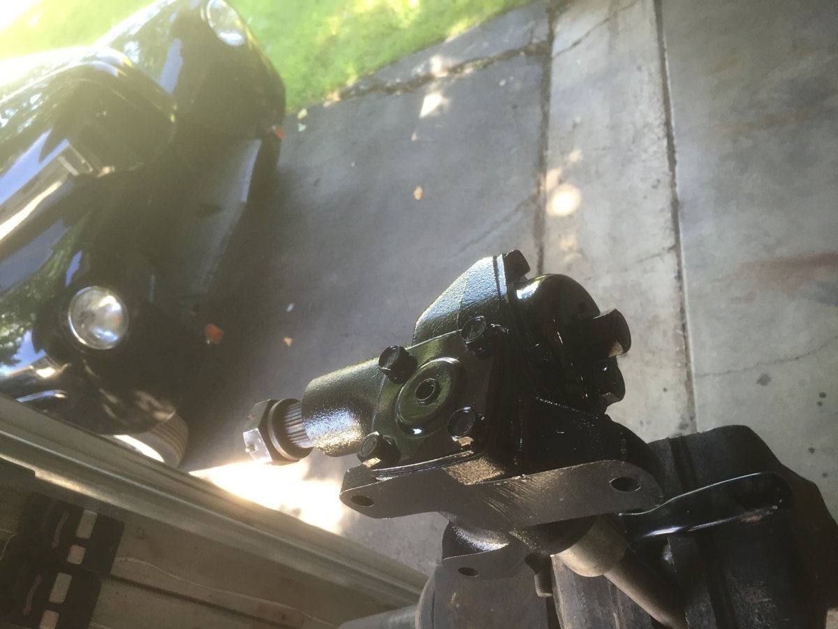

    I’ve just picked up my first 46 ford and it has a decent amount of play in the steering so exactly how easy is the rebuild any more details on it ?
    509garyd likes this.
  6. Chris
    Joined: Jan 5, 2005
    Posts: 14,500
    Chris
    If you replace the worn/bad parts, putting it together and adjusting it is really easy. There is an upper and lower bearing/race, work gear and sector which all must be looked at to see if they are good or bad. Sectors can be spendy but fit a lot of years of Ford cars and 1/2 ton trucks, worm gears need to be pressed on and off the steering shaft. bearings and aces are cheap and easy.
    I'd pop it apart and clean everything and go from there. You will also need a gasket/shim kit.
