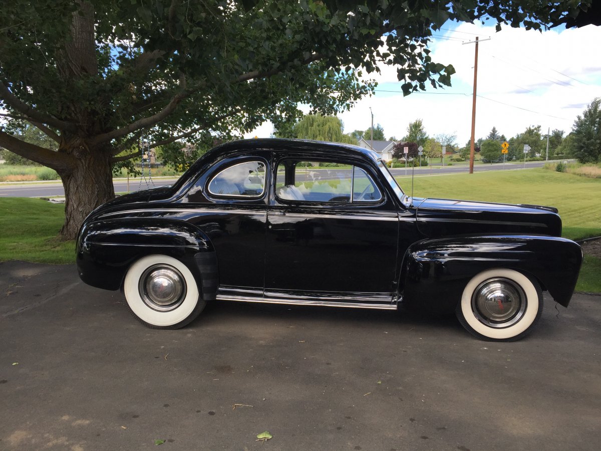

    Great work on the deuglying the previous owners misguided ways. The car looks great and will become a great family cruiser .

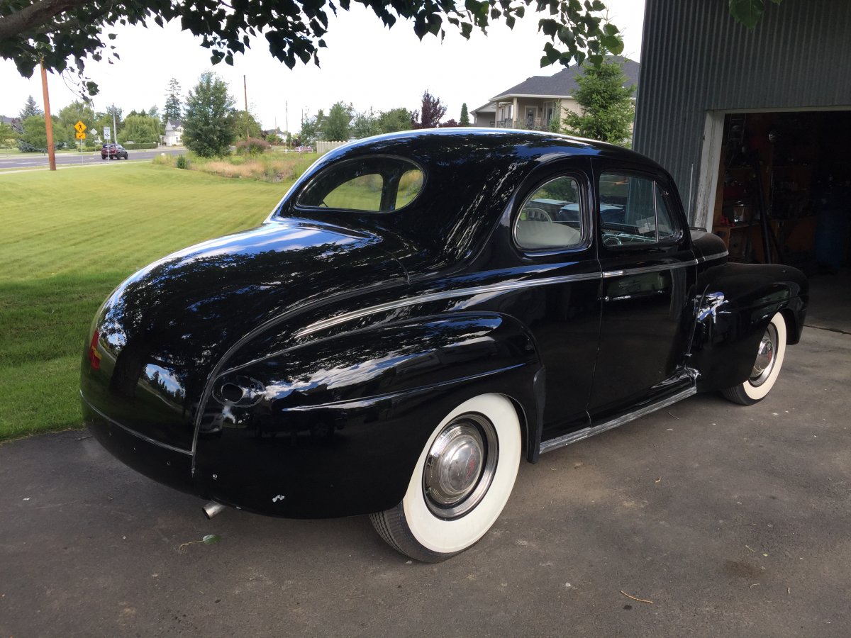

    It should. We wet sanded it with 1500, then 2000 and finished with 3,000. We buffed it with a rubbing compound, then # 2 followed by #3 Meguires. It was a lot of work, but well worth it

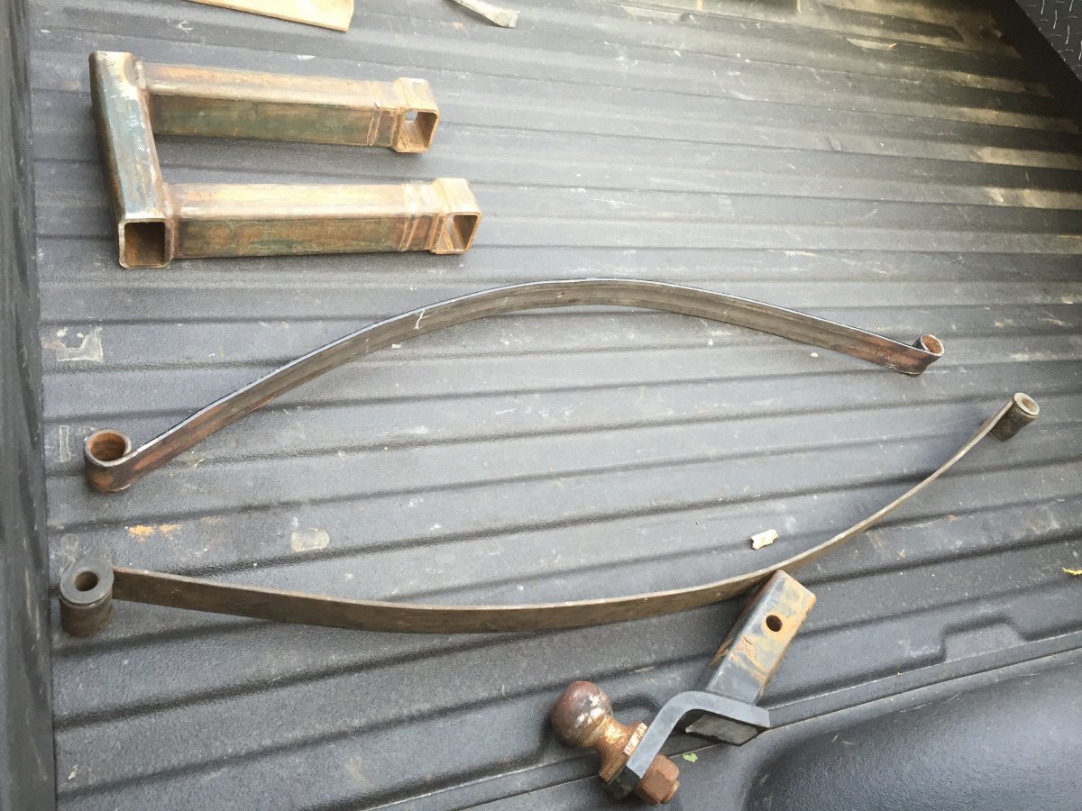

    Over the weekend I pulled both front and rear springs and reversed the main leaves. It has longer shackles in the front and I put a set on the rear as well. Put it together and it already looks a lot better. The car will get that dropped axle soon enough, as well

    I made one of those bucks after reading loudpedals how to as well. It works great. Looks like you had to extend yours a little. Different bottle jack???
  17. Chris
    Joined: Jan 5, 2005
    Posts: 14,500
    Chris
    Yes, it's been raised to fit a different jack. I could not use this jig, the spring eyes on these late springs were too big for the square tubing on the jig, so I used my dads press instead. Same idea...

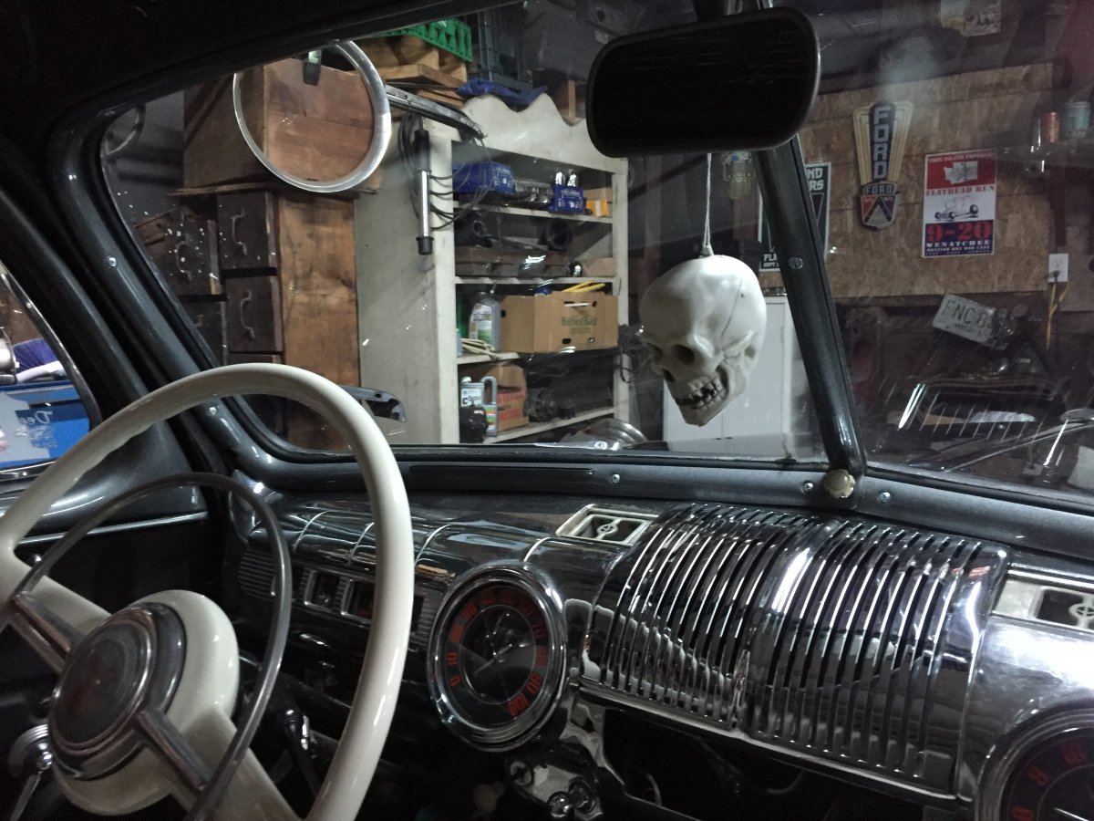

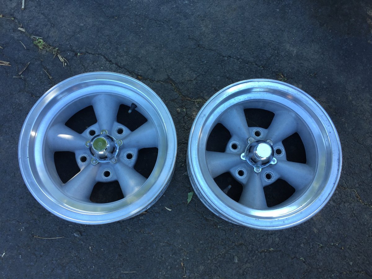

    I picked thes up from a member on here and they arrived yesterday. Very nice pair of 15x6 Americans in big Ford pattern. Now all I need is a set of 15x4's for the front. I want these to be able to run on the roadster or this 46 time to time. They will especially fit the 46 well when it gets that 283 ;)
  21. Baumi
    Joined: Jan 28, 2003
    Posts: 3,361
    Baumi
    Holy ****! That ´s lookin pretty shine for a flat black car! Very well done, I love the new dash too!

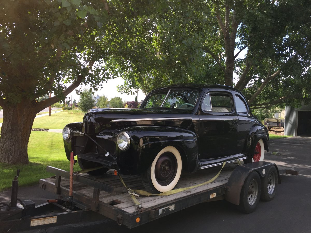

    Loaded it up and took it to Dustys paint shop last night. Hope to be putting it together soon. It was nice to see it out of my driveway. Don't mind the hood gap, I need to correct that

    Joined: Jul 10, 2006
    Posts: 9,036
    belair
    You really pulled that one back from the brink.
