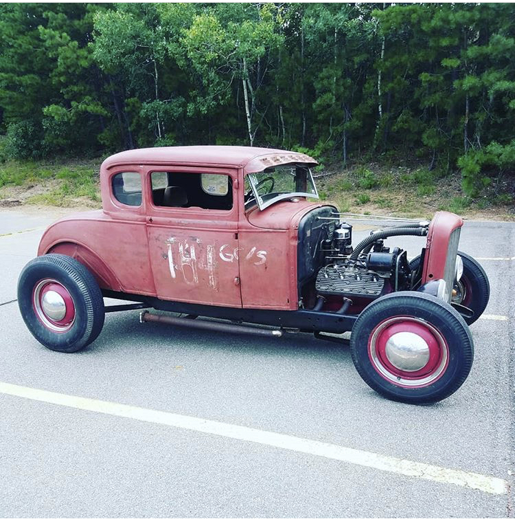

    Here’s a shot of @NoSurf coupe on AA rails and a bump to the top 0EF0DB36-884E-4F90-8EAC-7CEA9F39B109.jpeg @MrModelT maybe you have some incite to this?

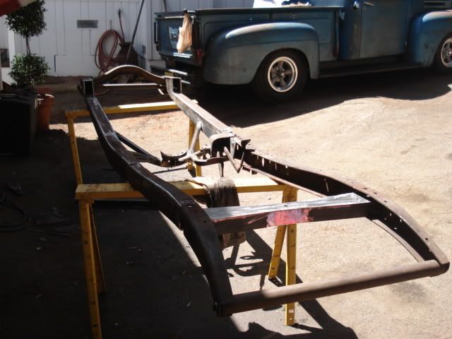

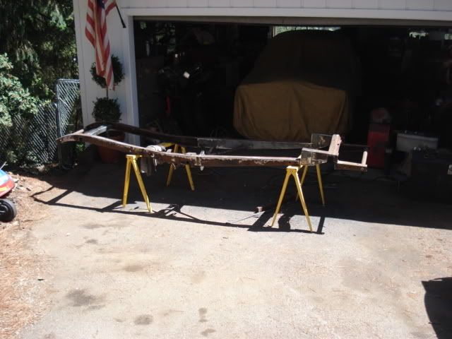

    Here's some shots of an AA and BB frame combined. It took some work but the two together made for a pretty neat side profile. They were cast offs and s**** pieces, I was unemployed so we made a good time out of it......
    This little Farts 17 now and workin' on his own stuff.

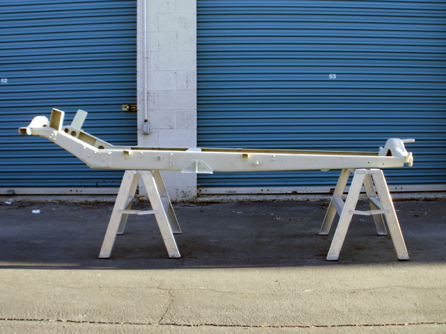

    Best I can do, right now. This is after it was chopped up, shortened, modified for A running gear, etc. That taper of the TT rails is one of my favorites but it's so dang heavy. Not as heavy as my current A ch***is... but it's no little T lightweight.
    I should get this roller mocked together, again.
