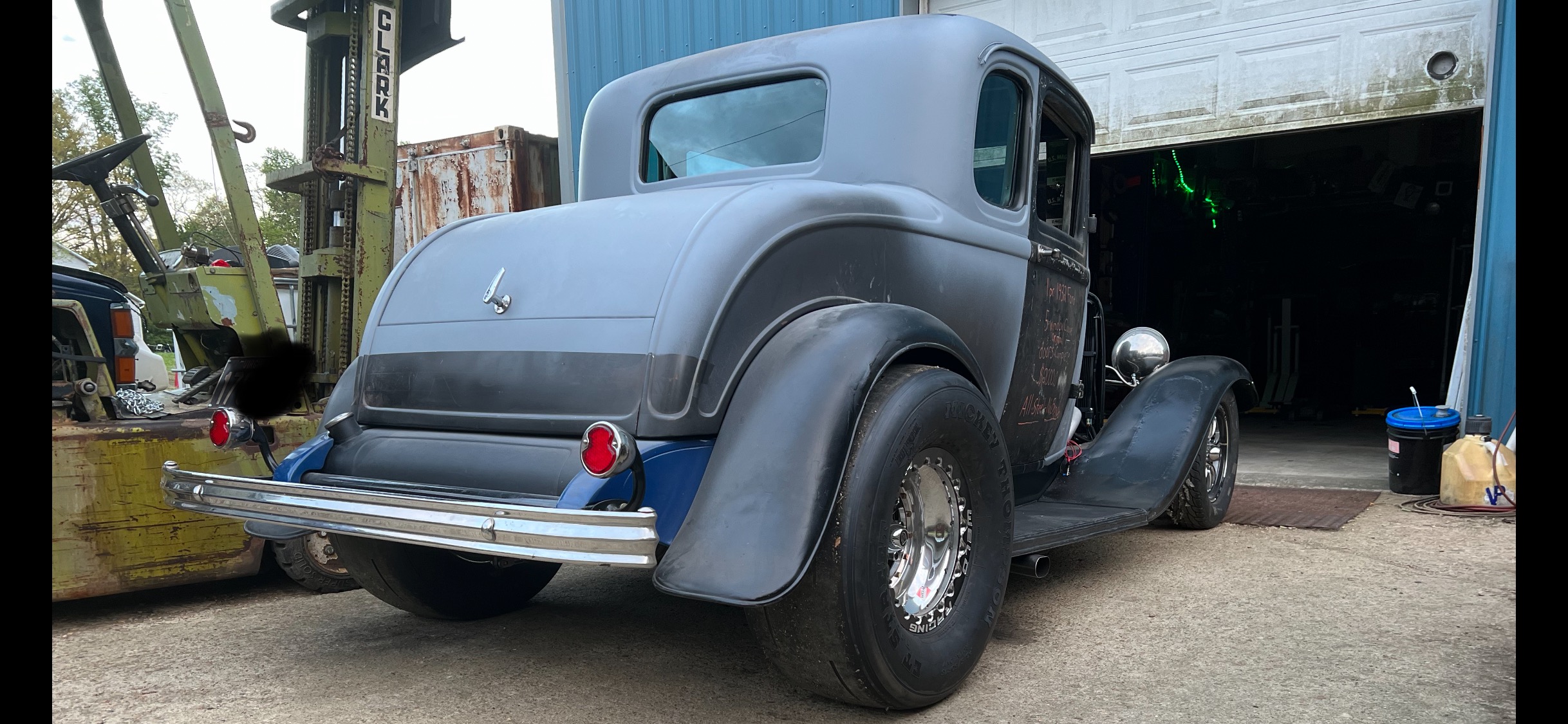

    Looking for information or pictures from anyone who has widened the wheel wells on a 32 Ford, and any tips on the problems they encountered.

    I know some about, really no different then tubbing any other , fabrication and thought.
    The 5w went over 155 mph as seen in pic back around 91 , No cage on
    Mc Corey's
    Bottom 3w chopped & channeled.

    While I didn't ask for pro-street, just widening some, I guess I should expect some really wide tire pics in the replys. Thanks for moving it..........
    Personally I like the pro street too, but what I'm looking for is info about how they dealt with the width of the rear fender as well as making a tub inside. I don't think moving the stock inner wheel well will be a problem, though it may affect some other things....like putting a gas tank in the trunk......but just not sure if the fender will need modification as well. Anyway, ALL pictures of this kind of modification are welcome on this thread.:)

    315 with no mods to fender or frame
