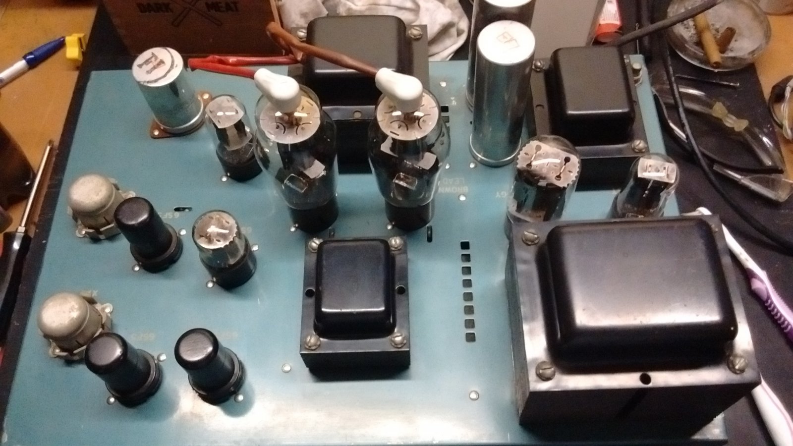

    So I just removed it. Dang thing weighs 10lbs.! I think the front of the car went up 1/2". So what's next? I guess I should at least put some juice to it. There's the two yellow and gray wires coming out of the radio, and two wires coming out of the transformer (?) on the tube unit. Would those be speaker?

    The larger of the 2 transformers is the power transformer, the smaller upright mounted one is the output transformer, the gray wires coming from that are the speaker wires.
    You did read @Truck64 's comment about rebuilding the power supply before trying to fire it up, right? If those electrolytics are dried out, and they probably are, you might get a big flash when you plug it in. Or, you might just get a loud hum. It's usually best to replace the caps first before applying power to an old amp that's been sitting for years. Some guys try to "reform" them by bringing them up slowly with a variac. I've never attempted it, I just replace them.

    So that would be the brown ones and the one big silver one? 20211018_112218[1].jpg

    Yes, the brown ones should have the value printed on the case somewhere, the metal can will have probably 3 - 4 caps inside of it and the values (capacitance & voltage) should be stamped on the case. The individual caps are fairly easy to find, a multi-cap can with all of the correct values is harder to find, but you can use individual caps in place of it. I've even gotten creative and opened up & gutted the can and stuffed with new caps of the correct values when I wanted to maintain the appearance.
