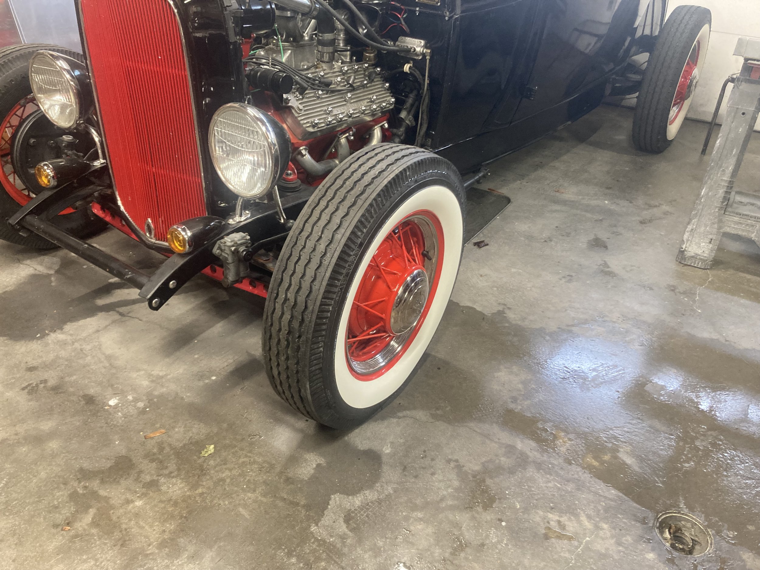

    I ran tubeless radials on stock 35 Ford welded spoke wheels.Regarding the Kelsey you might need to use a sealer where the spoke goes thru the outer band or rim. Make sure no deep pitting on the inner lip of the rim. Mine were pitted so had to take a disc sander to smooth them out.I then had them powder coated black. 33 front wheel:Nankang tire.jpg
