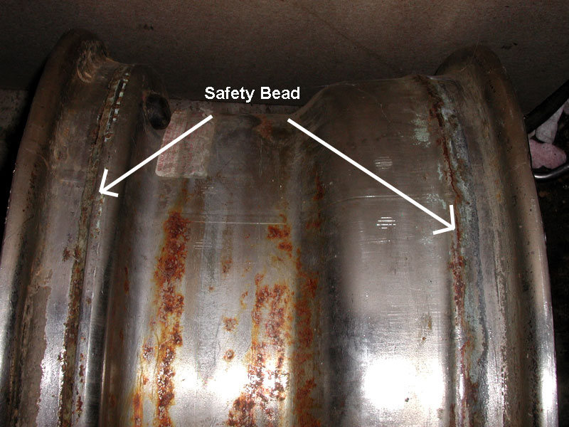

    Most 16" wheels do not have a safety bead, so it's a good idea to use tubes. If the tire goes flat, it will roll right off the rim, tubes slow down that process.

    Do your smoothie wheels have these beads inside the drop center?
    If so, You can mount them tubeless, but I would check with Coker on the Excelsior's.

    Here is the story... I talked to Coker's Tenn. office about this.. The Firestones are made from old molds that still say tube type.. They can run on a new wheel,, IE smoothie etc.. with no tube.. 16's have a safety bead on them... Jason.
