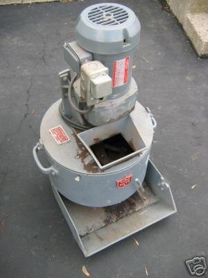

    The foundry I have is called a Mini Mite and unfortunately I don’t think this company survived Covid. You might be able to find one used.
    You can make them or buy one with a crucible off the interweb- I don’t have any experience with any outside of the one we made from scratch and this mini mite.

    My muller is also a Mini Mite. I found it on Craigslist years ago and had to fetch it from a few states away.
    Industrial auction sites might be a good place to look for one although there are videos out there on how to build your own.
