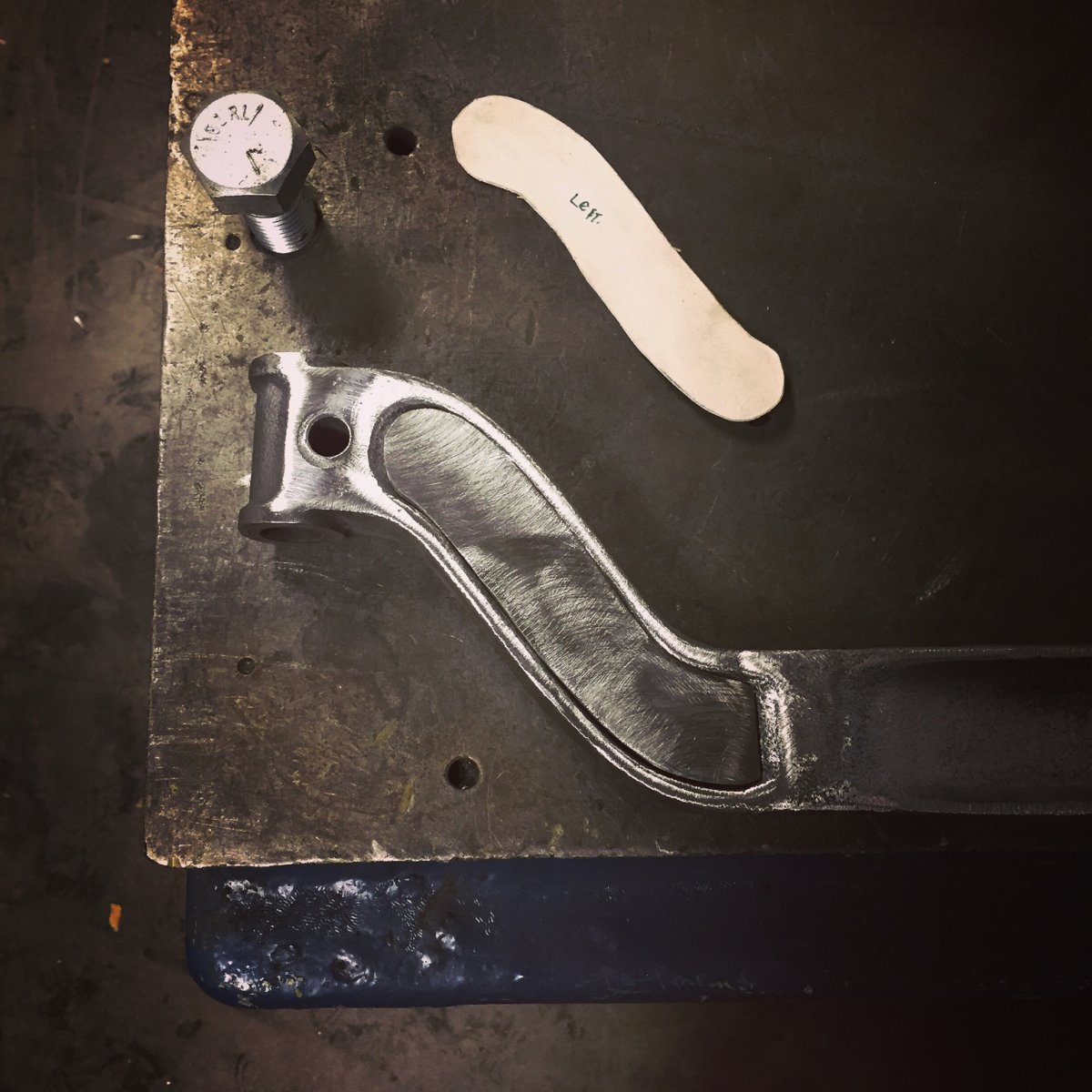

    Miles of welding today... a bit of filing and grinding and a list of supplies to order like sand paper, belts for the small hand held belt grinder-
    heads up to anyone wanting to chrome bones- when you grind off the weld you need to weld it again- the weld is mostly external so if don't weld them they'll split, I usually cut it open at the seam a couple inches tack tack and cut a couple more and tack tack again- otherwise they'll end up wavy.
    There is usually a lot of corrosion in these seams so it sometimes helps to blast the open seam- other than that there is not a whole lot you can do about it-
    I finished the welding on the other side of the axle too and started to fill divots etc- not going to get too crazy on the axle just jet most of this type of stuff I can do in the garage at home after school starts.
    Both of the bones are pretty much identical- and the shock pockets are pretty much mirrored on each- fine tuned the notches for the shocks and some other detail work but overall really happy with the progress.

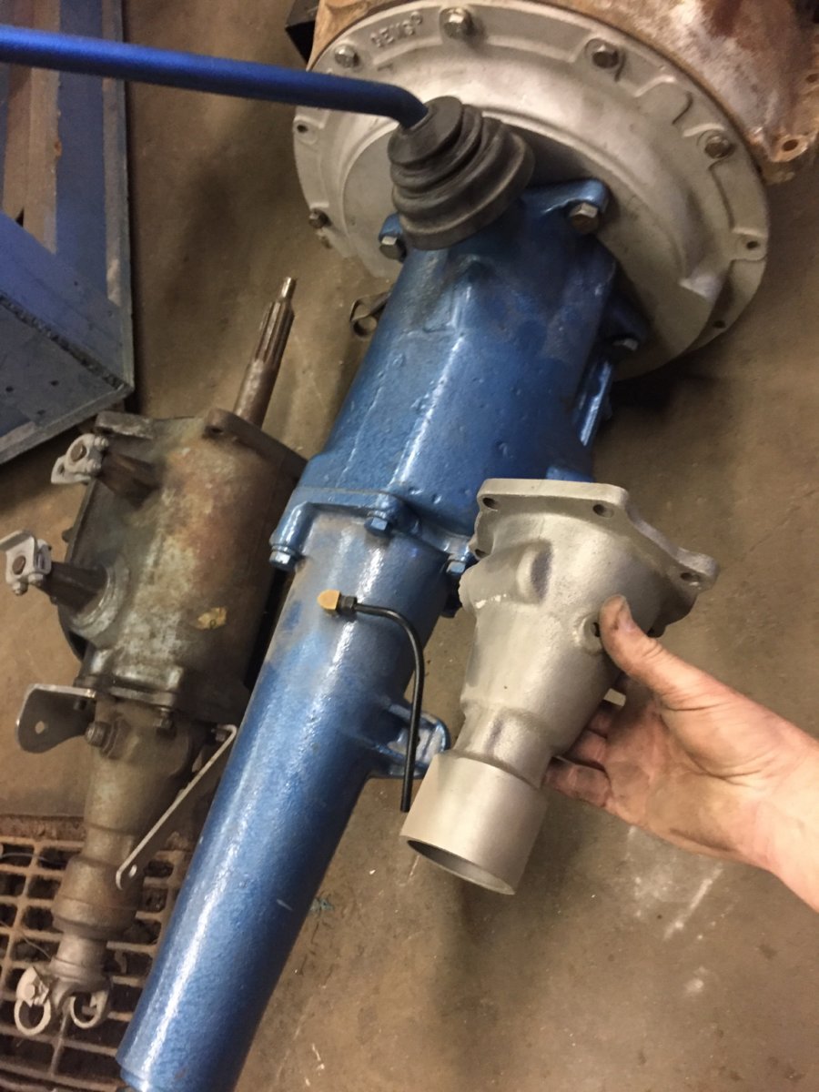

    School's started and I have a couple new cl***es that I started that are consuming all of my time.... all of it.
    But... I've been wrestling with the idea of simplifying the shifter by going to a top shift lasalle and adding the olds short shaft to it. I found one for sale just need to go pick it up... maybe this weekend if I can work it out.
    20686514_1434186696637001_6671024022546808832_n.jpg 20686509_458776747829408_7906286140481601536_n.jpg
    I really really really love the Hurst Shifter- but maybe it'll find itself in my coupe or the Ranchero... by getting rid of the hurst I would give myself more room for my right leg and s**** pedal- the shifter linkage is another thing thats sort of in the way-
    I realize that I can problem solve my way out of it and use the Hurst... but at the end of the day if a top loader is available and its a good solution and simplifies the ch***is I think its a win win.

    Editor
    good idea,
    it's a little more involved than the linked thread with the '37 but very doable,
    couple things to watch for;
    tapered pins in shift rails,
    and the cluster shaft is a smaller diameter so that shaft,
    it's bearings and gear need to stay with the '37 case.
    get a copy of '37-'38 Cadillac shop manual to walk you through it,
    just use the Olds parts when putting it back together.
    here's a quick teaser thread of one I did a little while ago: '37 LaSalle gets short shafted

    He said he bought it in 1972 for $165 from a Cadillac restorer! It looks like brand new!

    What is that tail housing in your hand?
    'looks different than all the '50 Olds' I've seen.
    '37 looks super clean, like fresh ***embled and never run, I'm jealous!
