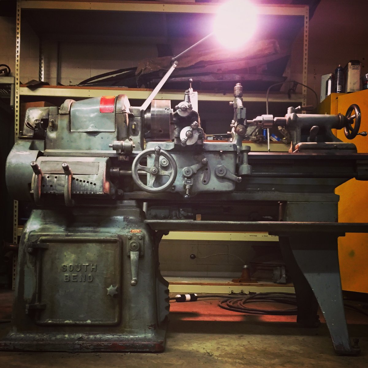

    Not really a roadster update although I have been working on the rear bone setup.
    Got a couple lathes thanks to my Father-in-law. - a 14 1/2" and a 16" with tons of extras. There are a bunch of parts that I've made with my little Smithy Granite but these things are literally next level. There are taper jigs, collet chuck with collets, extra chucks and mounting plates. All the stuff...
    I think anyone who is obsessed with hot rods naturally climbs this ladder. Hopefully I can make use of these when I get into the body by making some kustom bead roller dies, maybe some dimple dies? Hammer forms?

  17. vtwhead
    Joined: Oct 20, 2008
    Posts: 5,305
    vtwhead
    Tuck, what year is the lathe? Had one last year that we sold for a grand. It was circa 1950. If I remember it was a three phase motor, is yours?

    Those are 50 era for sure- I need to look at the serial number on the ways and see for sure. They were in the same place since 1967 before I got them and the guy that used to run the gray on used to take care of it like a cl***ic car my father said. The smaller one was used more and better maintained he thought. They've both had new belts etc... and I'm gonna go though and clean/oil with way oil etc.

    There is so much you can do with a good lathe and a Bridgeport mill. Time practice and a brain will allow you to make parts people would swear need to come from a cnc. As a 22 year journeyman machinist who has been " off the tools" for a year I am in need of a lathe. It is driving me a little crazy

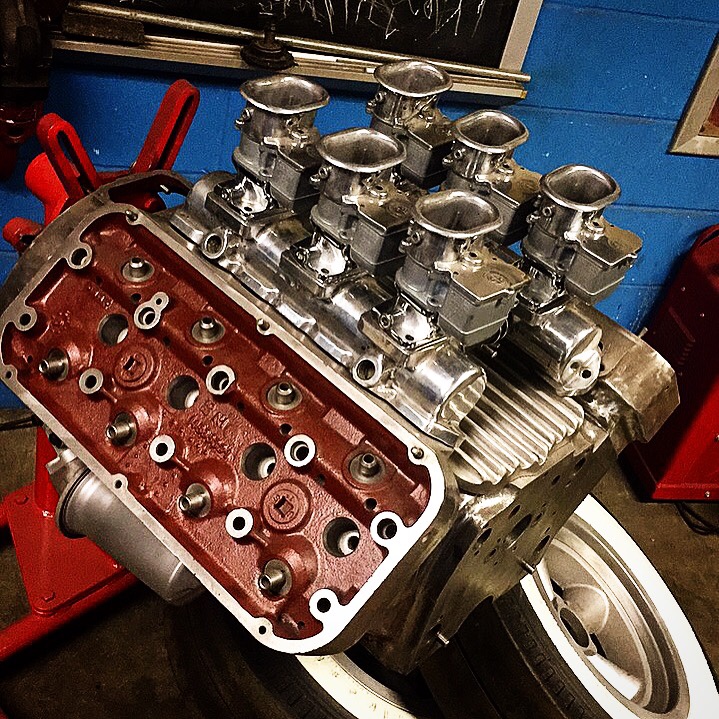

    Project is looking real good, like the front shock mounts. Intake manifolds look nice too, what brand are they? Bob

    Thanks Bob, That intake is a Weiand Drag Star. The Drag Star letters on the side were polished off long before I had it.
