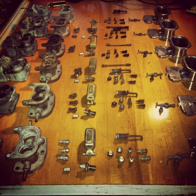

    Ok... I've been getting more parts and pieces and decided that this extreme cold up here (-20 F) I should work on some things I can handle indoors.

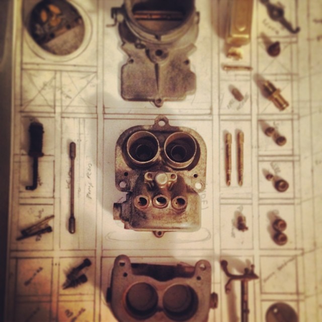

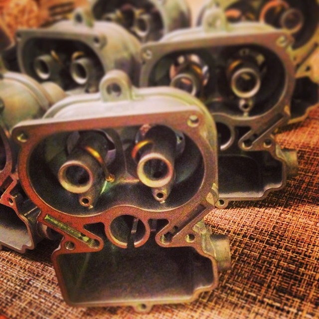

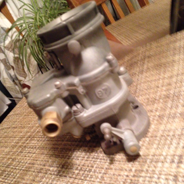

    So I started to rebuild my strombergs. Its so rad that Clive and crew remade the stromberg so all of the new parts FIT!!
    I have six carbs missing various parts- some had cracks in the castings... putting together all the parts to make six carbs when dealing with strombergs can get expensive.

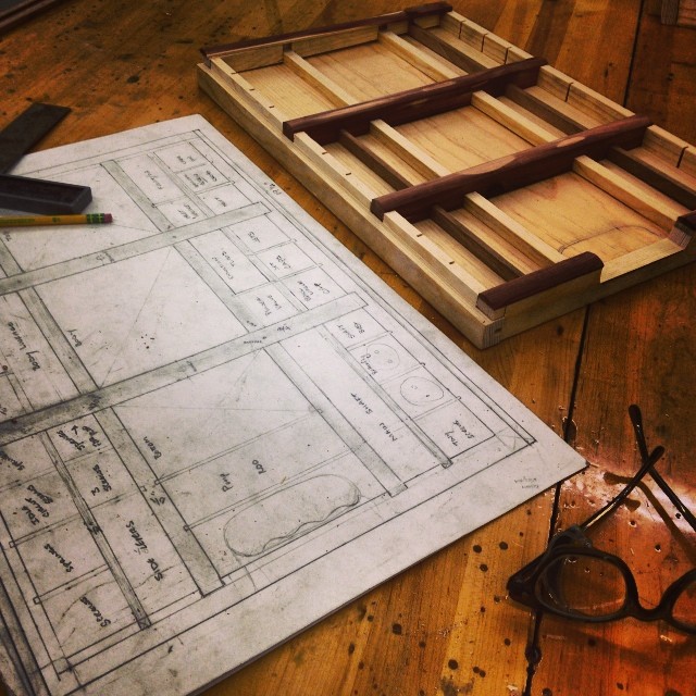

    I blew them apart on my drawing table when I realized I should make trays that fit in a box so you can keep everything neat and organized with each carb until you're done restoring all the bits and pieces.
    I don't anticipate this set of carbs being my last so I'm going overboard... but I think it'll be worth it.

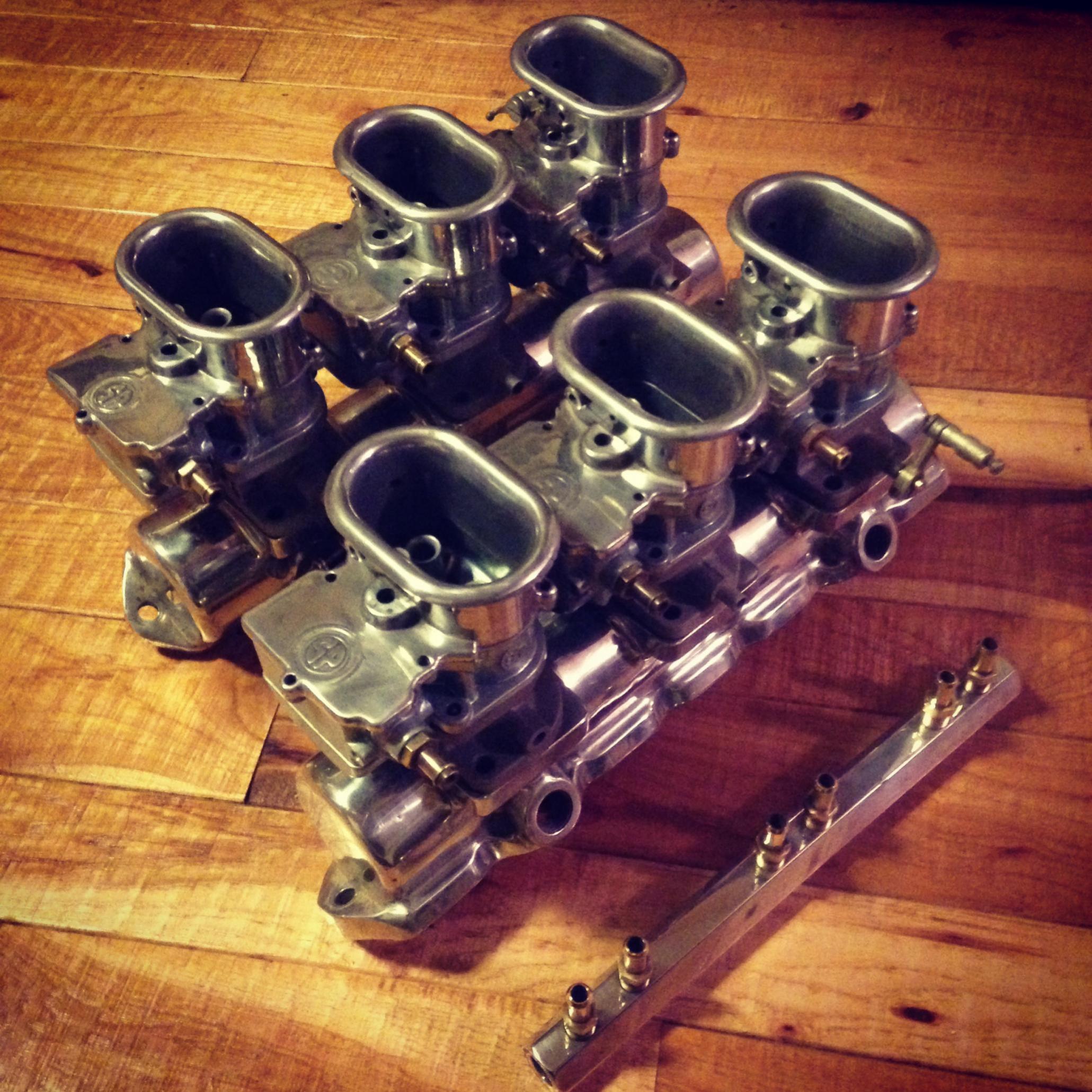

    birdog likes this.

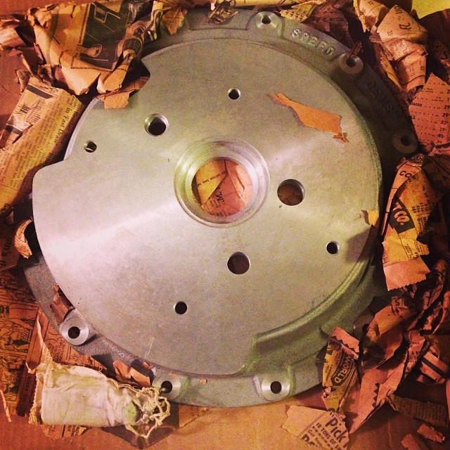

    I found a NOS adapter and a NOS flywheel- the adapter came with the right pilot bushing which I'm going to duplicate a few because I have more than one adapter just like this that I'll use for my 34 ford.

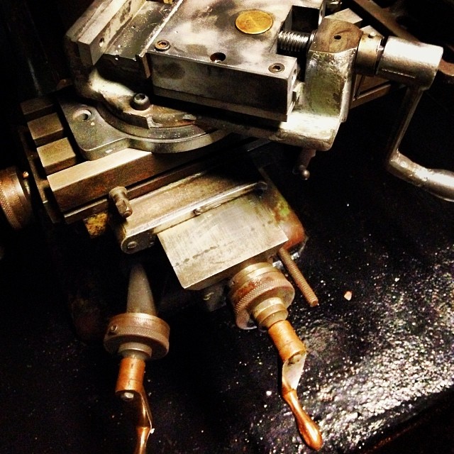

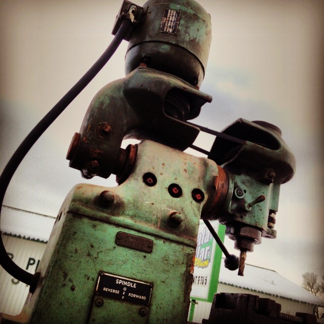

    I bought this little ELGIN mill... its from the early fifties. Its small enough to fit into my garage. In the process of finishing up a 3 phase conversion- had it wired up and it works great. It should be able to do most of the things I ask of it until I get my real shop finished. I found a bridgeport that I'll put in the shop when its ready.

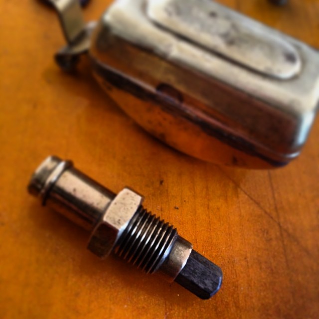

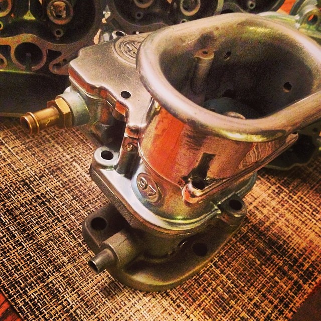

    The float and the inlet pic----> that inlet is cool because it olds the inlet needle for the stromberg so you don't have to have the extra stuff sticking out the side of the carb. I'm hoping that clive and crew make something like this with their new ball valve they're using. Less Clutter on the carb-

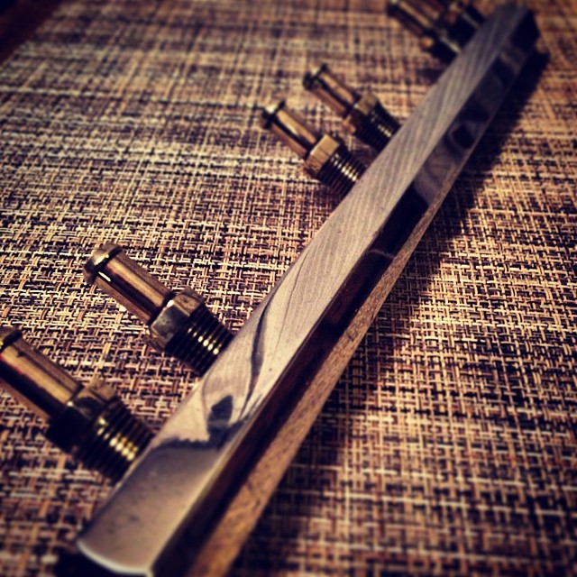

    Found a *****en hex fuel rail- started to polish it up.

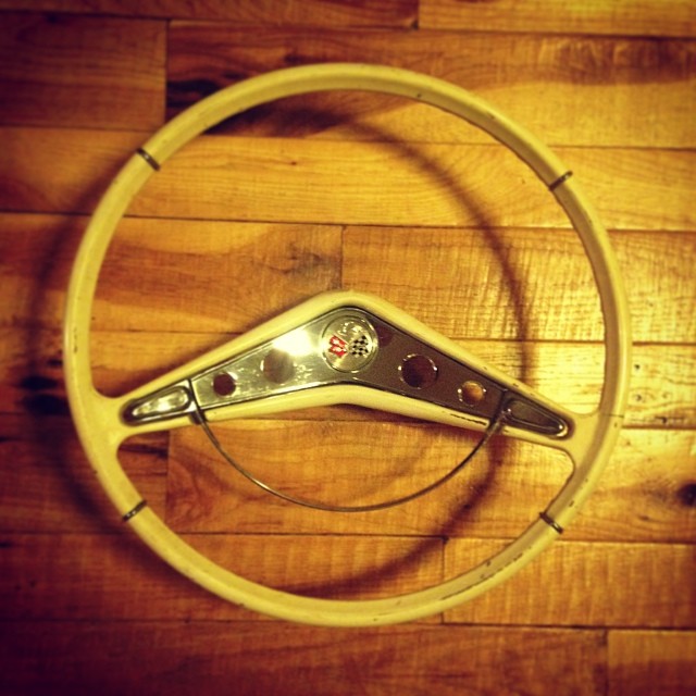

    Steering wheel is 59 impala but Im going to notch it and run a 58 horn ring. I wanted a 58 but got a deal on this one.

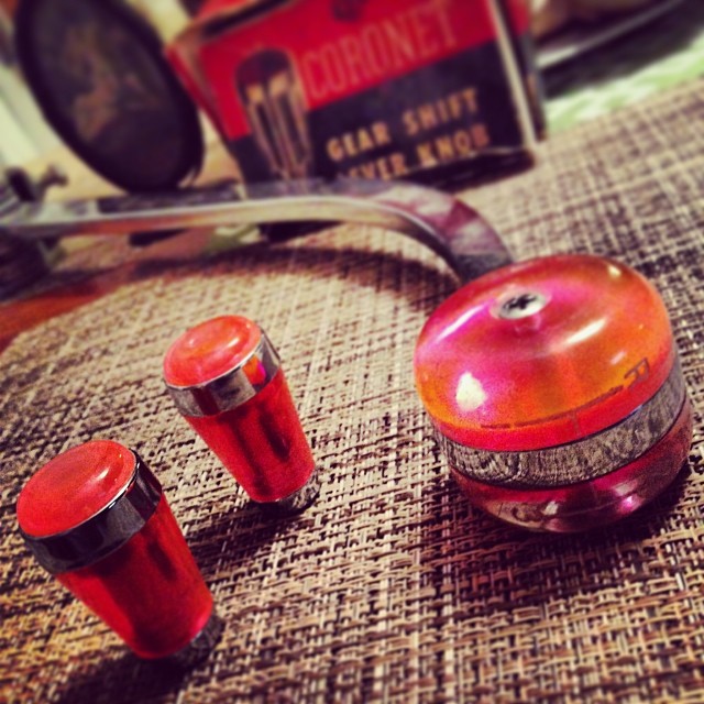

    Johnny Cola found me these *****en shift knobs that totally match my shifter in Hershey. I'm not sure what I'll use them for yet- he suggested a Hi-Fi radio in the console... yeah... :) I totally picture it. Reverb and all...

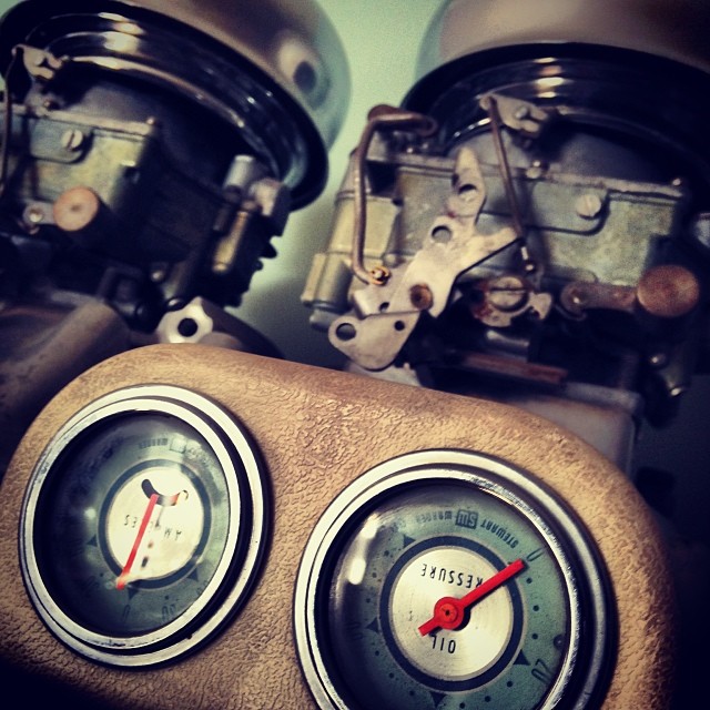

    Tokyo found me some gauges- SW Marine full sweep oil and an amp gauge. I'm going to use these in a 59 impala dash I cut out of a wrecked 59 in a local yard. I have some neat ideas for the dash when it gets sliced up and sectioned to fit the roadster body.

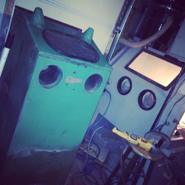

    I bought this awesome vacu-blast cabinet from 1964 off of CL for $50.
    New wires, new hoses and some wallnut shells and it works better than my skat blast cabinet! I'm just using it for the soft parts- carbs etc- it works awesome.
    The other cabinet is hard to clean all the grit out when you want to change blast media so I was looking for a small blaster but this thing far exceeded my expectations...
    which makes me think about the engineers of the sixties... THEY RULED!!
    ****py pic but I posted a carb i stuck in there and blew all of the **** off- it was a crusty old 97... came out looking minty fresh!

    This is just a mock-up...
    Getting closer-
    putting in a order to the hot rod company for the kits and parts I need to replace.
    I think I'm going to zinc plate my bases. I was thinking black but looking at it ***embled I like the cast color and I have a zinc plating setup that works pretty good- it plates a medium zinc color- nothing like that bright zinc that looks like chrome paint- just a nice medium zinc.
    If I chrome plate the body- I should really chrome plate the sp tops and the bases which would run about 225+ per carb. THEN... you would probably want to chrome plate the intake.....
    I look at this and if I polish all of that stuff- chrome all the small parts- linkage etc. I should be good... because the way it sits from a polishing stand point its what I would consider roughed in-

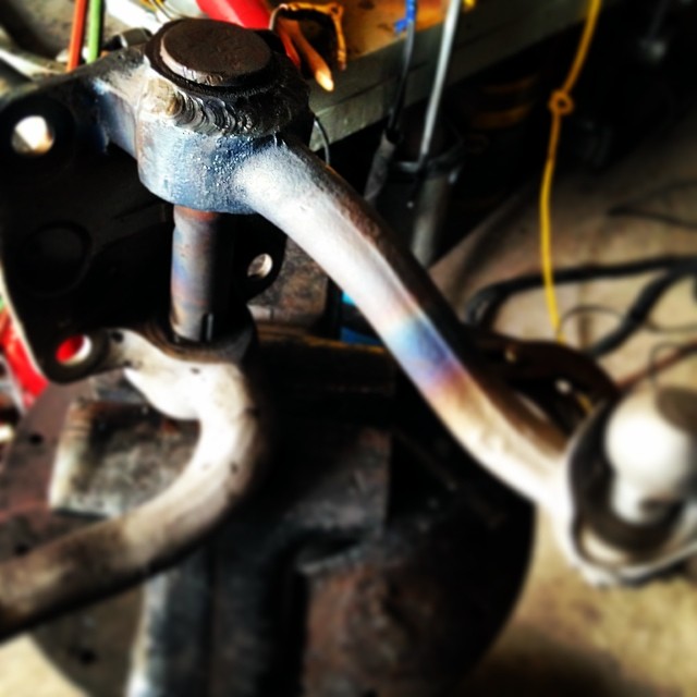

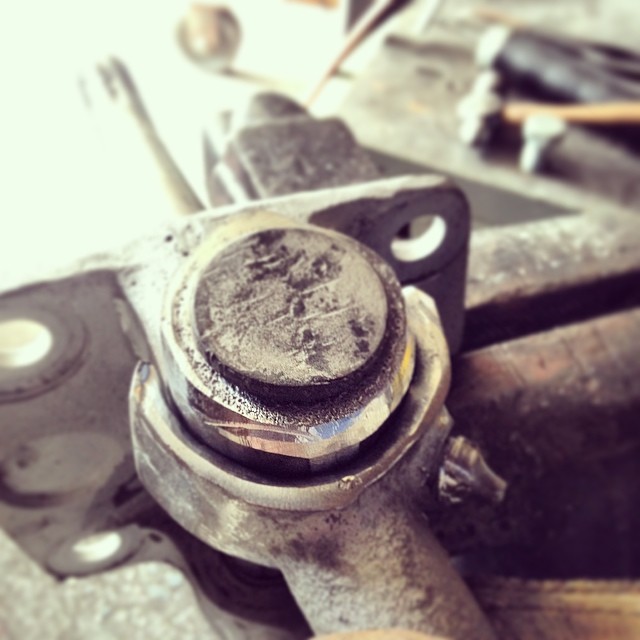

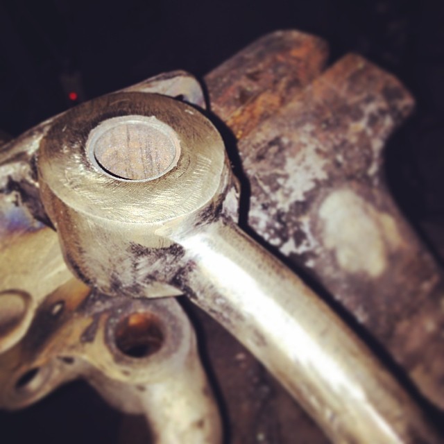

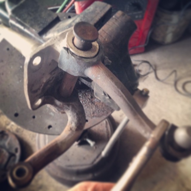

    I modified my spindles to accept the steering arm from a junk 32 spindle. I cut it on the band saw clean off next to the spindle back- and then cut into the king pin hole and shaped it around a ball peen hammer that was the same size as the 46 spindle I have-
    Hopefully the pics will tell the story- I beveled and cleaned everything- preheated it before I tig welded and it melted right in...
    Still have some shaping to do on the spindle to make it look like it was made that way but I think It turned out pretty good! :)
    So this with the dropped deuce heavy should look pretty good with this following the contour of the axle- and the square backs combine with a set of Lincoln backing plates and Buick drums/48 car hubs.
