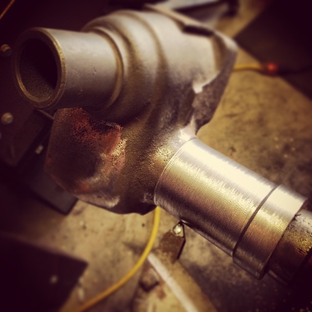

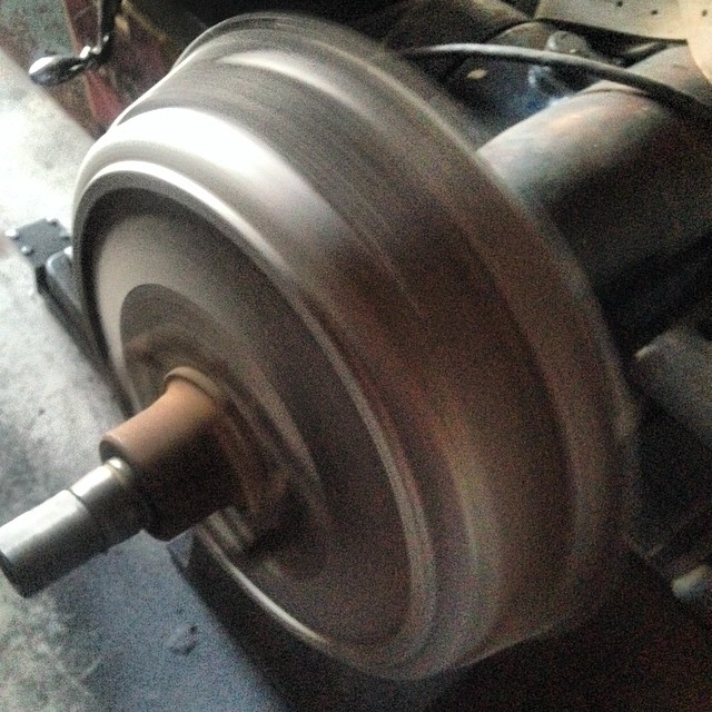

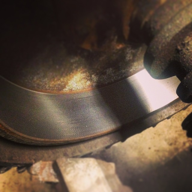

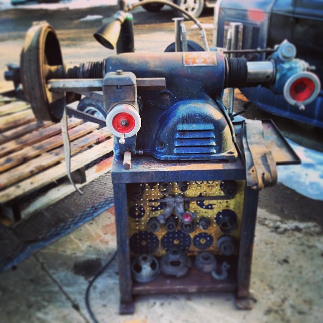

    Scored a brake lathe from a buddy- and started to turn my buick drums. Picking up hubs from Cheater Carl-
    I've never used one of these before- they're fun! Found the step by step manual online in PDF format and set up my drum. With the flywheel attachment I can relieve the hub to fit the drum too!! :) Pretty damn cool!
    I'm running buick drums all the way around-

    So I'm going forward with the full contact brake conversion on my roadster. With help from a couple articles from 59 rodding and restyling I'm hoping I can pull this off.
    I'm not able to do this at home yet as I don't have a lathe yet- (its on my list) but I did get a brake lathe.
    I'm having a friend machine my spindles to fit the I.D. of the dust shield.
    Then I'll tig weld up the old holes and locate new ones that line up with the new bolt pattern for the backing plates.

    Pictured below is my steering box- I'm setting it up in similar fashion to how I had it last time with some mild design changes- I was able to mount it to the brake lathe and get rid of the wonky casting along the shaft.
    This lines up just sunk into the frame a bit to clear the hemi starter and pedals- so I can either weld a new tab/mount or do a compression clamp style mount like I had fabricated before.

    Ive done the mods to many buick drums on my ammco brake lathe which is identical to yours. i made a couple bits out of tool steel and it worked like ****er.

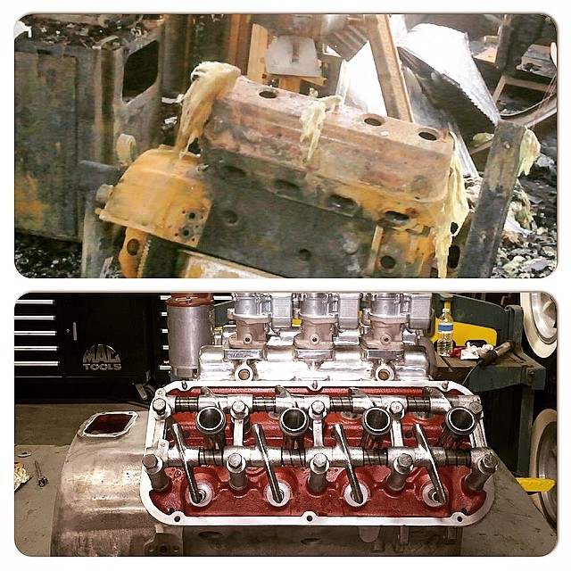

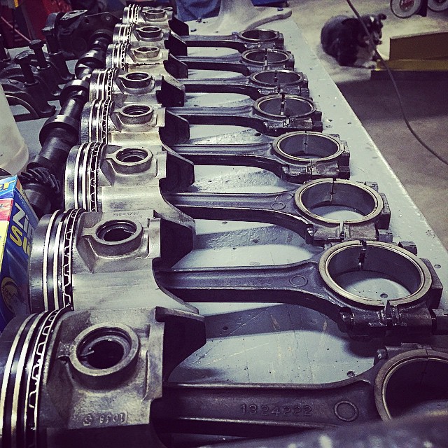

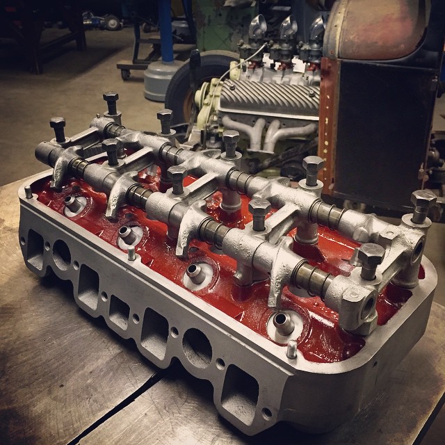

    I brought the engine in and had it washed at the local Napa. Then I gl*** beaded and finished cleaning the block so it was spotless... tore all of the internals out and everything looked really good. I could probably run the bearings they all looked like brand new. Because it was so clean... I was able to paint the inside with Glyptal. Some people hate the stuff... some people say it went out with fuzzy dice in the fifties. The truth is... that's why I did it. It fits the build and I love details.
    I started on the carbs a year and a half ago- and the intake etc- rebuilt the rocker ***y-
    I plan on running stainless valves instead of the stock two piece.
    Looking forward to some thrashes on this over the summer. Feels really good to get the hemi back to where it was... standing tall! It has conformatic hypothermic pistons and the 54 imperial heads with the oval exhaust ports... just like the 555 heads flow wise just no water ports like 55's. Its been bored to 354CID. The cam is getting profiled it's a regrind. Solid lifters with adjustable push rods all moly stuff-
    I have most of the stuff to rebuild this car- I'll be posting updates over the summer!
