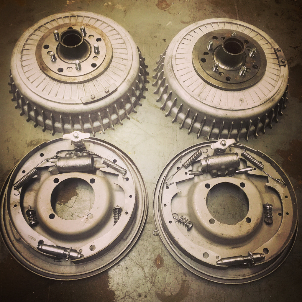

    Cleaned up the Lincoln brakes- Honed the cylinders... need to machine or make spacers that are 3/8 to a half inch. I redrilled the hubs for 4.5 on 5 so my mags will fit. I had them drilled for 4 3/4 before. Now they're swiss cheese.
    I need to ream my mag holes to use a standard .68 shank acorn on the 1/2" 20 studs... Right now the ID is .62

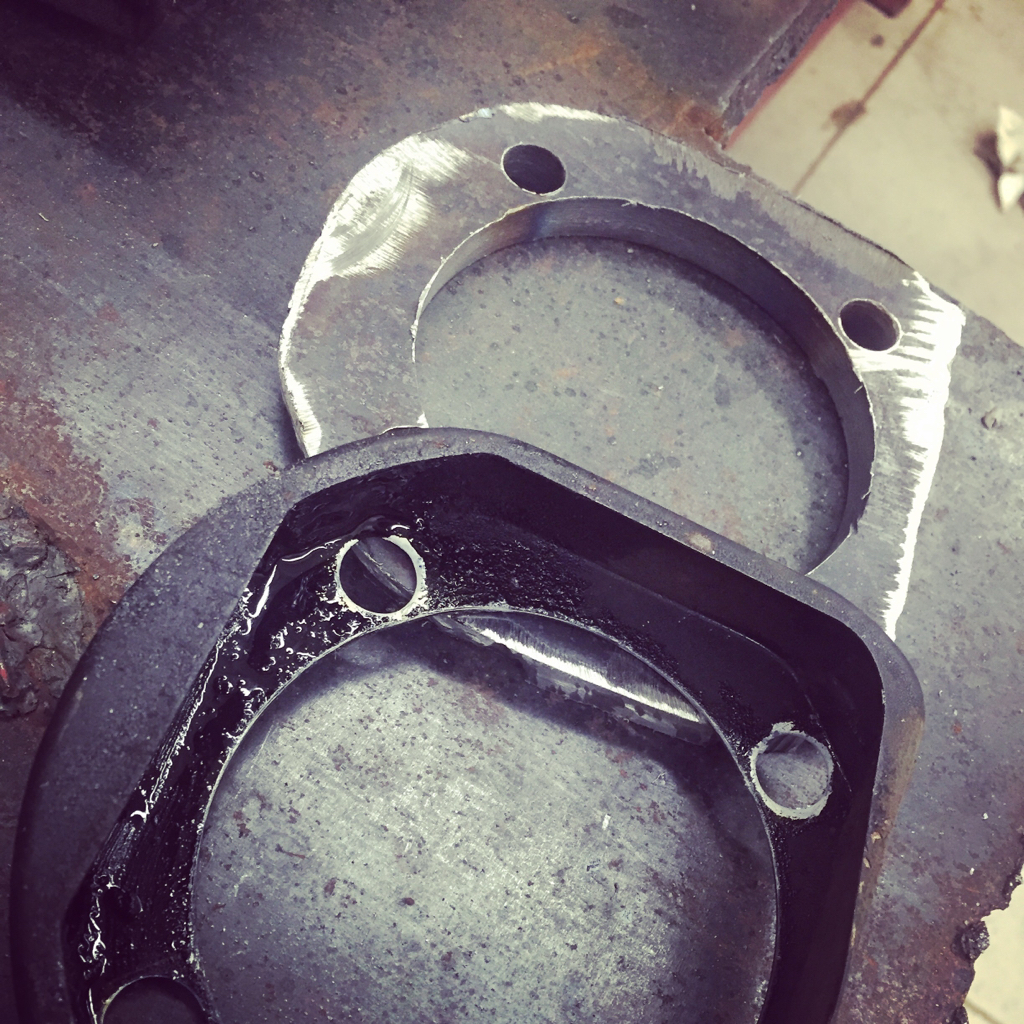

    Here is my first attempt at making a spacer- 1/2" steel plate! I used a whole saw for the center- drilled the holes and plasma cut out the shape- will belt sand to match the spindle!!

    Hot rodding at its best- I used a whole saw- centering punches and a flap disk.

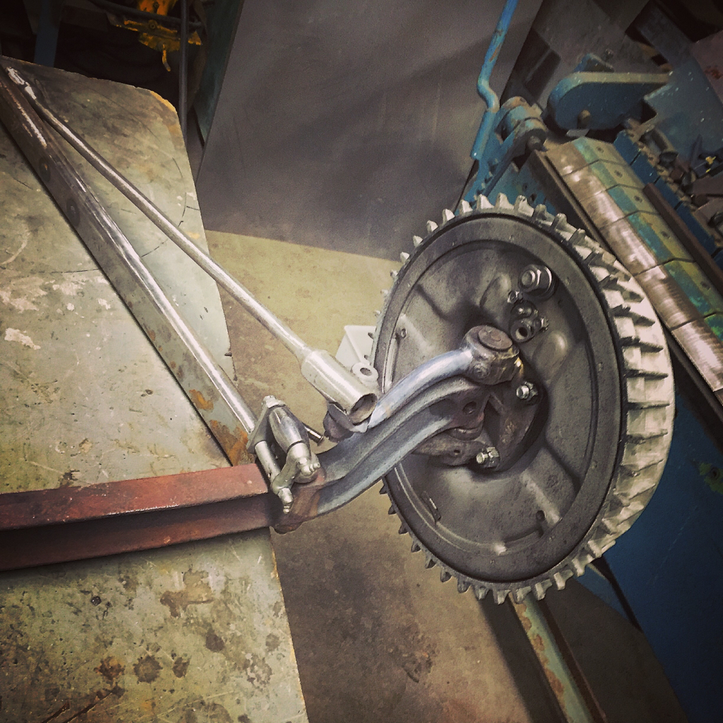

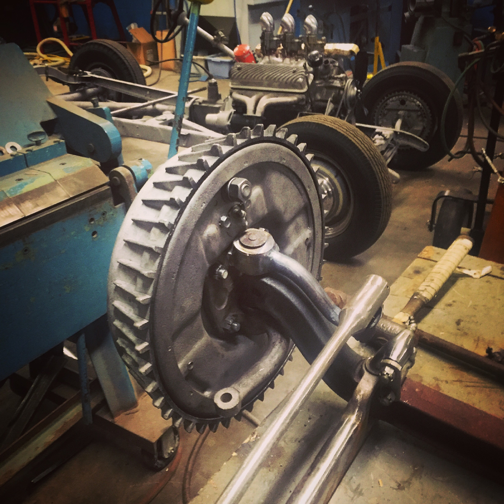

    Just a mock up- bent the steering arm to flow with the dropped axle. Turned and relieved the drums on the lathe so they don't interfere with the backing plates... (you have to remove more than you do for 40 backing plates because of the double lip) and bolted it all together with my home made spacers and it works awesome!
    Need to heat and move the steering arms to clear the drop next-
    No aftermarket parts- spring perches are pruned model a- drag link and axle are deuce.

  9. Tuck, I'm concerned about your shackle angle... :D
    Drums look great. Nice to see it all fitting together with old parts.
    Tuck likes this.

    Everything is looking real nice. That steering arm flowing with the axle looks great!
    Tuck likes this.

    What's up with that short drag link right behind the axle?
    jim mchargue and Tuck like this.

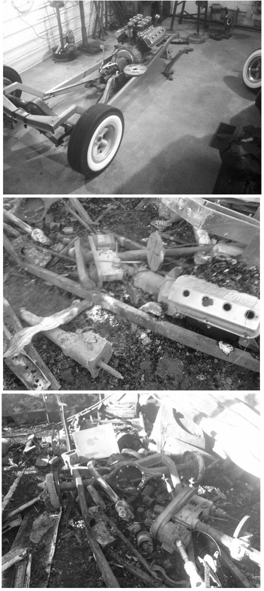

    I robbed the internals out of the short one for the 32 drag link- I saved that drag link from the fire but I lost the small parts in the mess-
    Everything that happened since the shop fire has been positive- Some adversity in our lives increases the drive for the things we're p***ionate about... It gets taken away and you appreciate it more than ever!

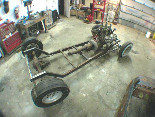

    Just a little :p
    old pics from before...
    user277_pic26627_1226383431.jpg 102_1404.jpg AUT_0044.jpg AUT_0060.jpg 100_1378.jpg
