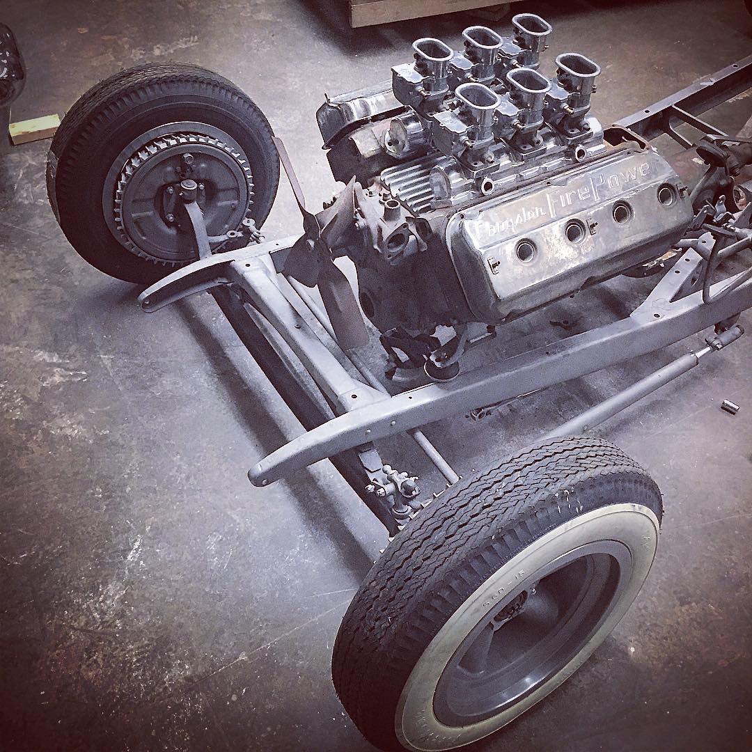

    I want to keep do***enting this- so I had a few hours last week and a few hours this weekend to work on the roadster.
    Roughed in motor mounts- front mounts I'm making into a cross member that hugs the pan, rear mount bolts to the back of the lasalle trans so the weight of the motor is sitting in the rails in the later pics with the body on it.
    I trimmed out the body and fit it. I played a lot with stance. Originally the plan was to have this sitting lower in the rear- but- in the pic is where It needs to be. I think this will work out great because I plan to make a curved body line from the cowl line below the door (like a flare) and back and fill the wheel wells. Sort of like a small rocker-
    It'll get a chrome roll bar - small one that will come though the rear panel behind the seat, flowing hedders that'll merge into side pipes and small quadrant-circle or ninety degree arc cycle finders that cup the slicks in the rear.
    There's a pretty long list of loose ends to ****on up but now that I have it all mocked up I can work on my pedals, steering column and other small projects.
    Tuck
