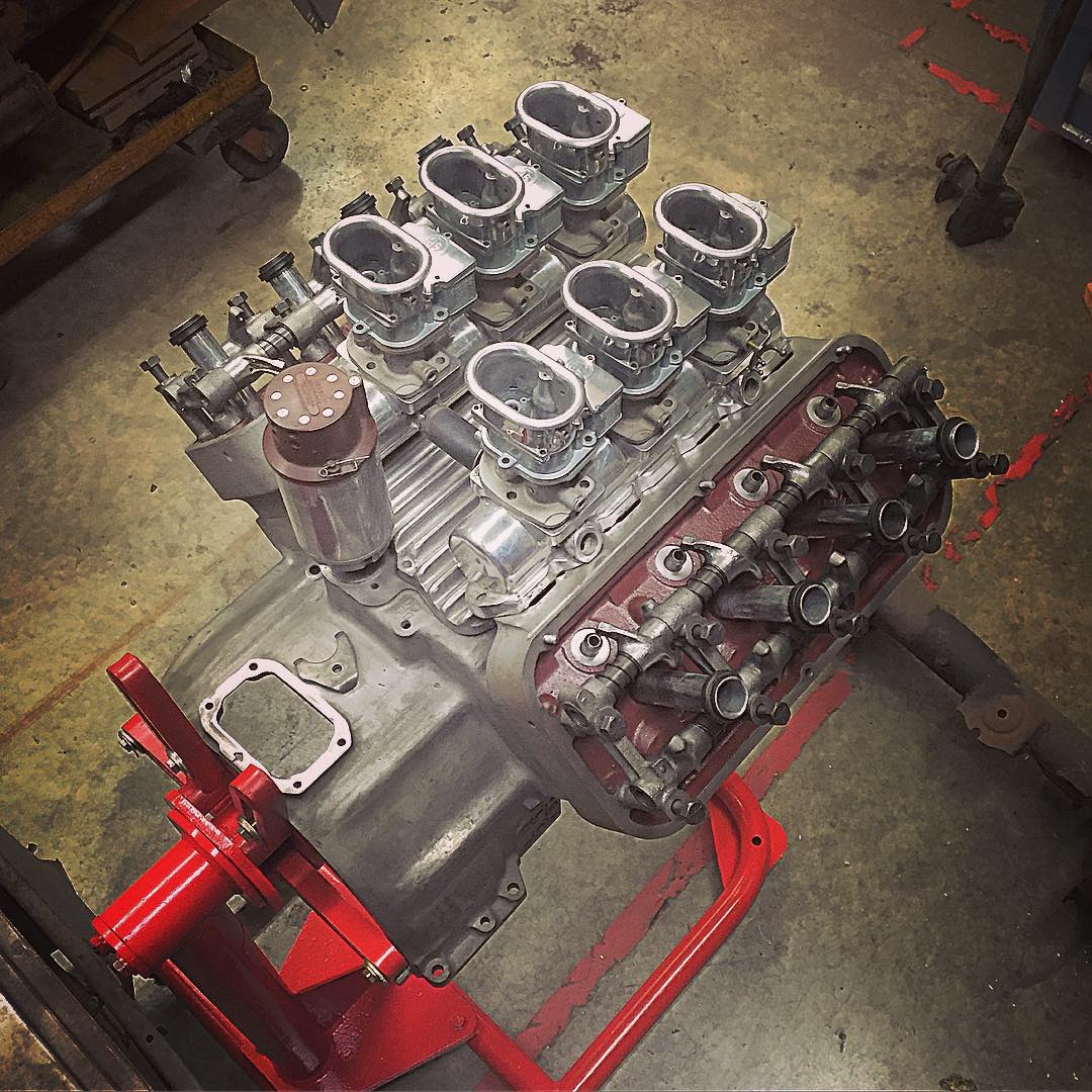

    Heads are going in for new hardened exhaust seats, mill job, new one piece stainless valves, updated guide liners, performance valve job and springs- Then I'll start to ***emble the block. Carbs are about half way done- I'll post progress as I go.
    I'm going to try my hat at some video with the engine build.

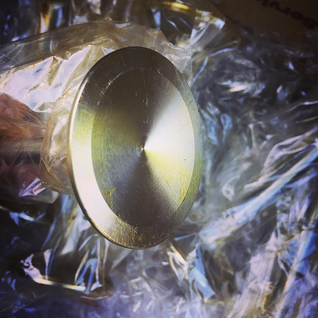

    I was waiting on the valves to show up in the mail from @73RR - THANK YOU- Heads are going in to get finished up today after work. They're one piece stainless, the OEM were known to have the heads pop off because they're spun weld.
    I was originally going to run a 59 wheel but decided to change to a 61! The coolest! :) Picked one up here on the hamb!

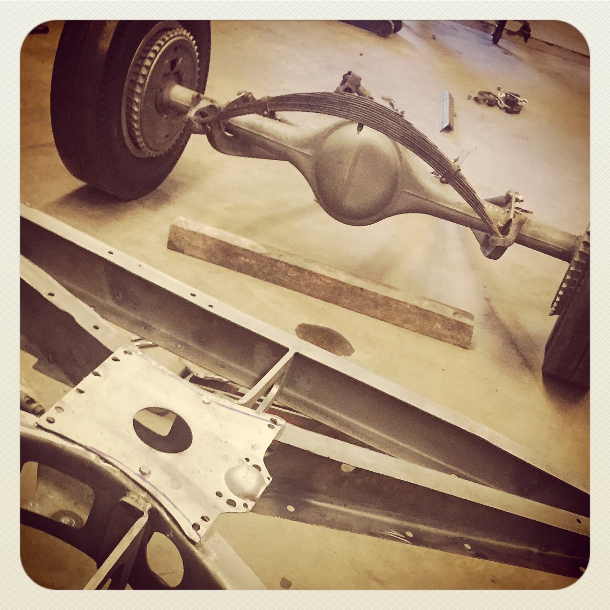

    I'm teaching summer school for one more week- they're only half days so I get a few hours in each day on the roadster.
    I flipped the bottom plate of the x-member so the ball mount would work for the rear- I have the reinforcement piece too that doubles up the thickness of it- I trimmed this down on the band saw but you get the idea from this pic- worked out slick.
    I also swapped the model a bone spreader ball mount for a 32-
    I mounted the front end and bones with the correct geometry- kingpins are at the same angle as the crossmember, replaced the bushings front and rear.
    Everything is pretty snug. Next I'll work in the pedal ***embly and finish the front and rear mounts for the hemi.
    Parts and more parts-

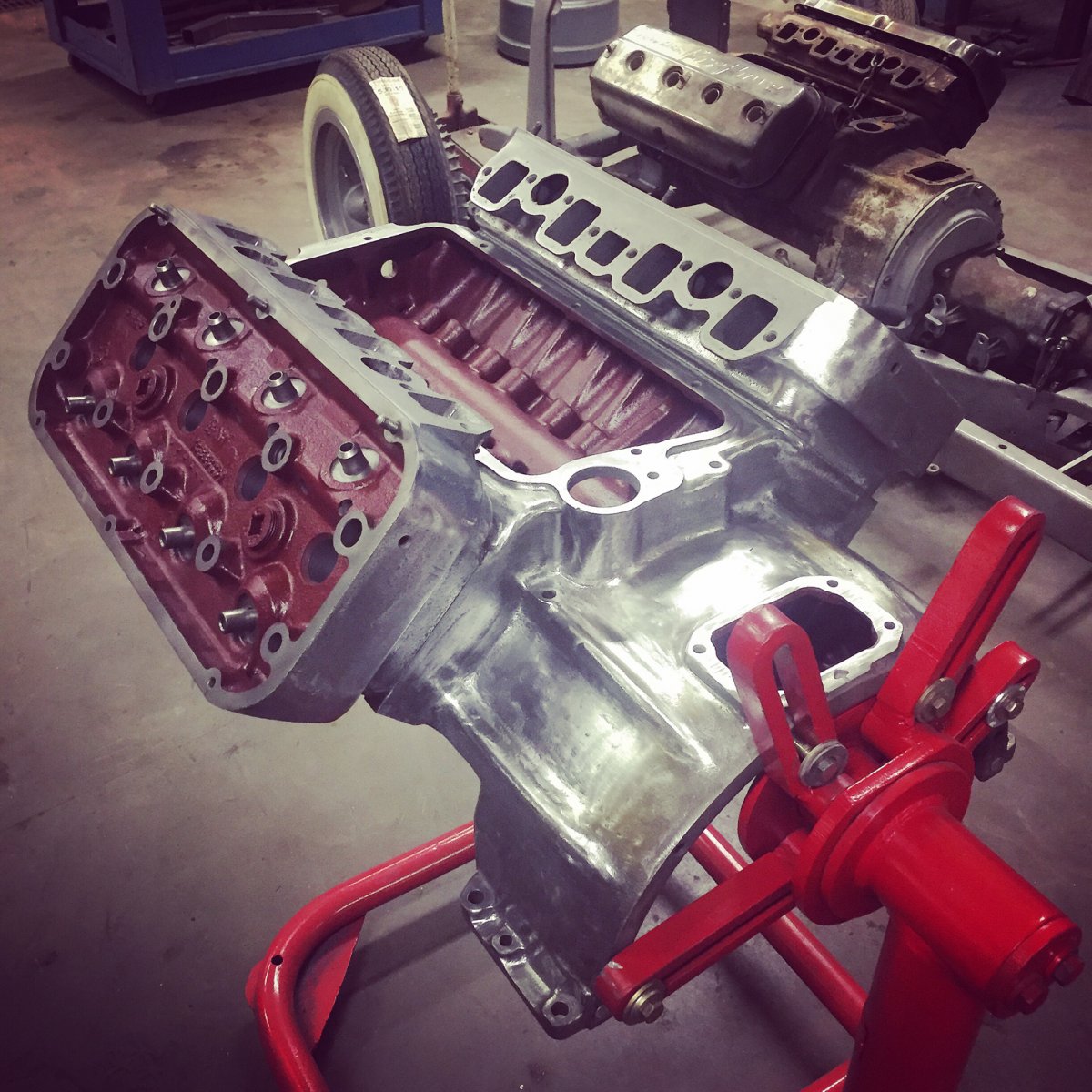

    Ground all of the casting smooth on the hemi- next on deck prepping the trans and timing cover for the chrome shop-
    Picked up a old chrome crank pulley for the hemi at Iola
