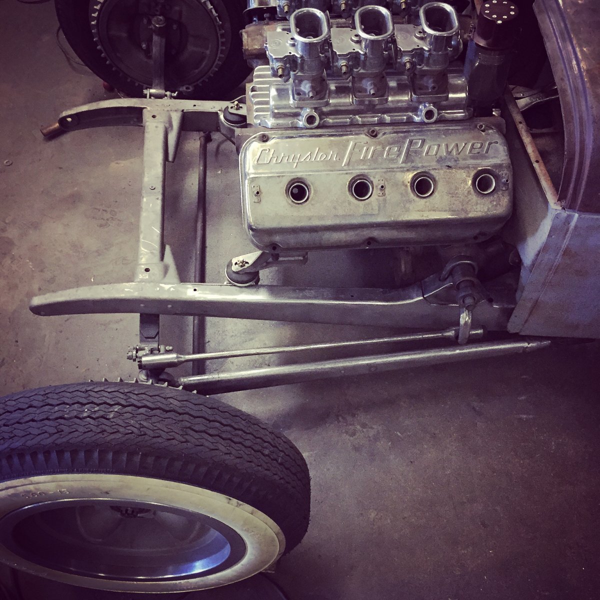

    I've been working on the steering and it got a bit out of hand- but I'm digging on it. I have a keyhole that the box fit between the frame, starter and engine block.
    I made a riser- started with this idea I had on the first roadster using a u bolt and a pruned f-1 box.
    Pics should explain-
    I made this a frame riser, boxed and sleeved it, plan to sleeve the frame so the u bolt goes through the frame and there will be holes in the bottom where the nuts will be frenched up inside-
    I notched and keyed it- the riser will get chromed along with the box and the pitman arm which is a work in progress.
    Still a lot of finish work to do- here's my progress from this week-

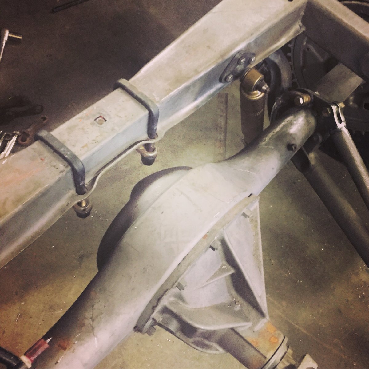

    Worked on the other Shock today- the front end is starting to shape up-
    I made templates to mirror all the mounting holes on both the frame and the bones and then duplicated all the bends- both shocks mounted.
    Worked out mounting the rear shocks- going to mount them tomorrow and finish welding and blending the bones for the shocks.

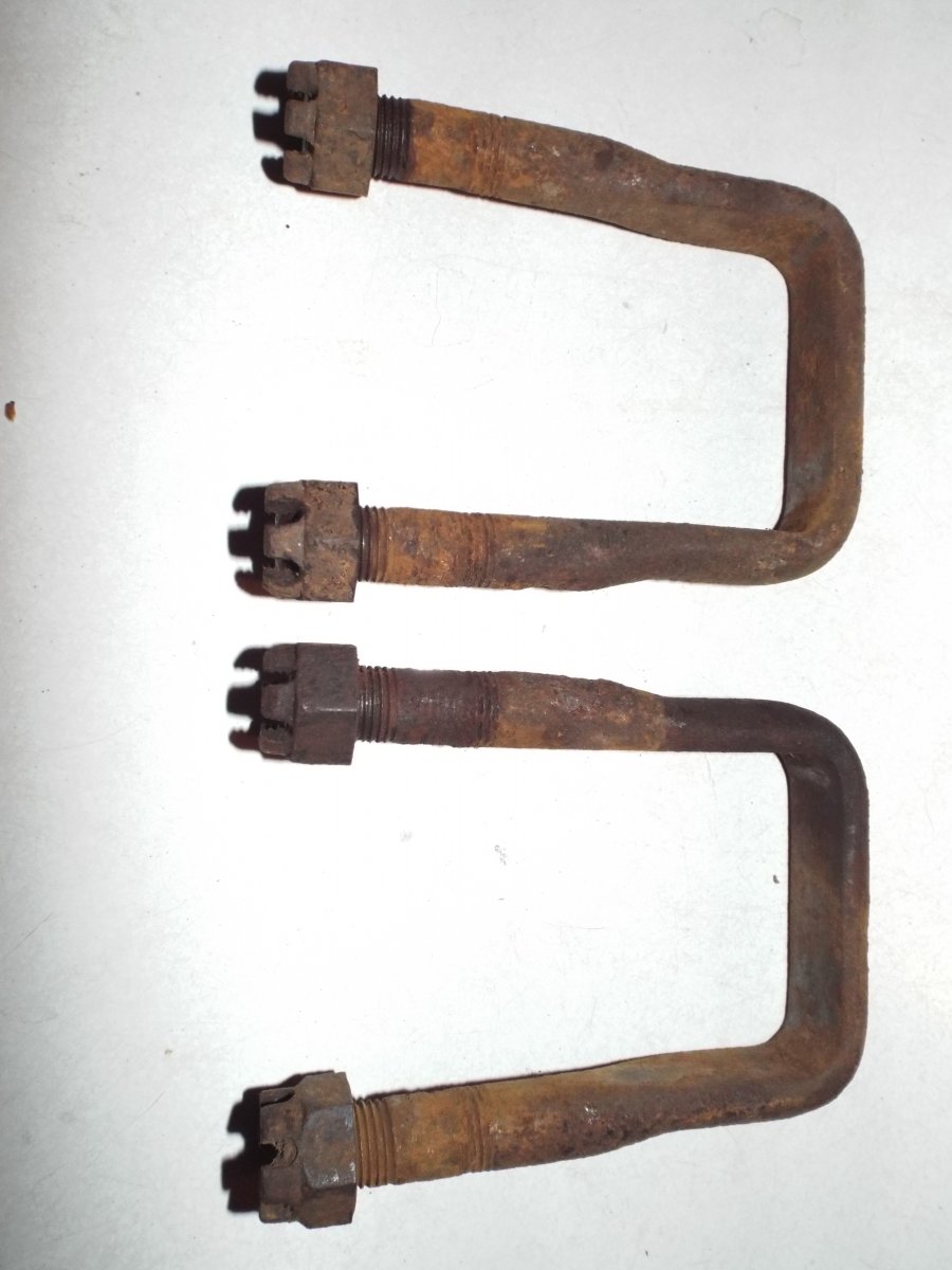

    Does anyone have any 28/29 front perch U-bolts? I had some new ones made but I have one and it looks so good...

    DSCF9752.JPG Upper threads are worn from the bottom plate. If you want them PM your address and they will be in the mail tomorrow. Really like the looks of the front end, look forward to seeing how you bracket the cycle fenders. Bob

    I'm gonna pick up the ones they made for me tomorrow if they don't look as good I'll take you up on this for sure!!! Thanks man-!
    Another quick update -
    Mounted the rear shocks- made the upper mount and lower mount is modified f-1 mated to the bone mount on the axle, the shock looks like an extreme angle but it's just shy of 30 degrees like the fronts-

    Ok after getting everything in place I actually extended the f-1 shock mount 2" so I can't bottom out the shock at all- brought it just to the bottom of the scrub line-
    Now It'll bottom out on the kickup before the shock-

    Fresh and flakey out of the forge they actually turned out pretty damn good! With a little grind and polish they should look as good as originals-
    I needed the rears an inch longer because I sleeved the rear crossmember to fit a 40 style front spring.

    I saved some ford castle nuts and will drill a hole in them when I get them setup and trimmed to the right length and I'll lose those modem looking nuts- back ubolts were spot on- brought the back down a couple inches and the suspension is stiff! Should ride like a plank!
