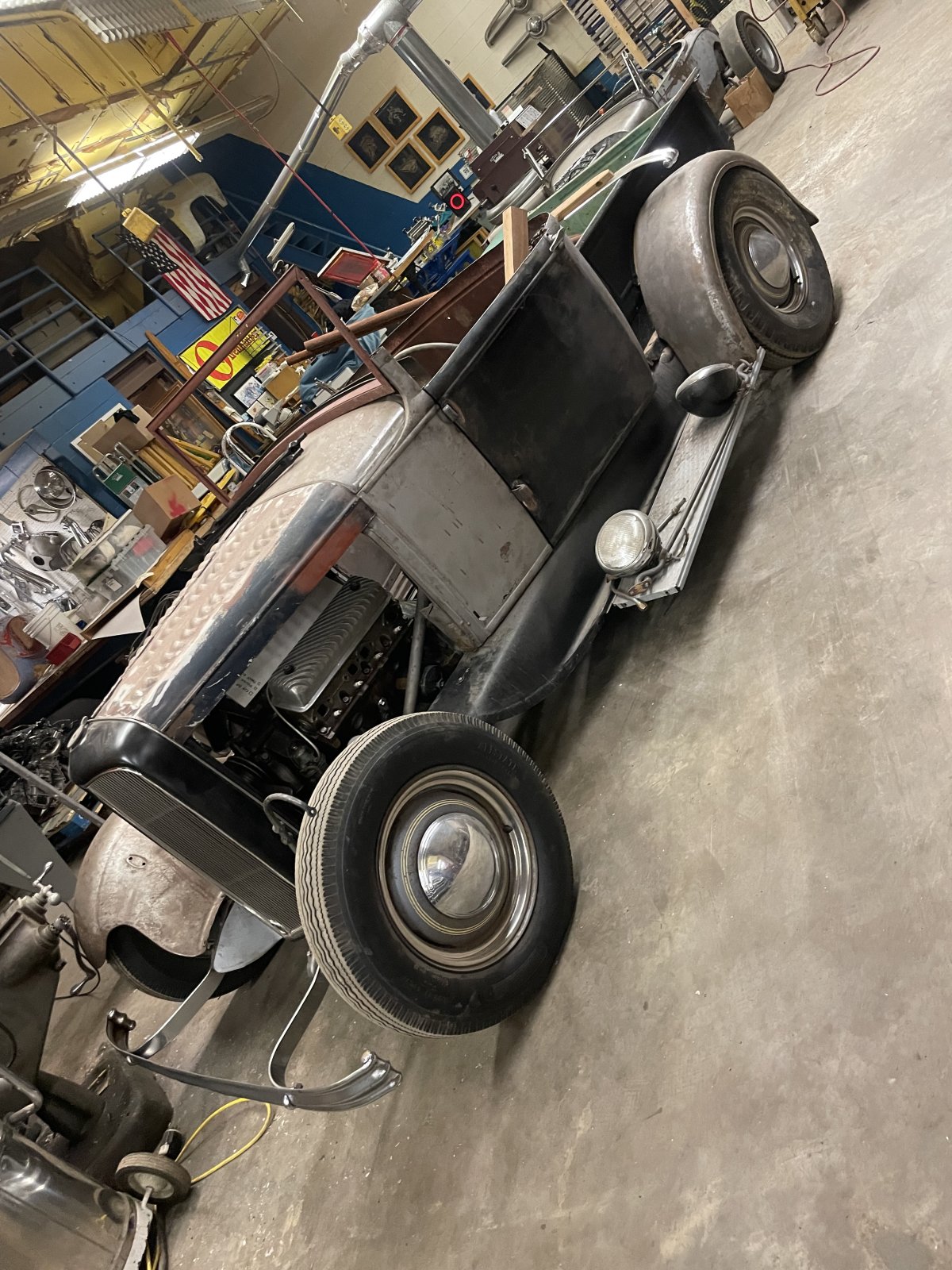

    They look good, if you are happy divulge your trade secret, what paint do you use on the tyres & how well does it last?

    Haha @Tim no trade secret I used a medium point oil based sharpie paint pen, I almost used oneshot... We will see how it holds up, I’ve heard it works well. Markal paint pens work too. I really like the look. It’s so easy if you need to touch them up every so often doesn’t seem like it would be a big deal. Once the pen starts flowing it lays out really nice and flat. I used lacquer thinner to clean the rubber and help promote good adhesion before applying.

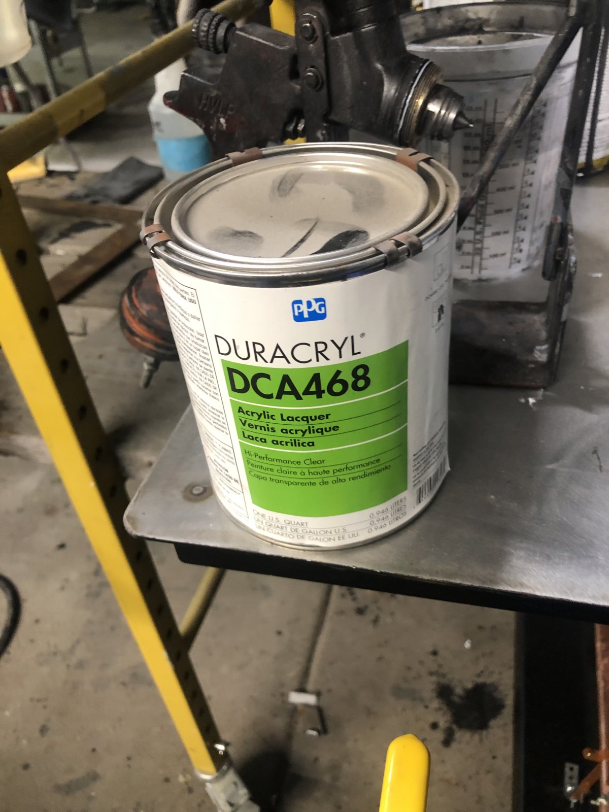

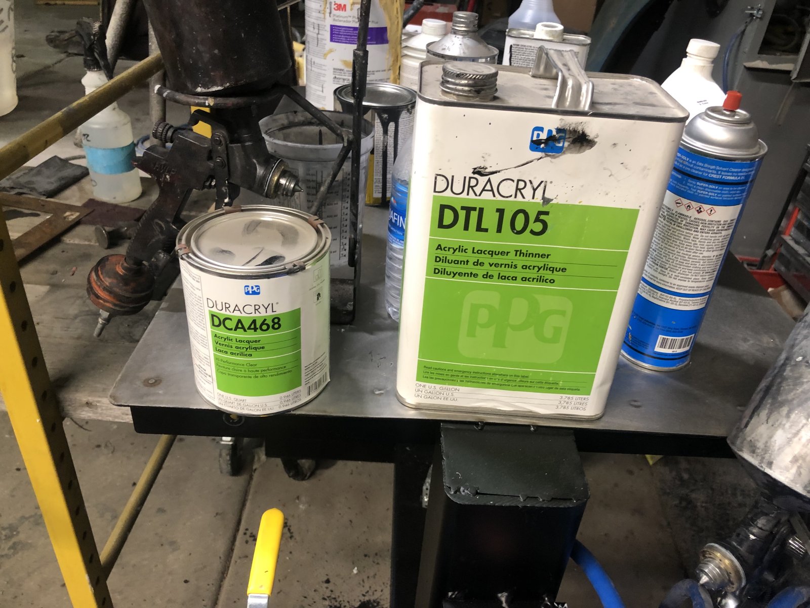

    I managed to scrounge up a couple more quarts of nos lacquer today and some Thinner! (Thank you Perry)
    tcb global makes lacquer and thinners for any color from old paint chips… lacquer is so fun to spray after spraying 2k urethane’s and isocyanate laden clears… no hardner, just mix one to one and go. IMG_8566.jpeg
    on the hunt for more nos DCA468 clear if anyone has any.. or for some silver acrylic lacquer for the base color for my candy flames. Message me if you have some you want to sell.

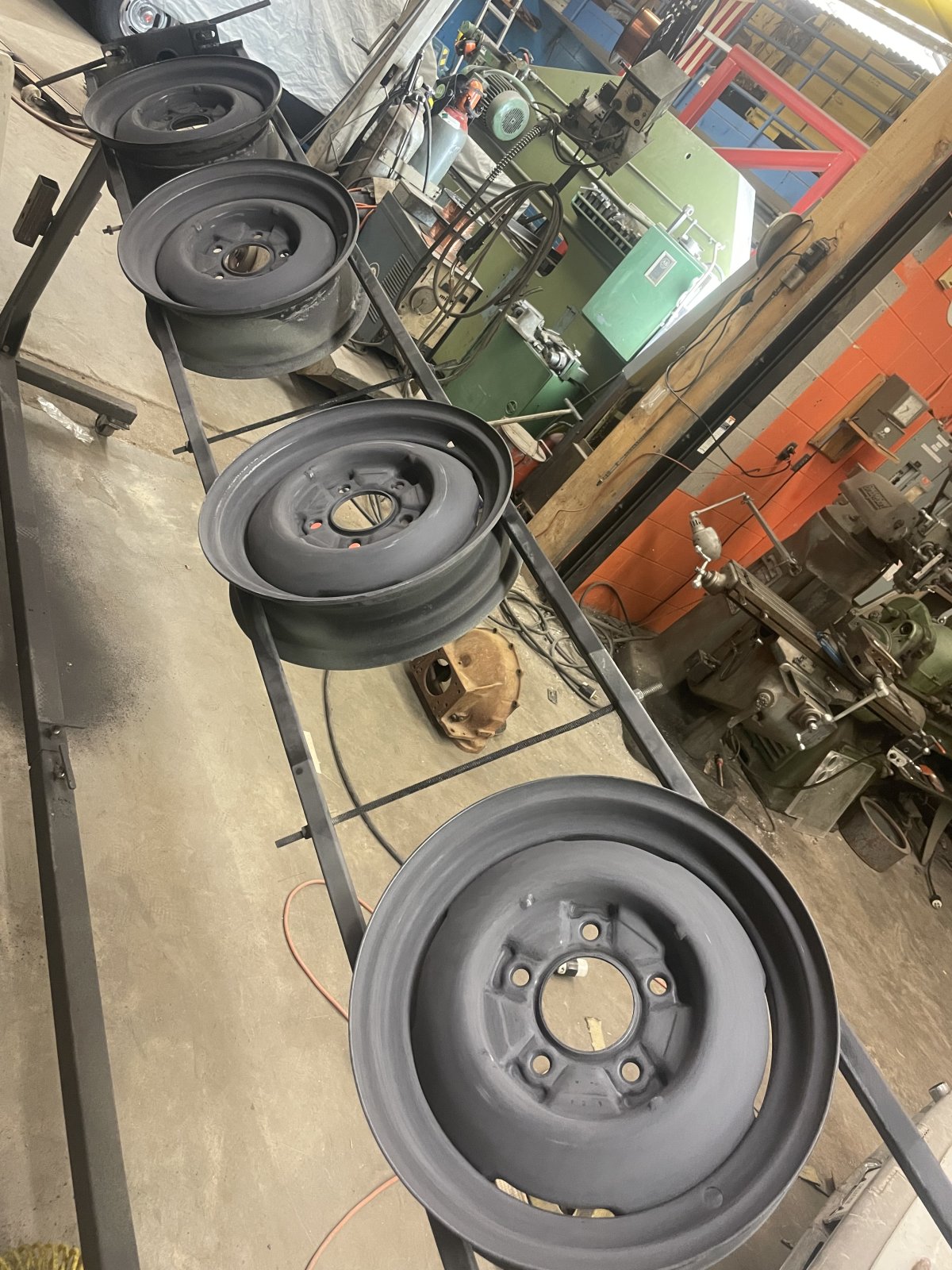

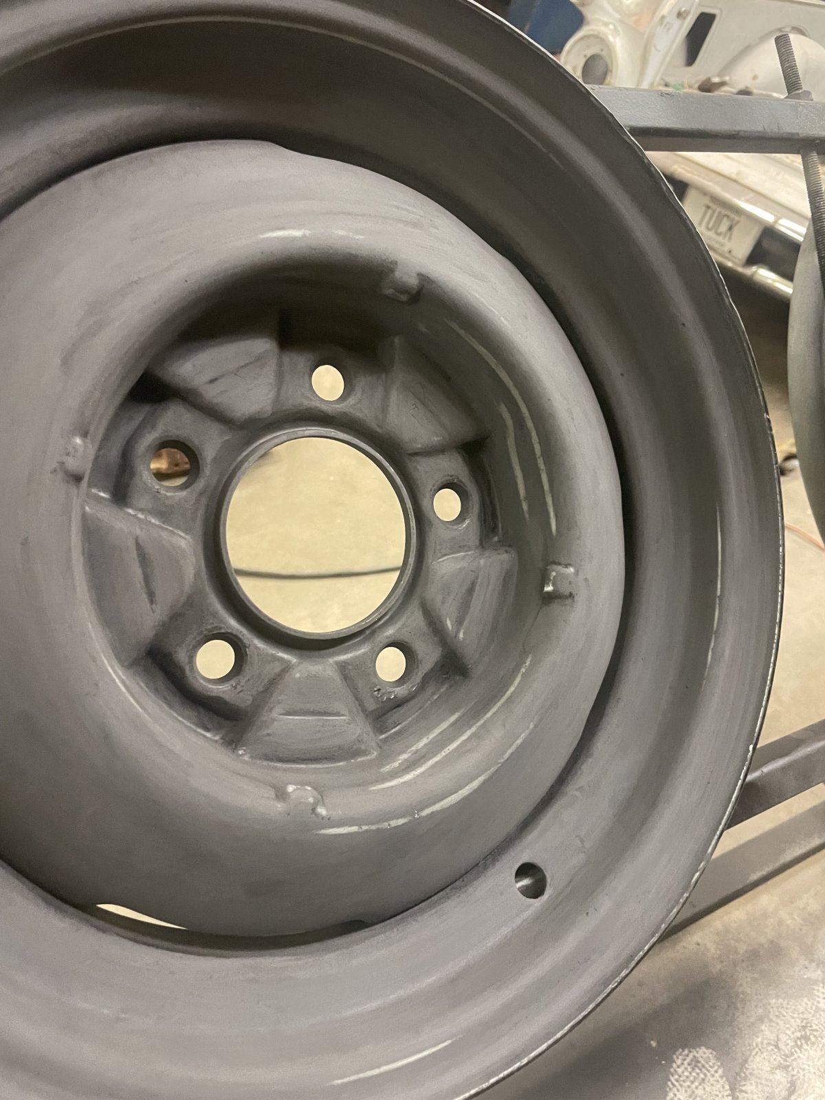

    Im at deer camp and I’m laying here feeling what’s left of the tips of my fingers… I sanded all the rims and they’re almost ready for sealer… I sanded so much my finger tips are raw.
    I’m going to seal these in epoxy next and then 5 coats of lacquer base and 5 coats of clear!

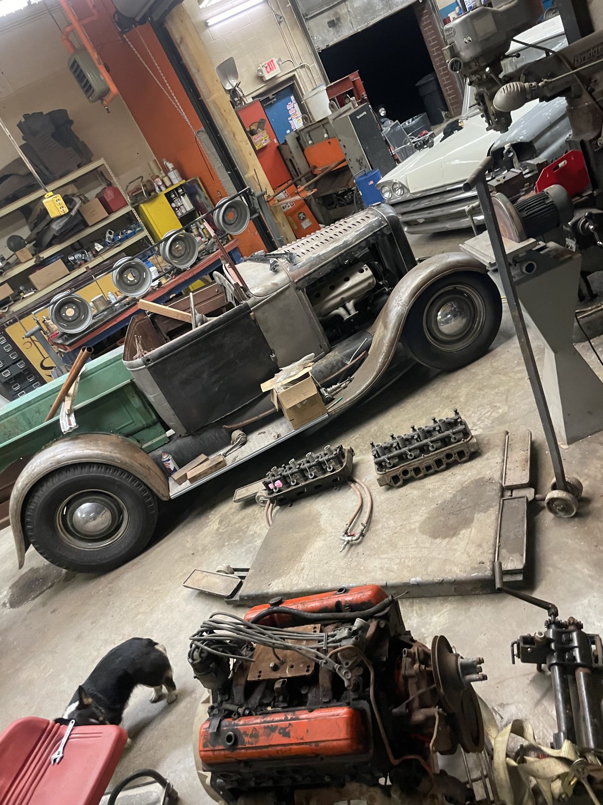

    I’m thinking of maybe just buying a replacement back panel for a real rpu and just shorten and narrow the doors. Or find real roadster doors. Are the hinges in different locations between a roadster and closed cab I wonder? They’re a grand shipped and that way I can just run a normal folding top and run side curtains. I don’t know whose roadster the red one is but I love how they gave quarter windows in the side curtain. So cool. I’m definitely having side curtains like this made.
    Originally when I did this I was thinking about making a lift off top… but after a couple summers of ripping around in the shoebox convert I want a top that is easy up and down so I can drive it in any weather. The only good time to drive a convert is so limited… No hot sun, no rain no cold… it has to be cool days or warm evenings.. otherwise it just gets uncomfortable.

    Nice wheel rotisserie.
    enloe, Tuck and daylatedollarshort like this.

    Thanks Rod, I made it back in 2012, the best part is sanding them in it you can do it standing up. I designed it to be a frame rotisserie for a hot rod and have used it for that but I made brackets for the wheels. Painted many sets on this thing..

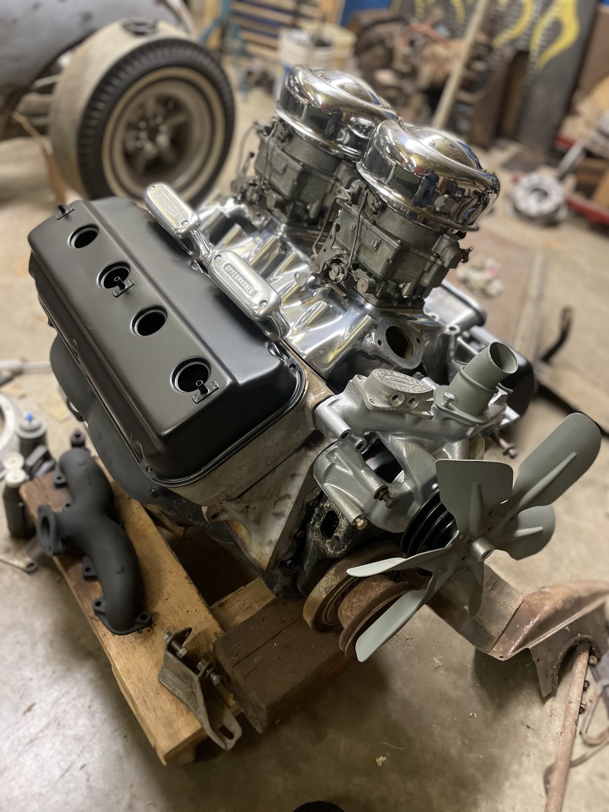

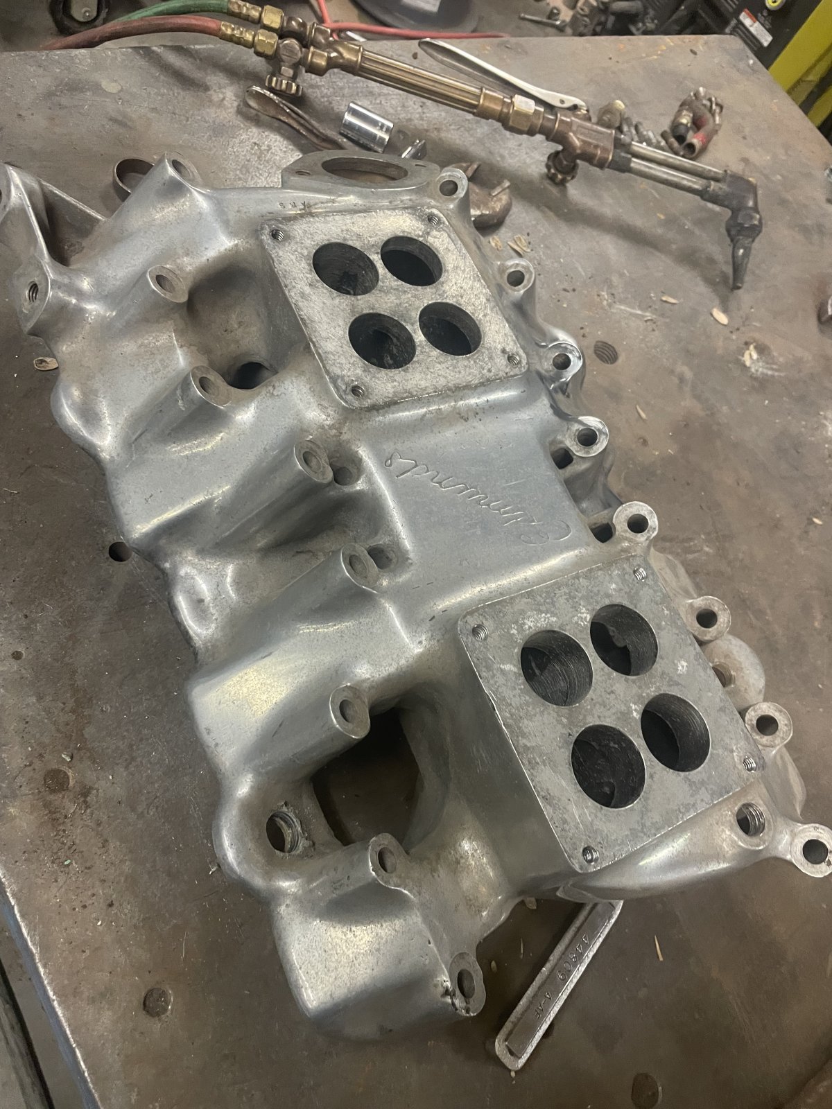

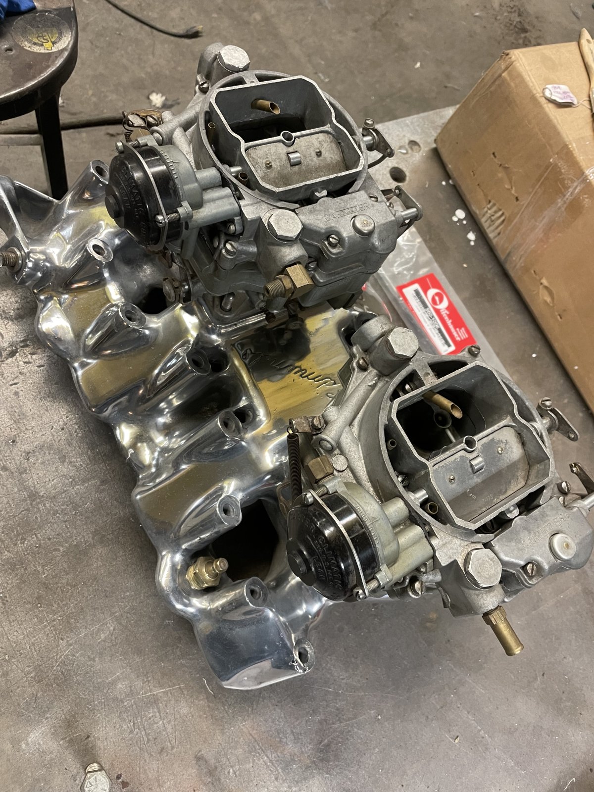

    Tore the intake down and polished it back to its former glory, it’s far from perfect but good enough.
    I need to make a finned block off plate for the thermostat as the 55 uses the one on the crossover.
    Carbs are rebuilt.

    Hey, tuck, is that fan on The hemi motor hemi specific?. And how big is It 17 or 18 inches? As it's got a nice curve to it and shape.

    I built this truck with the yblock because I had it at the time, it was after the shop fire. I like y-blocks but they’re not as cool or traditionally as common in an open car like this than they are in a shoebox coupe or a kustom. I decided to put the yblock in a shoebox. I measured one day and realized with an adapter the hemi was almost a perfect fit. I just need to change the mounts and fully box the rails.
    the normal hemi fan is a 4 blade and ugly, I have one I cut down on my roadster, this six blade came off a 1956 plymouth with a 6. I’ll measure it, it’s not as wide as a 4 blade. The fans are interchangeable. (Lots of parts are)

    Tim, I’m boxing for the added weight and the 250+ Hp for sure. I should’ve done it in the first place but it’ll be easy to do- I boxed the side with the steering box because it’s cross steer. The cragar adapter I got is *****en because it puts the starter on the other side so I can retain my cross steer setup… and these cast iron manifold are center dump straight down… shouldn’t have any clearance issues. (Maybe the hood??:eek:) we will know soon enough!
    I'm planning on running the cast iron manifolds and then straight pipes out the back hooked to a pair of chrome kick stand pipes under the running boards.
    The air cleaners I have on top of those carbs, the base is not the right size but I found these through vintage speed. They're cast and the outside is polished. One more thing to check off the list. Waiting for the gaskets for the base of the carbs... had some and lost them- I'll find them after the new ones show up. I can't wait to get the intake turn key.
