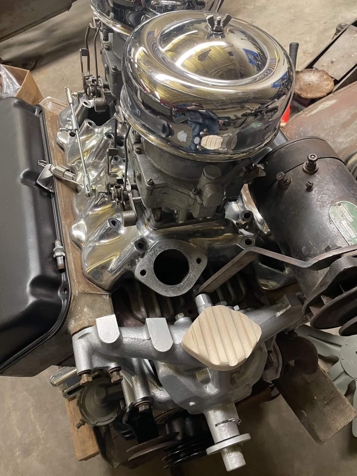

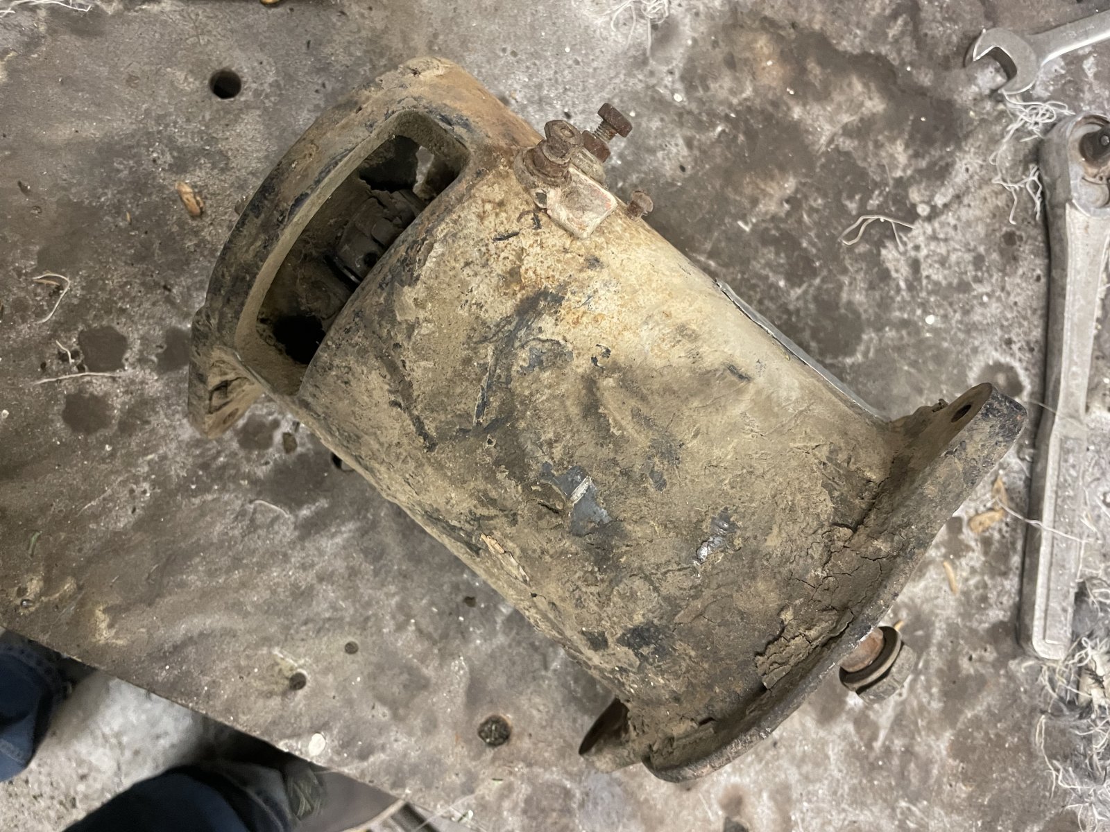

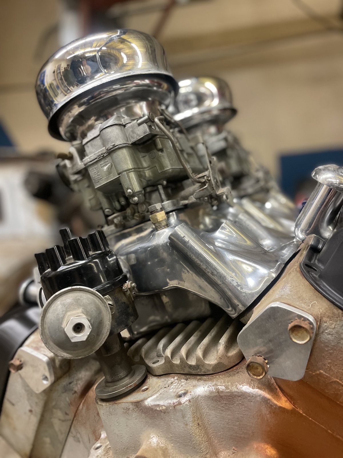

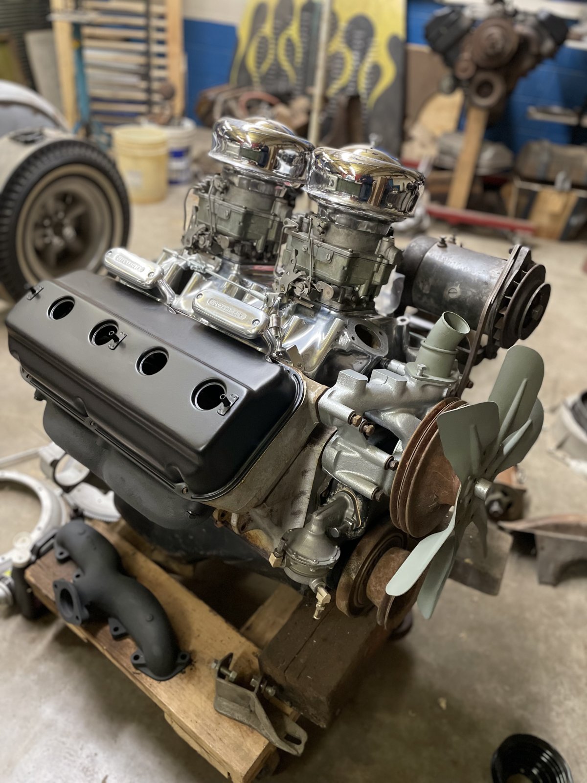

    This greasy thing showed up today… missing the cover band and the pulley… thankfully I saved a ton of stuff from the shop fire and had a burned 57 hemi gen that I borrowed the missing parts from. I also had the brackets.

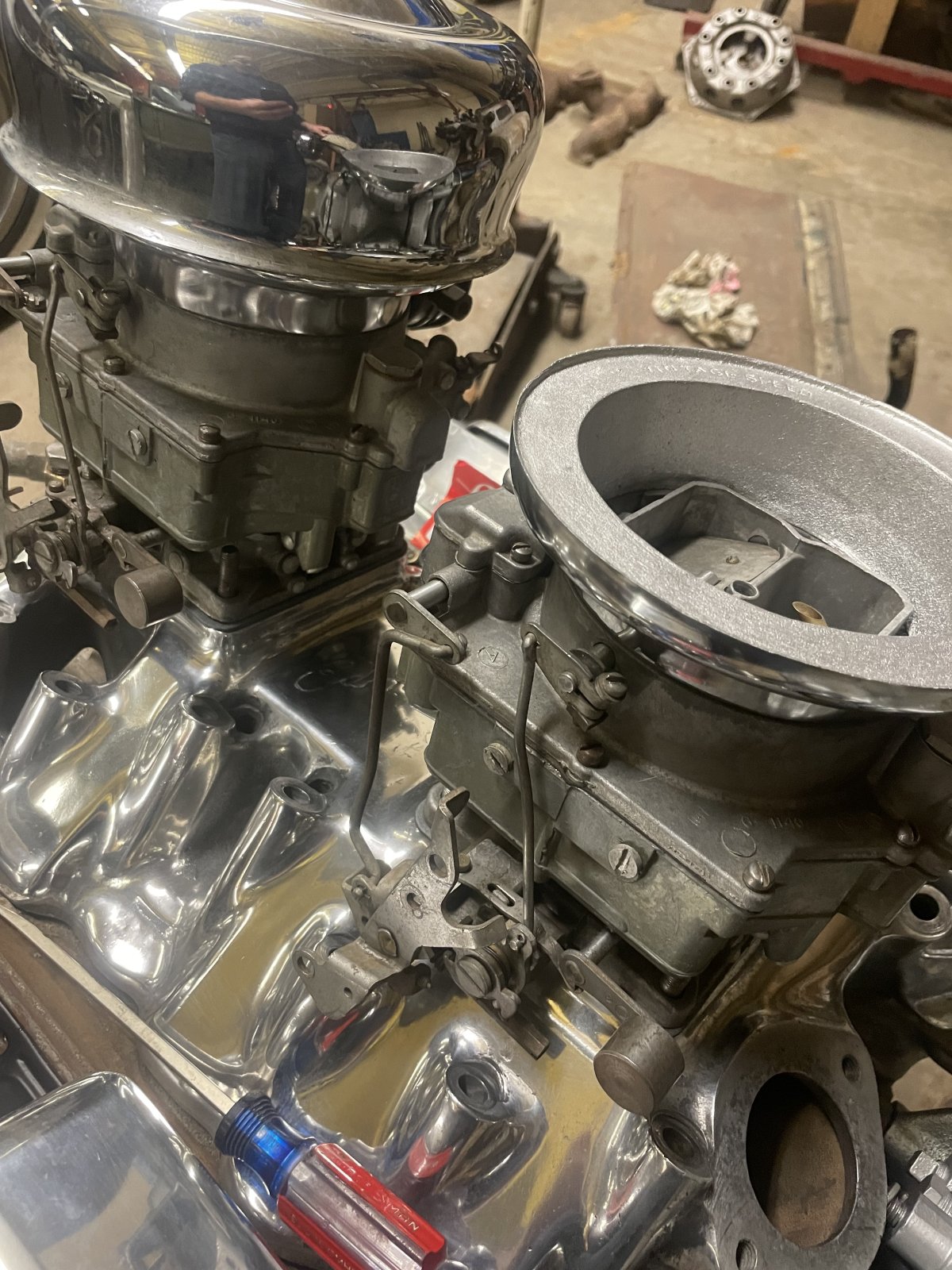

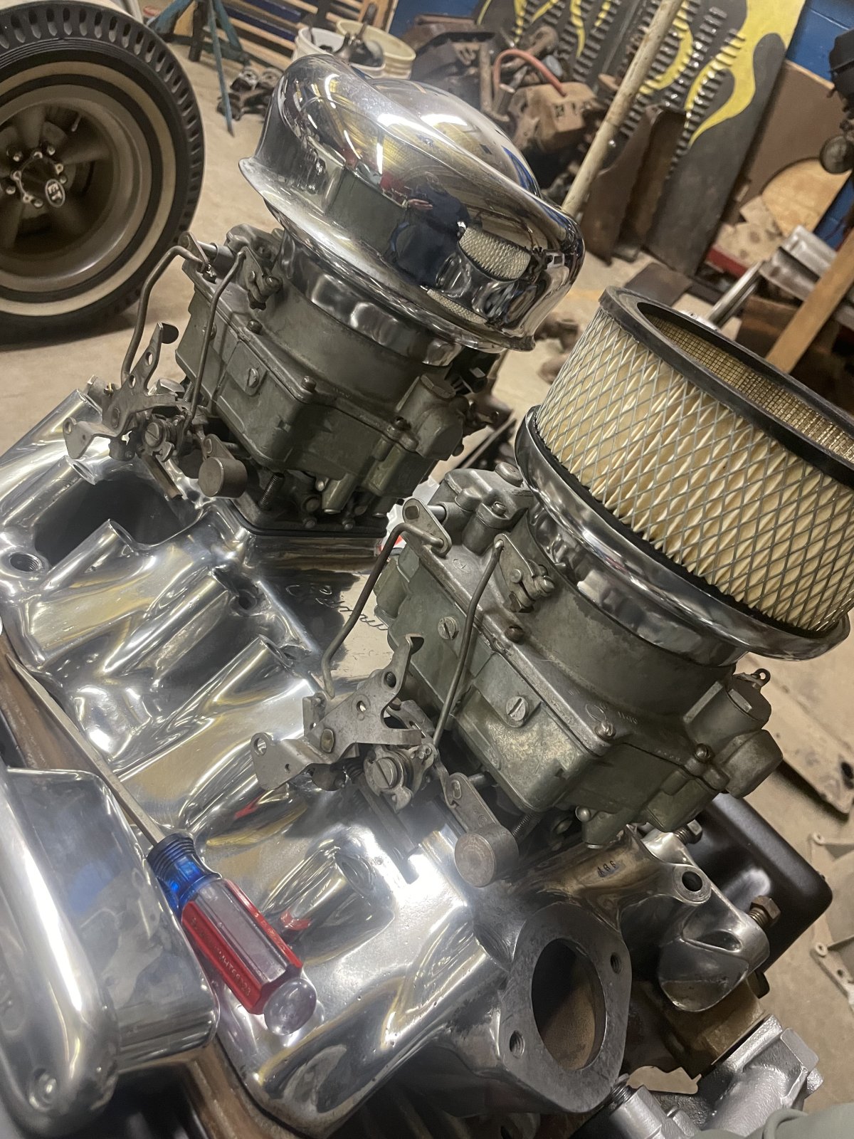

    Got the linkage on the carbs and picked up return springs. Also bolted up the new fuel pump with hose fittings.

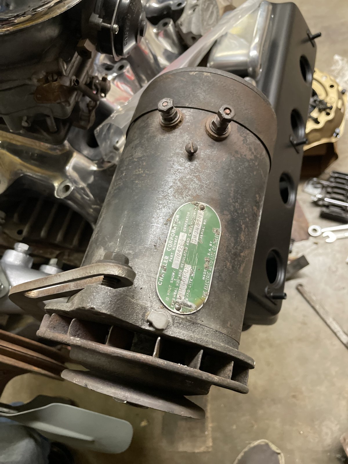

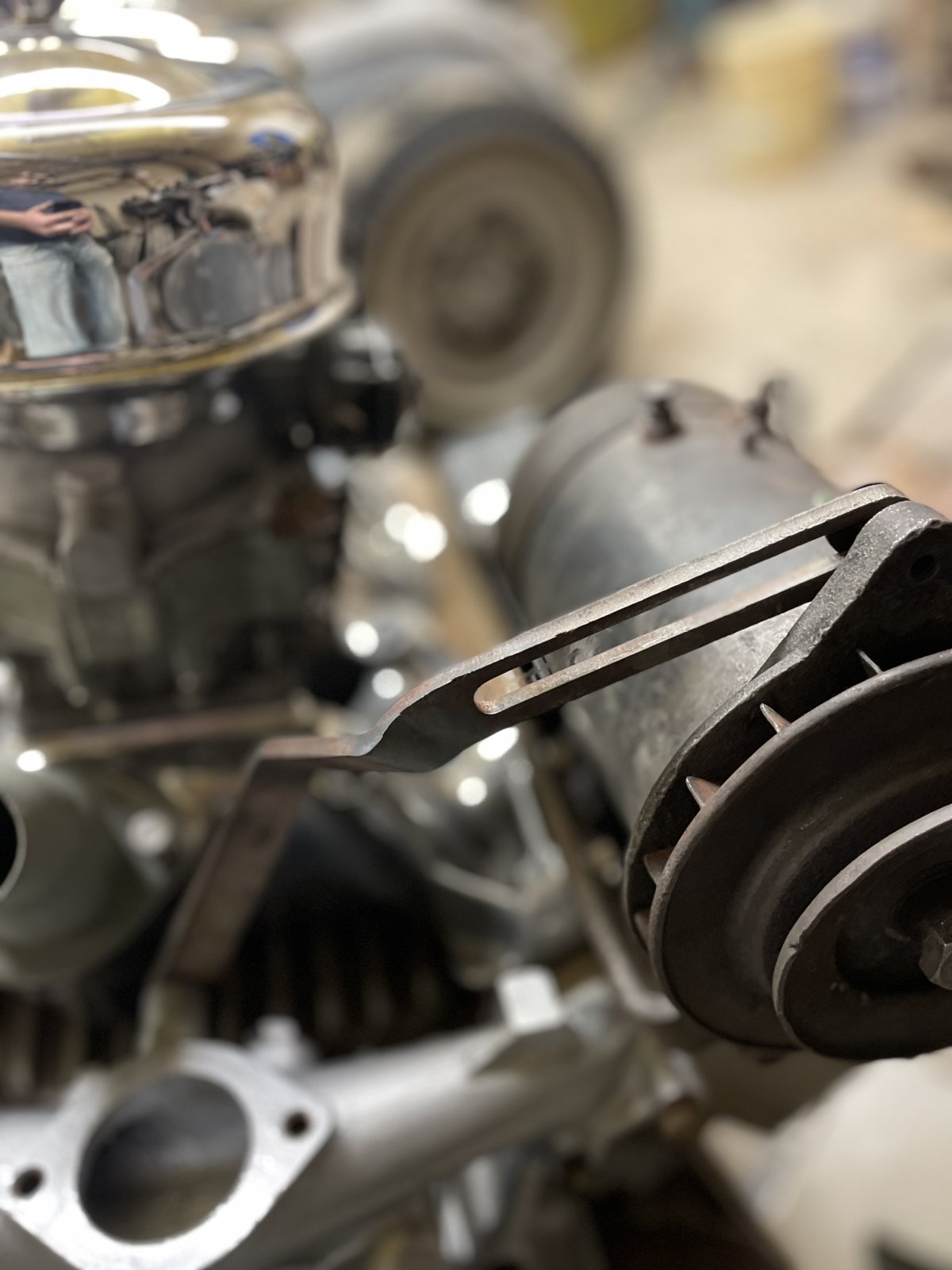

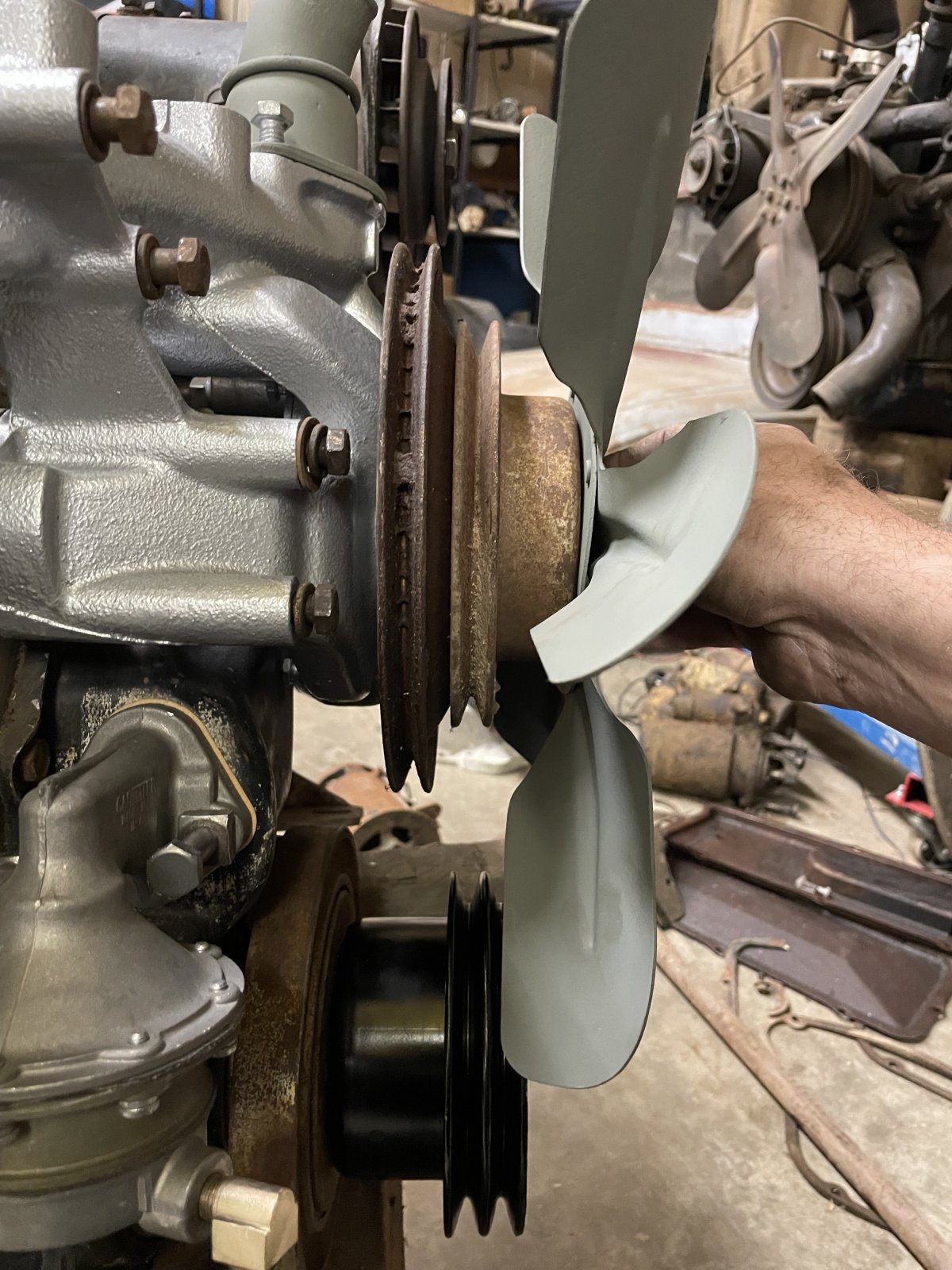

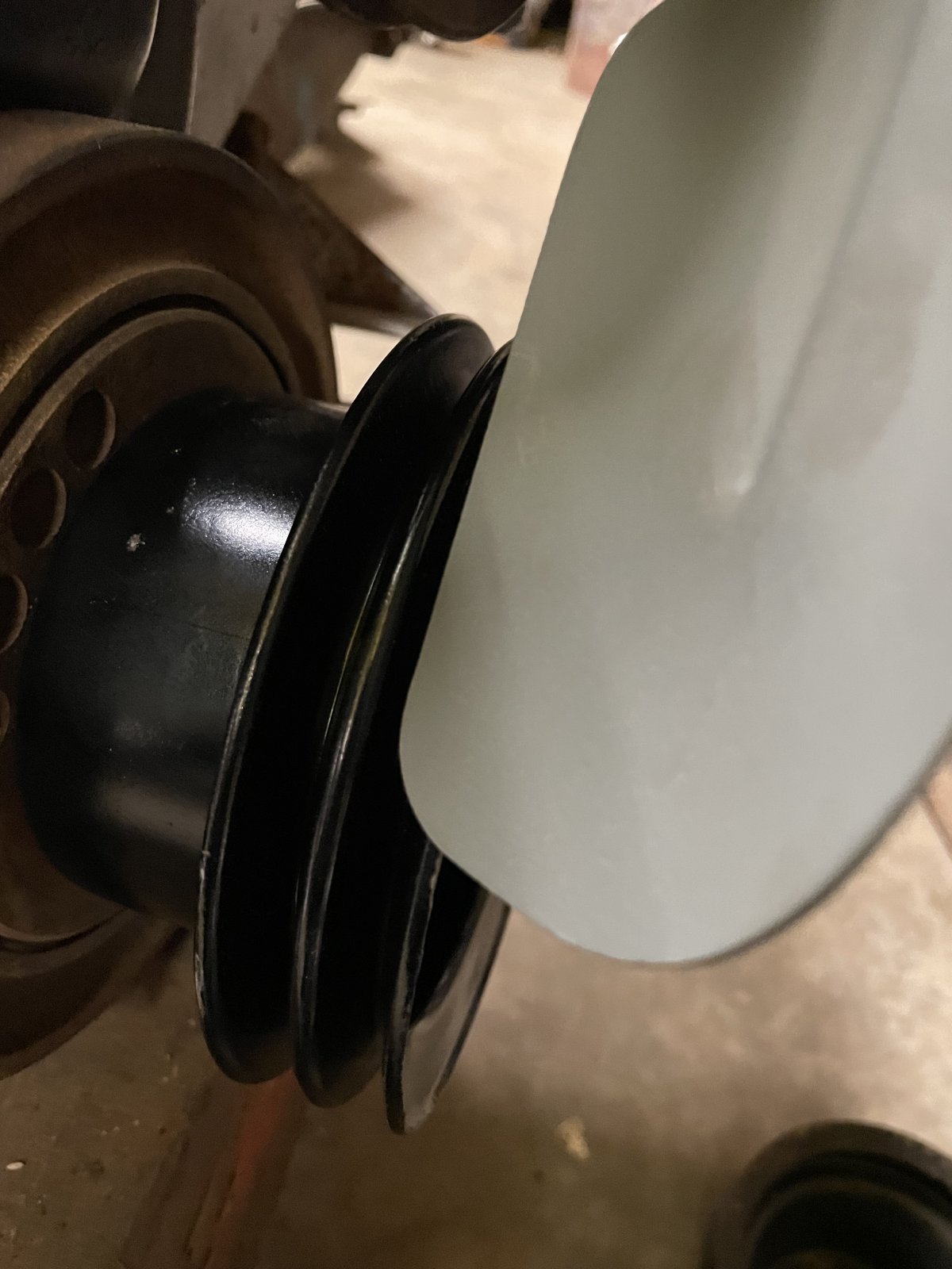

    I need to trim the bottom pulley down to a single groove in the lathe, I have a single pulley bottom but it doesn’t come out far enough to line up with this other pulley.. the generator is 57, the water pump pulley is 53 and the crank pulley is 55. Thank god I’ve been collecting pulleys… I was mix and matching but this setup works with no shimming.
    Charlie price adapters for these air cleaners showed up so they fit the base of the Carters. Picked up some 1/4-20 rod and stainless wing nuts and got this checked off the list. Carb gaskets showed up and I have block off plates for the rear of the heads.

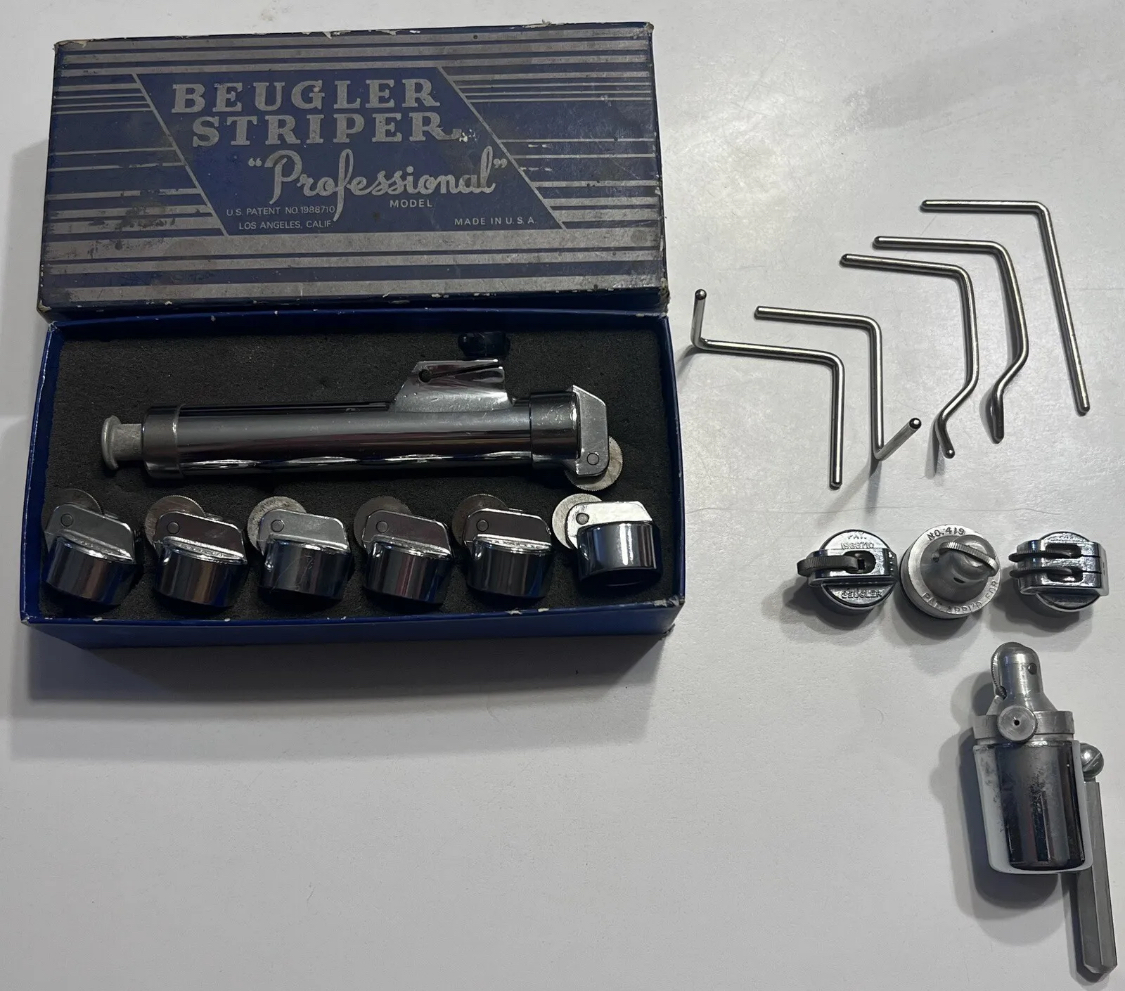

    I also bought a beugler so I can pinstripe my wheels. I’m going to make a fixture that fits in the center of the wheel so they all turn out the same. I used to have one I got from Perry Lindberg but lost it in the shop fire. Excited to get another one! IMG_5962.jpeg

    Tuck, you can actually take a Gm fuel pump that is the carter style and use the insides to rebuilt that one,ive had those laying around before to scavenge for parts, or you can buy a rebuilt kit for it too.

    Thanks Jeff that’s great to know! I found a place that sells kits for these, I’m ordering two of them.. I found another one of these Carter pumps on one of my other hemi’s, I'm going to need one for my 29 roadster too. They’re the same from 51-55 hemi it looks like.

    My dad has a Beugler he "borrowed" from Ford back when they used them in the plant! I "pinstriped" my 51 dash with it back when I was like 17. Looked like **** but I thought it ruled! Haha!

  15. I nabbed this one from my late father’s stash years ago! The little booklet is super neat! IMG_3407.jpeg

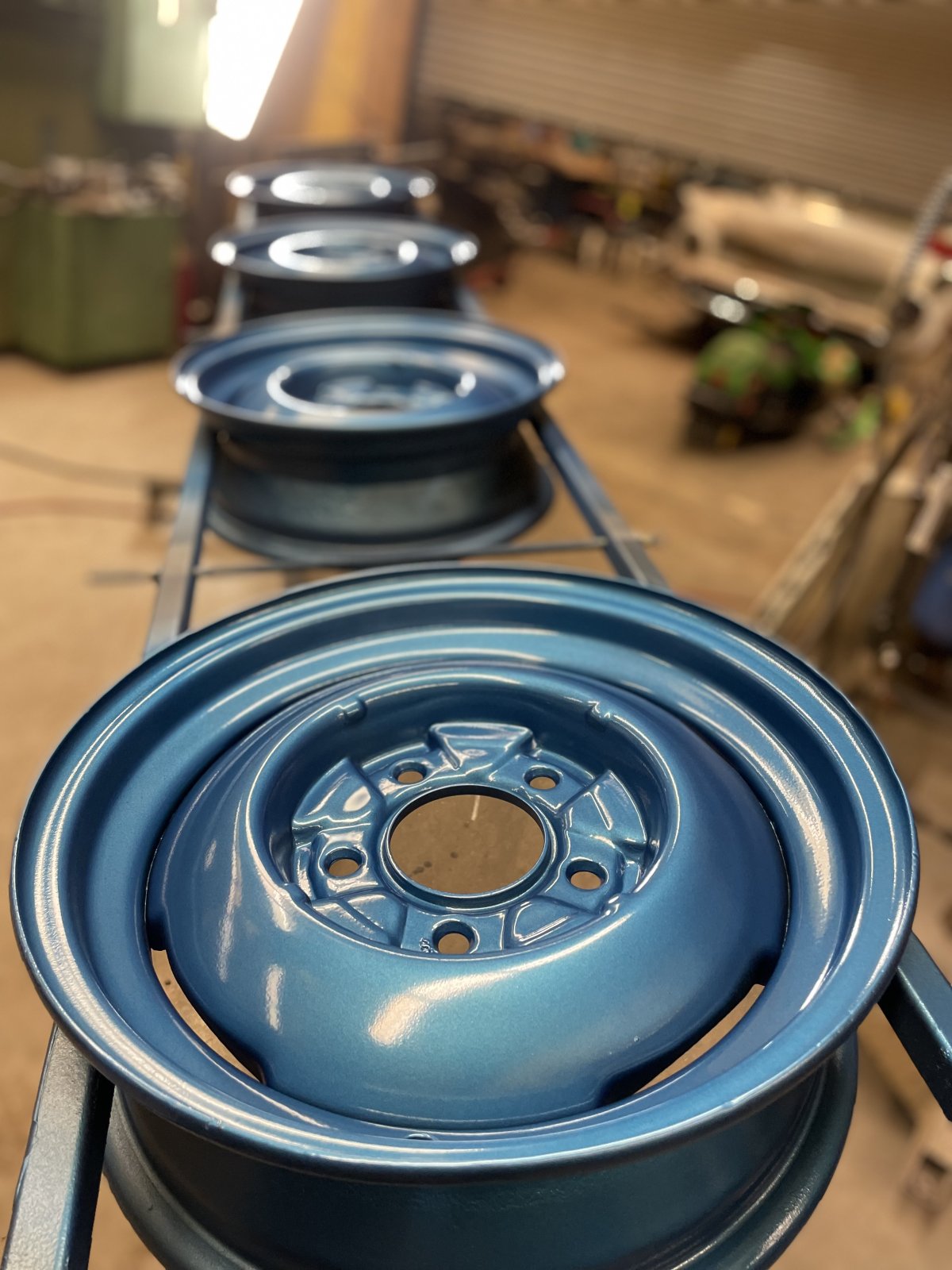

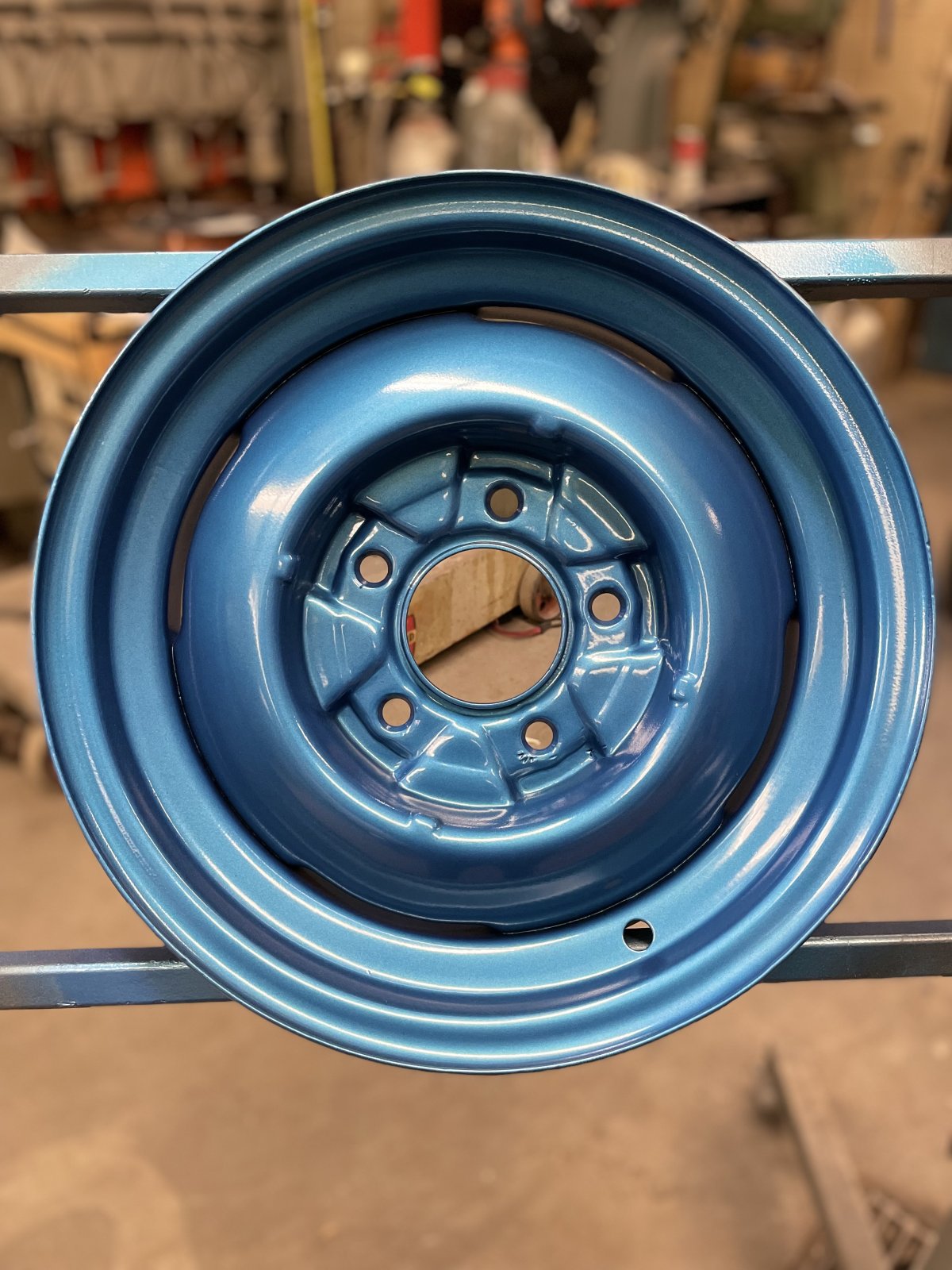

    Color reveal, Clear coat lacquer is next…

  20. Speedy Canuck
    Joined: Jun 3, 2010
    Posts: 3,896
    Speedy Canuck
    My sentiments exactly.
    flatout51 and Tuck like this.

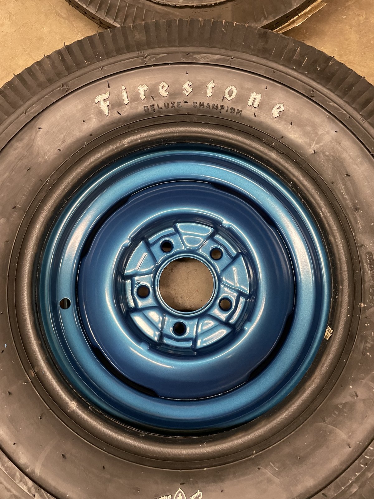

    Dude…, I love it so much! Such a good 1960’s blue. I can’t wait to paint more parts blue!

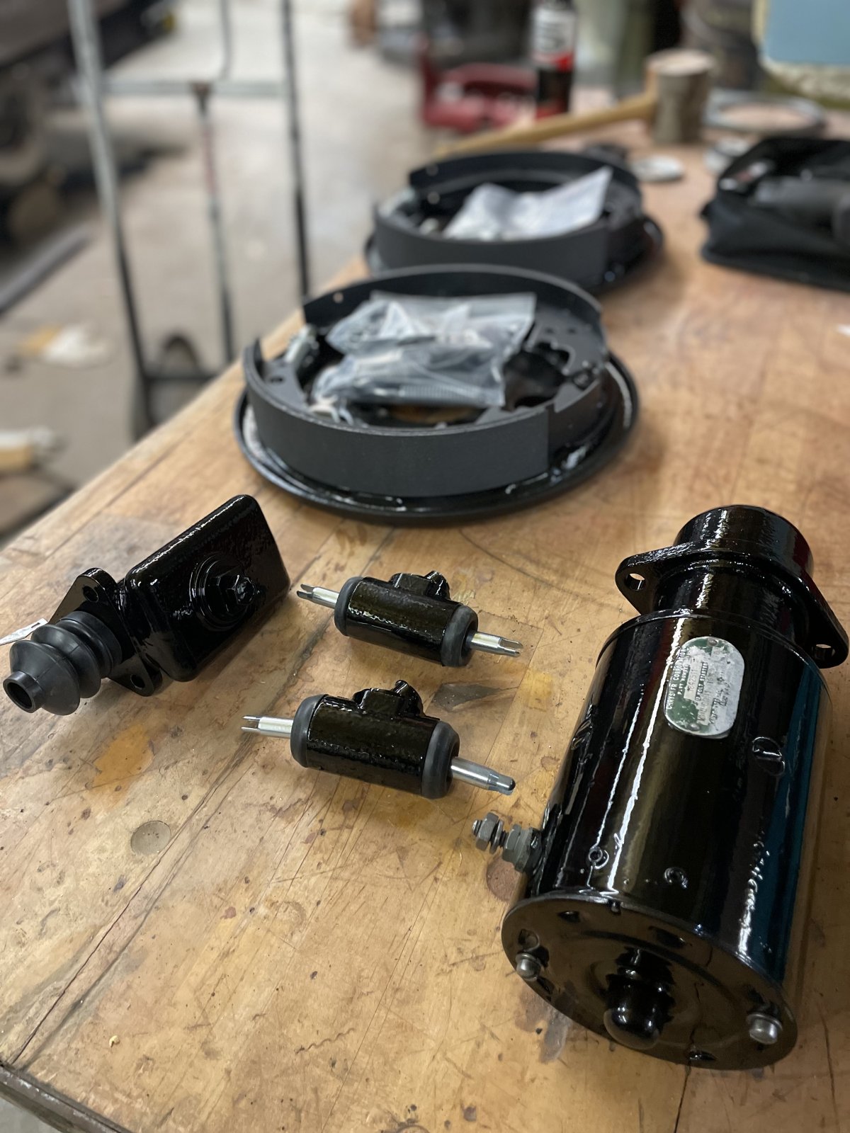

    I painted the master cylinder and the wheel cylinders along with the starter tonight in black polyurethane enamel.
    FUN!

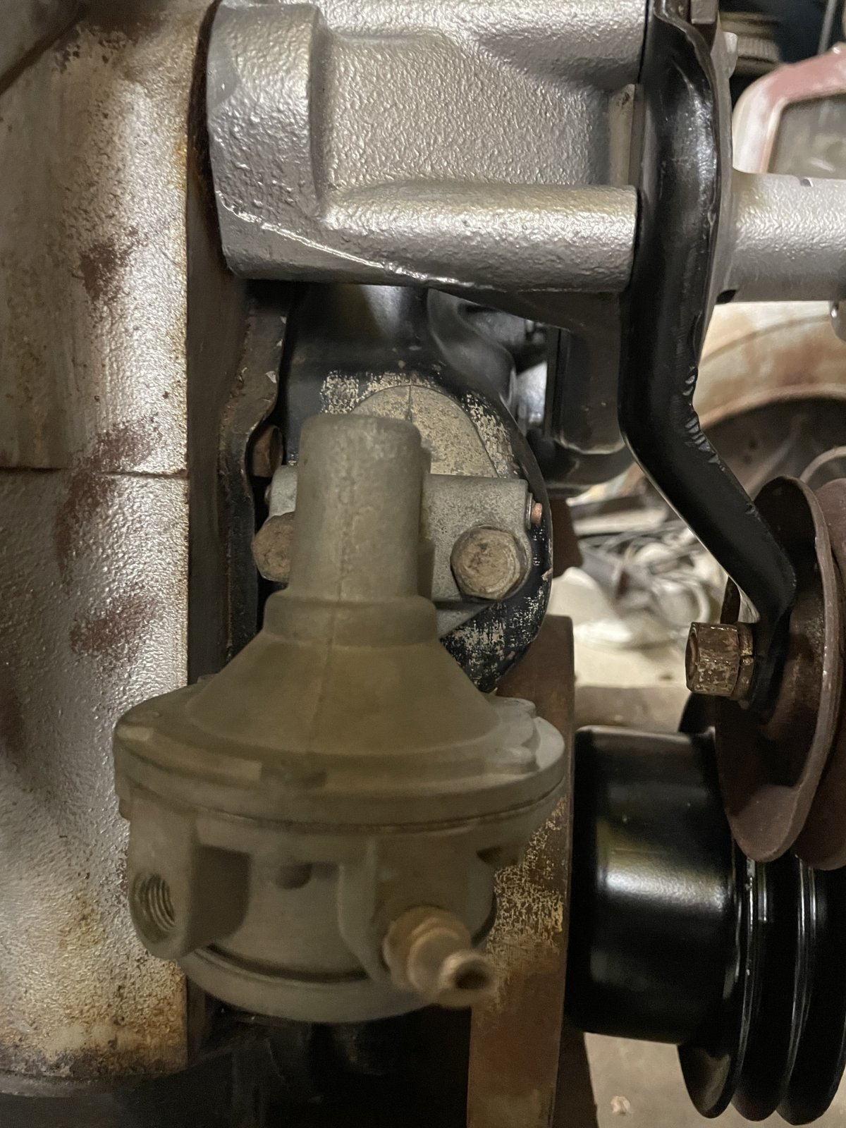

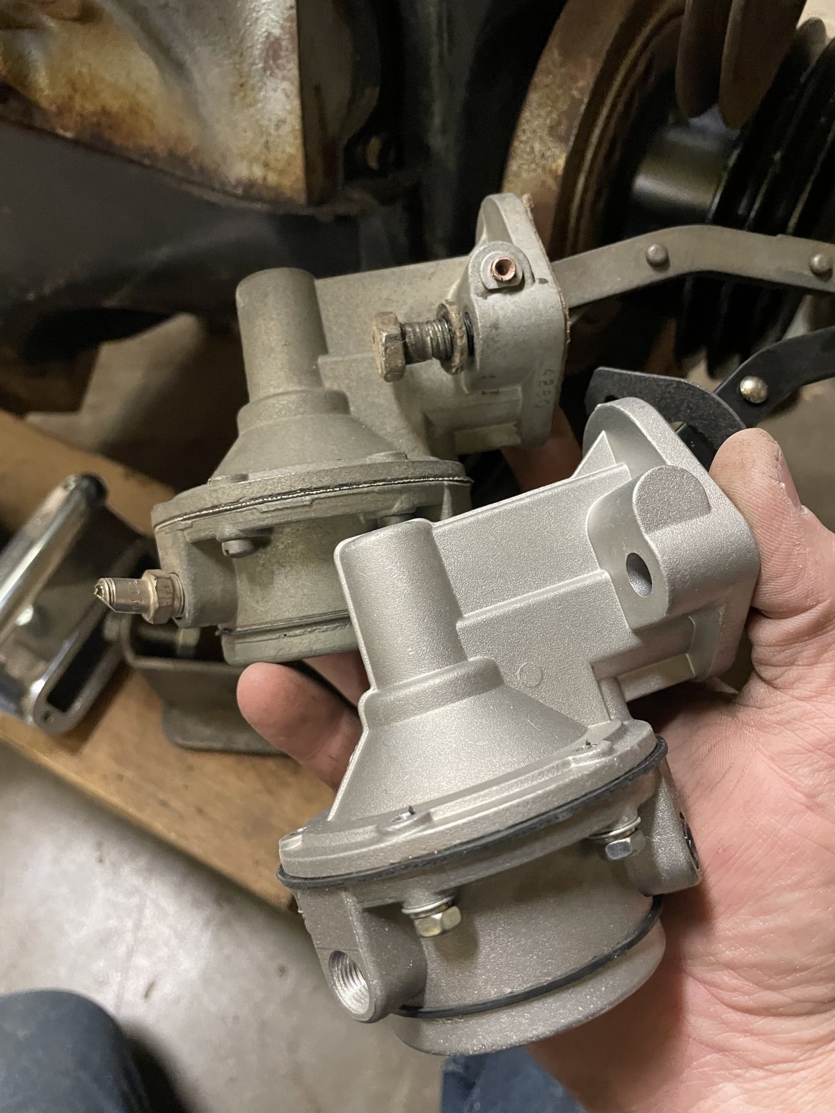

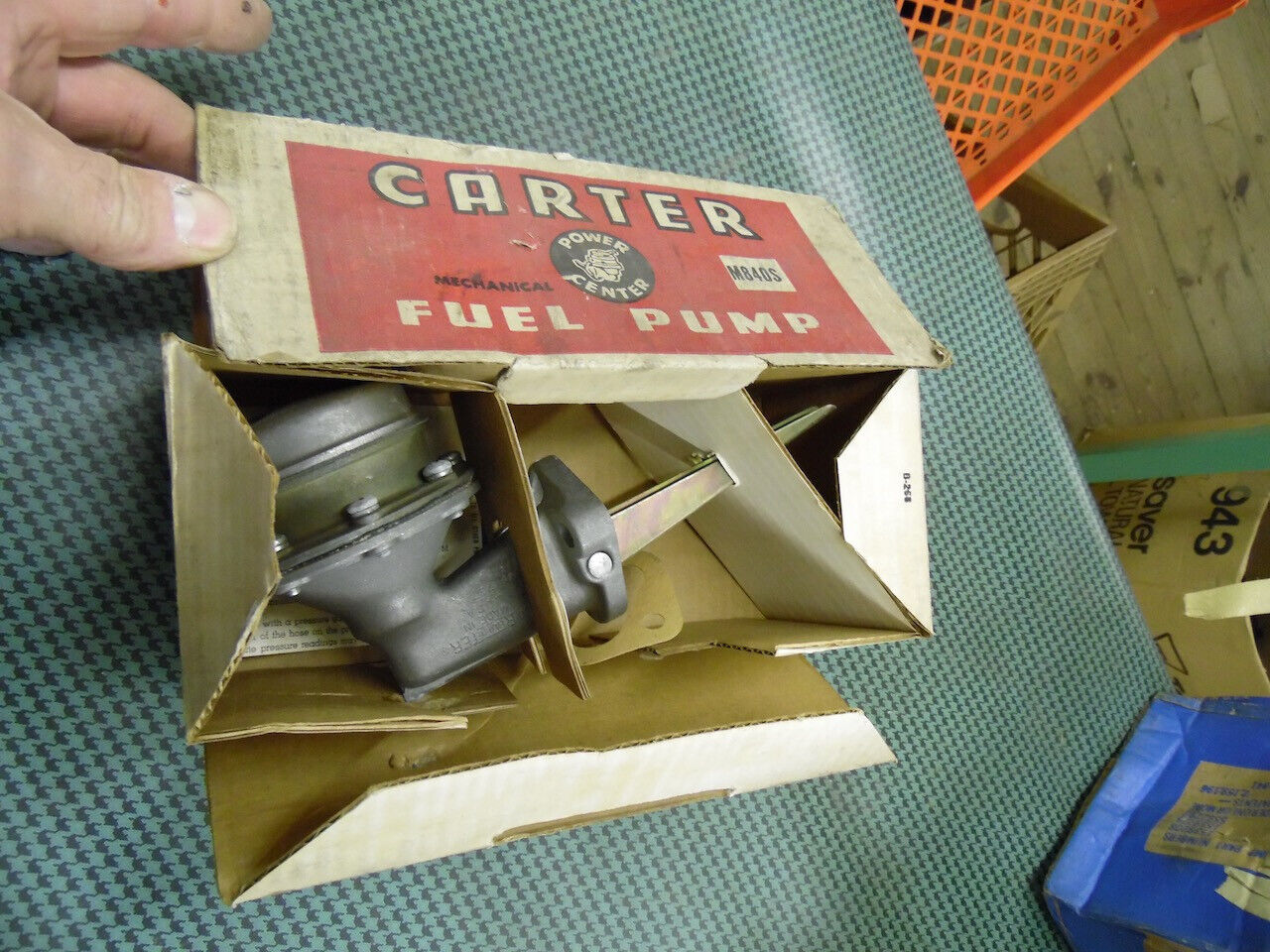

    The fuel pump I got said 51-55, but… I had another parts motor that’s a 55 block and pulled the pump and it was different. So did some research,.. and found a remanufactured one on eBay. I’m going to rebuild the NOS one I picked up and run it in my roadster.
    Heated and bent the gen bracket into place.

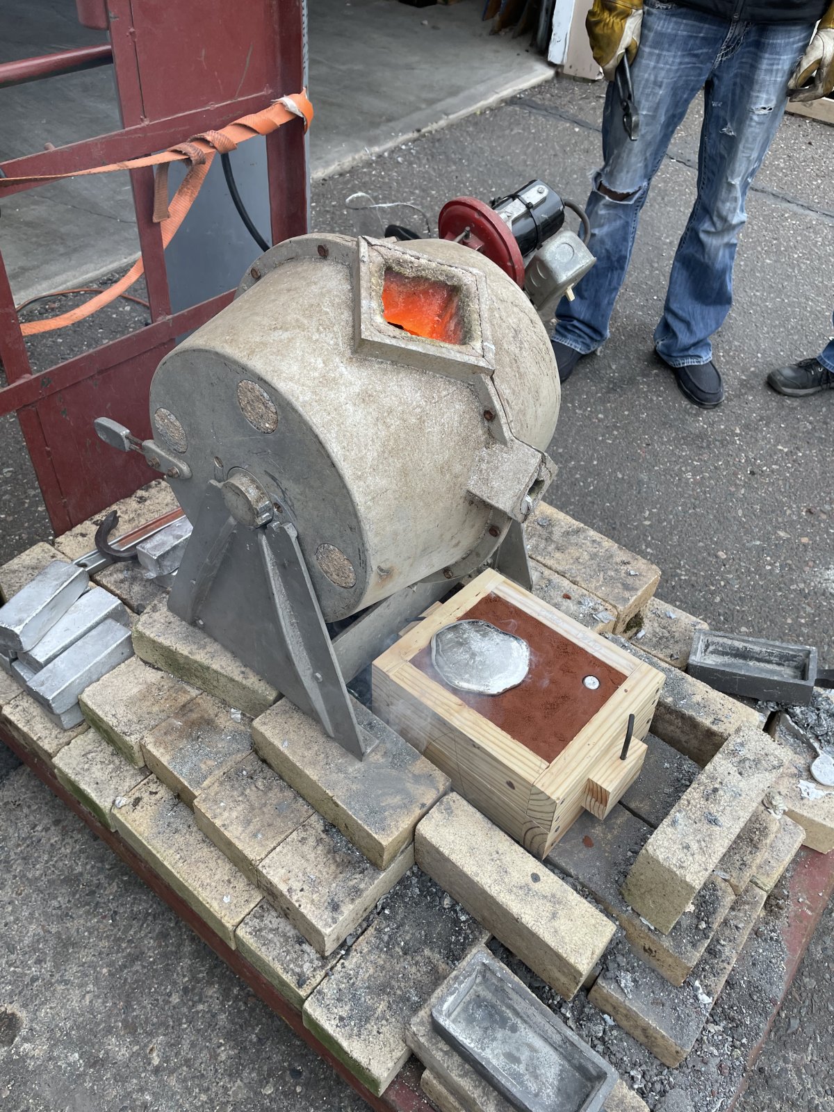

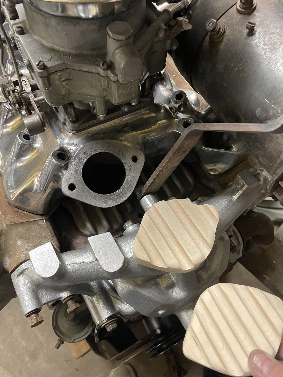

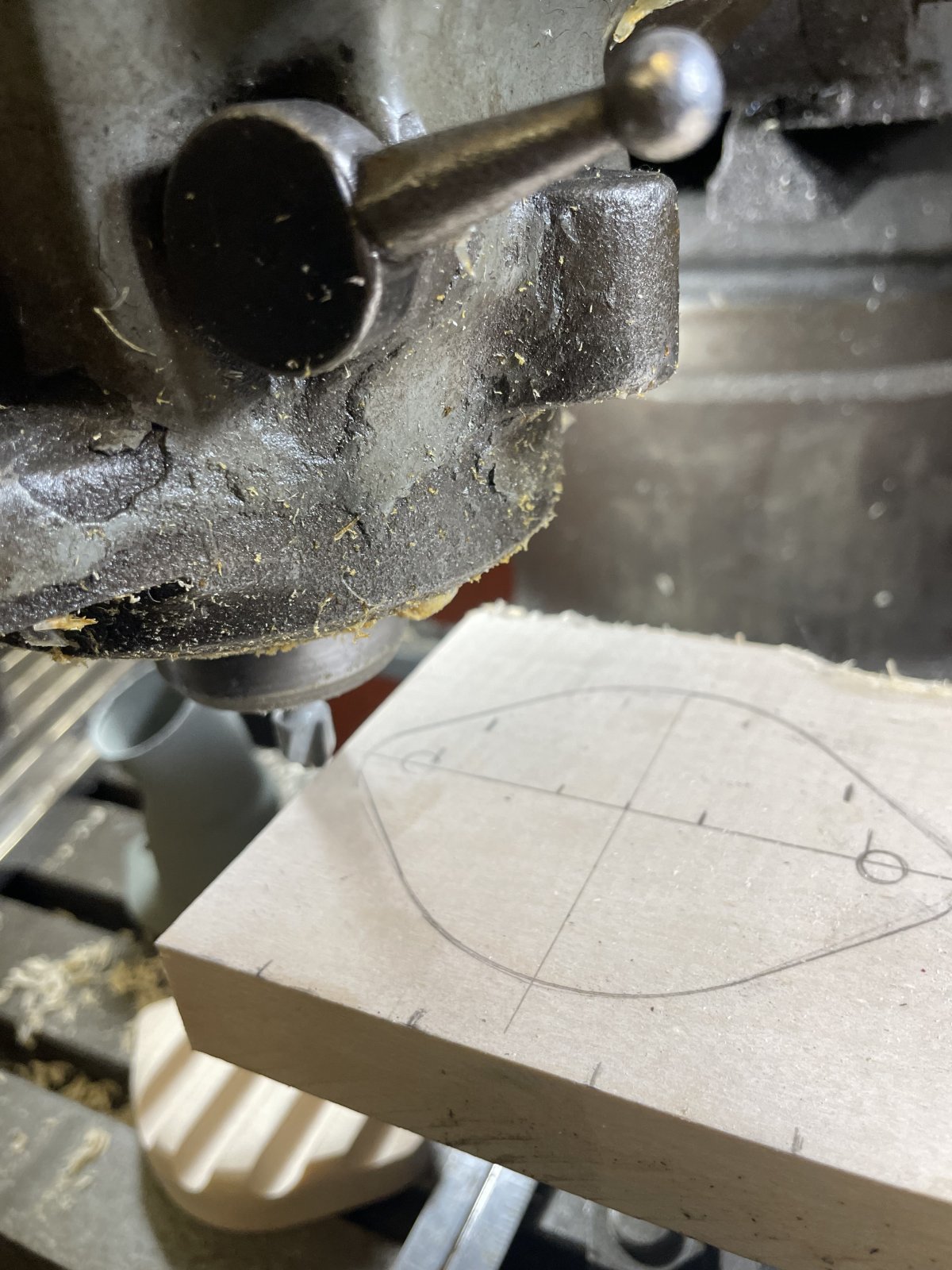

    Making a simple sand cast pattern out of maple for one of my block off plates… didn’t like the fin orientation on the first one so I changed it so in case I decide to mill off the outer find there will be 3 fins. Making it thick so I can mill the bottom nice and flat. I’ll probably radius the edges of the fins a lot more and primer surface it.
    I’ll pour it using my mini mite on Monday when my cl*** is casting.

    -the new pump showed up and it’s a new casting… not sure who is making these. It looks good.

    Thanks Tim. It’s made from maple. It’s a hard hardwood that you can mill easily with router bits and shape with sandpaper.
    -that fuel block was one of my students- that pattern was made from a 3d print. I could’ve 3d printed this too but it takes too damn long for such a simple design.
    I might make my own fuel block for this. It would be fun to make a mold with a core.
