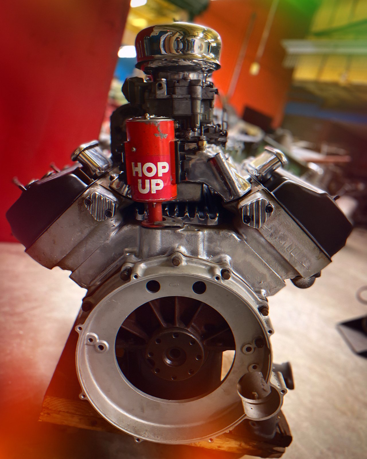

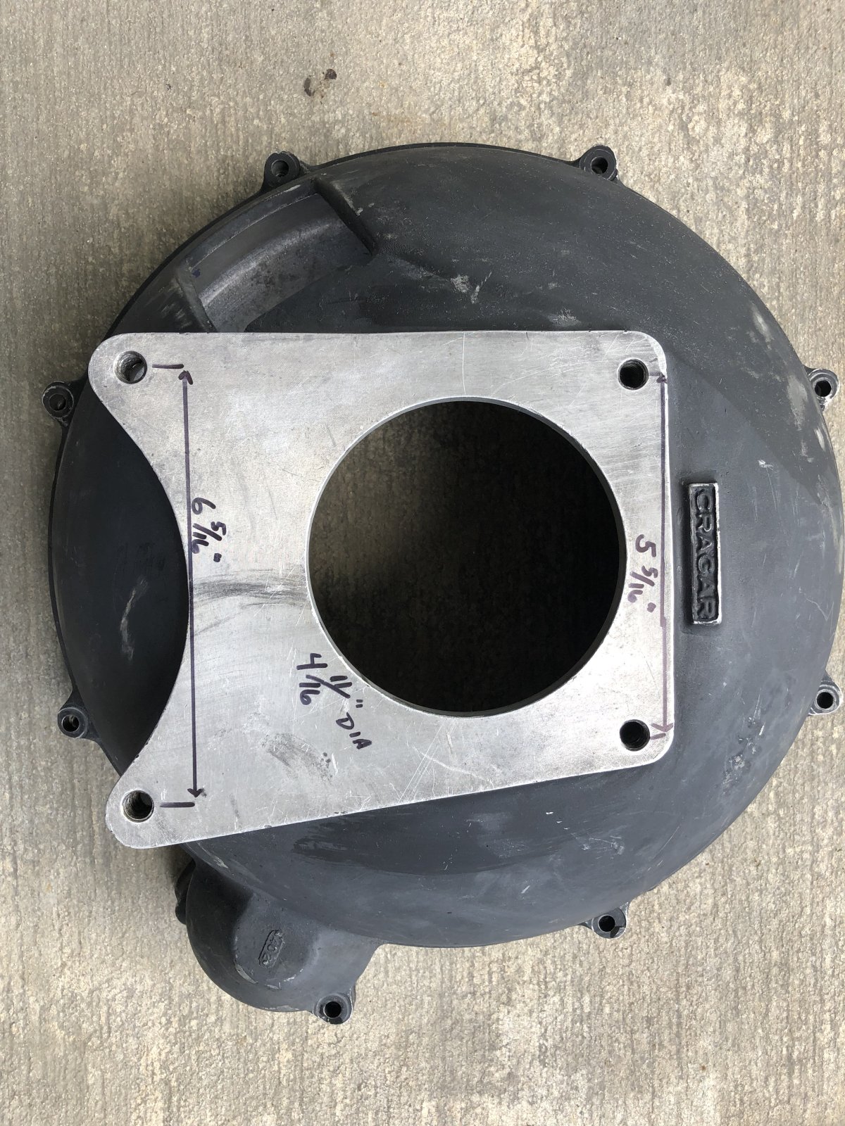

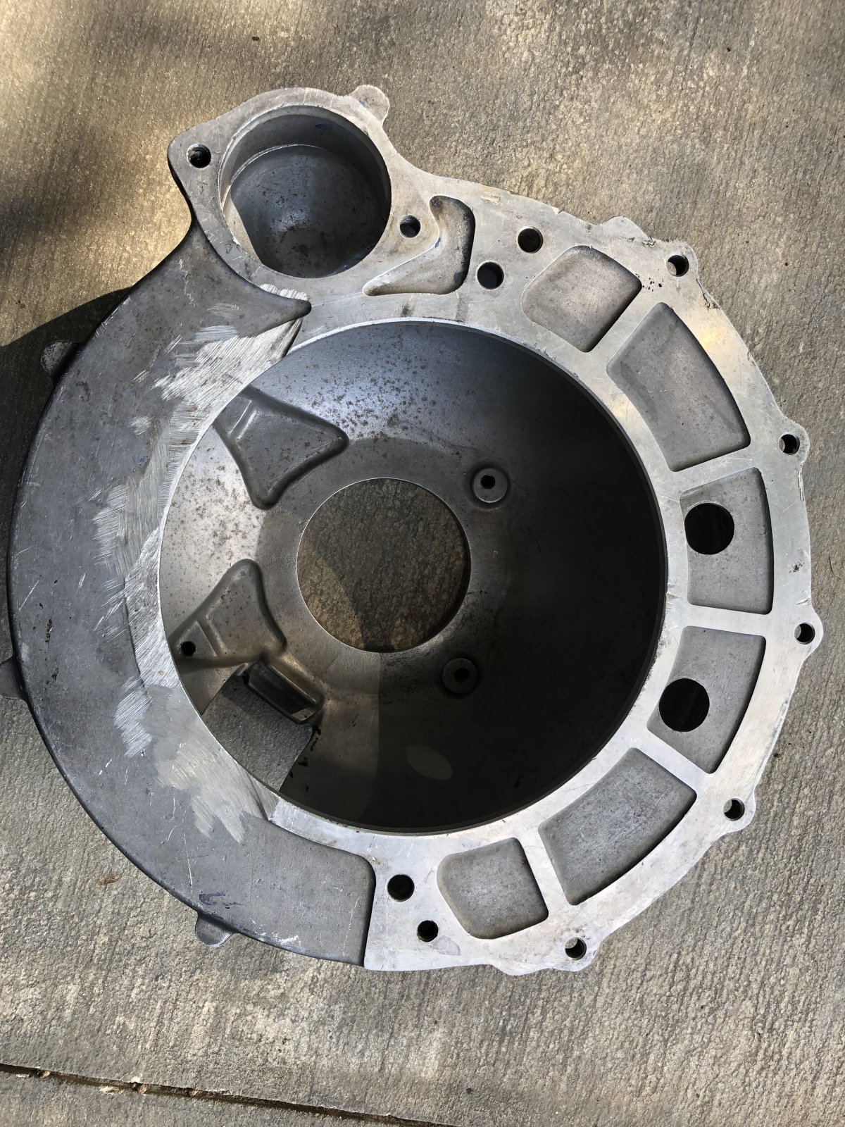

    This has nothing to do with this thread except for the hemi. I got this Hemi adapter from Fritz Christ in the cl***ified along with the cragar to early ford I’m running on this one.
    I wanted to put this hemi in my shoebox convert but couldn’t find an adapter like this… looked and looked… Then when I go ahead and decide to put it in my truck and this one pops up haha. So I got it.
    This is how having a pile of parts you don’t really NEED starts… :eek:

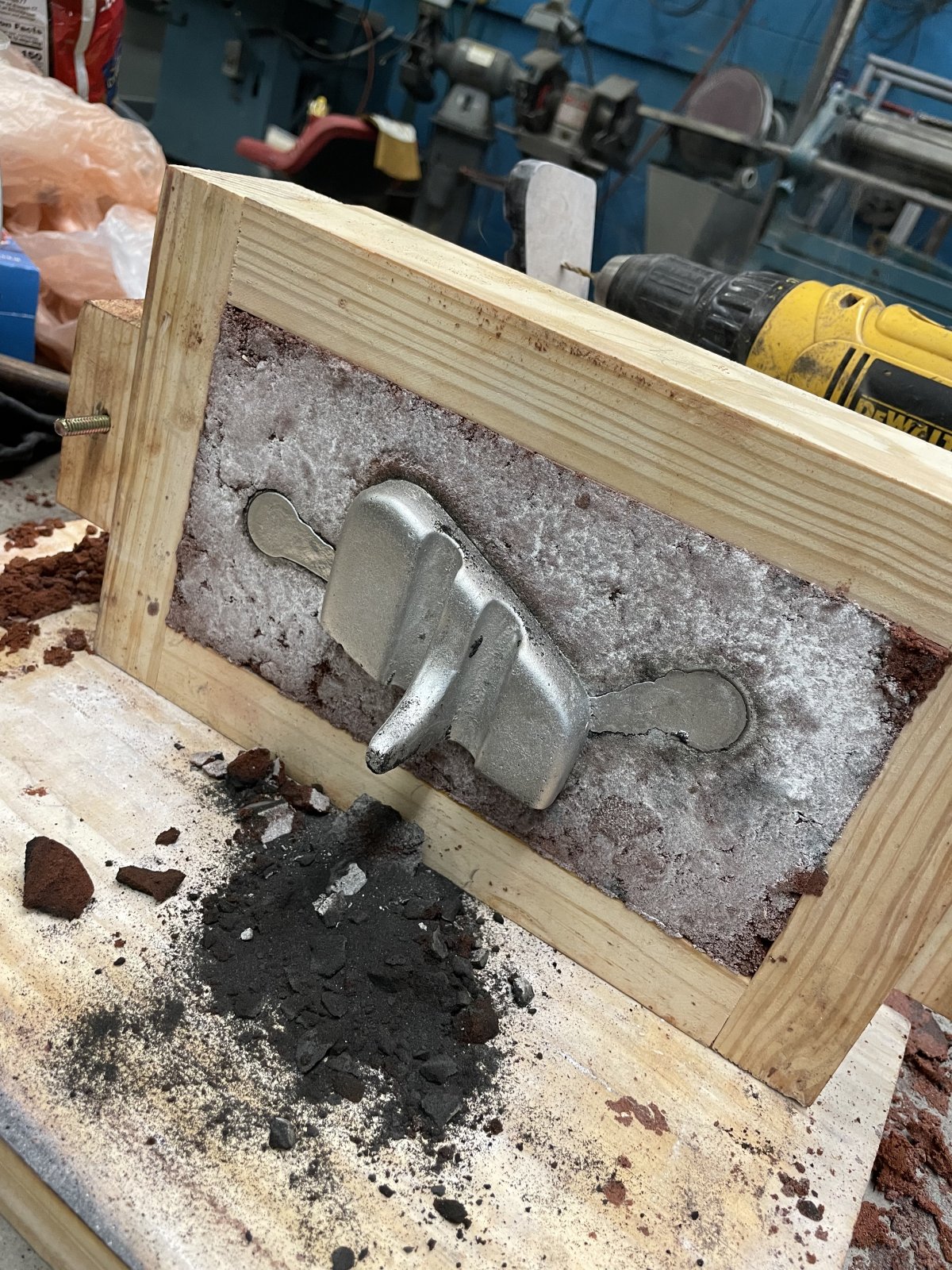

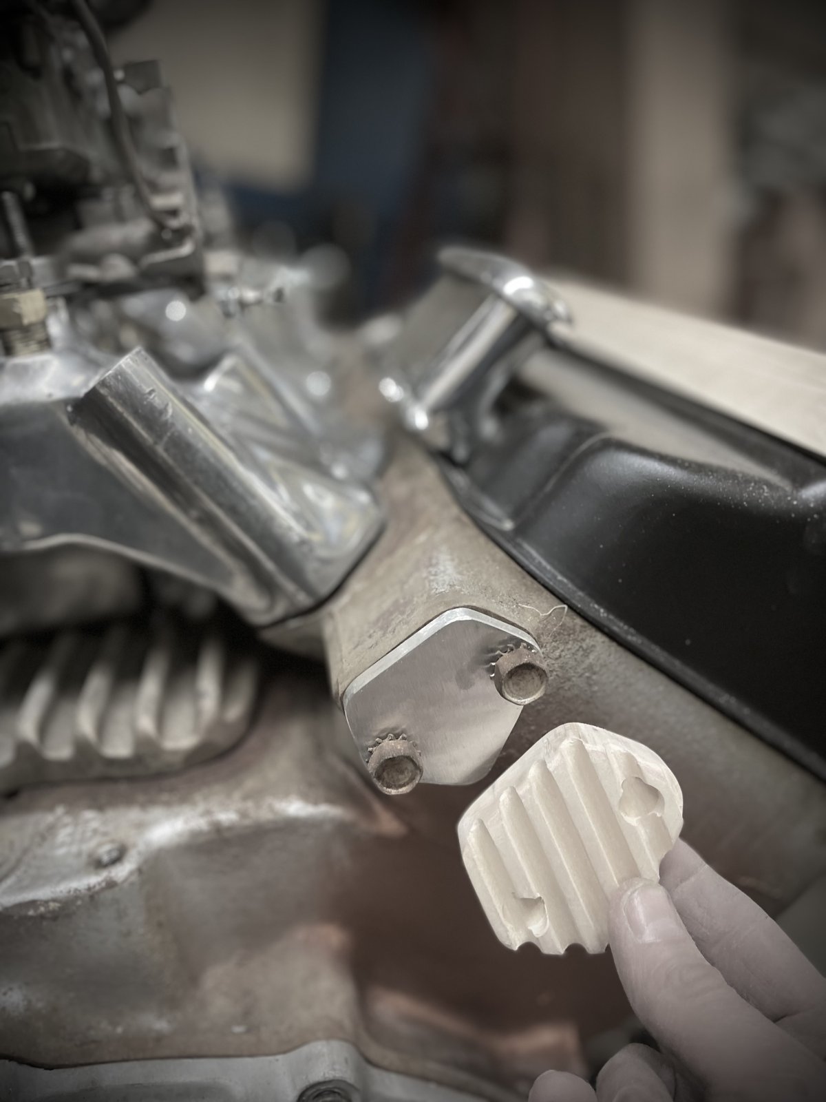

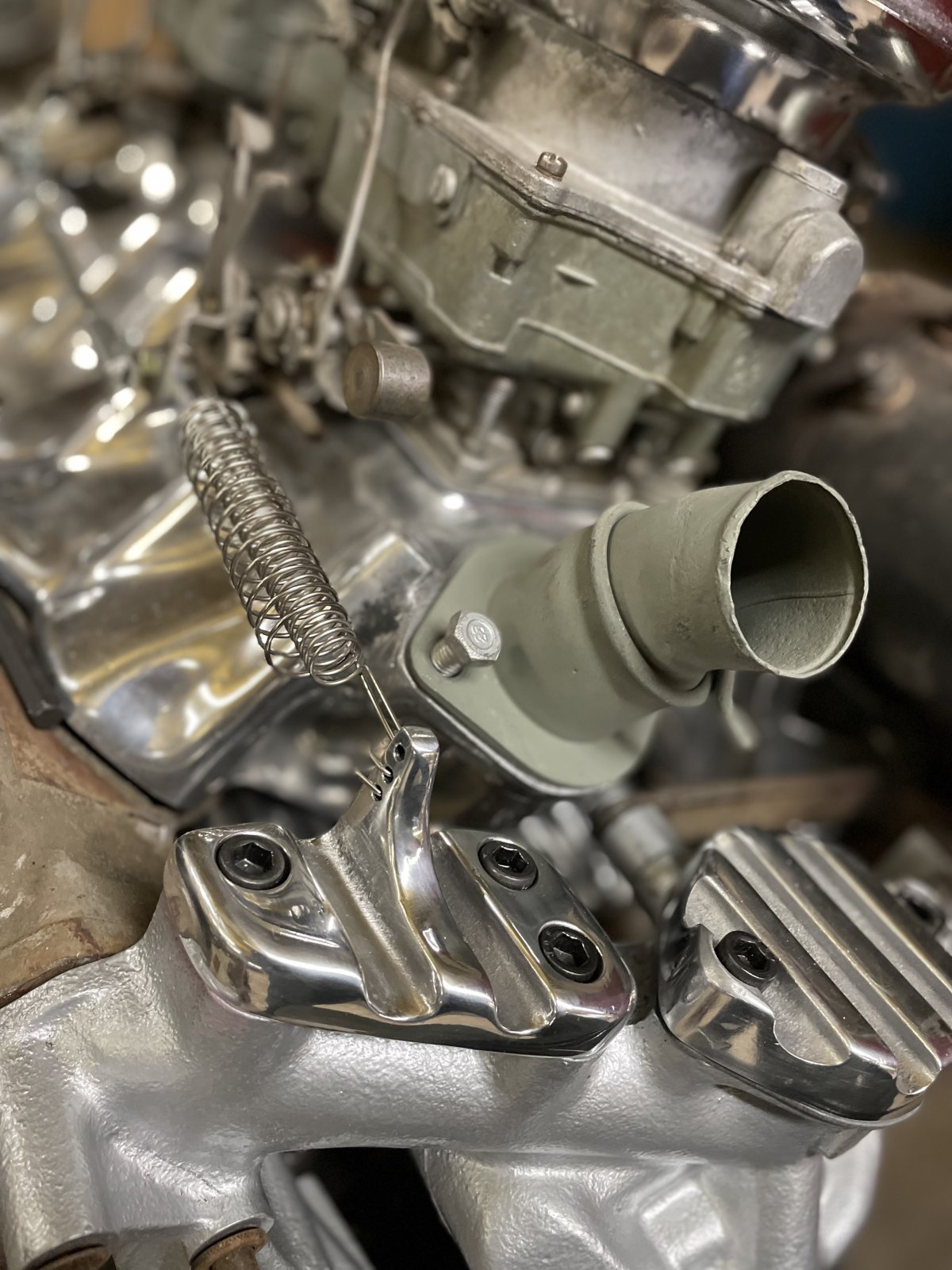

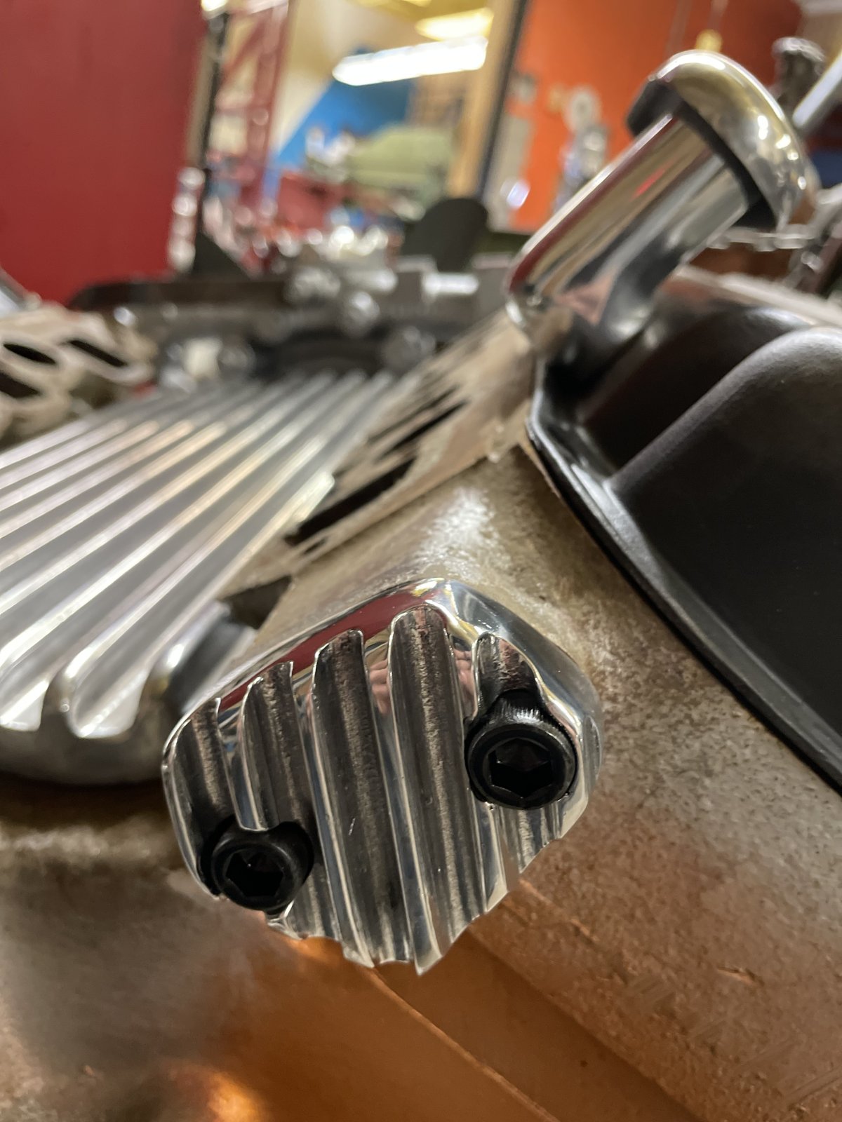

    I decided to cast some block off plates instead of the flat aluminum stand ins for the rear water ports since I can pour these all the same day.

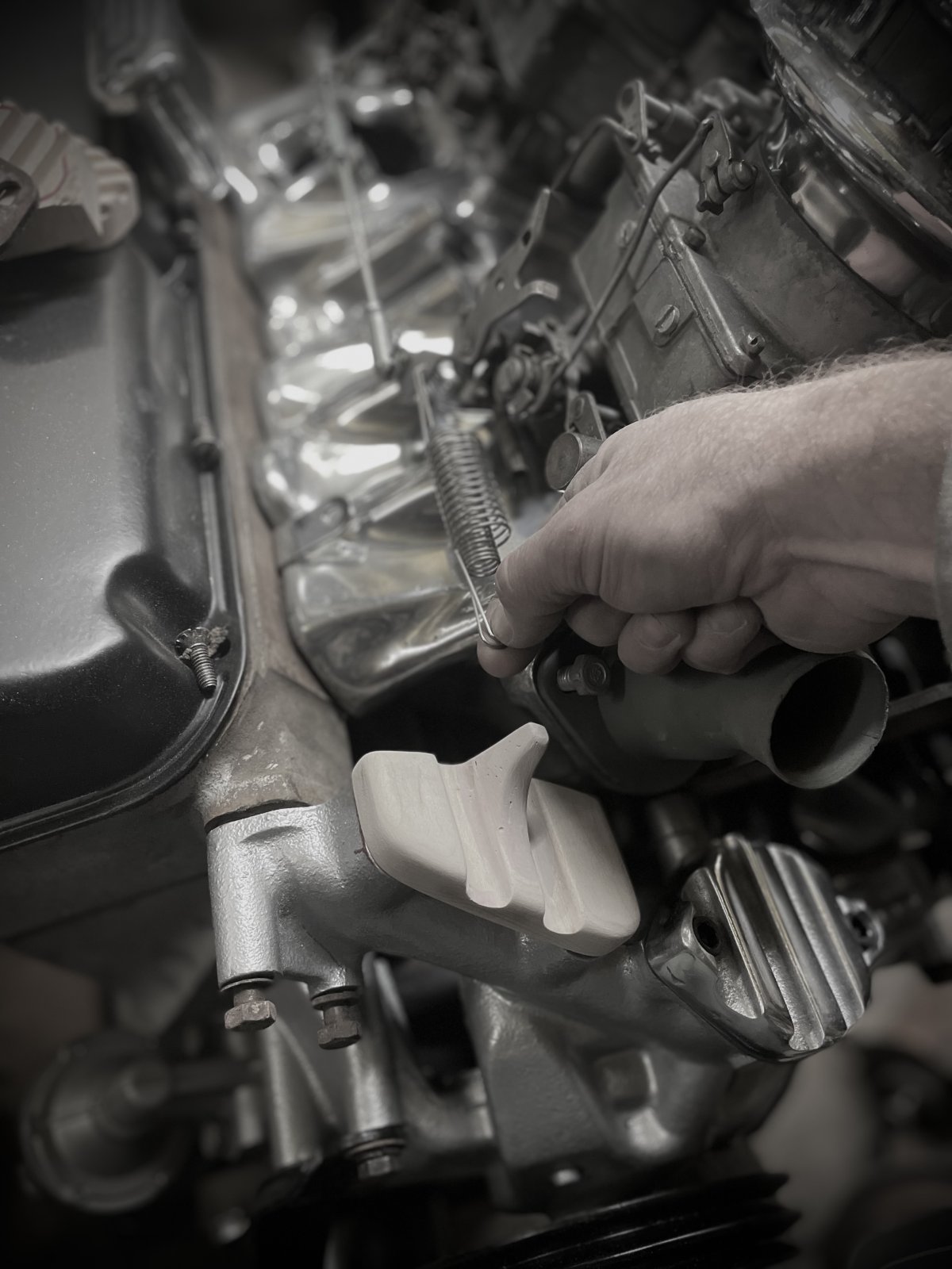

    I’m gonna cast the spring return mount which I’ll drill and polish it. I’ll add Allen head bolts recessed into the aluminum like the block off next to it.

    Very cool! Are the flat stand offs hollow and you would just drill and tap for a hose fitting? I was curious why you hadn’t cut them off and smoothed them when I noticed them.
  6. Tuck
    Joined: May 14, 2001
    Posts: 5,873
    Tuck
    Tech Editor
    from MINNESOTA
    Thanks man, They’re leftover solid risers from the casting process, Chrysler just machined off the tops the same height as the water inlet. I’m going to drill and tap them. I’ll locate where I want to put the hardware, machine those and then use a transfer punch to locate where I put the holes to drill.

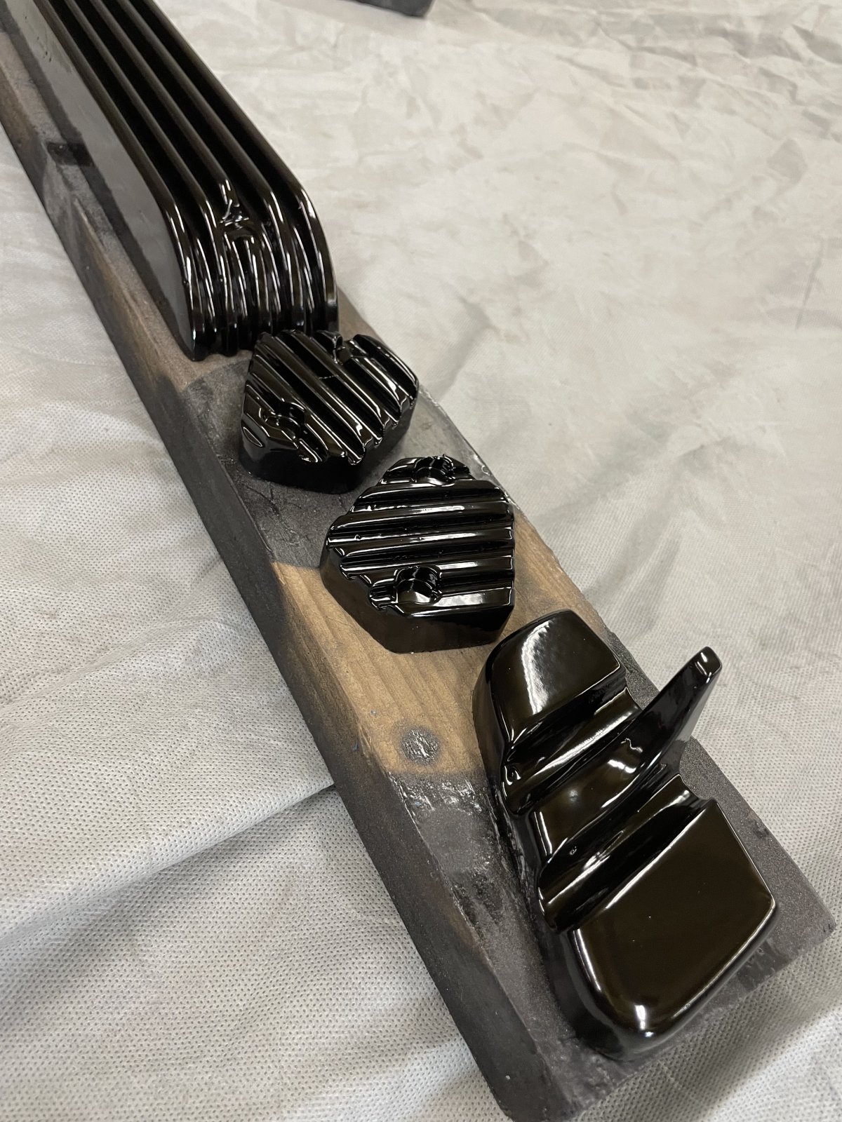

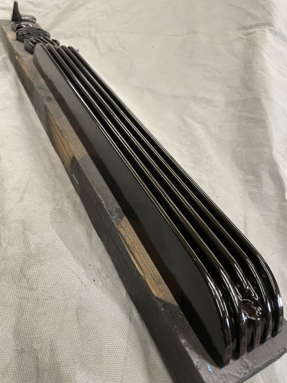

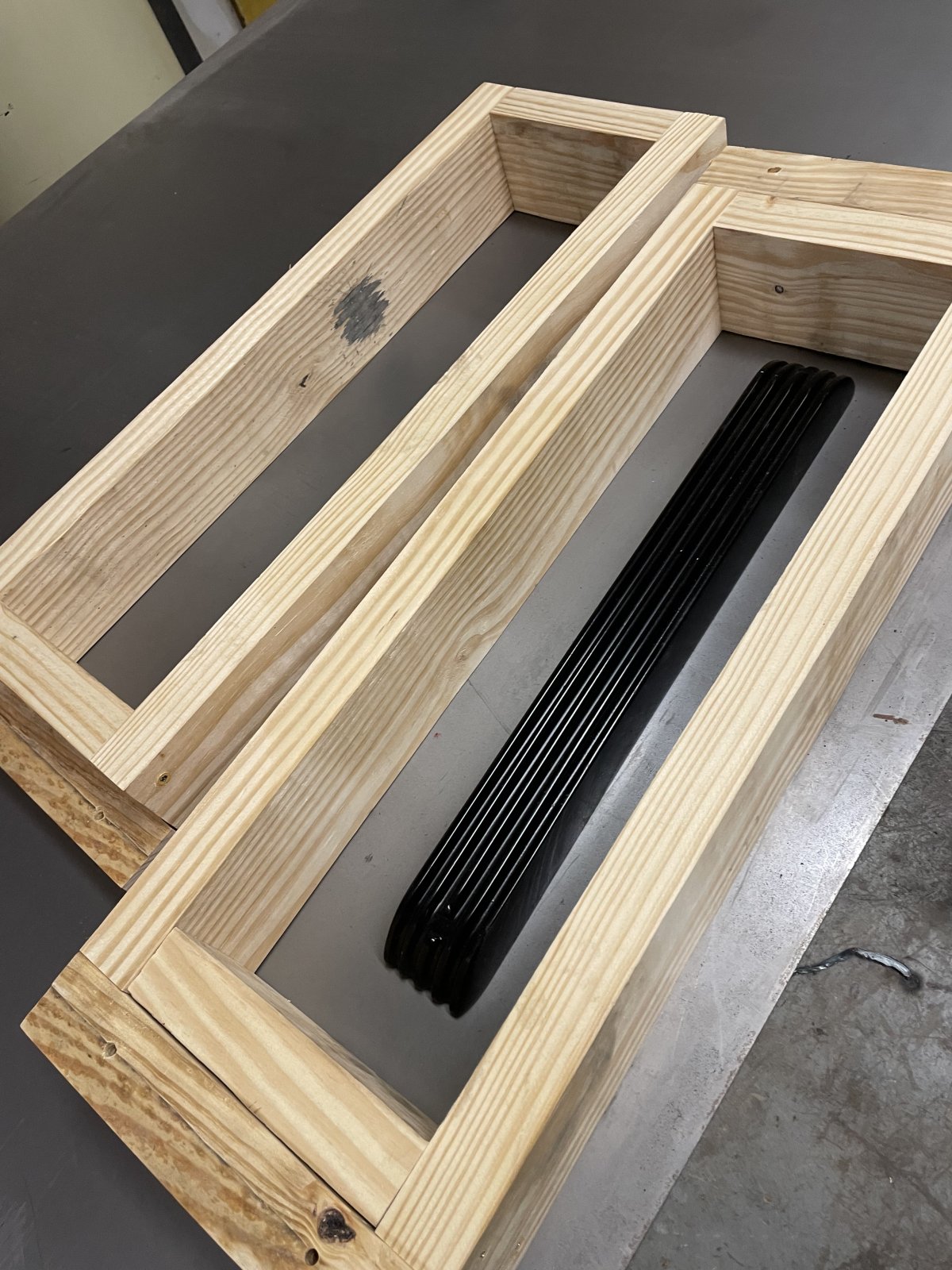

    Got them in primer surfacer. I’ll block them out and then paint them in single stage acrylic urethane. Once they’re shiny they make really good patterns because they pull out easy and will have a nice finish.

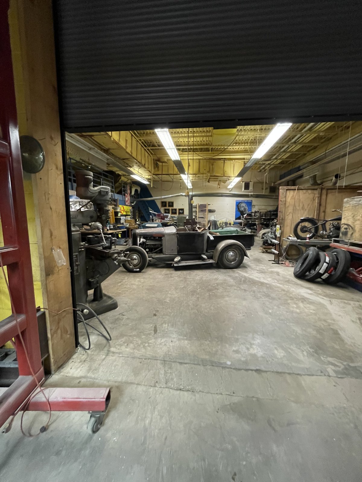

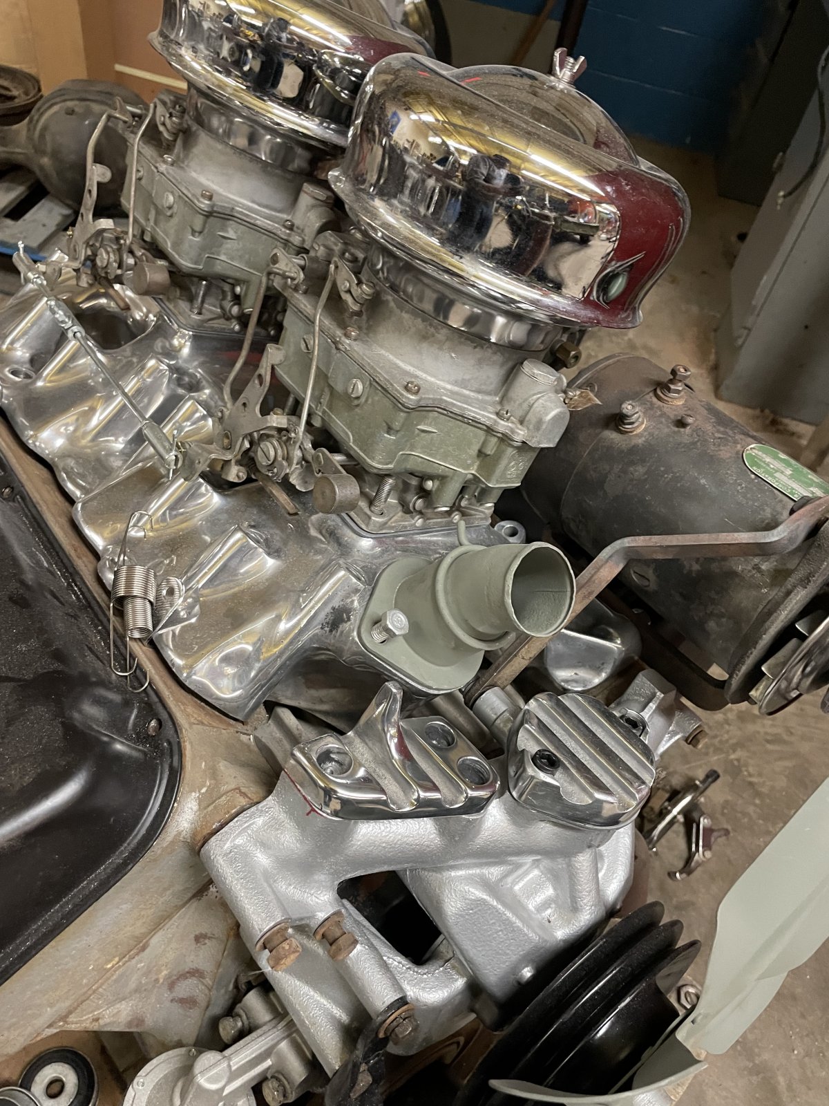

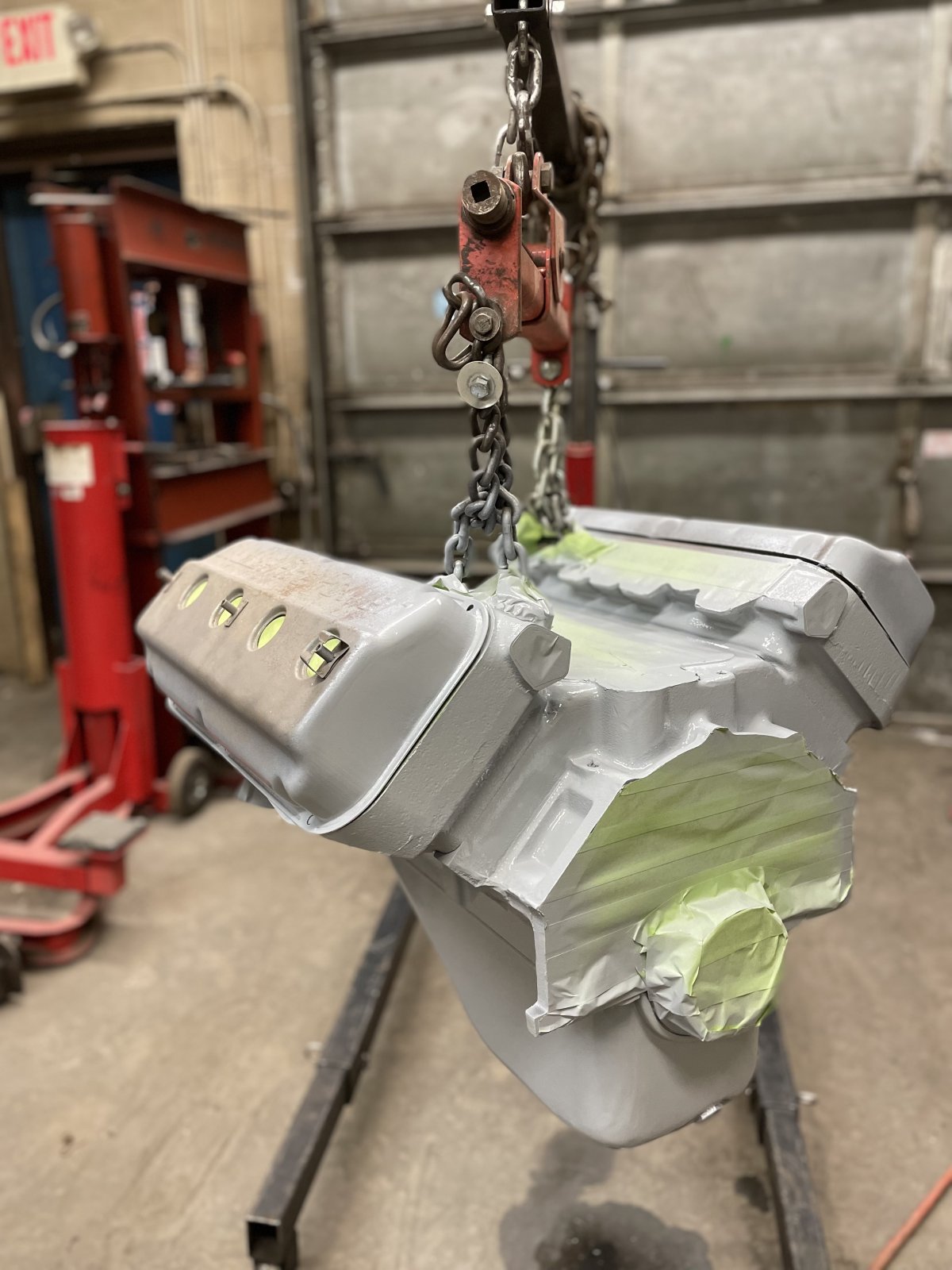

    I don’t not have much to report because I’ve been sick for almost two weeks… :confused: It’s the never ending story… Can’t wait for this bug to subside. I swear I get over one thing and get hit with another.

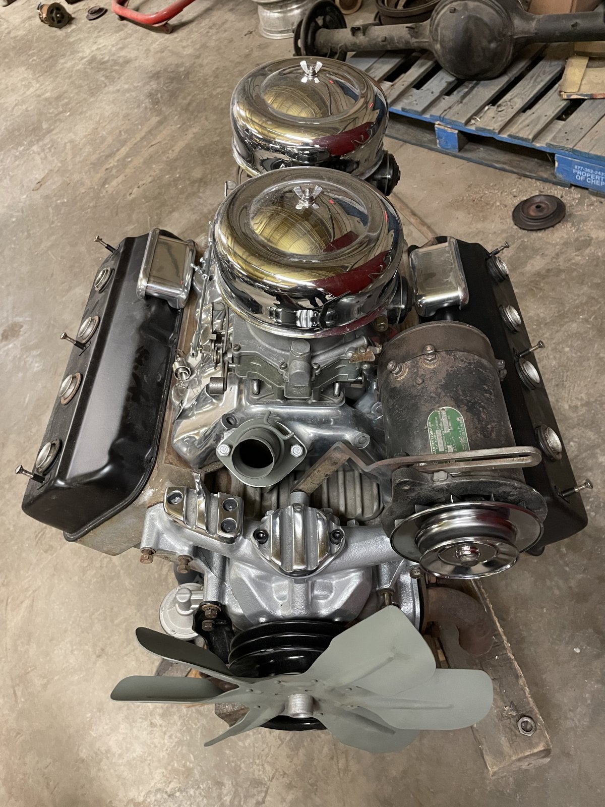

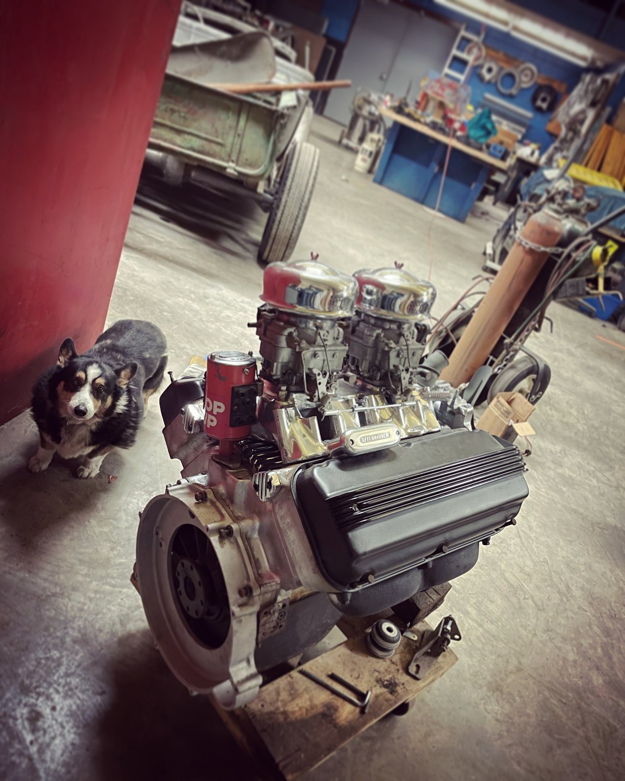

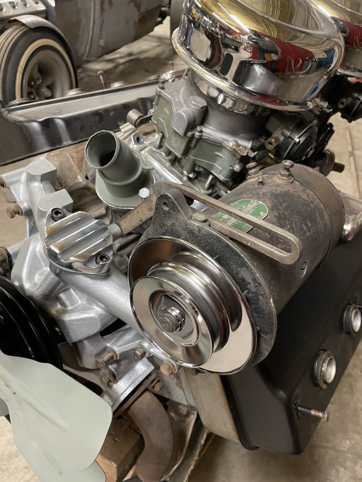

    I prepped the gen pulley for chrome. I’m going to chrome the generator because it sticks out in your face and would look cool. I need to chrome a few brackets too so might as well drop them all off at the same time.
    I cast the spring return mount.
    Had to take 3/16” off my valley pan so it won’t hit the bottom of the intake.
    I picked up material to build an engine run stand… so the plan is to get the hemi painted and then I can mount it on the stand and work towards getting it together and ready to fire up… with the idea that the ready to go running hemi will motivate me to finish the ch***is, run break lines etc… knowing I can drive the damn thing!

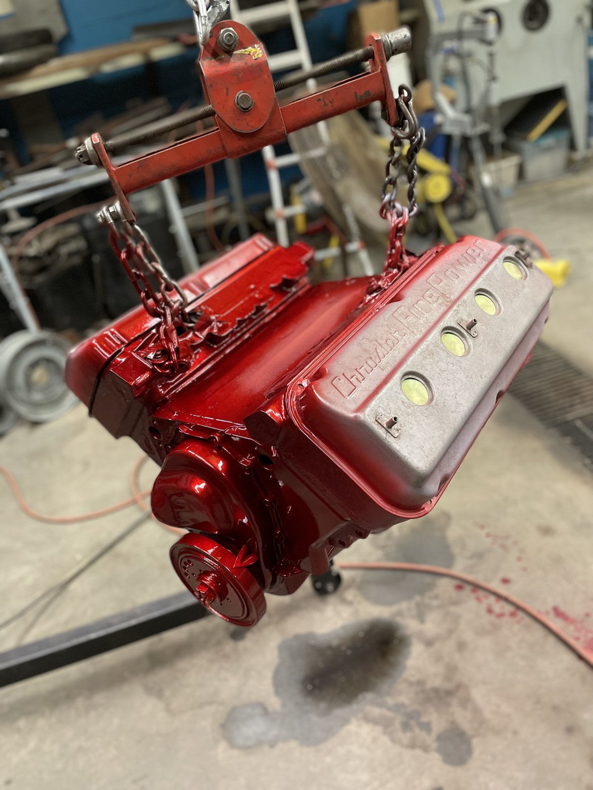

  28. SS327
    Joined: Sep 11, 2017
    Posts: 3,885
    SS327
    It looked better painted candy red! The silver does nothing for me.
