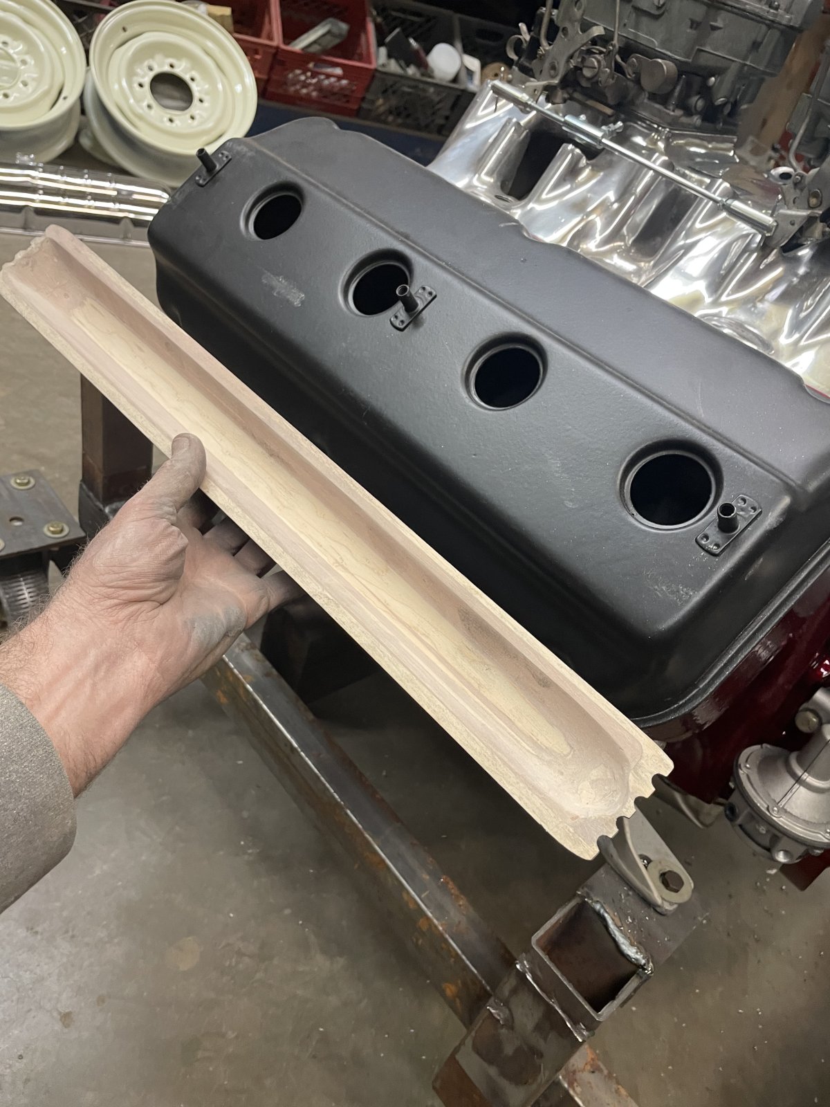

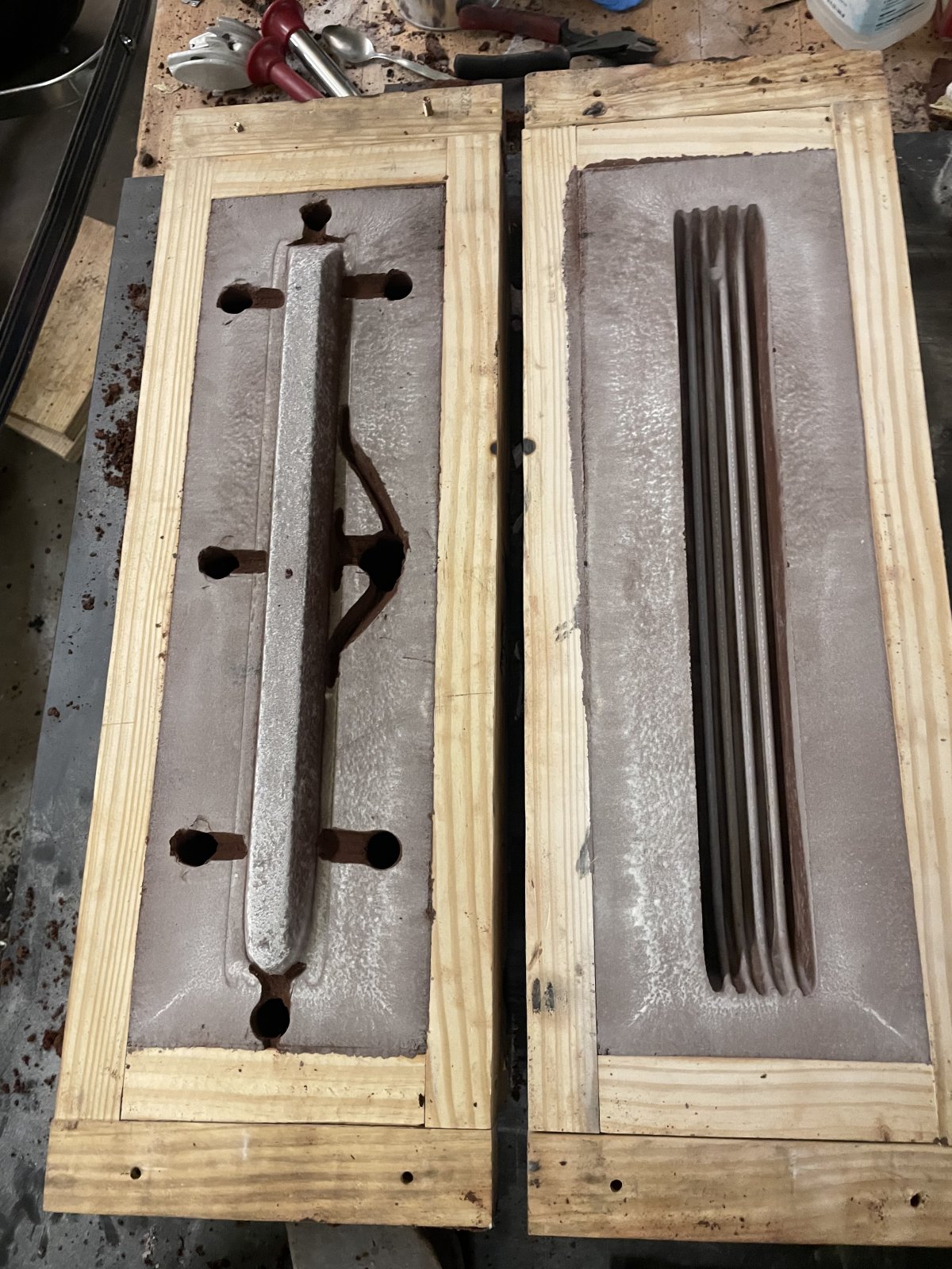

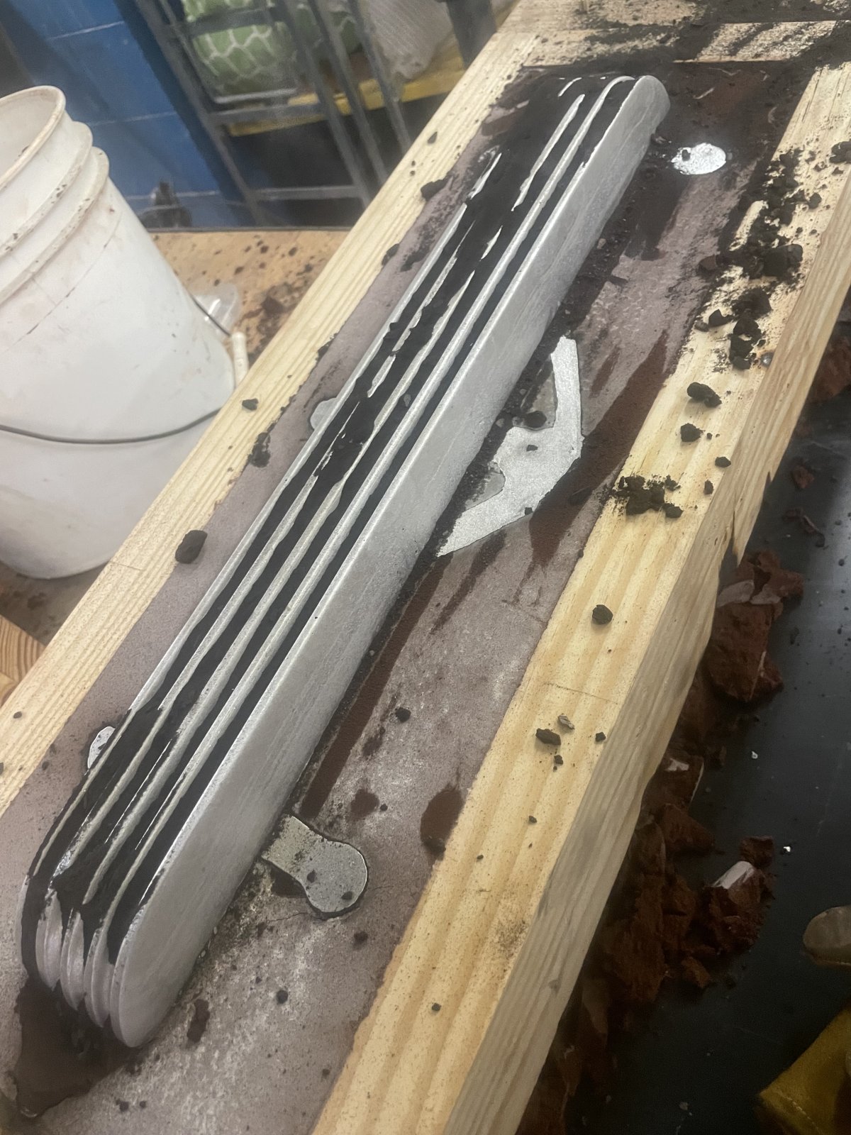

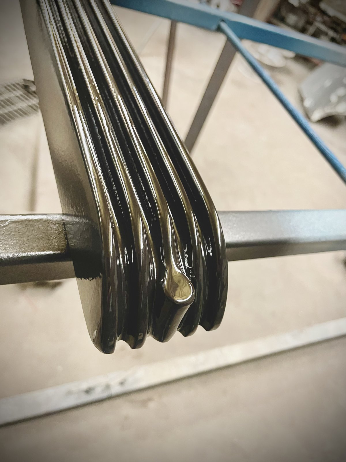

    Working on casting Hemi parts today
    IMG_8025.jpeg IMG_8026.jpeg IMG_8084.jpeg IMG_8089.jpeg IMG_8096.jpeg IMG_8123.jpeg

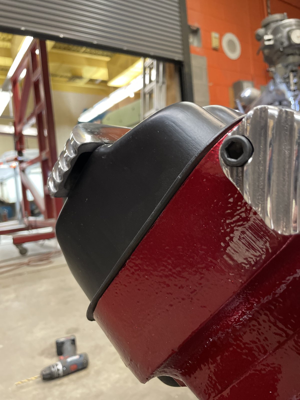

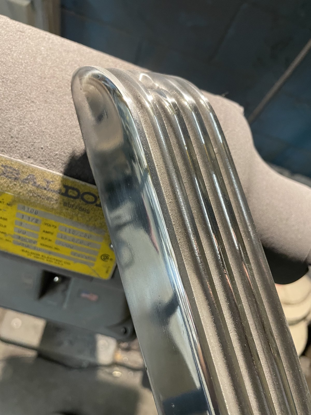

    Thanks dudes
    brEad, enloe, hotrodA and 17 others like this.
  7. Outback
    Joined: Mar 4, 2005
    Posts: 3,372
    Outback
    from NE Vic
    The gap at the end for the plug leads is very neat, that is a beautiful job! Thanks for the front row seats

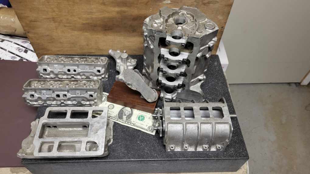

    I have been casting for 25 years. I started with the Gingery Furnace and still run it although I have upgraded it so I can convert it to waste oil so I can pour cast iron. I started with smalls and still cast the baby Moon pedal, but recently poured the T5 to 215 buick spacer.
    It is a deep dive, but check out http://www.forums.thehomefoundry.org/ there is a lot of information and some talented foundrymen.
    This is the 1/3 scale smallblock in my avatar.

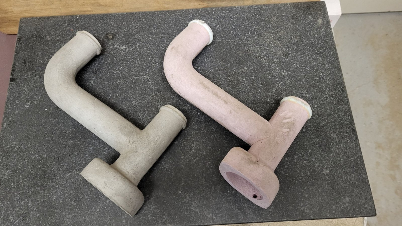

    This is an OT coolant fitting that I did as an experiment for one of the members using the lost foam process. He has gone on to produce absolutely unbelievable multi carb manifolds. Resized_20240311_171125_1710202564969.jpeg
    The left hand piece is aluminum and I didn't cast the second more detailed sample since the method was proven.

    thanks everyone, didn’t expect a spotlight on my thread today. Stoked everyone digs em.

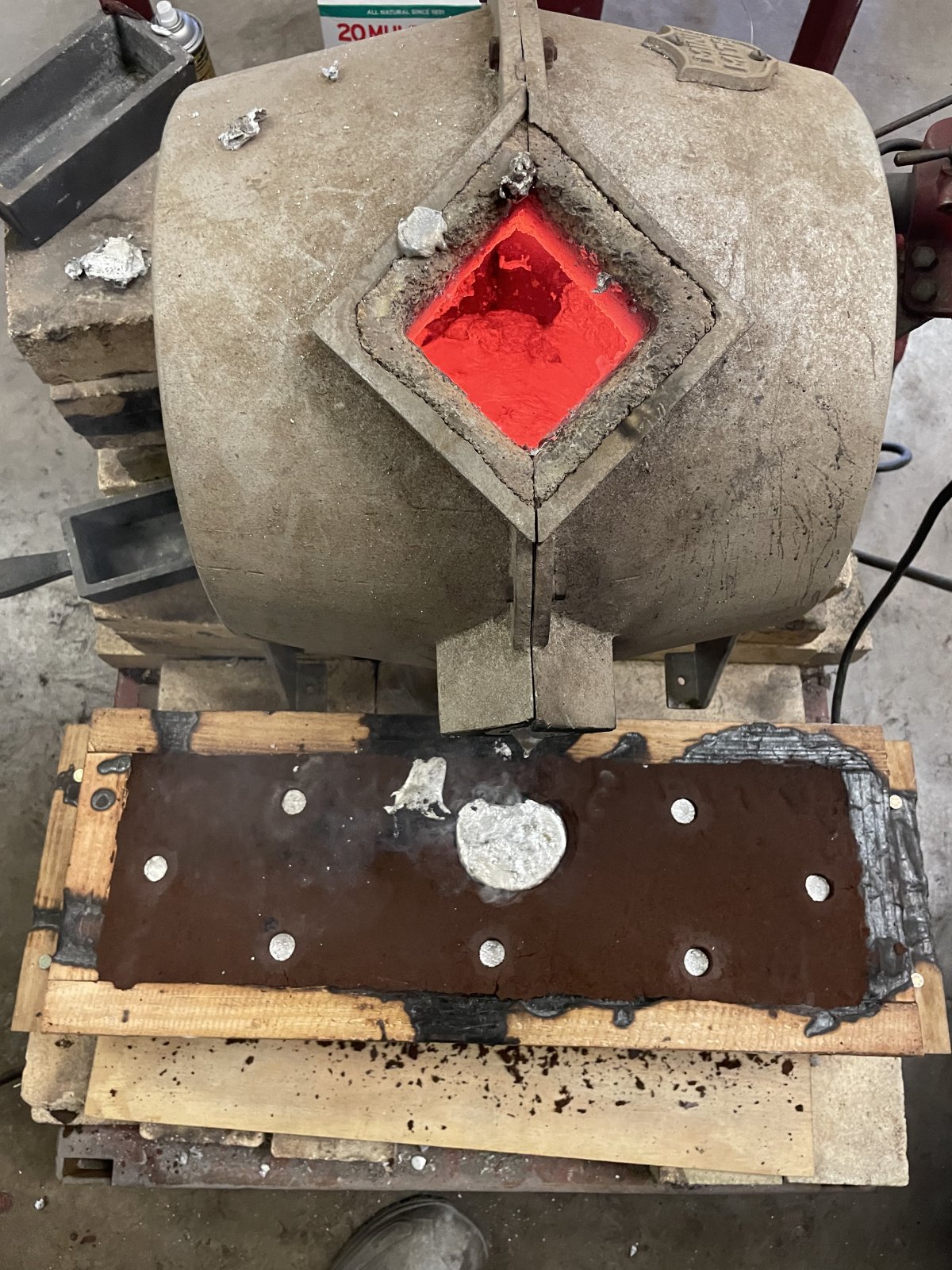

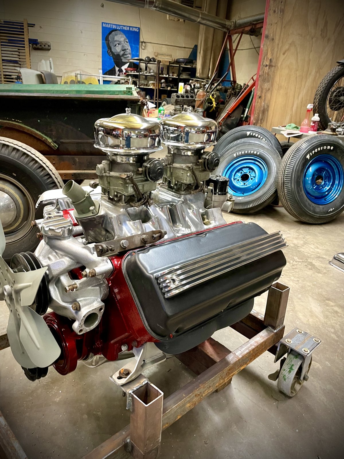

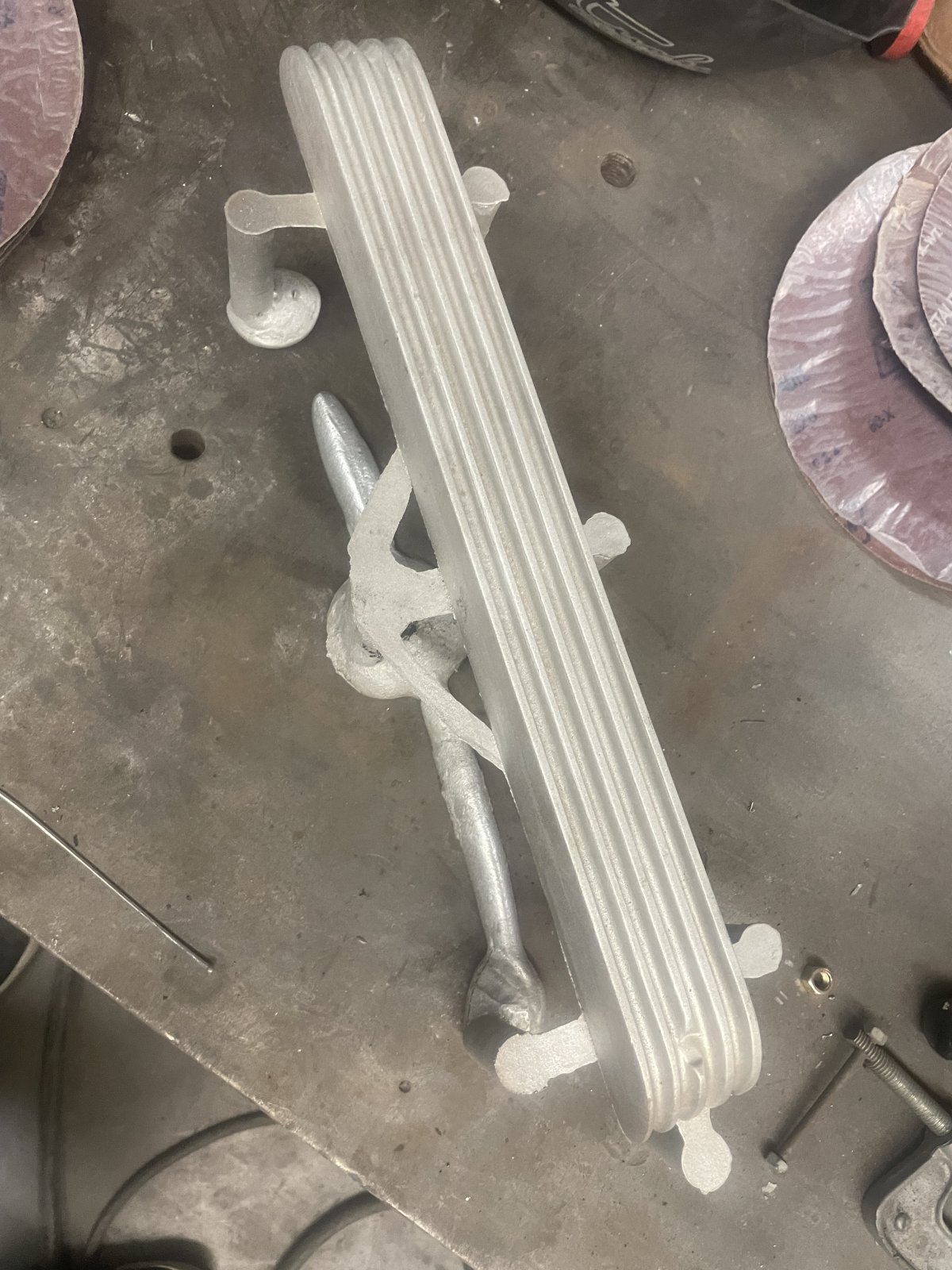

    I cast a couple more today, I changed a couple things and the last one I poured is the best out of all of them.. I think I have the gates and risers figured out.

    Was the overhang on this valve cover on purpose, or are the valve covers different lengths from side to side? (Not a Hemi guy at all).
  22. Tim
    Joined: Mar 2, 2001
    Posts: 20,254
    Tim
    from KCMO
    @Speedy Canuck i believe they over hang on purpose to sneak the plug wires out

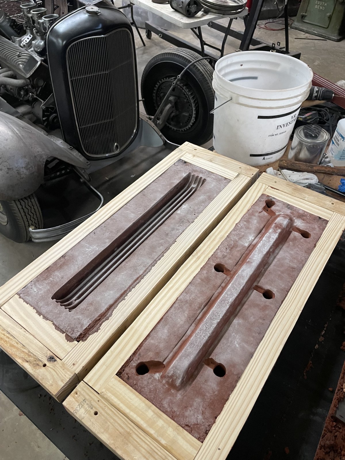

    the last two nights I was at the shop sand casting covers… I had trouble with two castings (one of them my fault) and the third one turned out perfect but then when I machine them I'm lacking material on the front of cover and it’s easy to mess them up. Welding a **** up is a *****! I’ve been learning a lot about how to position the gates and risers to allow for shrink and turbulence pouring- some people might think its all wasted time, even my inner dialog has **** to say but I just tell it to shut up and look at the results. It’s ****ing fun making stuff that never existed before!
    Money won’t make you happy but learning skills will… and tools are an investment in yourself. <— this!
    So I went back and added a boss for the screw with sneaky draft angle and I’m excited to see how this one looks. I can’t wait but I won’t get a chance to be back in the shop until Friday night or Sat!
