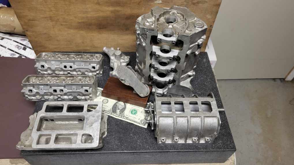

    I wanted to say thanks for sharing this... Phenomenal work @Sandcrab. Im really curious about the lost foam. My next quest is to cast something with a core like a breather-
    I shared pics of your mini sbc with some of my students and they were blown away. I can see how this path I’m on making parts is addictive. (Just like blowers/superchargers:D)

    Glad to share Tuck.
    One of the great things about lost foam is that you do not need cores because with proper vibration, the loose sand fills all the interior spaces and locks itself into that shape.
    Explore the "lost foam" thread on The Home Foundry site for some amazing examples and great descriptions of the process.
