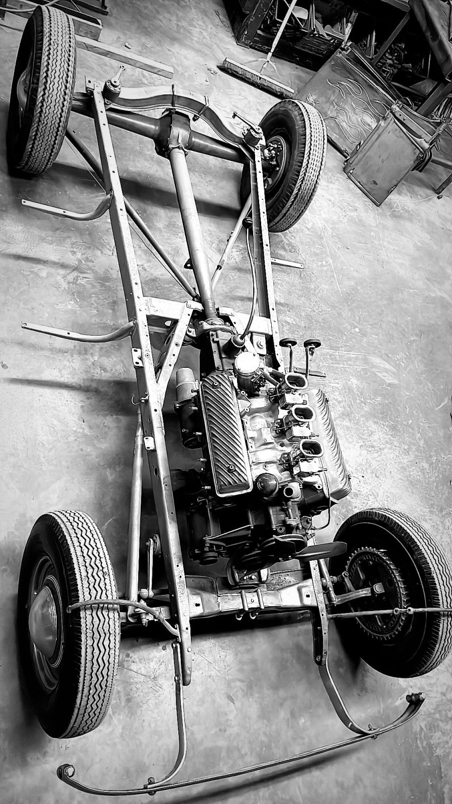

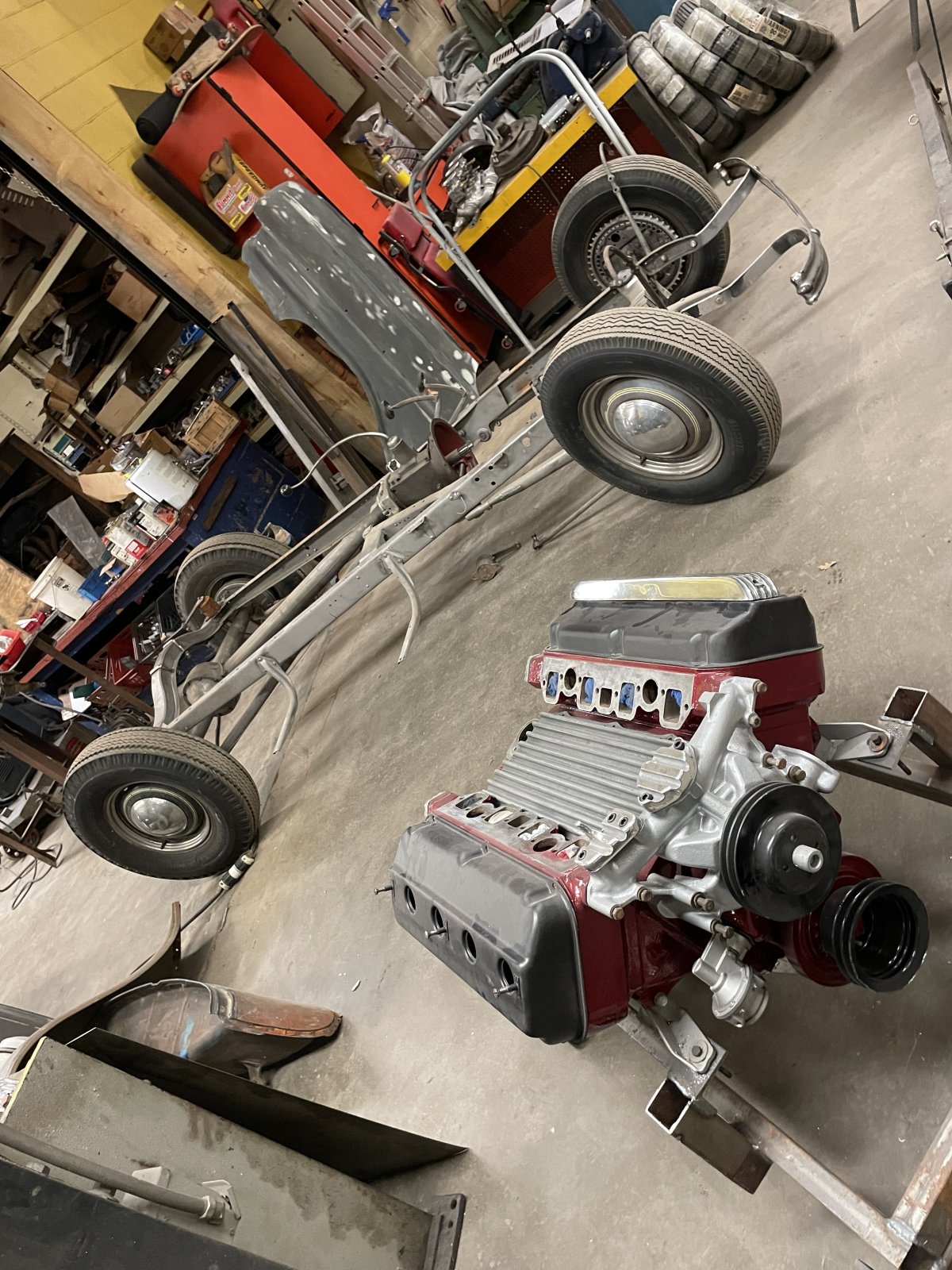

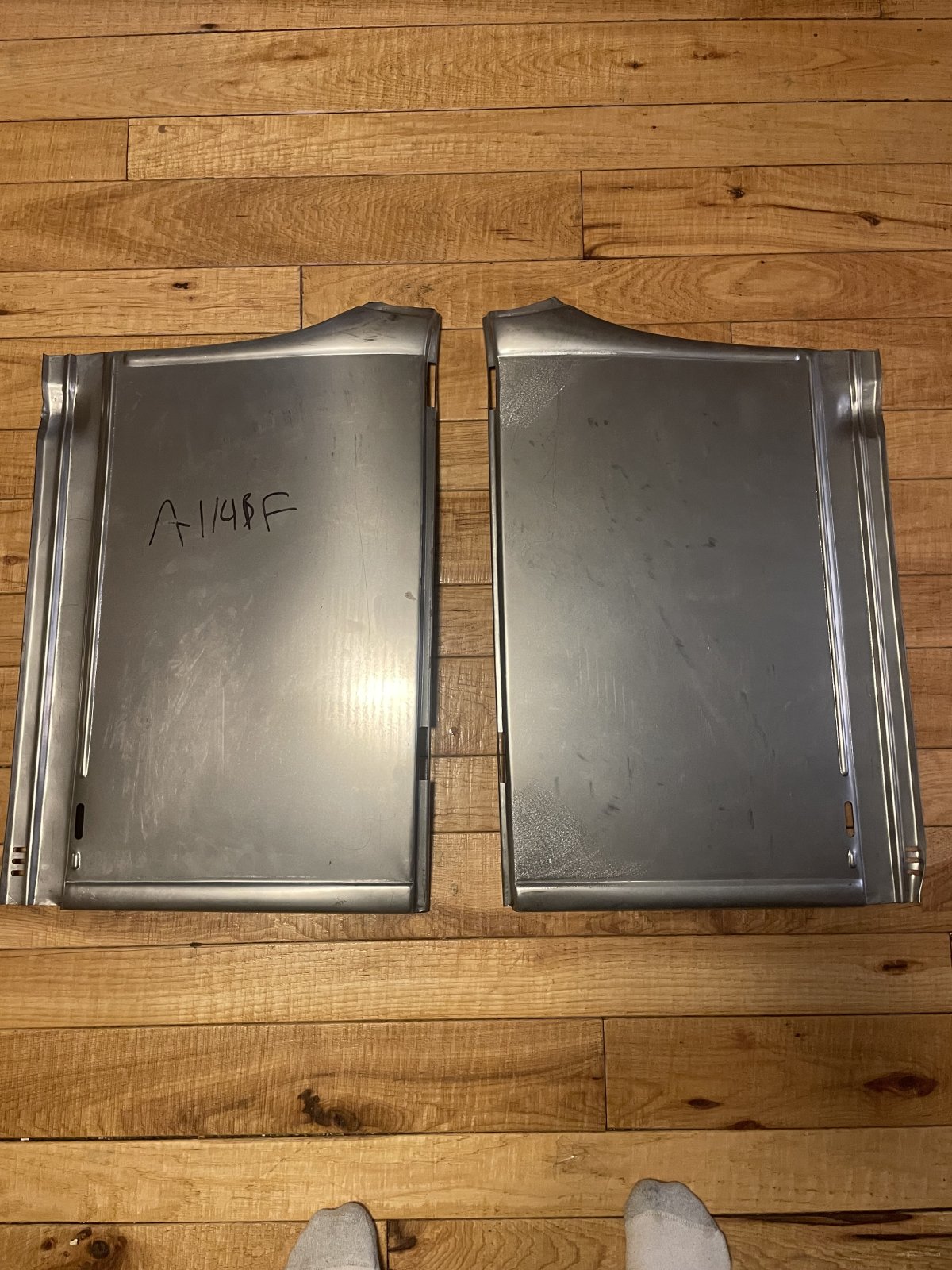

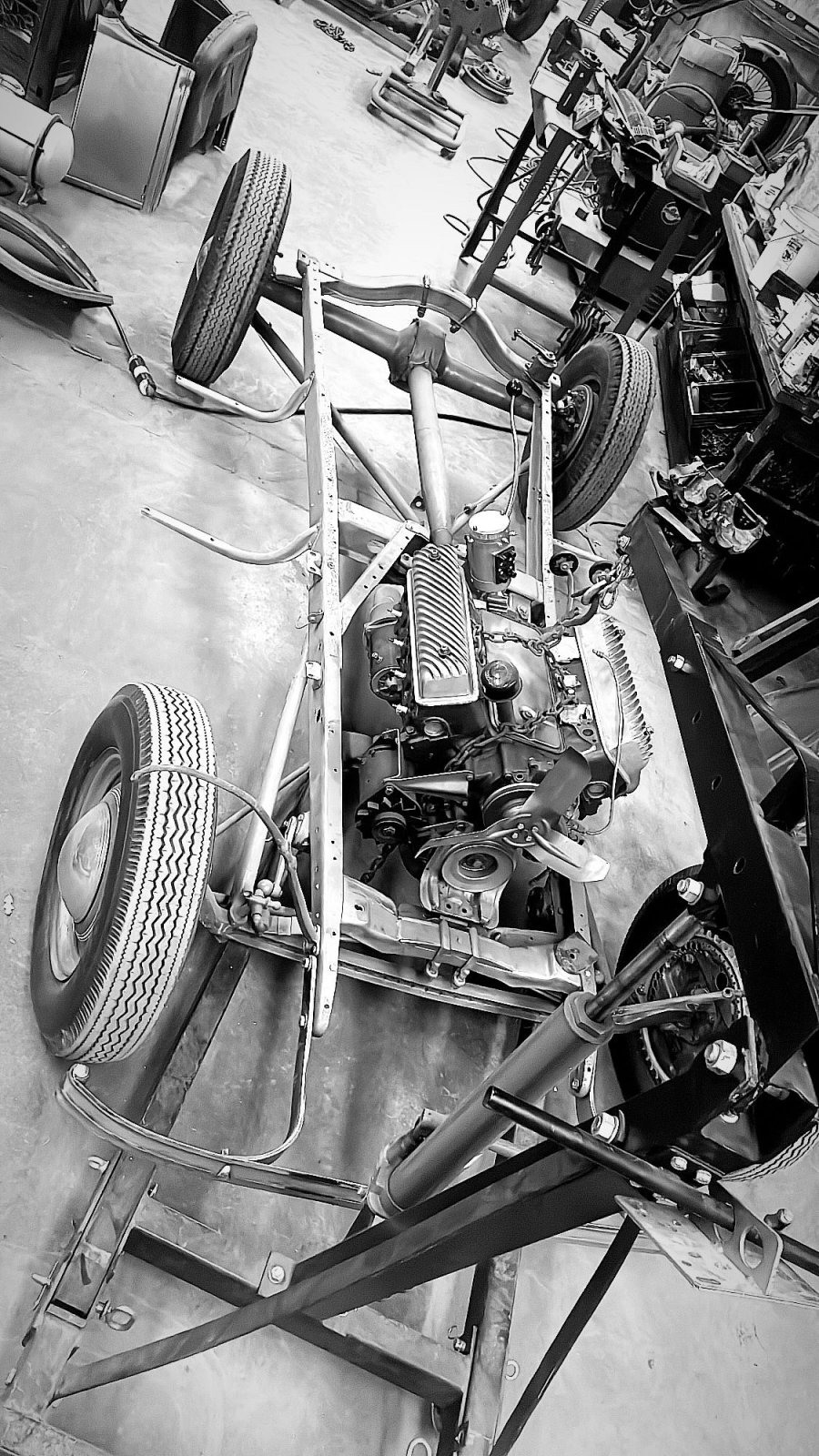

    Good news and bad news...I've had the doors annd back panel of the cab ordered from brookville since last nov, and they put it off another 3 weeks. This time they said the back stamping would be done in the next two weeks... but prior this this they had said that panel was done and were waiting for parts for the doors. So I suspect someone else got my back panel or they're all full of ****. Hoping to get my doors and back panel in a few weeks... but in reality maybe next year...
    Meanwhile the cowl sides showed up today and I'm stoked!
    started to strip the ch***is and get ready to fit the Hemi in the Y-blocks place so I can fab motor mounts and check steering clearance. I may end up changing that-

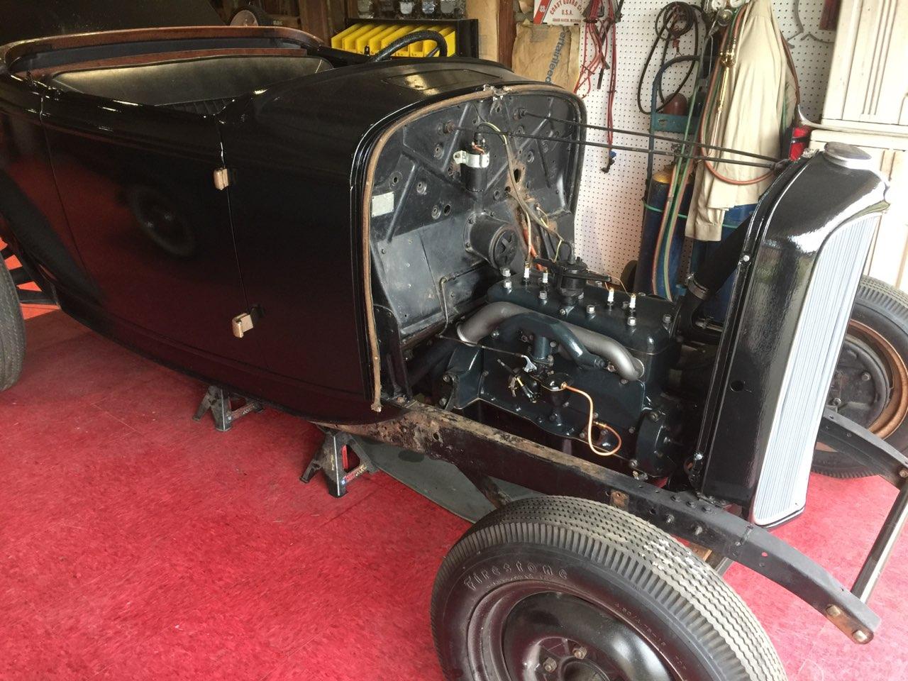

    I’ve been silently following, looking great. Nice to see this ‘32 again, I “built” that car about 7 years ago. I use the term built loosely as the new owner did a lot of great work to it, as the V8 and top a**** other things that I don’t want to take credit for.

    That 32 was exceptional... Reminded me of something you would see in one of Vern Tardel's books. Nice work to everyone involved. They say a project car changes hands like five or six times before it's finished.

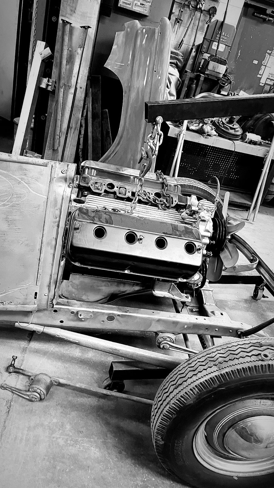

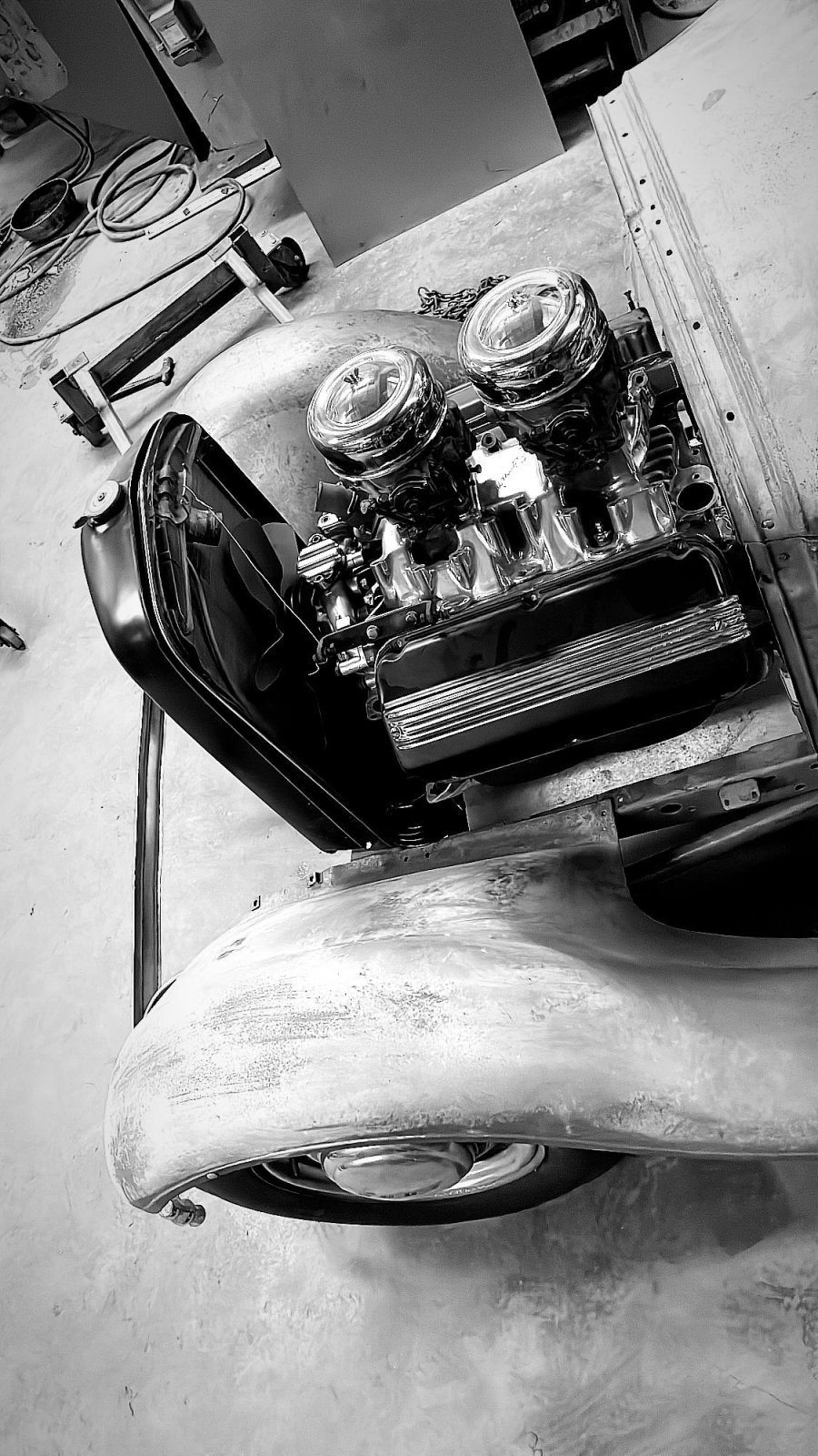

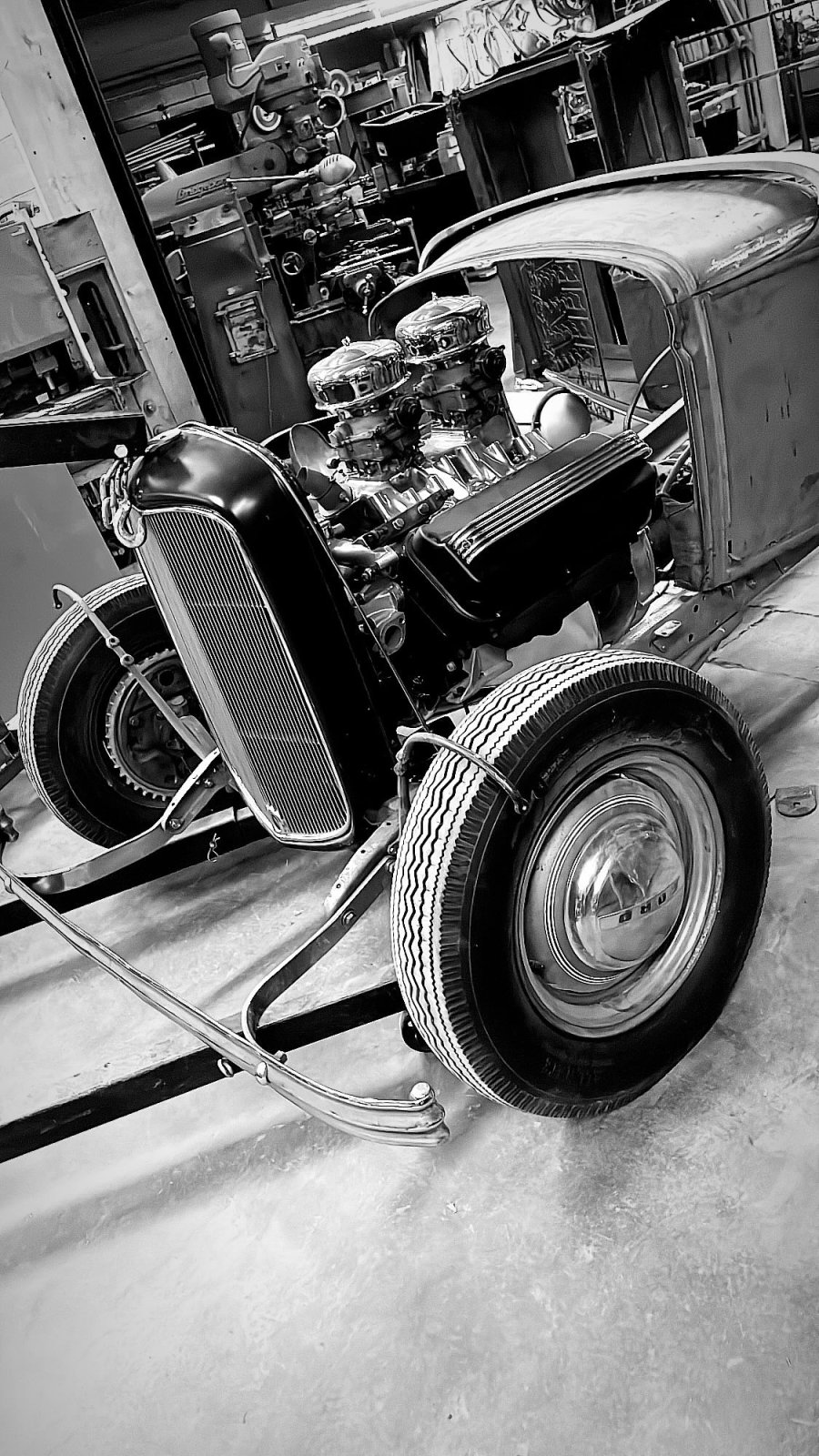

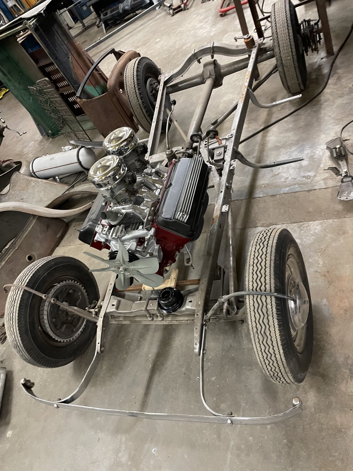

    It fits! My measurements were an inch off... I have to move my rad forward about an inch.. maybe less. I could move the hemi back one inch but it falls back into the cowl and I don't like the way it looks as much as where it is so.. I think it's gonna be ***s where it is. If I ran a big block Chevy water pump this wouldn't be an issue bahahaha... but I just can't do that. It would be rude.

    I'm absolutely smitten... I love this.

    *****en! With the 32 grill and full fenders I doubt the radiator moved forward will be that noticeable.

    Thank Tim, yeah I think it's only a half inch forward... so yeah I don't know that it's going to matter much at all! Stoked- it looks so rad!
    I'm gonna start working on the cowl next along with designing motor mounts- the mounts need lift the hemi pretty high to where it looks right. It was amazing how much the suspension dropped when I let the weight of the hemi settle onto the ch***is! Then I'll box the ch***is and run brake lines and stuff and then we can body work and paint this MoFo!

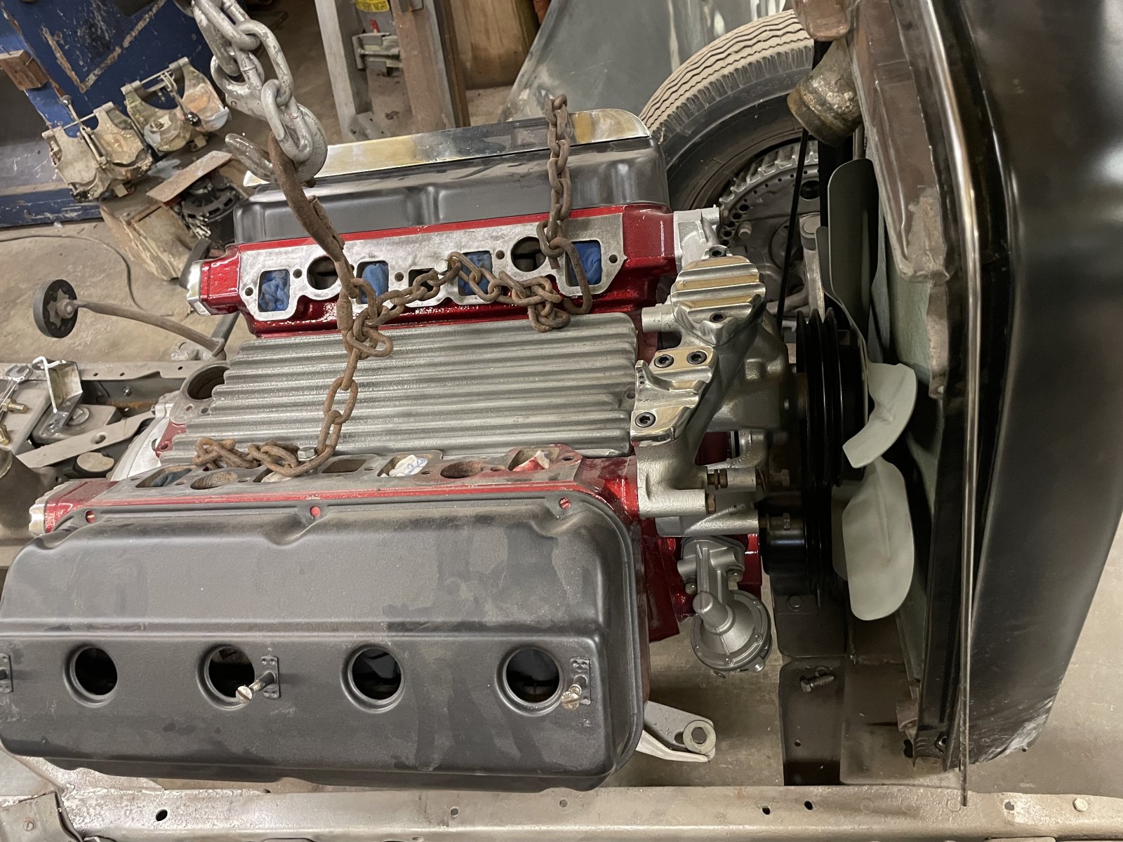

    Fabricating a motor mount, it's far from done. The idea was to reinforce the steering box, keep the rails clear for the fenders and try and keep them looking clean. Here's my solution, everything just tacked together at this point.
    This should help keep the frame from twisting.
    The radiator is just shy of an inch forward but the tilt of the engine allows me to tilt the radiator back 3/4" and a stock hood fits!

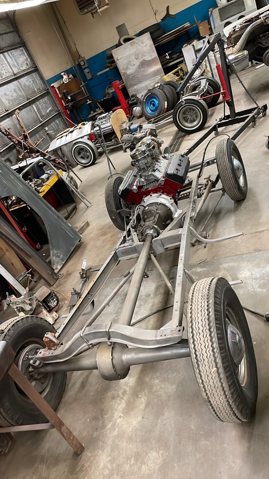

    I still have this center mount from the y block, I think I'm going to use it and make a mount like the y block that bolts to the lower bolts on the timing cover, shaped like a J with the top of the J like a tuning fork and will be hidden under the pulley you won't see it and should help distribute the load/stress.

    Looks good! That under engine brace/ cross member should really stiffen things up

    Thanks Tim! - it should help a lot. I had a crossmember under the y-block sort of setup the same way. Now to weld it all up solid.
