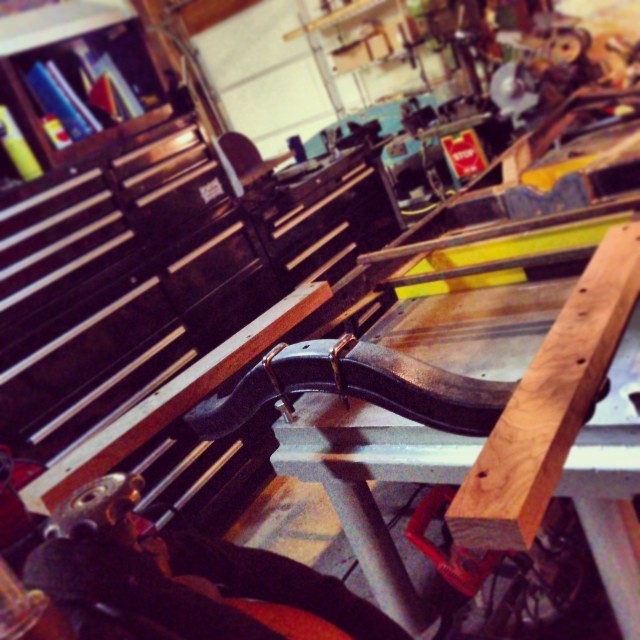

    Made bed Sills tonight
    Finally some progress-
    Started with a slab of black walnut
    Borrowed the templates from my friend bird
    Tuck
    Outback likes this.

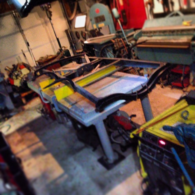

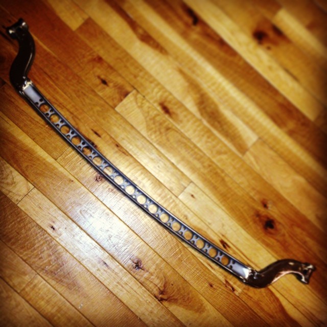

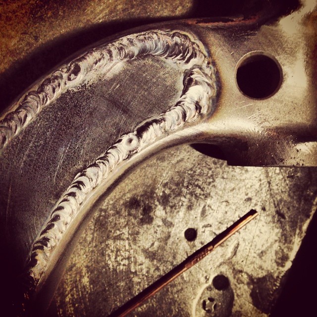

    I got a chance to work on the truck this weekend- It was a little cold (-17F) today-
    I finished welding the frame- (major stuff anyway)
    Welded in the bungs and blended the welds on the bones-

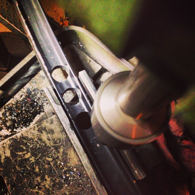

    drilled my axle and filled the ends-
    the bed sills line right up with the holes-
    Can't wait to get the front end mocked up- next I need to pull my spindles and backing plates etc.
    then I'm going to finish going though my pedals and get the pedals bolted in-
    I think I'm going to end up chroming the axle and bones- wasn't the plan at first but I think it would be rude to just paint this stuff...

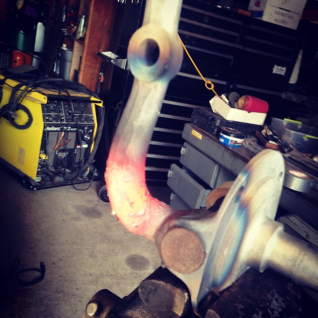

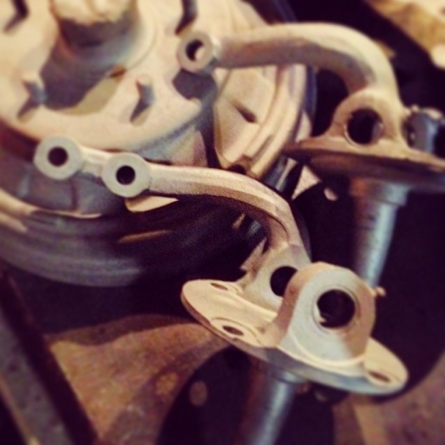

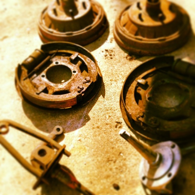

    busted apart some front ends...
    have some 39 merc spindles-
    gl*** beaded them and dropped the steering arms to clear the axle.
    Beaded the drums/hubs and getting them turned.
    the backing plates from the 46 axle are really nice- going to rebuild them and reline the shoes.
    The 40 rear brakes are all new and ready to go-
    Can't wait to get this stuff rebuilt and bolted to the axle!
