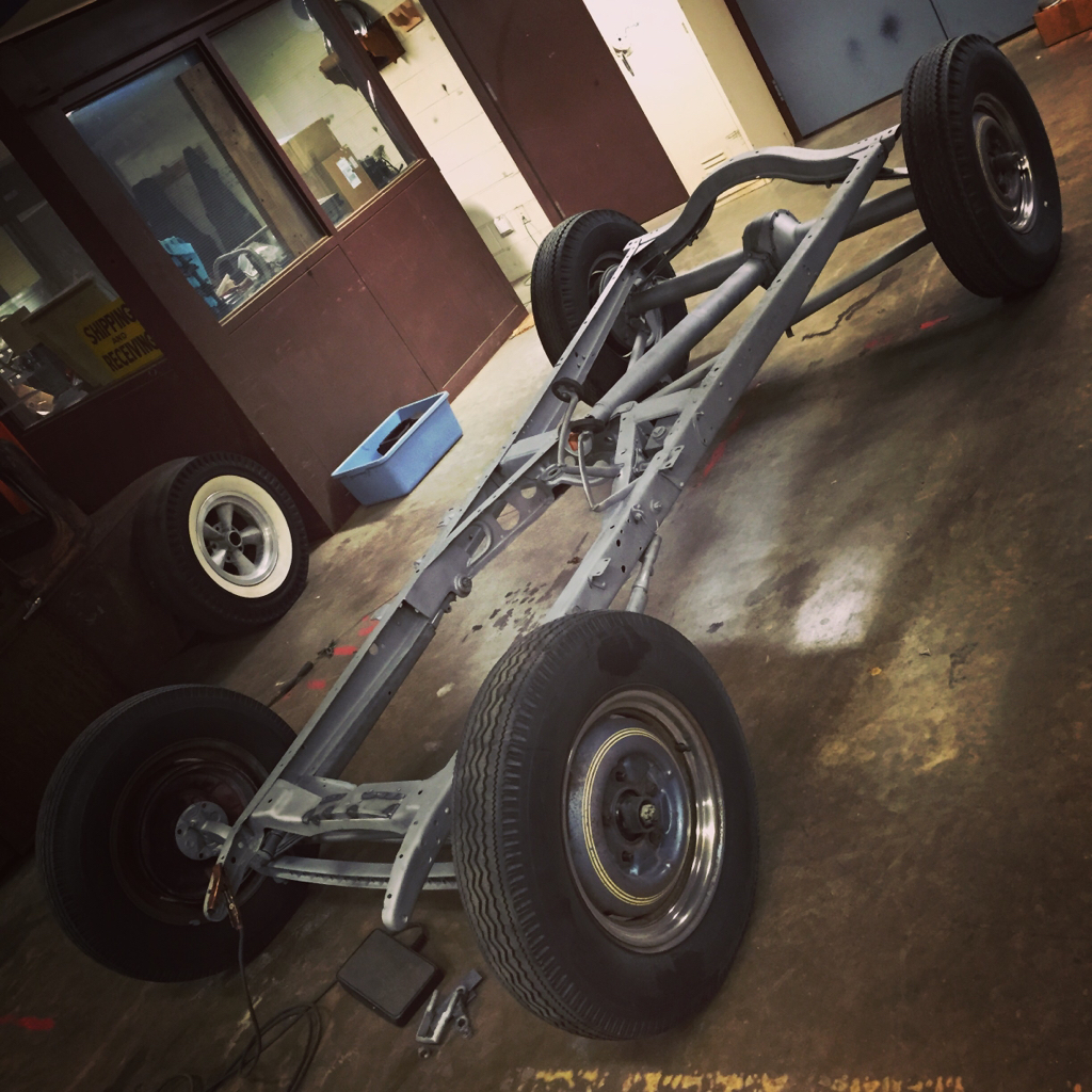

    I shortened my torq tube, changed the front crossmember, bones, mounted the pedals and steering... pretty much have a rolling ch***is now...
    [​IMG] [​IMG]

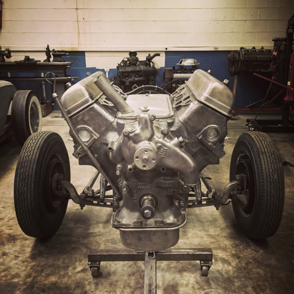

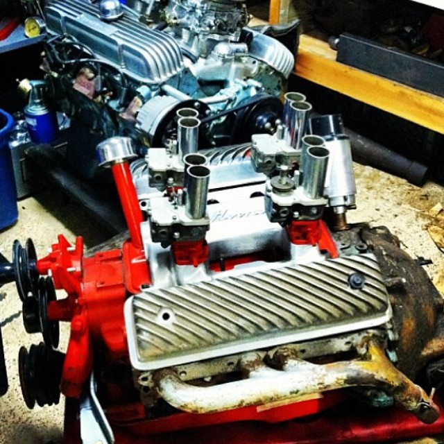

    I had a rusty 78 case I pulled apart and zephyr gears that came out of an overdrive that went through the shop fire- I got a couple books on rebuilding these- was pretty fun going through it.
    [​IMG] [​IMG]
    took some weight out of the flywheel with the brake lathe-
    Have not had a chance to work on it in a couple months but now that school is out I'm hoping to get the ch***is finished and painted.

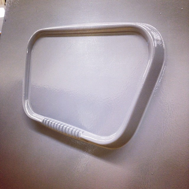

    Fenders-

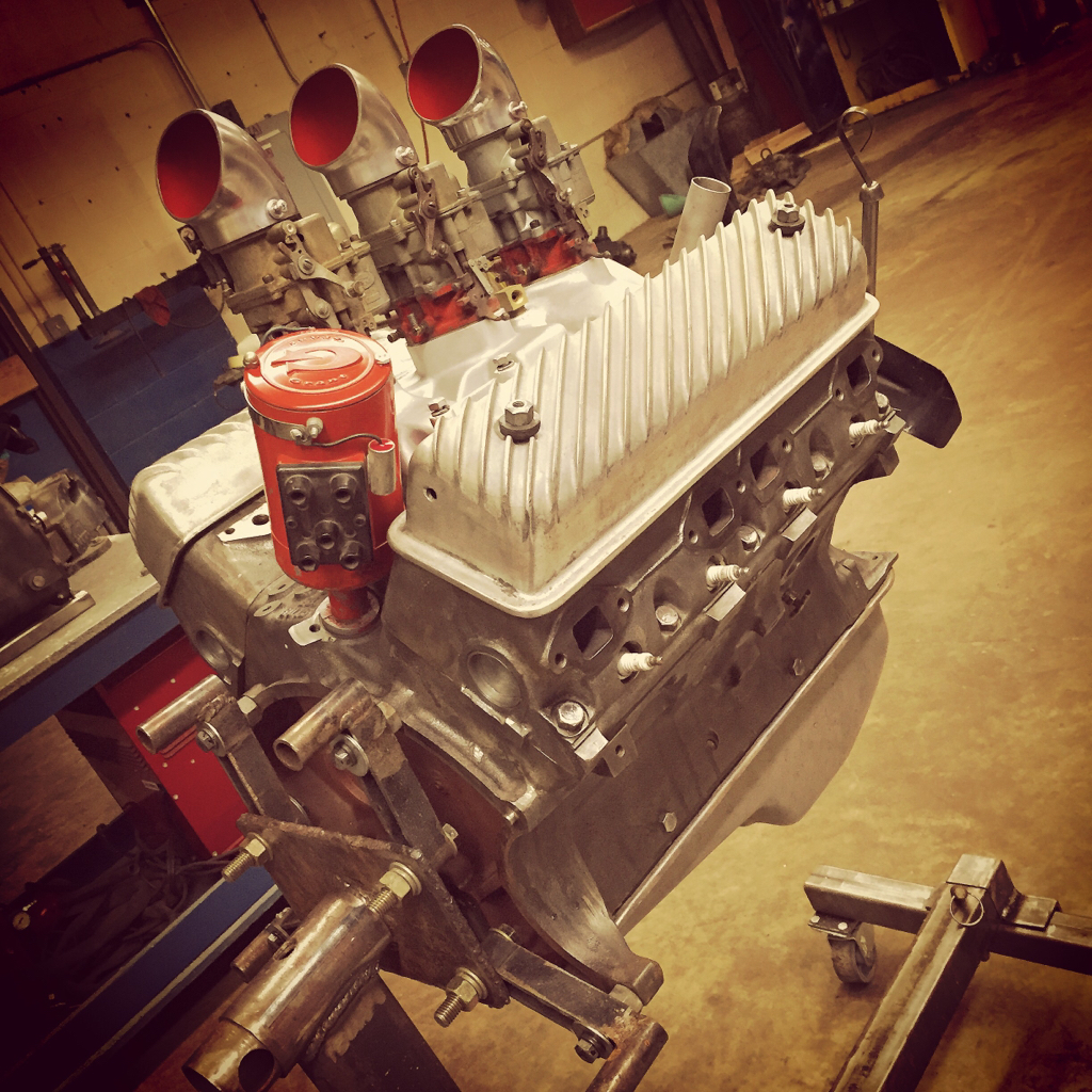

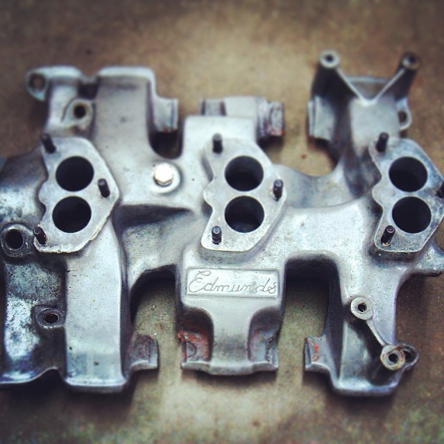

    Going though the carbs
    [​IMG] [​IMG]

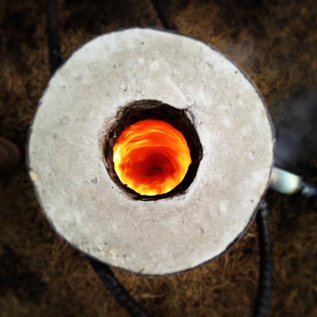

    strip and plate and dip in yellow chromate-
    I plan on painting it 59 buick wedgewood blue and I'll paint traditional flames on it striped in white. I'm calling this one the Blue Ox- Nice Kanadian name. There is a local 34 pickup owned by a guy named Iverson that was built in the sixties with a nailhead and is painted a similar color. Full show rod pickup- I used to drool over it when I was a teenager... and he would always say you can buy it! At that time I think he wanted 12 grand which might as well have been 120 grand to me. Now I'm just building my interpretation of it.

    The Y-block is a brand new overhaul- ***embly lube is the only thing taking up residence inside- the builder painted it without priming the block... Used that bill hersch? Stuff- and it was starting to flake off- you could literally blow it off with an air gun.
    Opted for aircraft stripper and stripped it bare naked-

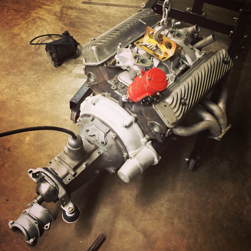

    Prepping the trans, engine and next is the rear end.... Plan on painting them a kandy flake copper/gold with some fades. Oil pan and pulleys etc (everything that's not aluminum and bolts on) is getting polished and chromed!
    Really love the way engines look... Both apart and together. Working on these engines I really grow to appreciate the engineers that put this stuff together!
    This whole drive line will be new! -don't think I've ever started out like that before- usually end up with a running engine or recently rebuilt... Can't wait to fire it for the first time and shift it into first!

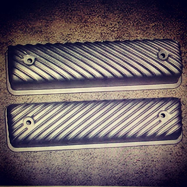

    Tech Editor
    from MINNESOTA
    Thank you Mr. Webber- We will be at iola! Can't wait for the show... your son inherited a new nick name... Spaulding :) haha... I've been teaching him the ways of swapping. I hope he's paying attention!!!

    Yes a single "dog bone" on the steering side to counter the torque. I need to move the steering back one inch and then I'll weld the bracket for it. @alchemy
    I'll take a pic of the mount and DM you- @Speedy Canuck
