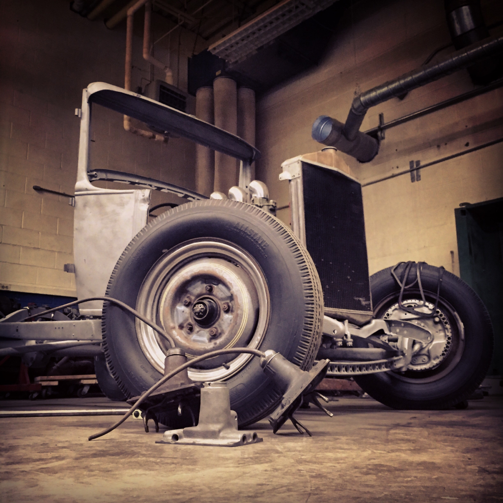

    I needed a good shift tower- mine was broke at the top- I brazed it but the shift forks were in rough shape too- picked up two of them from a local guy. They're both double detent- the one with the swan shifter came out of his 32 survivor at one point.
    Started to get the body panels cleaned up-
    After I finish my chassis mods I plan to work on mounting the cab and firewall- thinking of making the polished firewall stand alone like a 32.
    I picked up a real deuce grill shell from stu. The rad is a 32 model B. Really nice shape-

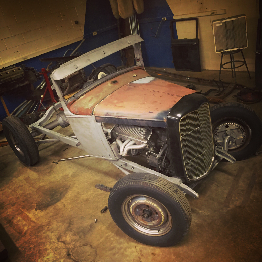

    Chopped the cowl today- been starring at it thinking about the chop for a year or better- I was between 3 and 4"... I ended up with 3 3/4". 3 1/2 was good but I had to push it. :)

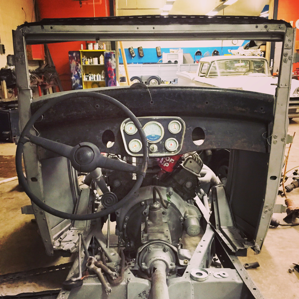

    Been looking at this chop and thinking about it all week- I added some back in the pillar so it's only a 2 1/2" chop- I didn't really want it to look chopped... And 3 3/4" looked kinda hammered. It's amazing the difference of an inch. I also figured out my motor mounts with the help of some 34 olds parts- was going to build a dog bone but I scrapped that idea and I'm adding a small crossmember with mounts- it'll help stiffen up the rail next to the steering box too!
    Found a 24 Chrysler dash at iola swap for five bucks- it's going in! ImageUploadedByH.A.M.B.1436982759.474086.jpg

    right?? @Runnin shine I really like the look of it. I think I'm going to make an upholstered pad that runs across the top so it'll be a padded dash... its so big on top I just had the urge to drill it full of holes and save the gauge panel for my 34 coupe! :)

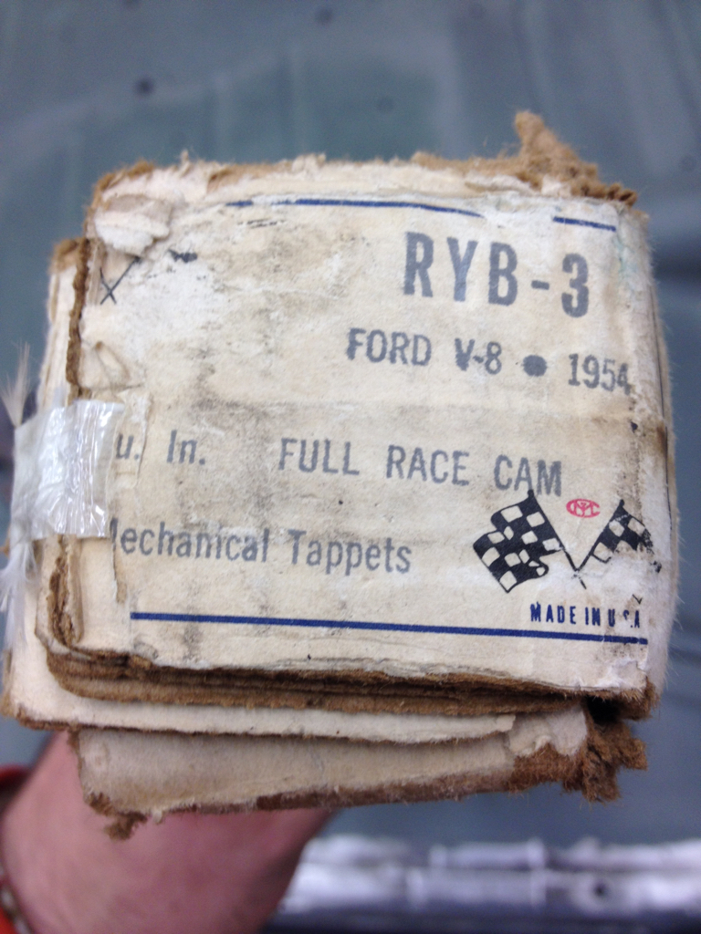

    My friend Mike Kluver found this at a local swap for the truck! Can't wait to install it this winter-

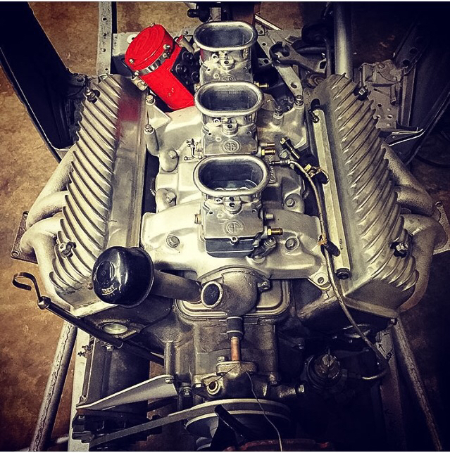

  21. If your Buick drums with those E-T Mags is the coolest thing I've ever seen then this has to be the second coolest. That Spaulding distributor peaking out from behind those Strombergs is just so right! Looks good!

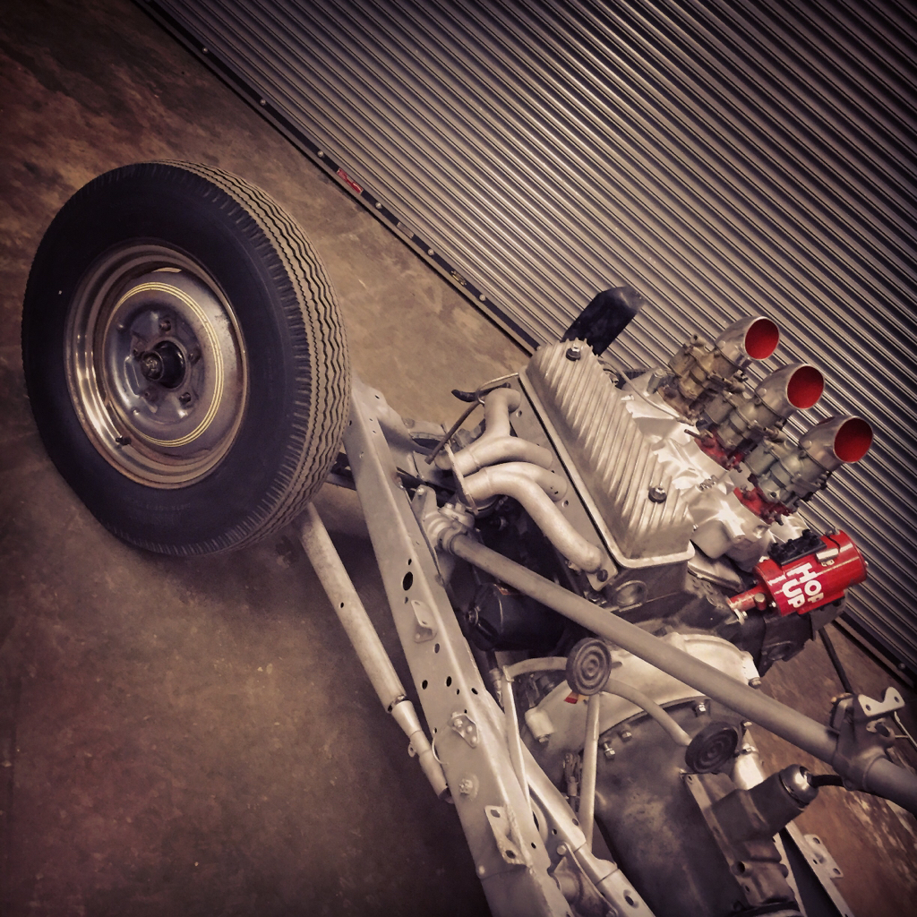

    Got some work done today! Adding a 34 olds crossmember and motor mounts to tie in the frame next to the steering box to help prevent twist and torsional twist of the motor.
    The mounts I made from flat stock to mimic the way Hurst made mounts-
    I relieved the x-member to help clear the x member- it was too close-
    Fixed trans mount issues I was having because of it-
    Salvaged some castle nuts and modified the spring holder and was able to tighten up my rear spring for the first time without c-clamp vice grips (-;
    Getting closer to getting the little odds and ends fixed so I can blow it apart for a final weld job!
