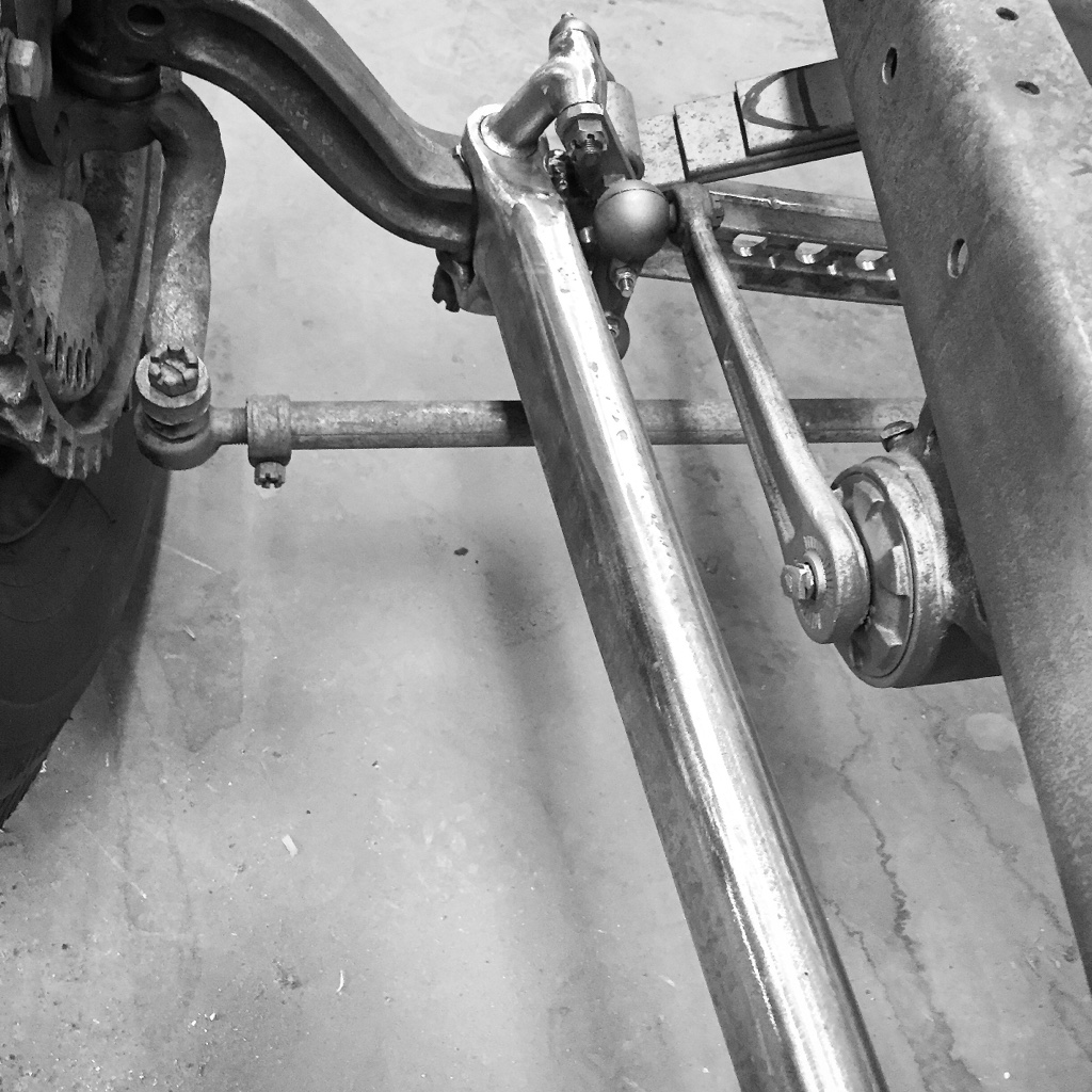

    Mounted front shocks today- they're rear shocks from a 41 ford. I cut the ends of the arms off and flipped the ball- then welded a ball mount on the bottom of the bone.

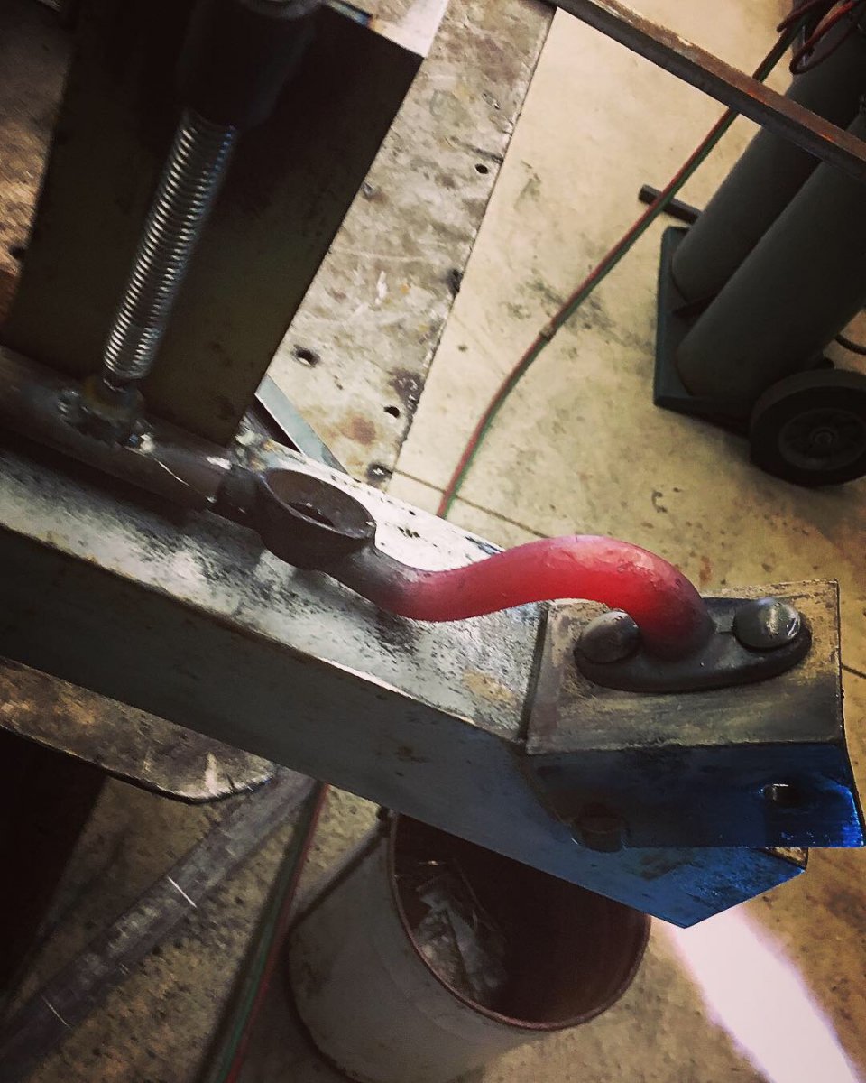

    Thanks man- Like a pretzel! I'll smooth it out/tig fill any valleys when I prep those things for chrome. I had to drop them for the axle and then spin them around to get the tie rod below the bones.
    I mocked up 41 front shocks on the rear- I think I'll be able to mount those in almost a stock location mounted to the model a spring over mounts I mounted to that 40 rear.

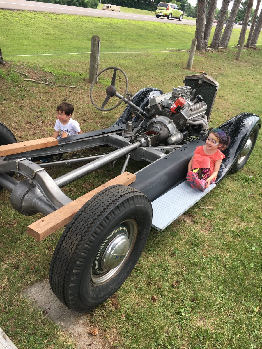

    I worked on the truck the whole Friday before the show. I cut off the rear 40 spring hangers. I trimmed the crossmember a little more for the torque tube and made a nice little cap for it. I drilled and mounted the front shocks. I did a bunch of cleanup grinding. I ended up blasting the ch***is and cleaning up all the parts before putting it back together.
    With this last pic I can really see it as an RPU! (-;

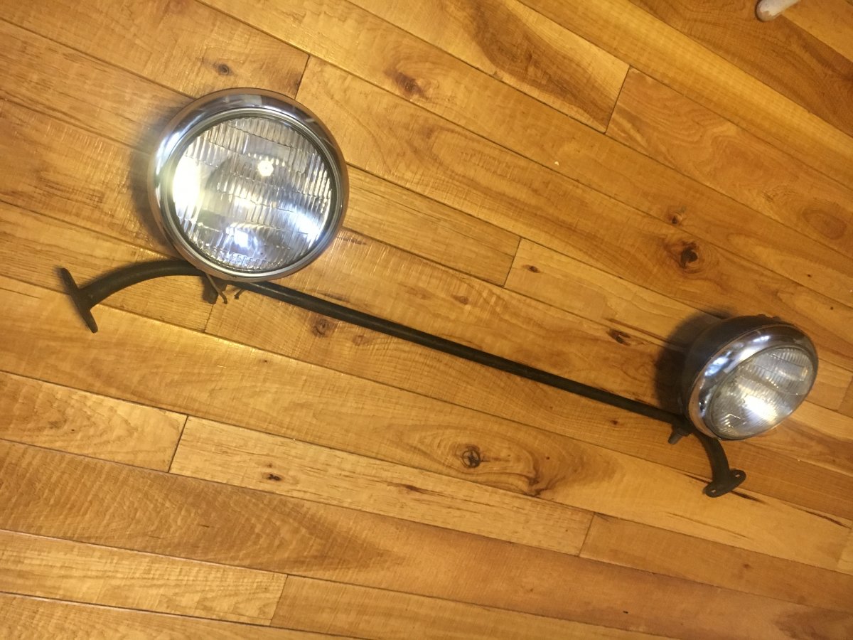

    I had a headlight bar for this thing but couldn’t find it... anywhere...
    I ended up buying another one
    I found some 903-j’s but Rich Bloedorn Turned me on to some Arrow 775’s which look really similar only on a diet.
    I wanna get both and mock up- I really like the look of King bees too but they’re even thinner- won’t know until I get them on the truck!
    I put a wanted add for some but If anyone has any arrows DM me!

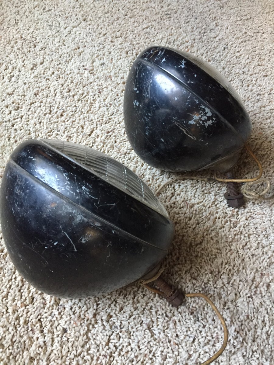

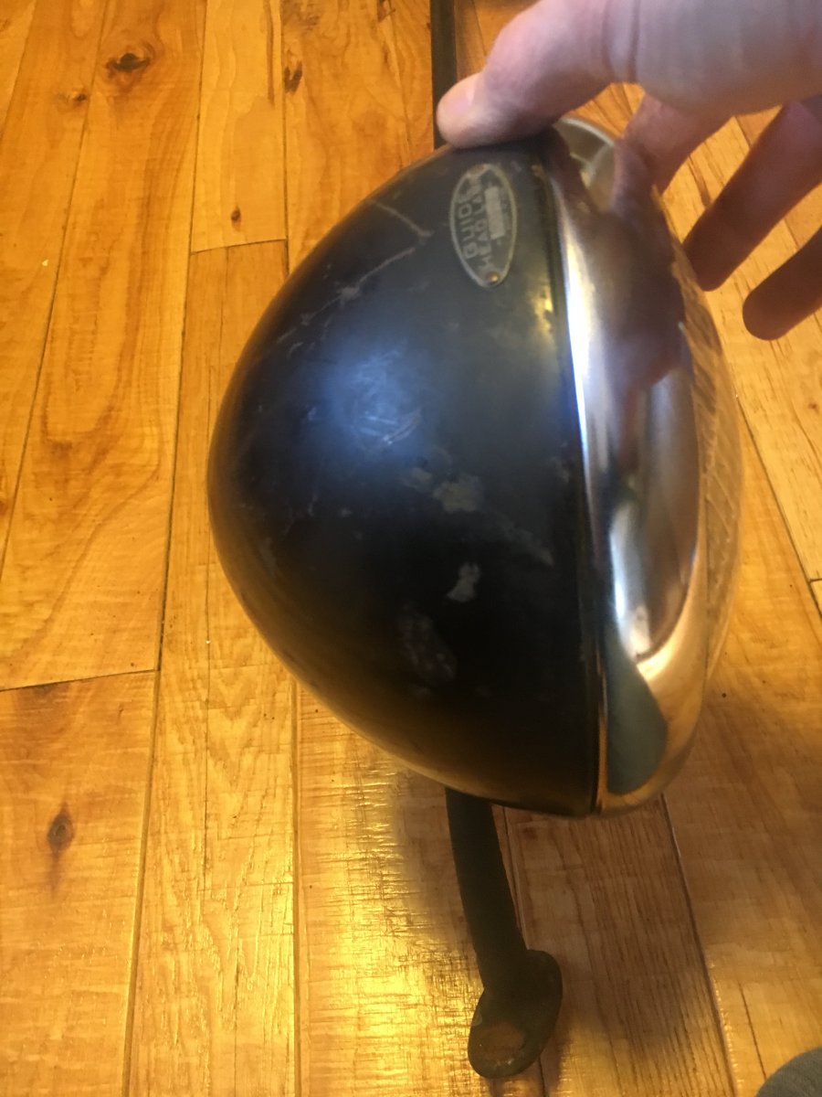

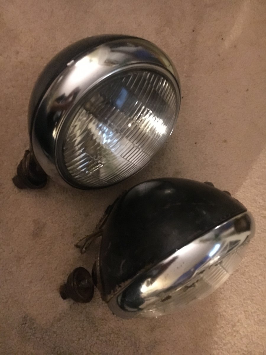

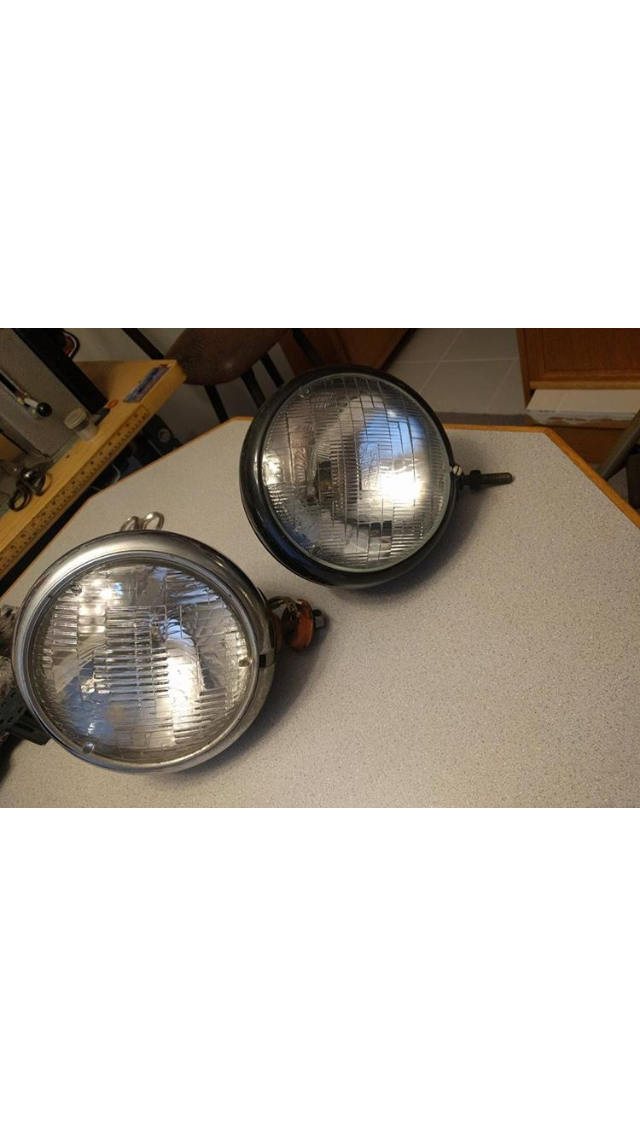

    The Hamb came through thanks to @gordspeed I got this *****en pair! Thanks Gordon-!! I can’t wait to mock these up!
    @sloppy jalopies I think you’re correct.

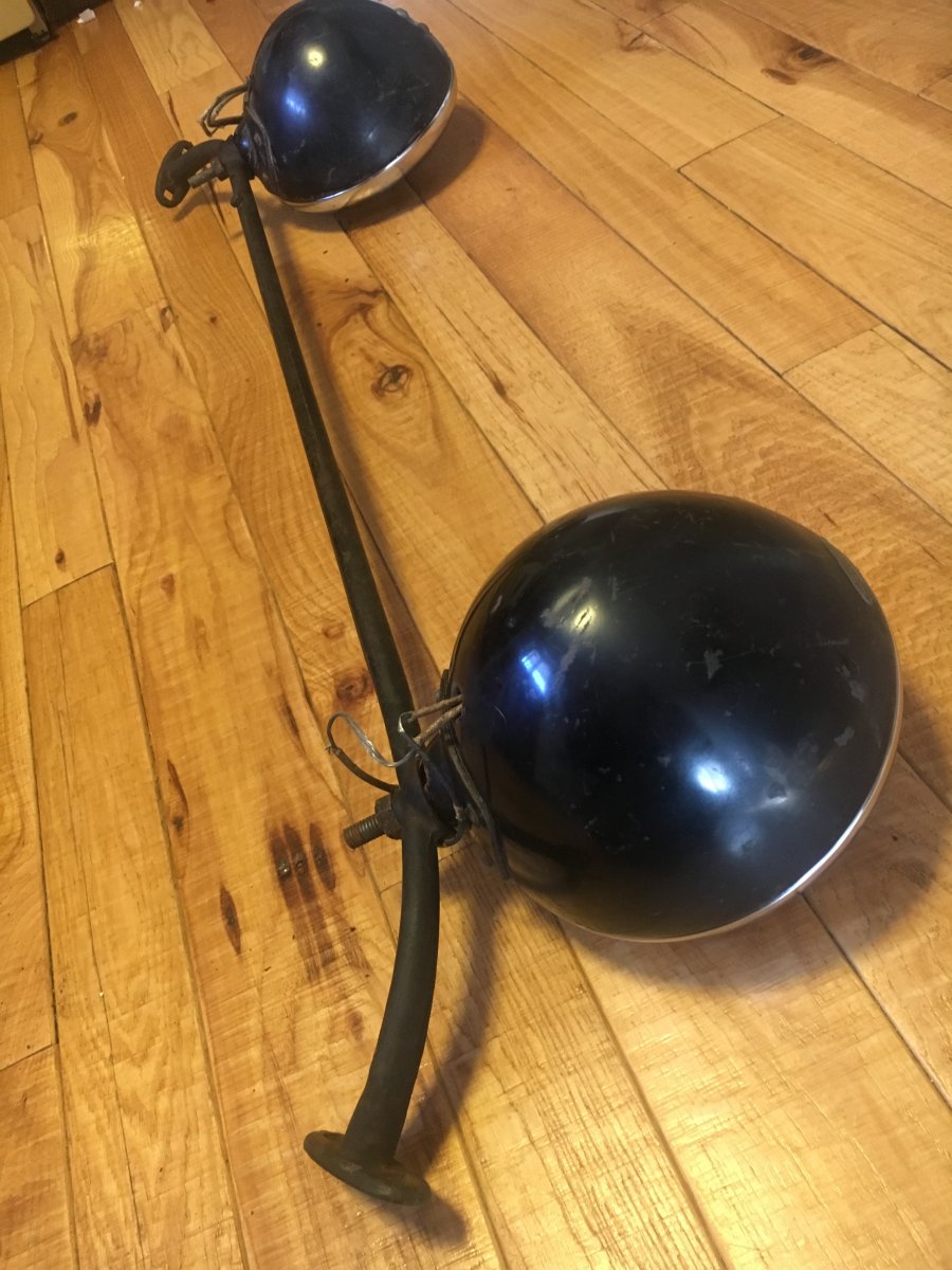

    Not much to report but totally stoked- Picked up my headlight bar today... now now to get up to the shop to bolt this up- Pick of Branches sedan (same lights)

    that headlight bar looks like a 28/9 bar
    i have arrows on my 32 roadster, and yes milners coupe has arrows on it

    It is- I’m running 28/9 fenders (-; Joel said this bar originally came from a 29 he got from you @***us (-:
    Still waiting for the Arrows from @gordspeed and then its mockup city! :)

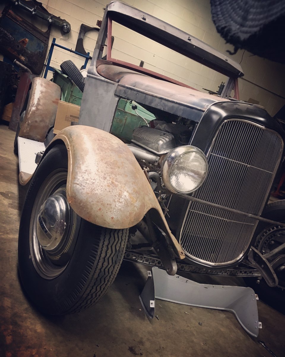

    I need to make a headlight bar jig so I can drop the headlights about 3 or so inches- and then they’ll be in the zone!
    Nothings really bolted the fenders are just sitting there. I traded into really mint fenders over the summer. Got a nice splash apron too.
    I realized I need to order some hardware for the fenders too/headlight bar too-

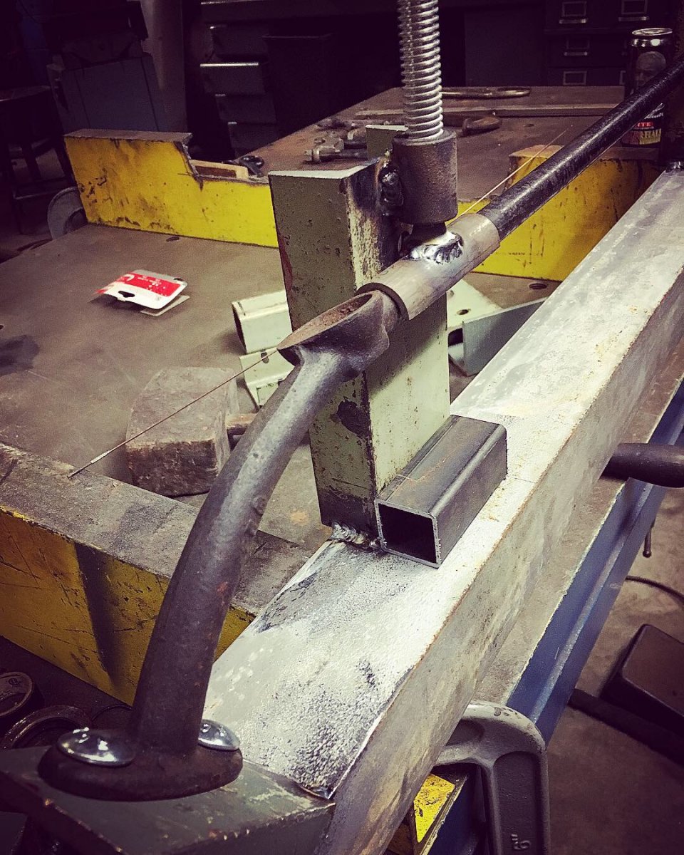

    2492BD10-1120-4488-A4C3-444CA0A6C2EF.jpeg View attachment 4212797 View attachment 4212798

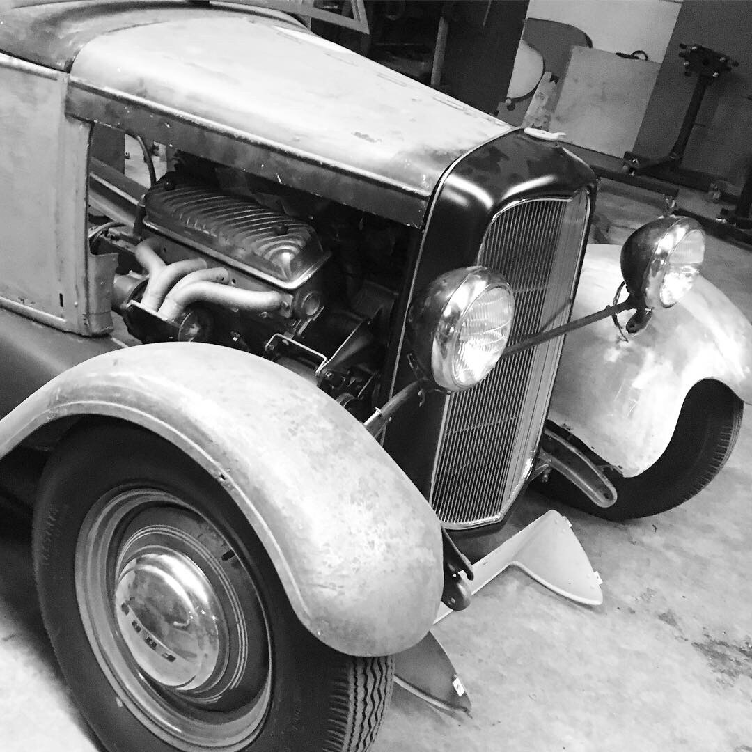

    5827BF0B-FA88-4670-A0C0-90EB523B7A89.jpeg DD4D21E2-0520-4CB2-8325-A65C7AD12CA6.jpeg 890A0CC4-6C5E-4D27-8CE9-CD2D84AE6B3B.jpeg
    I made a jig which worked but the half tubes tilted and put pressure on the ball so I’m making slides that will go up and down on each side of the c-channel that will get welded to those and keep them from moving-
    I dropped them 4 3/4” approx... I used a 3/8” plate as a spacer/stop. I was originally gonna go 3 1/2” but it looked like I had plenty of room to go more and still clear the headlight and bolt-
    I ran out of time otherwise I would’ve mocked up the arrows.
