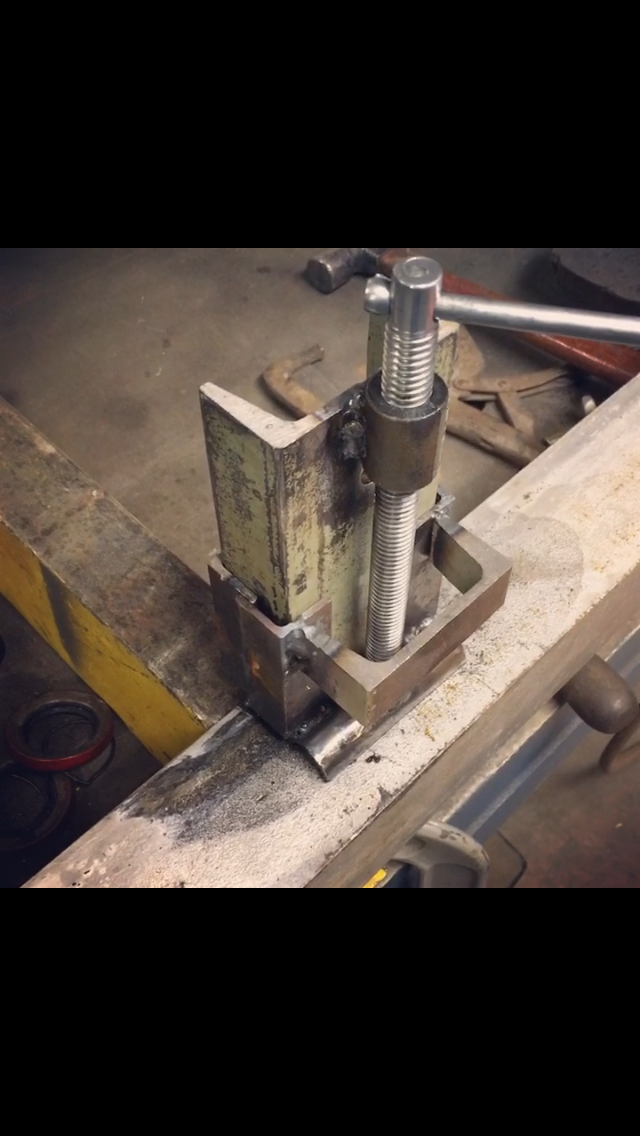

    Here is my updated jig- added the slides that grip the tower and keep the half round piece from tipping-

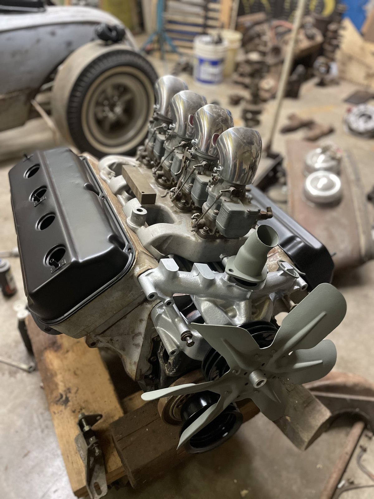

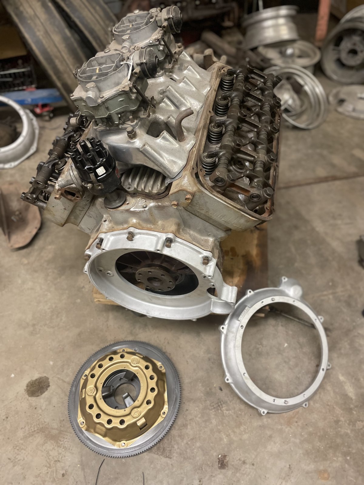

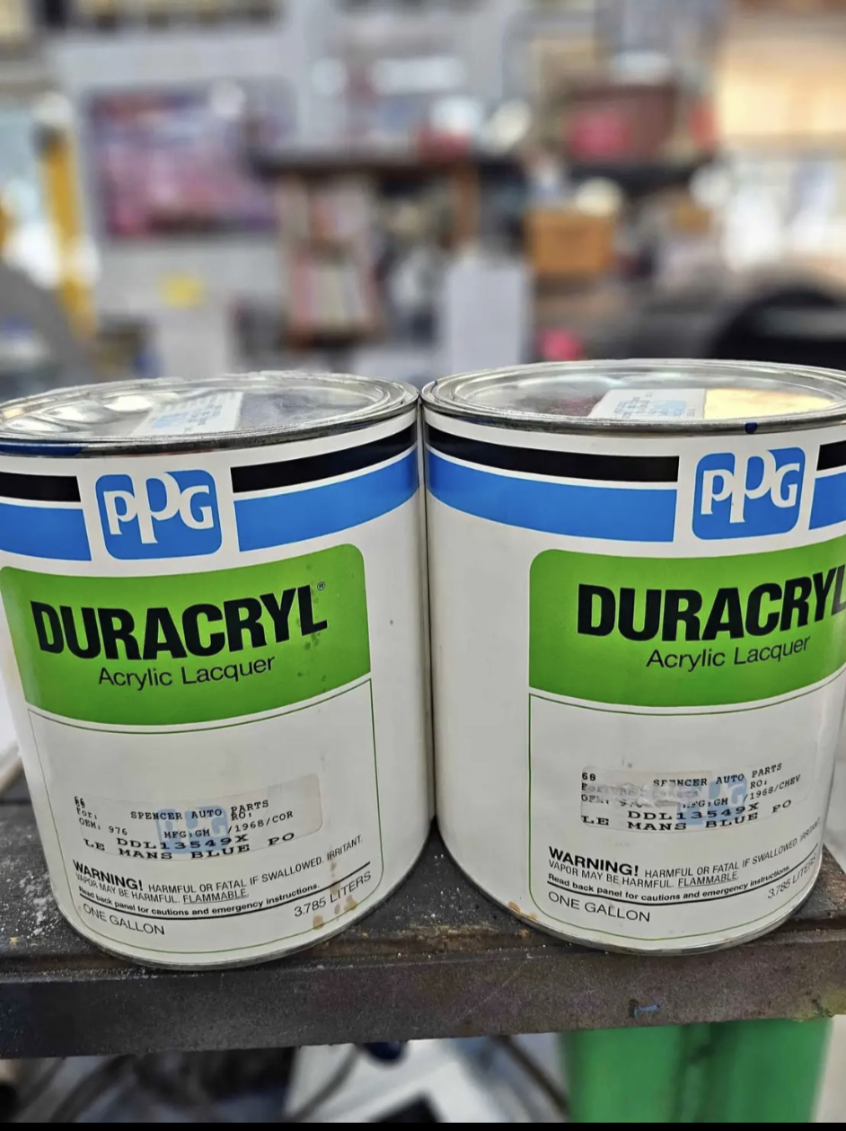

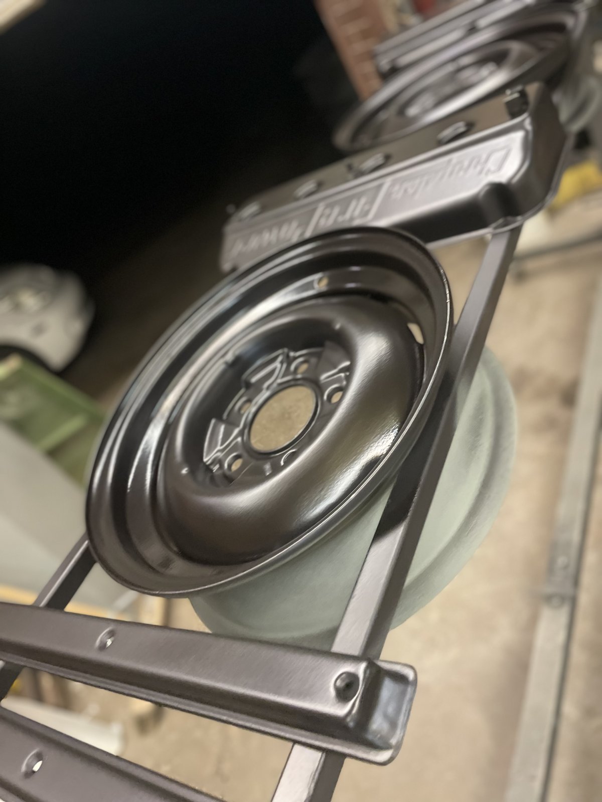

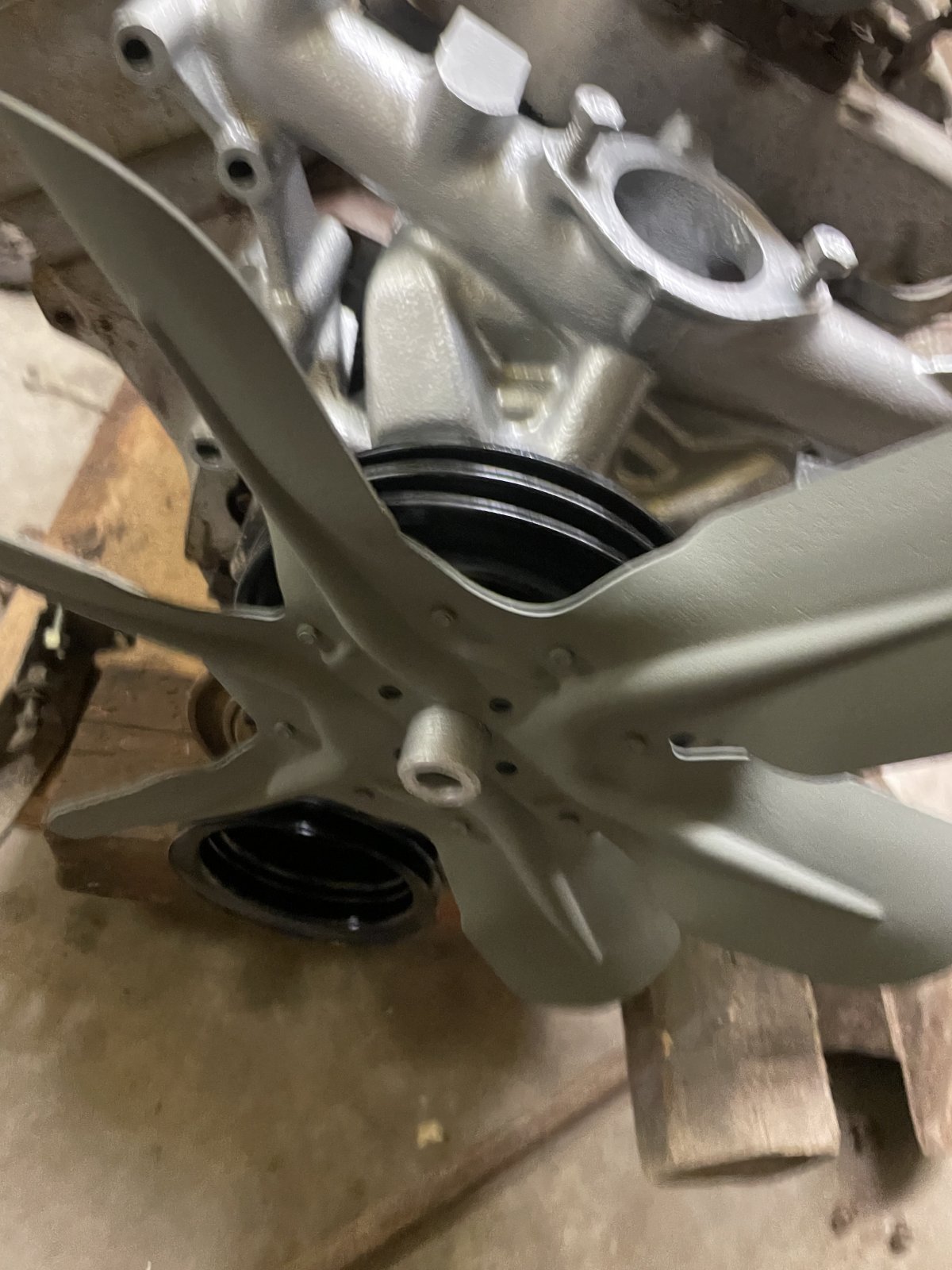

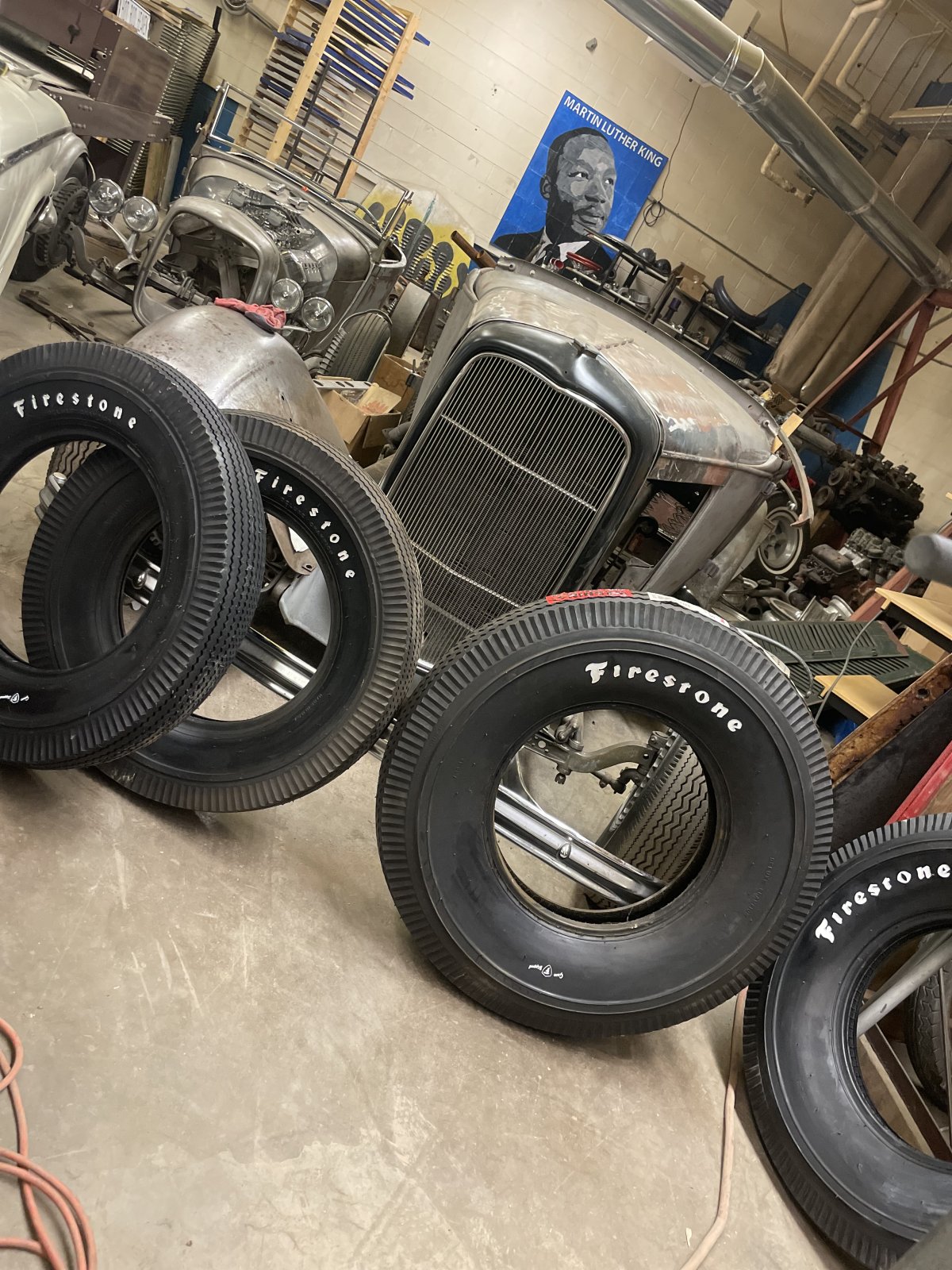

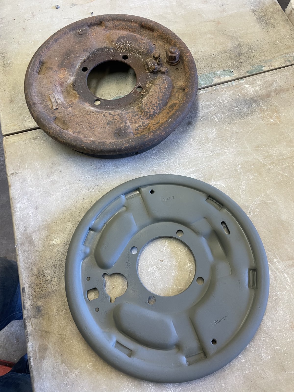

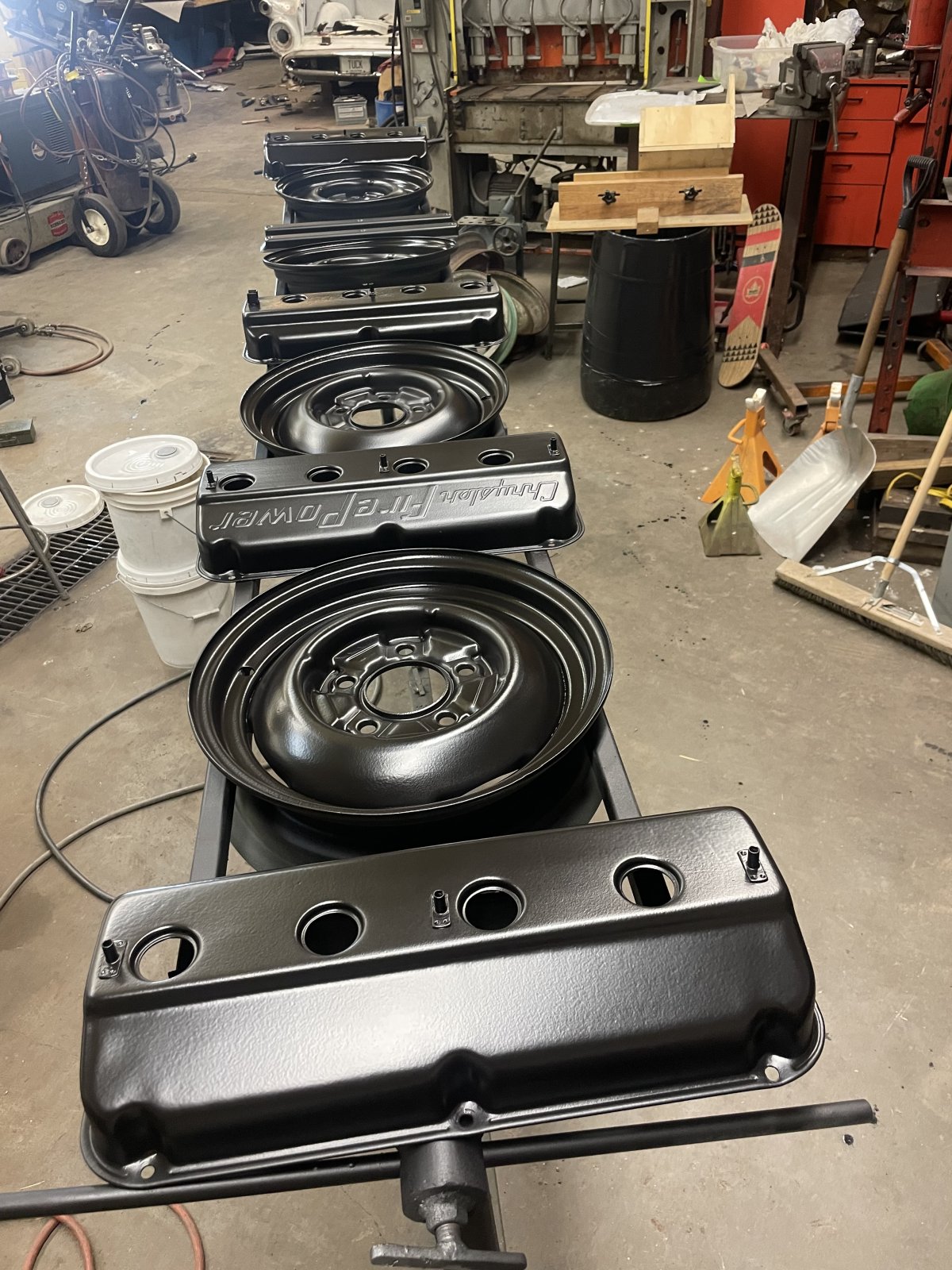

    IMG_5643.jpeg IMG_5542.jpeg IMG_5539.jpeg IMG_5534.jpeg IMG_5504.jpeg IMG_5413.jpeg IMG_5503.jpeg
    I haven’t worked on any of this for a couple years… but as of a month ago my messy divorce is over and I can finally breathe… and then as if a switch had been flicked back on…
    I’m grateful for it now but in the beginning I thought my whole world was crashing down around me… but sometimes things need to burn and we prune the dead fall in our lives to make way for new growth.
    I haven’t posted any pics anywhere but I’ll post progress here. The yblock is coming out and going in a shoebox. I was ****ing around with a tape measure and figured out the rebuilt 55 hemi I had in the corner would literally fit in its place with minor mods.
    The kid in me said do it and I listened.
    Bought a couple gallons of acrylic lacquer, it’s lemans blue. First thing I’m painting is the wheels and I’ll mount the new blackwall firestones, I painted the lettering white. I blasted the wheels, etch primed and they’re in black surfacer. 5” wide truck wheels in the back and 4” up front,
    Then I’ll paint the fenders and I’m gonna flame them in candy lacquer over a silver base.
    bought all new brakes, master, cylinders, springs, pads.. I’m going to prep and paint a bunch of gloss black parts. I’ll paint most everything except a few parts like the front axle etc. I’ll chrome.
    Found a nos cragar adapter to early ford top shift. Flywheel is surfaced, new old pressure plate. Have the pilot bush adapter. (Making more will be for sale on my site)
    found a 57 starter to match the 57 172 tooth flywheel, painting and rebuilding that.
    The Hemi is a NE55 short bell block out of a New Yorker originally with a 4bbl and 250 Hp. Haven’t been fired yet, just waiting in ***embly lube.
    bought some Chrysler silver paint to paint the block and valve covers. Should have the engine painted in the next week or so. Deer hunting is gonna interfere a bit.
    I’m either going to run the Horne or the edmunds dual quad. As cool as the Horne is my heart right now loves the edmunds.
    I want to get this on the road next summer, the body and box will be in red oxide and I want to have the rest painted. I can’t wait to pick up my girls after school in this…

    A vote here for the Edmunds dual quad!

    I think that intake is my favorite hemi intake of all time… because of its size, it’s more proportional to the heads, that’s why blowers look so good on a hemi. I love the crudeness of edmunds castings and I love those Carter 4bbls… they way they look from the top. It’s a shame to run air cleaners on them.
    That intake I got from Bob K which makes it even better.
