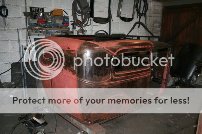

  1. I have had this body stashed away in the shed for a few years now.
    My 14 year old son keeps pestering me to get it up and running.
    So to keep him interested and involved we have decided to get it built up and ready to run in the flathead meltdown at the Hotrod Drags. (September 18/19)
    This is how it all started at the beginning of August.
    Panels are now all bolted together.
    If I can't get any top wood I am going to make a steel box section frame for the top.

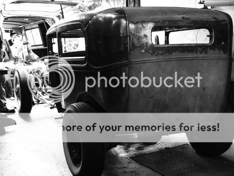

    Mid August and we started back on the sedan and have now beefed up the roof with some 25x50 and 20x20 box section
    With all that done we have now marked out the body ready for a 5" chop ;D

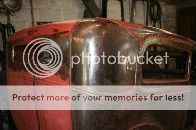

  2. had a day off work 16th August so we decided to chop the roof.
    We took 5" out of the roof.
    Ricky making the first cut
    No going back now ;D
    All tacked in place, just got to finish welding it all up and chop the doors.

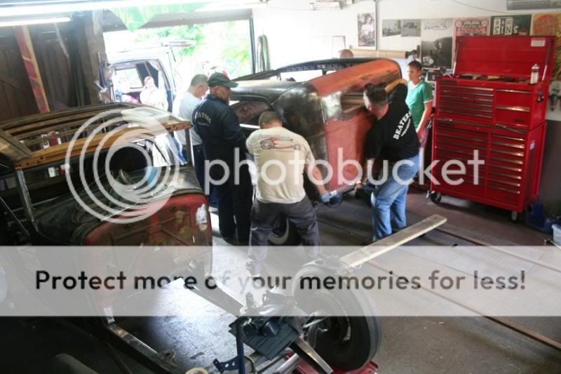

  3. When we were roof chopping the Coupe on August 21st the power went out and someone had the bright idea to start on the sedan while we were waiting for the power to go back on.
    So in came the T
    Then it was all hands on to strip it down, the end of an era for the poor old T :'(. the old girl done us well over the years.
    All stripped down
    Then on with the Sedan body
    So its now just resting on the rear wheels, next job is to make up the floors and bolt the body down.

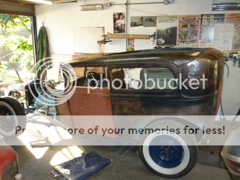

  12. Bit more done today
    Lifted the body back off and painted up the underside.
    Body now all bolted back down

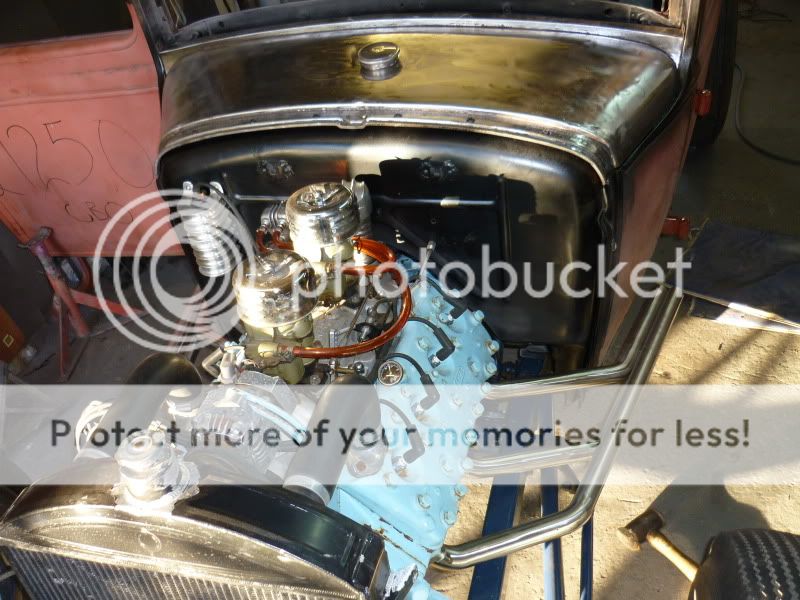

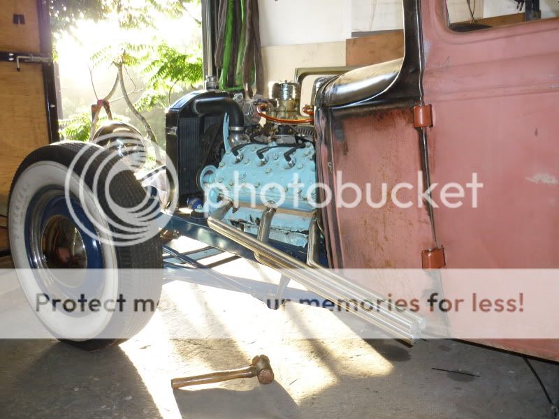

  15. 12th Sept
    Got the headers made up plus a few other jobs
    Just a few more jobs to finish this week and its all ready for the drags
  16. The car was finished in time to run it at the HotRod drags this weekens and ran in the flathead meltdown with a best time of 16.9
