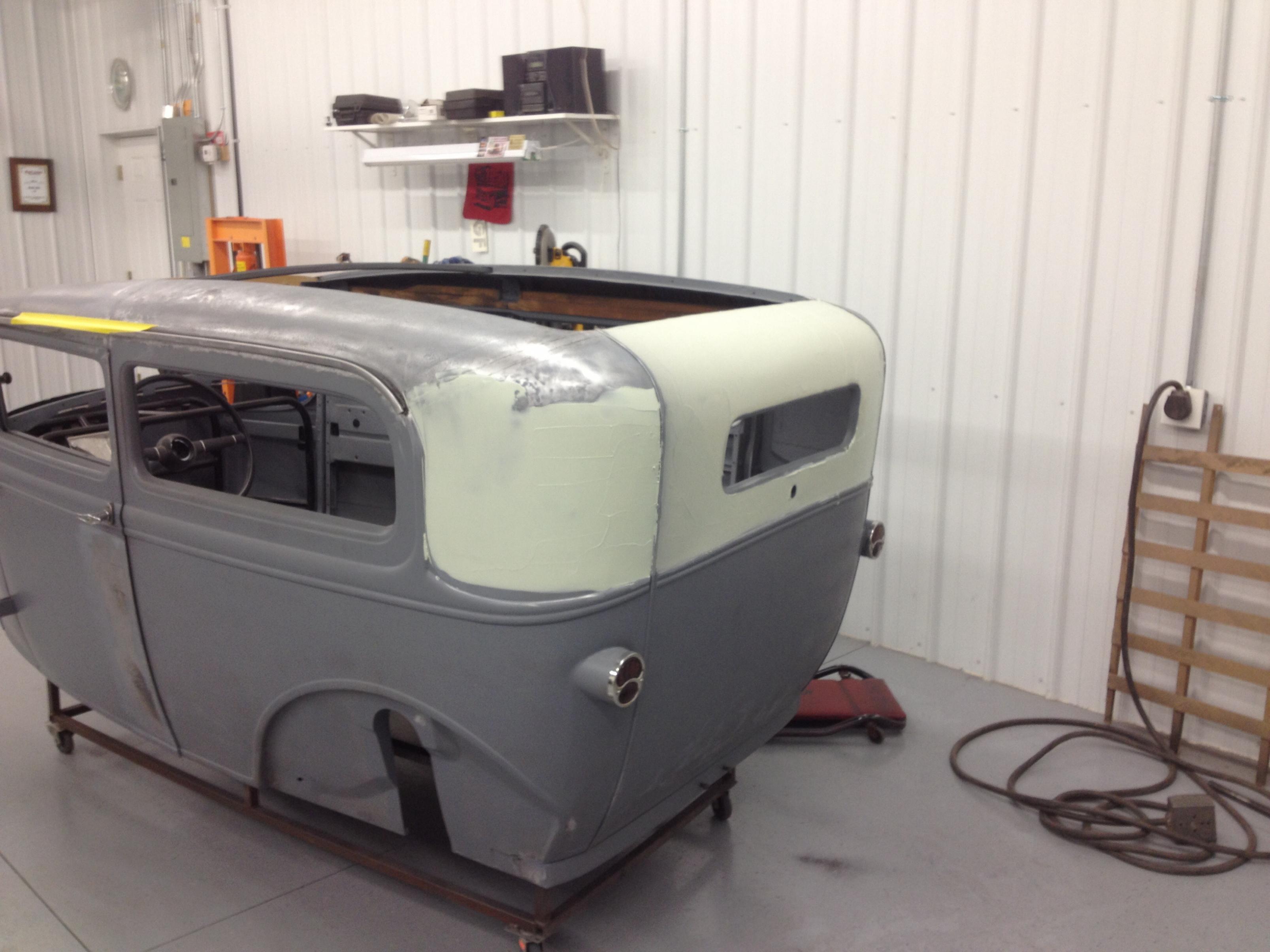

  16. I've been working on finishing up the roof area. I'm planing on putting a coupe style vinyl insert in the roof. So the channel that runs around the back had to be removed. On the top of the quarter panels I cut the channel out and welded a new piece of metal in ImageUploadedByH.A.M.B.1385478909.517060.jpg
  17. The top of rear body panel I hammer and dollied the channel flat. Then welded up all the slotted holes shut. ImageUploadedByH.A.M.B.1385479270.676298.jpg
    Then I had to take care of the mess between the two panels and the bead. The bead was a 1" too short so that need a piece add to it. ImageUploadedByH.A.M.B.1385479570.161656.jpg
  18. The front next to the visor needed work too. I filled the two holes and connected the roof panel to the visor. ImageUploadedByH.A.M.B.1385479739.236818.jpg
    Thanks guys,
    You are talking about this strip right?
    On the sides from the raised T strip to the rain gutter I cut the slotted grove out completely. I then tig welded a strip of 18ga ( hammer welding as I go) in to replace it. Being the corners of the roof have a pretty good curve to them there was very little warpage that's why I cut them right out. As far as across the top of the back panel goes. I hammer and dollied the channel flat first. Then I held a piece of br*** ( a large br*** punch) on the inside of the holes and mig welded them shut. I didn't cut that strip out because I figured it would be a lot more work and would have warped the panel real bad. ImageUploadedByH.A.M.B.1387860028.092224.jpg
