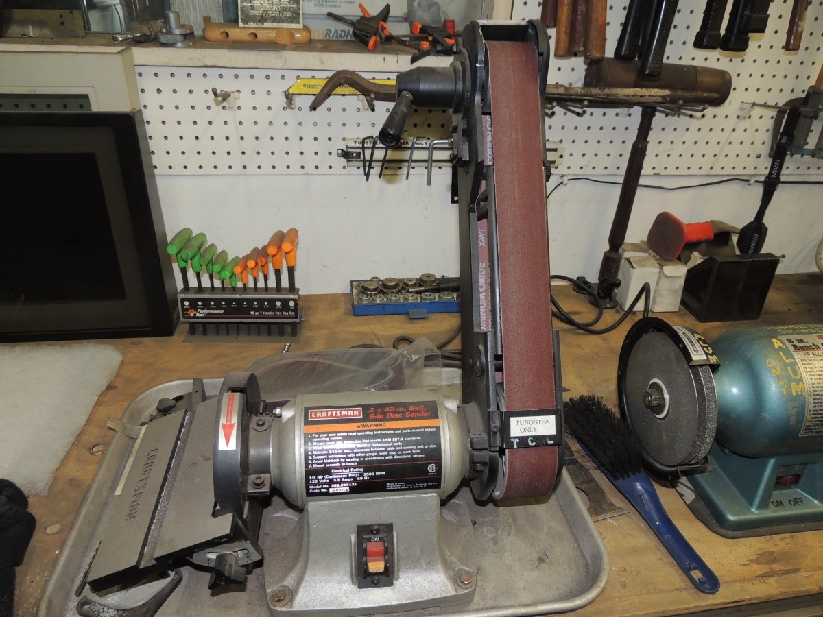

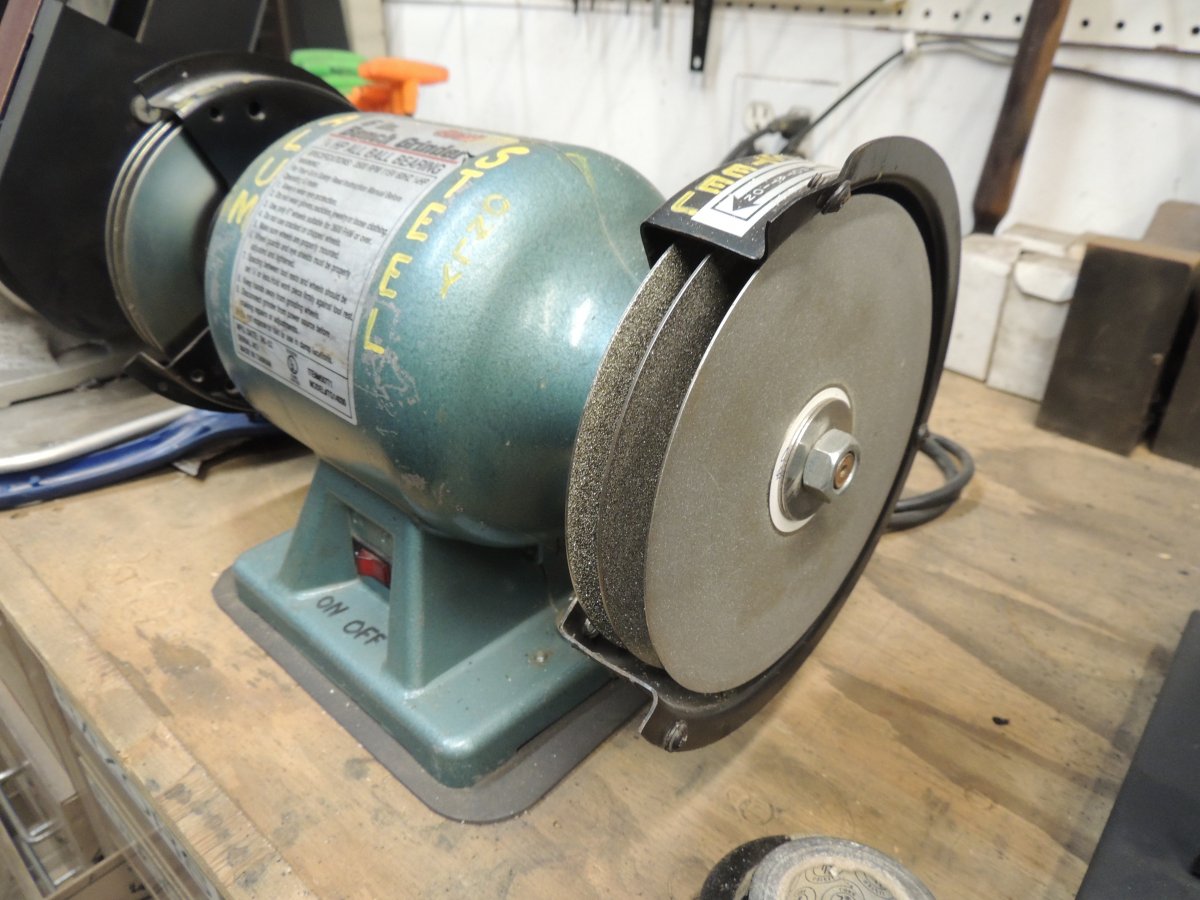

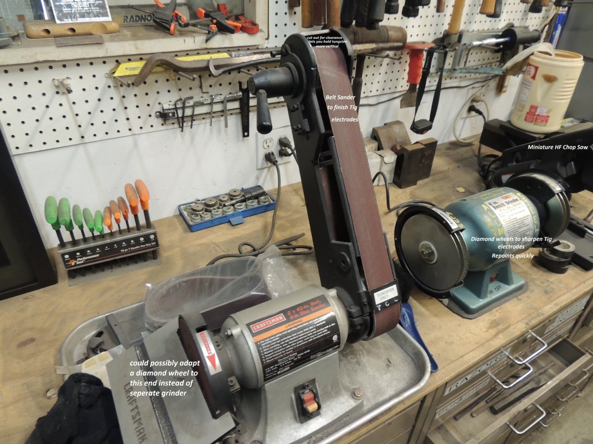

    I bought a small grinder and put some diamond wheels on it. In my typical overthink fashion I bought fine/med/coarse wheels. Turns out that the coarse wheel was all thats needed. The diamond wheels don't break down and they are great at quickly removing the unwanted crap on the tungsten. I put one on each end of the grinder so I have one end dedicated for aluminum and one end for steel etc. Since the sharpening needs to be made longways instead of radially, I then move to a small belt sander and finish the end.
    The thing I find is that it takes a LOT of work with the belt sander alone, but the diamond wheel puts a good tip on it in just a few seconds. So in the long run, you save enough belts to pay for the other stuff.
    I also bought one of the small HF chop saws. Its perfect for cutting the tungsten off when needed. It might be possible to put a diamond wheel on the opposite end of the belt sander instead of buying a separate grinder. I also cut away the very top of the belt sander for clearance to let me hold the tungsten more vertical. I'm tellin ya, the diamond wheel works great for quickly pointing the tungstens and they don't seem to wear out.....and I grind a lot of tungstens when I weld.:D:D:D
