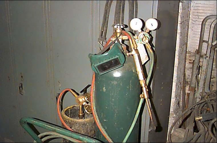

  12. squirrel
    Joined: Sep 23, 2004
    Posts: 59,932
    squirrel
    this handy device can both make clearance for the exhaust, and be used to make the headers.
    Deuces, mgtstumpy, 46Chief and 4 others like this.
  13. partsdawg
    Joined: Feb 12, 2006
    Posts: 3,927
    partsdawg
    from Minnesota
    "this handy device can both make clearance for the exhaust, and be used to make the headers."
    Missing the required BFH in the picture

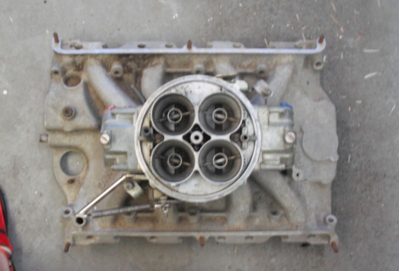

    Ok, back to serious stuff, Do NOT think in terms of running a pair of 390's 0r 450's on that intake, get a proper pair of carbs. 660 center squirters...

  30. Crown'd
    Joined: Jan 19, 2014
    Posts: 120
    Crown'd
    from Utah
    Everything I've ran is single 4V, I ***ume there's something particular that makes you say that. Please enlighten me. ;)
