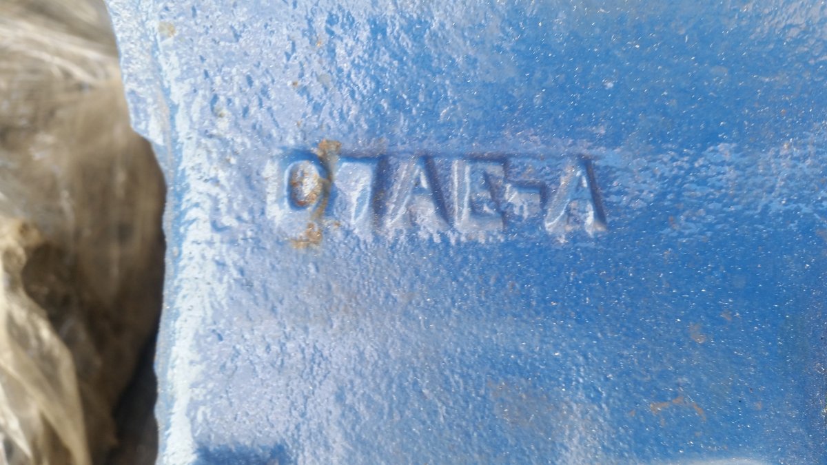

    A Google search on C7AE-A; 67 side-oiler or 68 marine FE block http://www.mustangtek.com/block/Block.html http://www.fordification.com/tech/castingnumbers-FEblock.htm
    Screw in welch plugs and cross bolt mains. I only had a 390FE in my 66 GTA and Tri-Ys in RHD format (Australia) were a real PITA to install in a unibody with shock towers and that exhaust bolt pattern at 12 O'clock and 6 o'clock. I would think those huge tunnel ports whilst being impressive would love high RPM to get the best volumetric efficiency, similar to Boss 429 heads. What about some medium riser (MR) heads on the street as those tunnel port heads are rare these days. I would still love to side step the clutch with those TP heads :D

    It's happening, but may be longer than I thought. I won't run that block, or either crankshaft. After some research there's too many advantages to a beefed up block from Pond or Shelby to risk an old one damaging them. And to really make it streetable it wants to be stroked, so I'm building another 482 (just finished one a year ago). Probably run a TKO wide-ratio 5-speed manual with 600 hp...set up properly it could run the Power Tour. (Not sure I would, but it could.) I will go through the effort to get long tube headers possibly.

    Close inspection revealed that block had rotted from the inside out...it had been used in a boat and the corrosion in the water jackets must have been horrible...not much wall left, especially after being bored .040". If I run across a vintage block for cheap I'd be interested in building it, but great vintage blocks are still weak and not far off the price of aftermarket.
