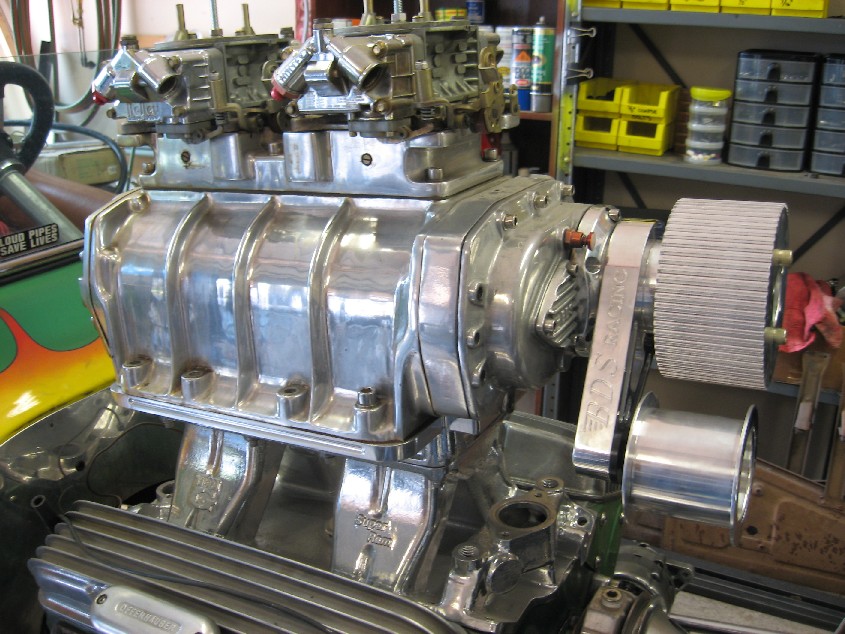

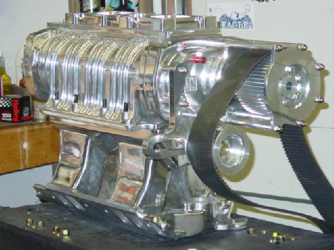

    Been looking into makeing one of those for my bbc in my Hondo drag boat. Should act like a small intercooler. Cant use it in my modelA want see out the windshield(lol) :rolleyes: As soon as I get a victor base for my BBC in the boat my neighbor is gonna machine the plate for me. Here is a pick of my friends tbucket with one he is doing and some other picks I have collected.:cool:
    DemonTweaks and kidcampbell71 like this.

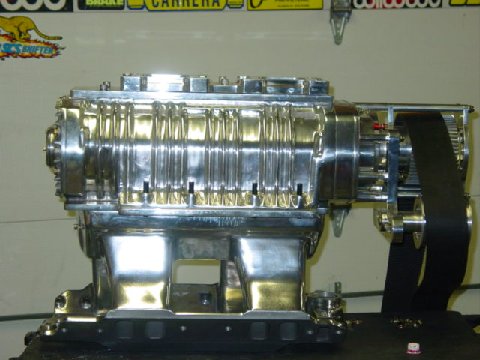

  13. abone1930
    Joined: Jan 16, 2006
    Posts: 1,324
    abone1930
    Hampton did the nice polished ones. :cool:

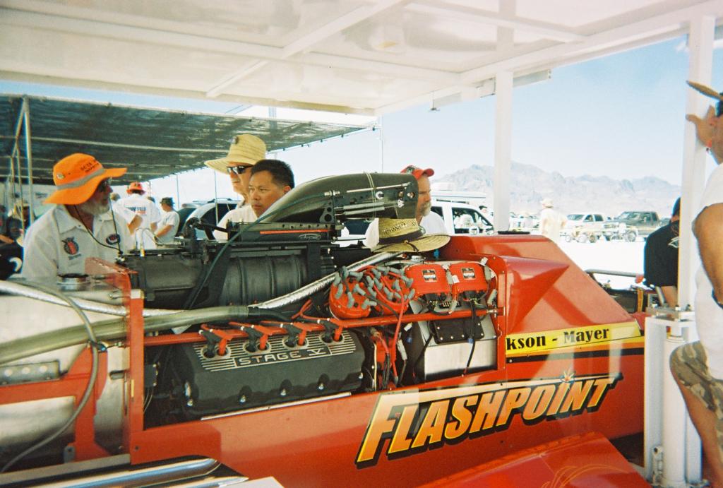

  19. My 6V71 on top of a custom tunnel ram and Offy crossram adapters.
    GordonC and METAL MELTDOWN like this.

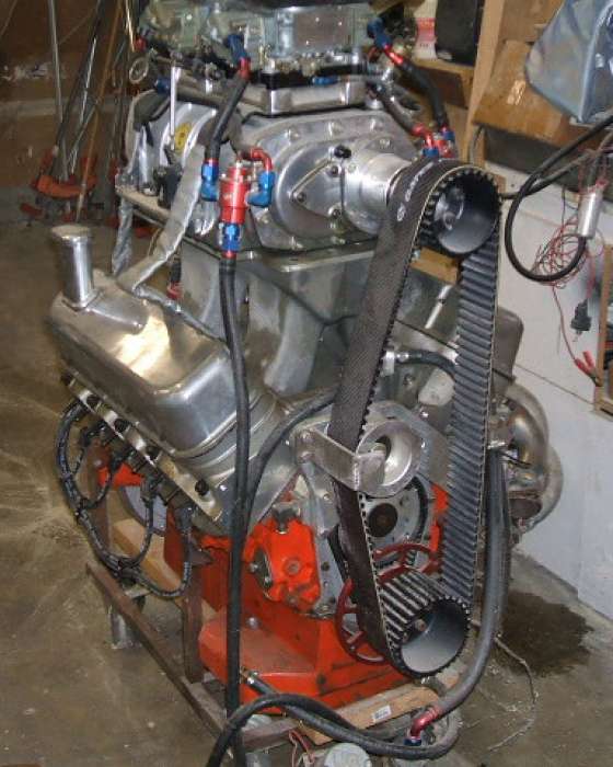

    Look at this thing. It's an 18:71. Not one of those sissy NHRA blowers. The opening to the manifold is way in the front. Long way to the back of the rotors, Seemed to work great 1471 .jpg

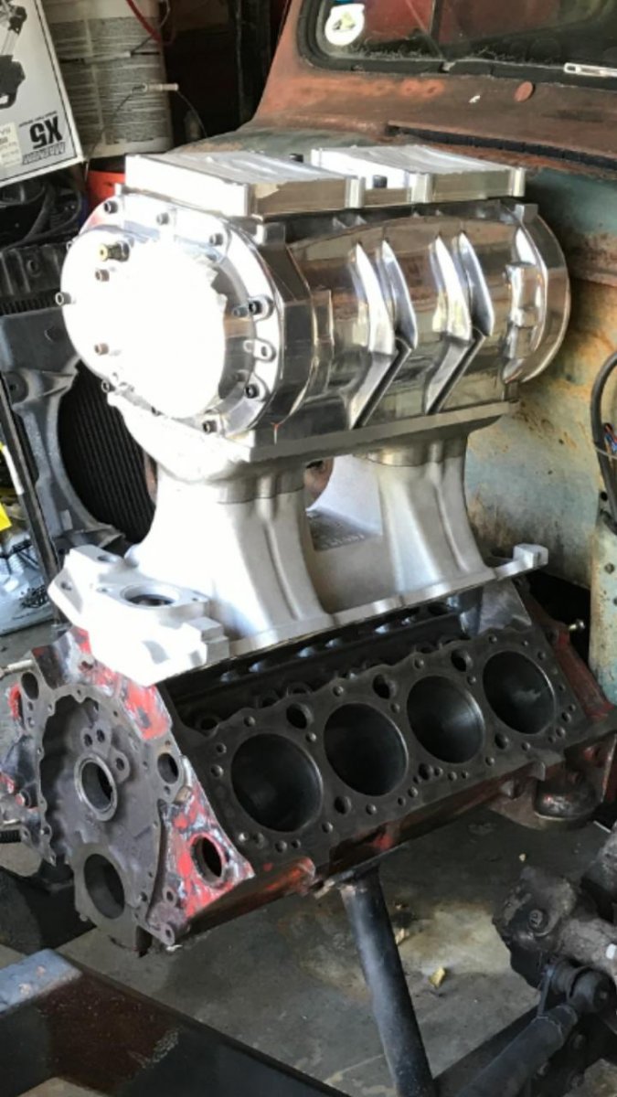

    I'm bringing this back up from the dead...
    I'm looking to bolt my polished Weiand 8-71 to a tunnel ram base for my SBC. I'm building a street freak style *non HAMB friendly* and I like the attitude and the altitude of the tunnel ram look. Can anyone provide some insight/suggest parts regarding the easiest way to get this done? I've reached out to Hampton blowers about their setup, but no response yet.
  26. 19Eddy30
    Joined: Mar 27, 2011
    Posts: 3,380
    19Eddy30
    from VA
    ^^^^ nothing new things like this have been done since the 50s , what's your specific question ,One will be $ , you will have to experiment with a tall intake running carburetors because the front cylinders can run leaner than the rear cylinders, with mechanical injection and EFI easier to fatten up front cylinders ,you will need a longer belt than normal, & possibly a snout support depends on the intake being used
