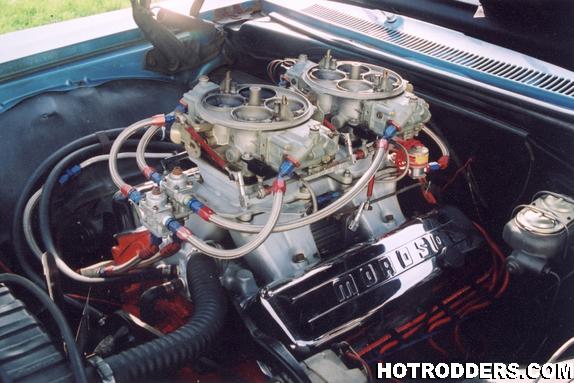

    Top Fuel
    from Cincinnati
    I have ran tunnel ram setups on the street and track for over 25 years with great results. The 390's (Holley 8007) work great, but are getting pricey. The 450's (Holley 9776) work very well even though they have mechanical secondaries. I have run the 450's on small blocks from 283 to 406 with only minor accelerator pump and power valve tuning. While the 450's can be run on a big block, they are best used on smaller engines and they do generally require some re-jetting.
    There are many factors that go into putting together a good running multi carb set up. The "trick" is to have good velocity through the entire intake system from the carb venturi past the intake valve. All to often, people put a tunnel ram on an engine with huge intake ports and a huge cam designed to operate above 4000 rpm, then they blame the tunnel ram for streetability and drivability issues.
    Almost any carb and manifold set up can be MADE to work on the street. Here is a picture of the set up I run. Yes, it took quite a bit of work and the throttle response isn't what anyone would call "crisp", but it is streetable and it does get the looks. By the way, that's a 433 in. engine.
    I feel fortunate that I have been able to help many people run multi carb set ups when eveyone else told them it was impossible. Carb tuning is getting to be a lost art. I do more than my fair share at my shop and am glad to do it. If anyone has any questions, please feel free to PM or email me. I'll be glad to help.
