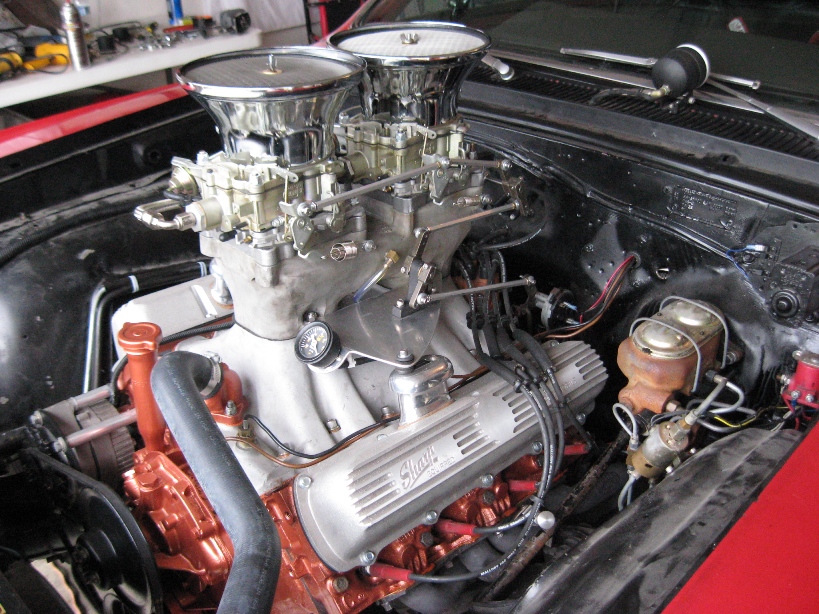

    I've been running Qjets on my BB Olds tunnel ram setup for about 6 months now...really like the responsiveness, and at 1500cfm total it's pretty peppy too :D
    Funny thing though, when the temp is in the 60's-70's this past spring and the humidity is up the intake has crazy condensation all over it! Thought I had a m***ive fuel leak the first time it happened!

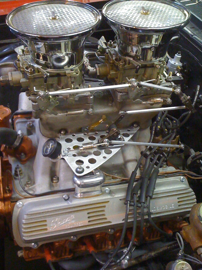

    We've done lots of tuning now, made some changes related to the fuel delivery that has helped a bunch and exposed some other problems we were having as well...
    Had a dead head style Holley regulator with the electric pump, fuel pressure was not staying steady under heavy load with the two carbs...
    Switched to a Robb Mc Performace byp*** regulator with return to the tank and it's MUCH better, car runs out properly on top now.
    However, doing this showed me that the fuel tank sump area I made in the factory tank needs to be changed, because I can "see" the fuel pressure drop when it gets low and I stand on the throttle :D
    Not the best pic of the regulator, but you can see it in the upper corner...
