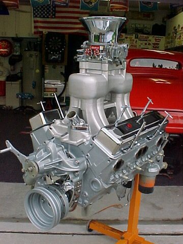

    These engines were not special built for running a tunnel ram, I like to keep things simple for trouble free driving.
    Two 500 Edelbrocks, great on the street.
    I had two 600 Edelbroks on this one, yea, I love tunnel rams.
    Single 600
    mad mikey, wraymen and ampsbad41 like this.
