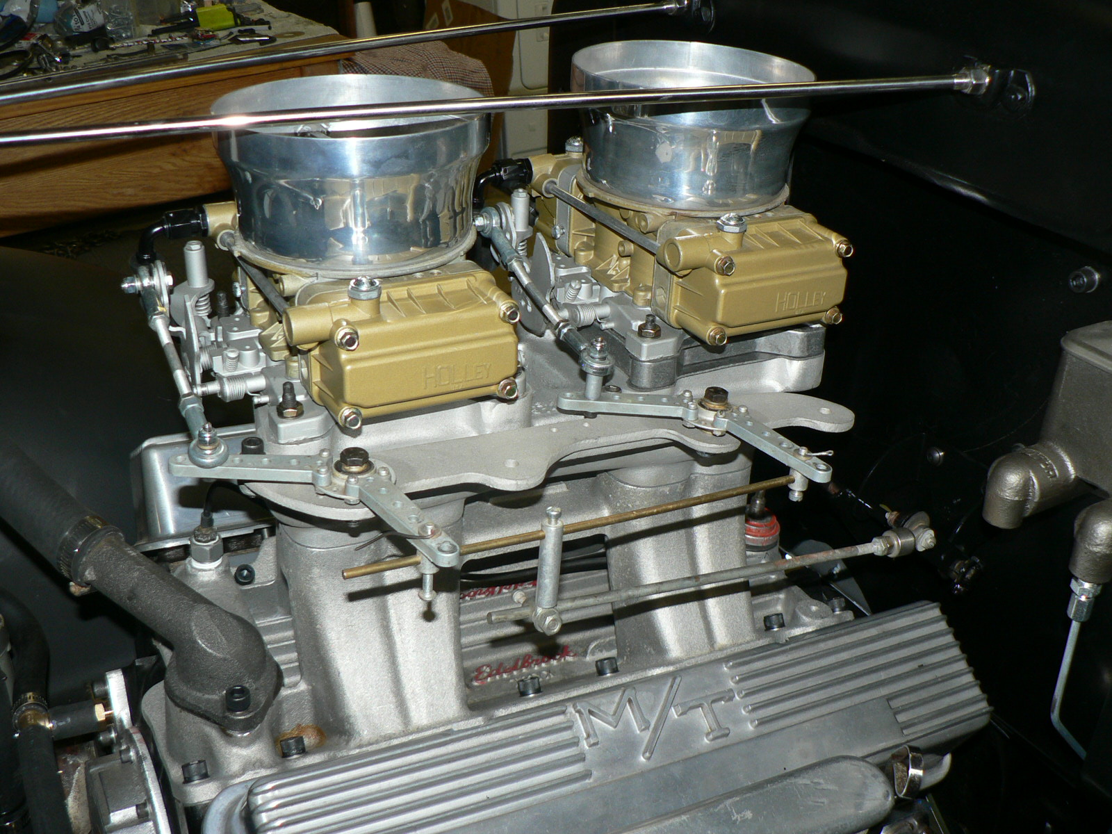

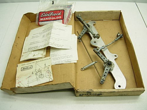

  2. gasserjohn
    Joined: Nov 9, 2008
    Posts: 1,218
    gasserjohn
    660 holleys
    original edelbrock linkage....

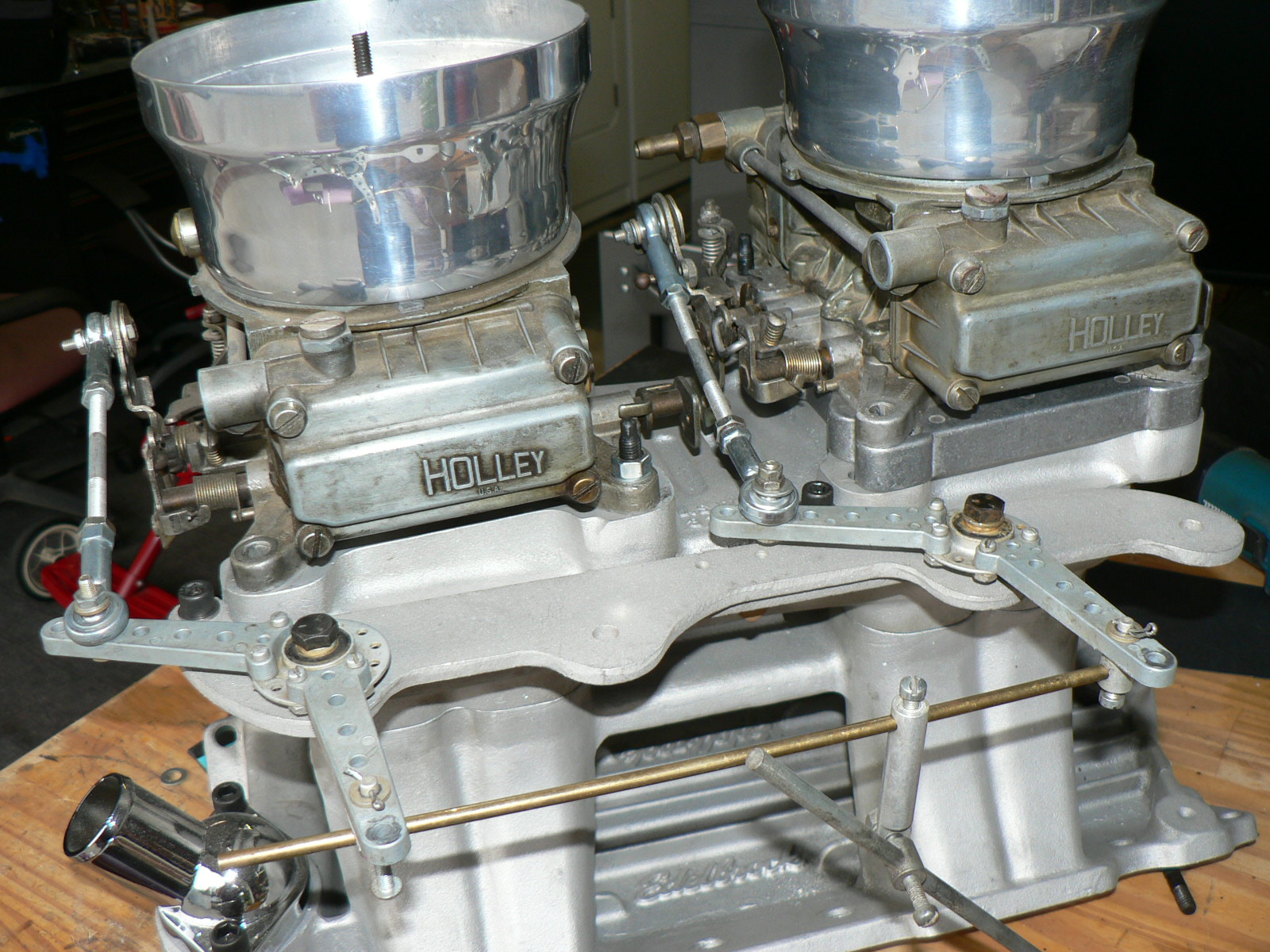

  3. gasserjohn
    Joined: Nov 9, 2008
    Posts: 1,218
    gasserjohn
    previous photo 450holleys
    this is the 660 carbs......

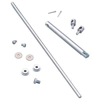

  4. gasserjohn
    Joined: Nov 9, 2008
    Posts: 1,218
    gasserjohn
    here's the simple summit linkage for in line holleys

  6. awsomeears
    Joined: Feb 5, 2011
    Posts: 159
    awsomeears
    I should also note my carbs are in-line.....
    g***erjohn that is the kit another member and I were talking about, simple cheap and effective as he noted...

  7. swade41
    Joined: Apr 6, 2004
    Posts: 15,001
    swade41
    from Buffalo,NY
    not a tunnel ram but the same thing, one to one linkage with little heim end ends on a 1/4 inch solid rod

  9. swade41
    Joined: Apr 6, 2004
    Posts: 15,001
    swade41
    from Buffalo,NY
    Another close up shot of the 450's on a different car, you can see that a 1/4 inch rod has been put through a different kind of end to go inside the big hole of the arm
    and a video that you may be able to pause and see what the heck is going on..lol

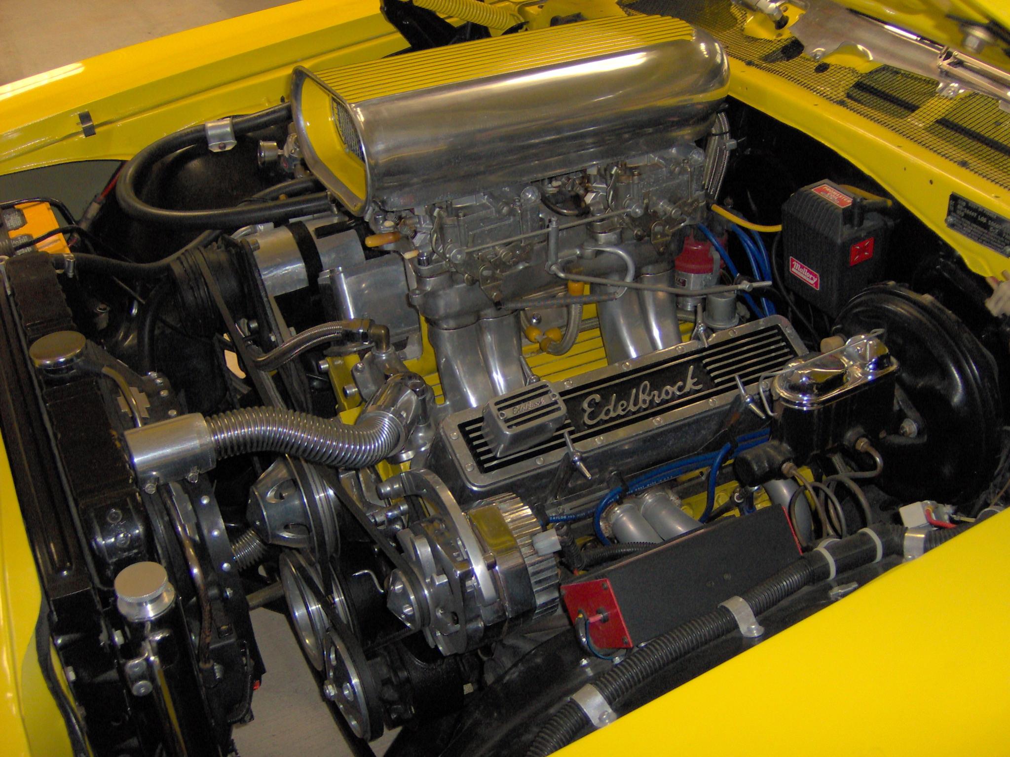

  12. mine 327 chebbie ..
