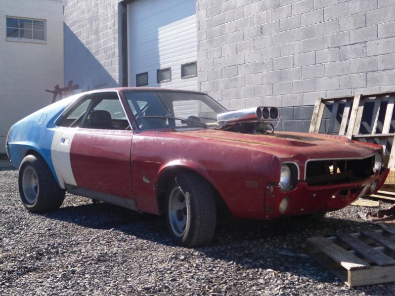

  14. gutshottt
    Joined: Jun 2, 2006
    Posts: 60
    gutshottt
    from new york
    pic of car
  15. Larry T

    You must have really gutted that AMX to get below 2300 lbs.! That's lighter than my tiny little British Austin!
  21. gutshottt
    Joined: Jun 2, 2006
    Posts: 60
    gutshottt
    from new york
    Rough estimate only,but I will tell you that I wacked about a foot out of a Buick Regal frame and basically welded a floorless body to it. Half a sheet metal dash,no sound deadening,no carpet,no inner fenders and no Freakin Radio! Who needs a radio when you have a rumpity cammed and tunnel rammed small block with a 40" dual exhaust :)
