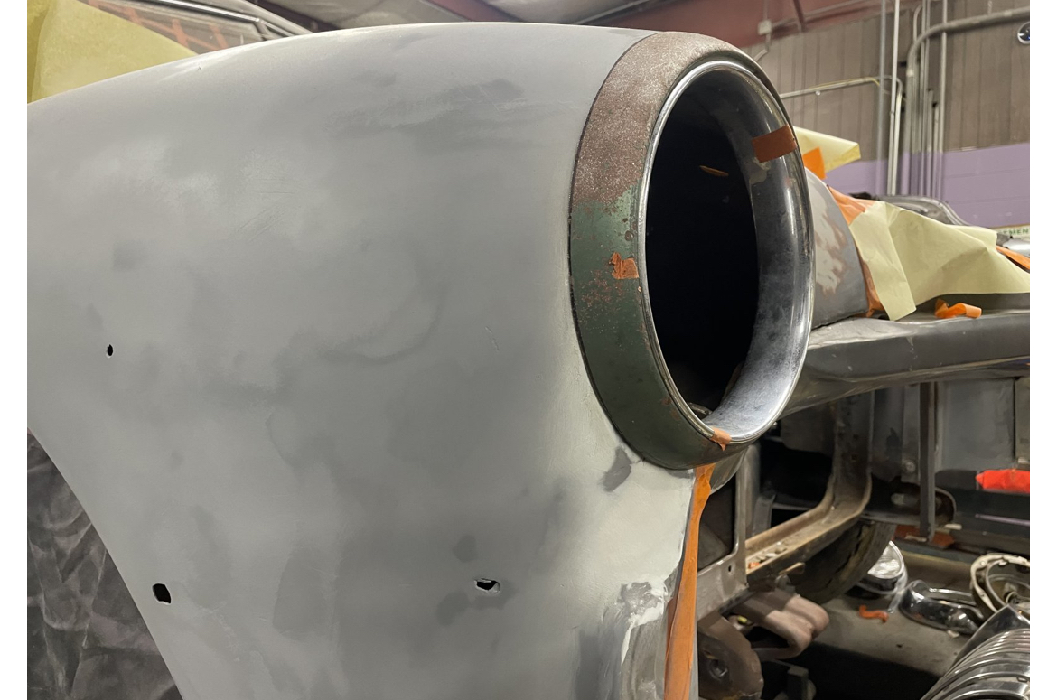

  6. The ford ones mentioned

    Then '56-7 Continental style is the only way to go. No visible fasteners in the stainless trim ring:
  13. These are thinned or trimmed about 5/8th of an inch
    They can be trimmed more
    Okie Pete likes this.

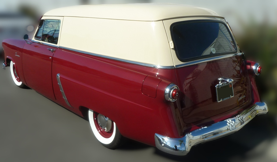

    Unless you ae going to have the custom creation just for shows, then the adjustable units from the factory should suffice. When I saw this cool maroon Ford sedan delivery on the side of the road, I had to stop and look at it. from the street inside of our car, the headlights looked “Frenched.” I thought I saw my first full custom car on the actual streets in a long time. The paint and detailing was tremendous.
    But, as I got closer for better detailing shots, I noticed the headlight rings were still there. The stock lines are not noticeable and looked like a custom “Frenched” look was done. But, we all know about adjusting headlights for adapting to lowered cars and those on a rake, to keep the level within acceptable sight lines.
    Jnaki
    To me, it does not seem logical to French in headlight rings to get the smooth look. Very impractical as one has to open the hood and re-wire both light connections and adjustment screws. For most, it is a “frenched” headlight look, but with adjustability at your finger tips. YRMV

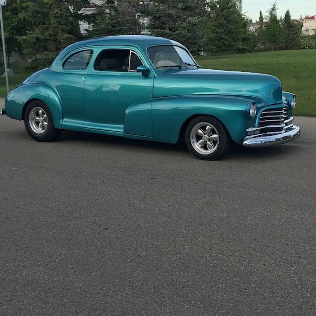

    On my 47 Chevy aero sedan the original trim rings were blasted then welded. That way there was no extended look to the fenders. The headlights were converted to a rear removal. I had one headlight go bad in 10 years and it was easy to replace from the rear.
