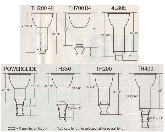

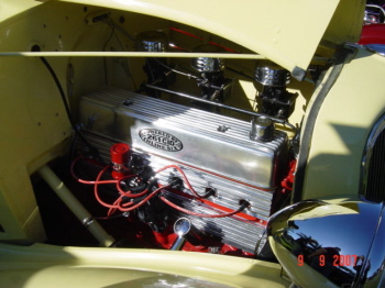

  19. mgtstumpy
    Joined: Jul 20, 2006
    Posts: 9,286
    mgtstumpy
    He's a chart and a friends blue flame with triples in his 35 Cheby roadster with T400 behind it via an adapter kit. 60" is roughly the maximum length for a single piece tailshaft. You need to factor in critical speed with length and diameter. GM transmission dimensions.jpg Rons 35 engine.jpg

  20. Thanks for your comments, Jim.
    The carb set up is shown in the avatar, dual Rochester single bbl carbs, with no throttle cable.

  22. Although I cannot find manual ****** lengths right here and now now, I believe the TH 350 with the 6" ext. will be close in length to the manual.
  23. Thanks for those measurements, would like to see a pic, as to how he connected his ****** kickdown cable to the carb linkage.

    56sedandelivery
    A 6 inch extension housing is the same length as your 3 speed/overdrive manual transmission setup. You will need a different, 27 spline slip yoke however. The kickdown cable on a TH350 really is't needed; both the Summit and Jegs branded TH350 transmission have the cable hole in the transmission plugged as examples. You just don't have a kickdown p***ing gear; you have to pull the transmission down into a lower gear manually, and then upshift it manually. In drive it shifts fully automatically You should be able to sell your 3 speed/overdrive fairly easily; they are in demand. I am Butch/56sedandelivery.

  29. Thanks for verifying the overall ****** lengths, when comparing the two ******s.
