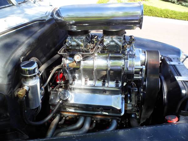

  8. Bob Lowry
    Joined: Jan 19, 2020
    Posts: 1,626
    Bob Lowry
    Agree...had one behind this motor, lots of burnouts and NEVER a problem with it..
